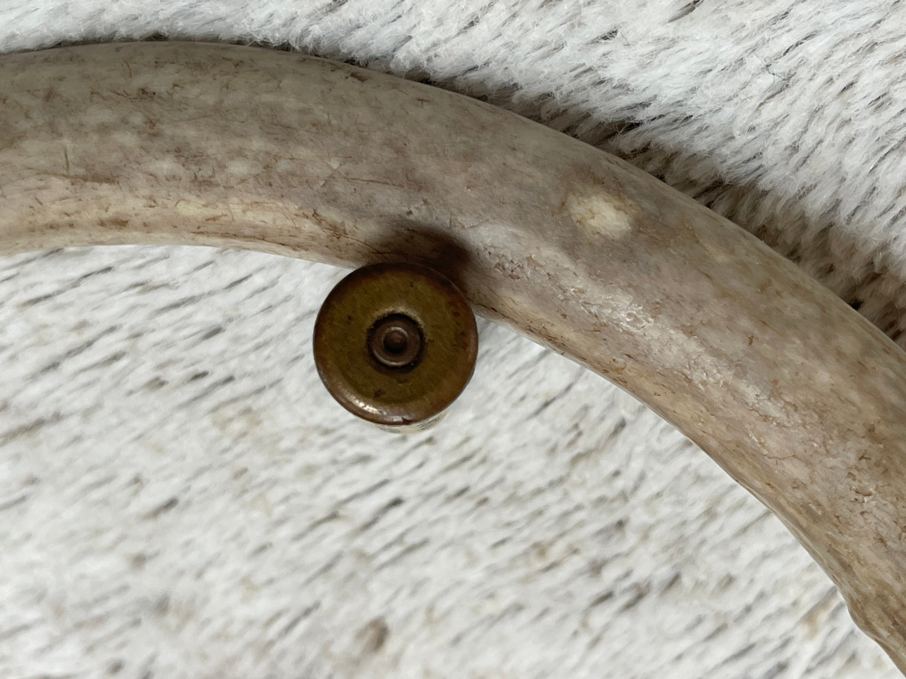

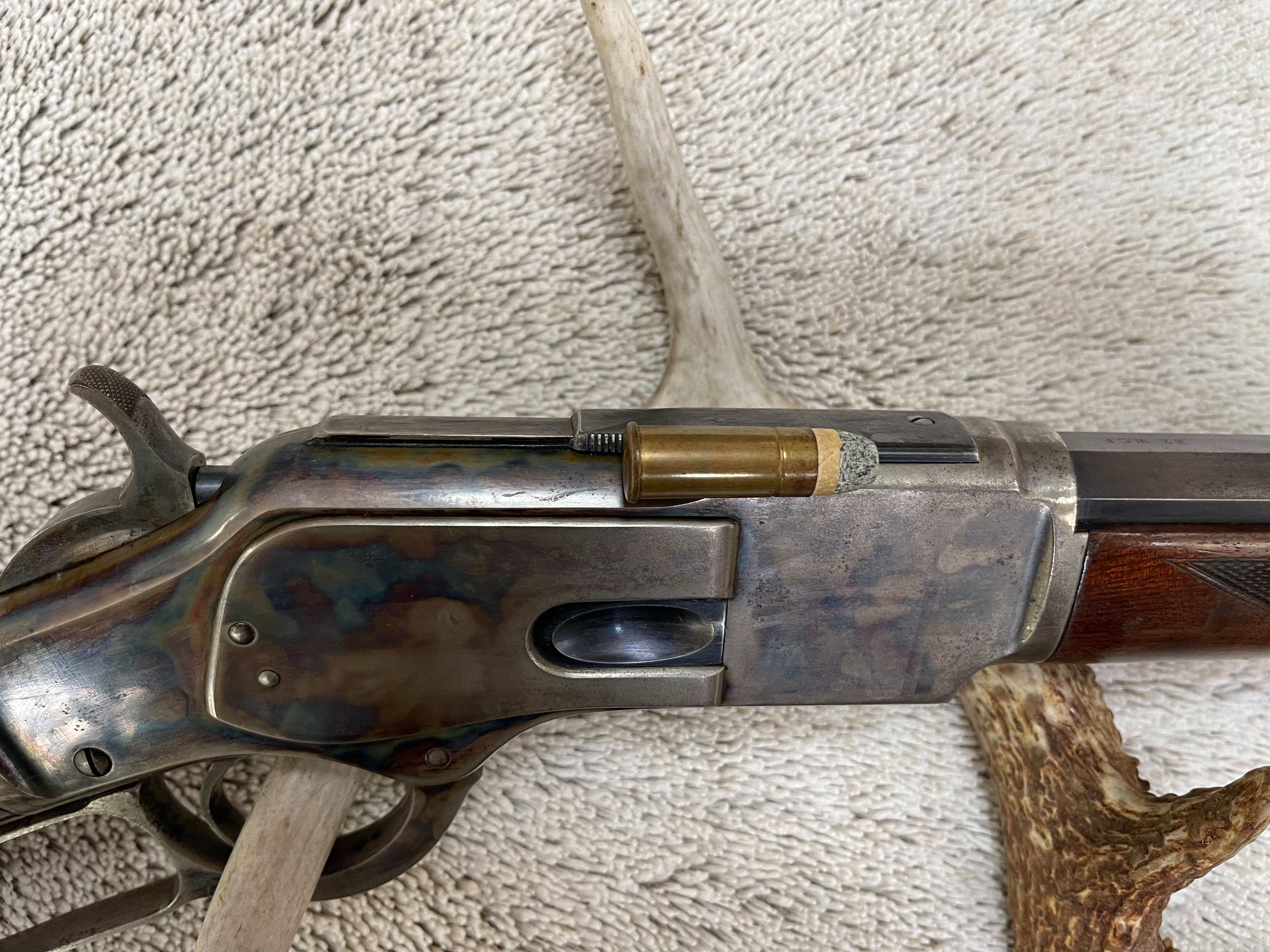

I was asking about this cut away cartridge!
Here is a picture that was sent to me.  The file size is 1.1 mb but it will be reduced when I post it .  This is not some picture copied from the internet.  I do not know who took it.
Chuck,
I understand what you are talking about in reference to you’re post!
Look at the difference in the bases, with Chuck’s, being flat, and the cut away that Bryan posted, rounded, like the one I posted, which is rounded also!

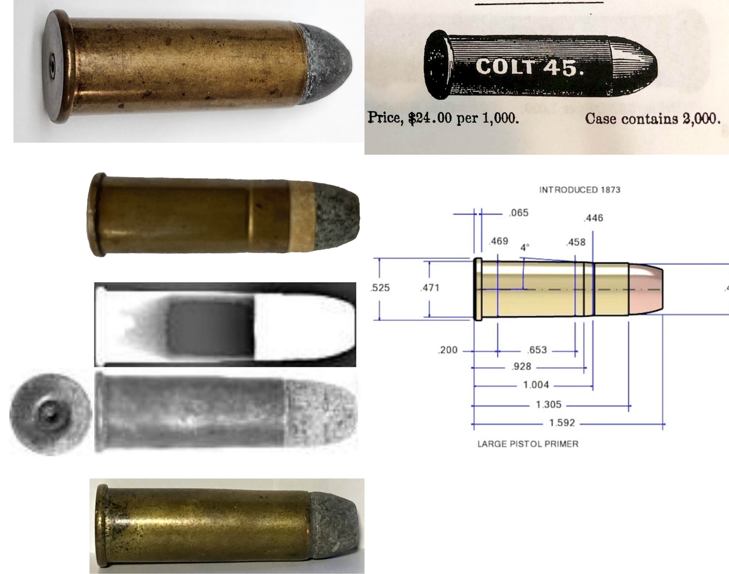

Ok, I getting myself confused.  The only 2 know Milbank primed 44 WCF cartridges have been shown on the internet before.  One is paper patched and the other is not.
How does the one I posted look compared to the only known one?

1. The photo I posted is not a 44 wcf, just a reported Milbank primed case of some type. If it is indeed a Milbank primed case, note the case design (drawn rather than folded) and the side of the primer that has been ground away. This makes me think it is not a milbank primer….but if it is, then it is in a solid head case with a large primer pocket, and the Milbank primer that is tapered, rather than the Milbank primer that looks like a 22 rimfire case.
  1. Cartridge #1 – the cartridge that has been x-rayed
  2. Cartridge #2 – the paper patched cartridge somewhere in this topic
  3. Cartridge #3 – the last photo Chuck just shared
That is all I know as far as Milbank Primed 44 WCF cartridges.

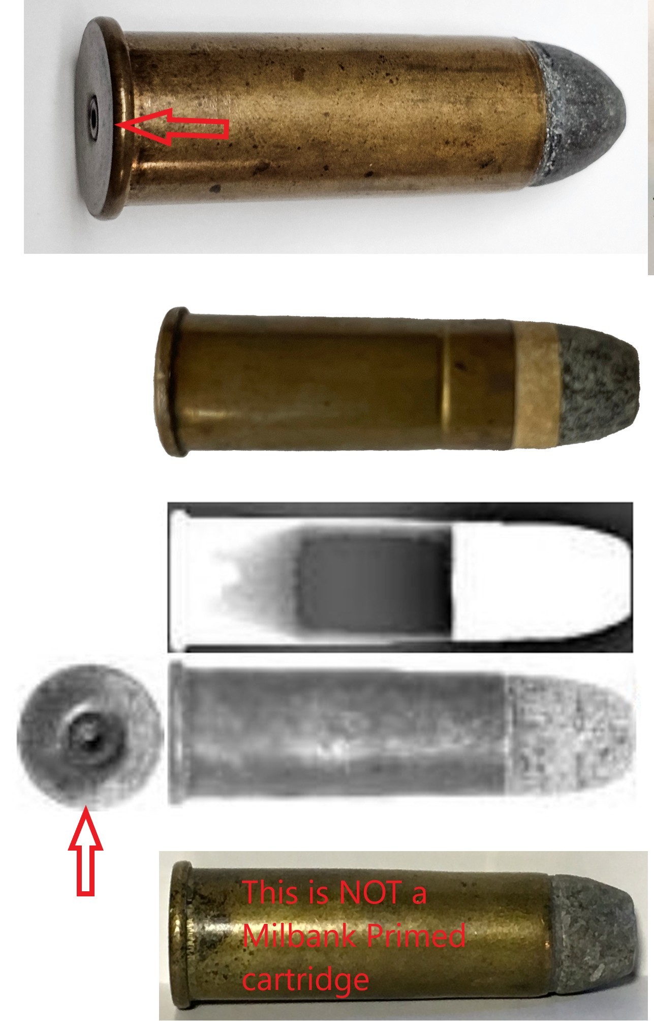

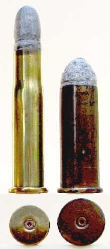

CartridgeStudy-1.jpgChuck, Based on what I’m seeing the cartridge you posted in my opinion is a Milbank primed Colt 45 cartridge. This is based on the profile of the bullet matching the 1875 Catalog, along with the case being straight walled. The 44 WCF has a slight neck to it (see diagram) and not straight walled, including the earliest Milbank primed cartridges.

Don’t think the 45 Colt ever used the Milbank primers.
In the photo you shared, I edit it a bit…
1. Looking at the distance between the primer rim and the cartridge case rim, the top cartridge is obviously a much larger caliber cartridge. Not a 45 Colt
2. The bottom cartridge is not a milbank primed cartridge…the bullet is being pushed out due to corrosion on the base of the bullet.

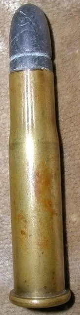

https://www.oldammo.com/50_45Carb.JPG
Well then, my next vote is that it is a 50 Gov’t Carbine that is Milbank primed. Based on the shape of the bullet and the length of the case and it being straight walled. Or even a .58 Gov’t cartridge. Without knowing the dimensions or something to scale it off of, its a moot point. But I don’t see how its a 44WCF cartrige.
What evidence is there to suggest that there wasn’t a 45 Colt Milbank primed? It was being produced at the same time as the 44WCF.

May 20, 2025 - 12:26 am
None, but what “evidence” says it was?
All we can go by is what we have, hope something surfaces, and play process of elimination until then.
Again we look back at the manufactures…Winchester and UMC. Without digging for dates, these two manufactures dominated the primer patents at the time.
Early 45 Colt civilian cartridges by UMC used the Orcutt patented primers…they didn’t need Milbanks patent…a waste of money on an already inferior primer. Winchester did not have a centerfire patent and used the Milbank primer patent for the 44 WCF extremely brief, until Winchester patent primer in early 74′.

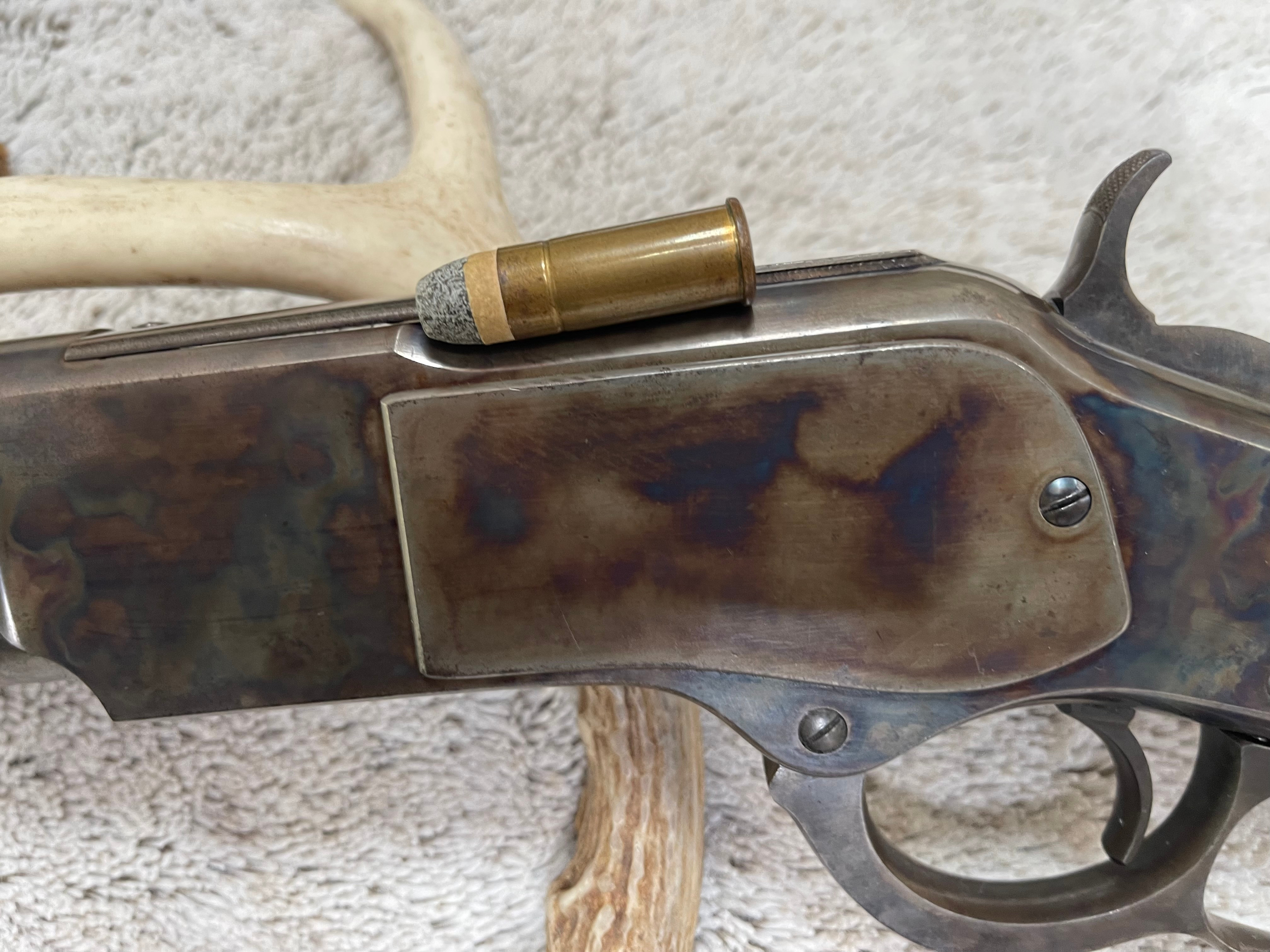

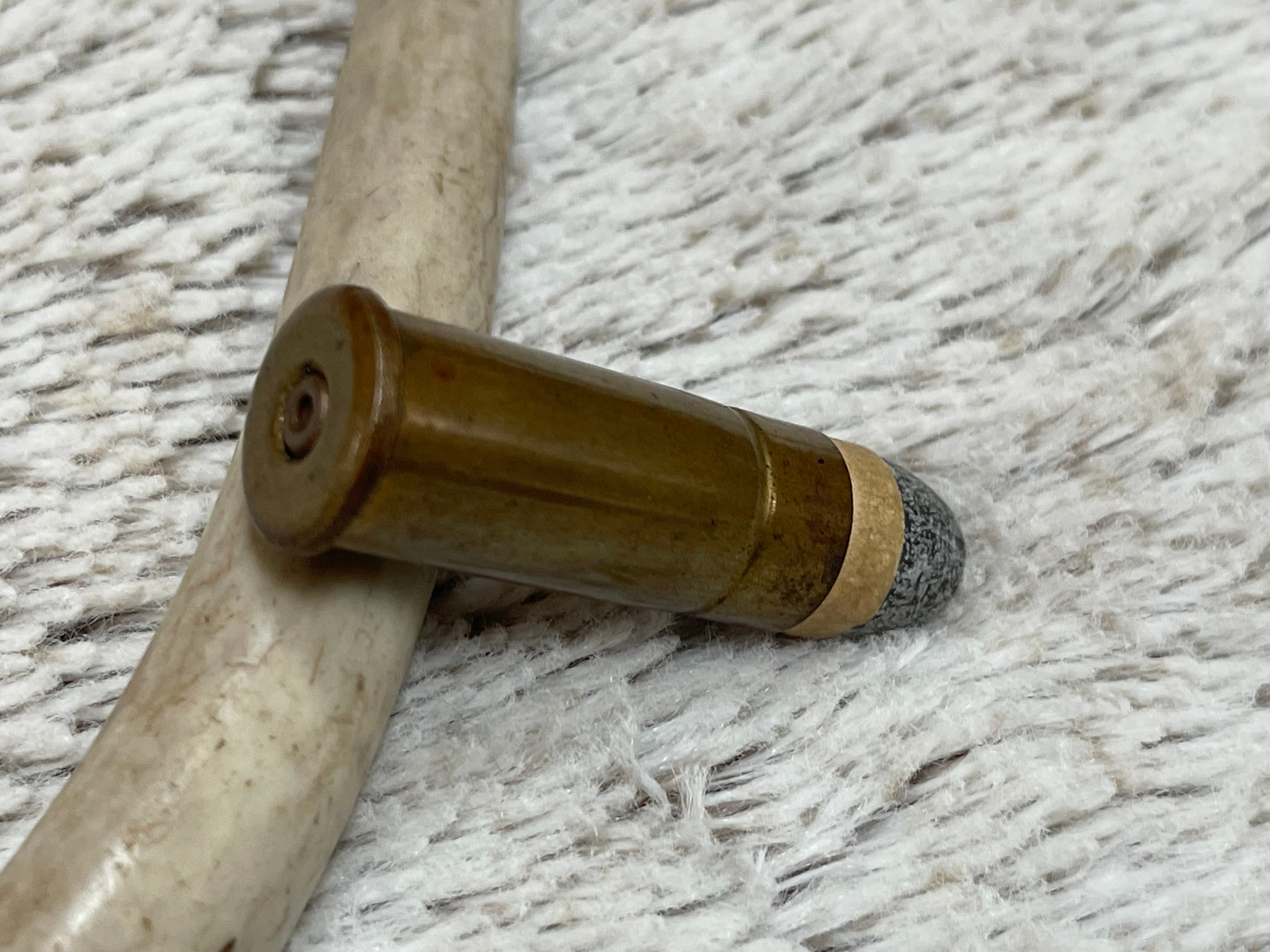

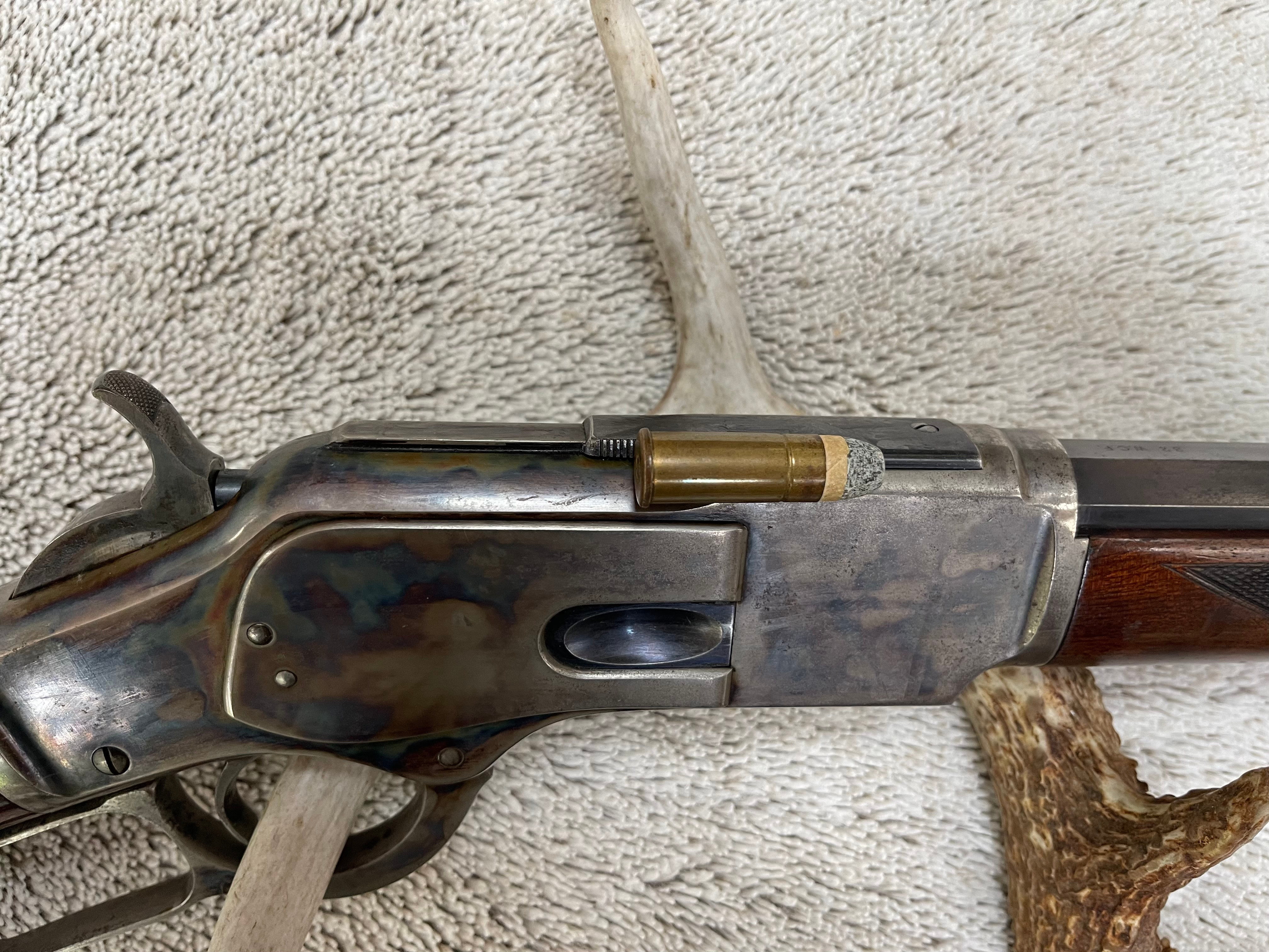

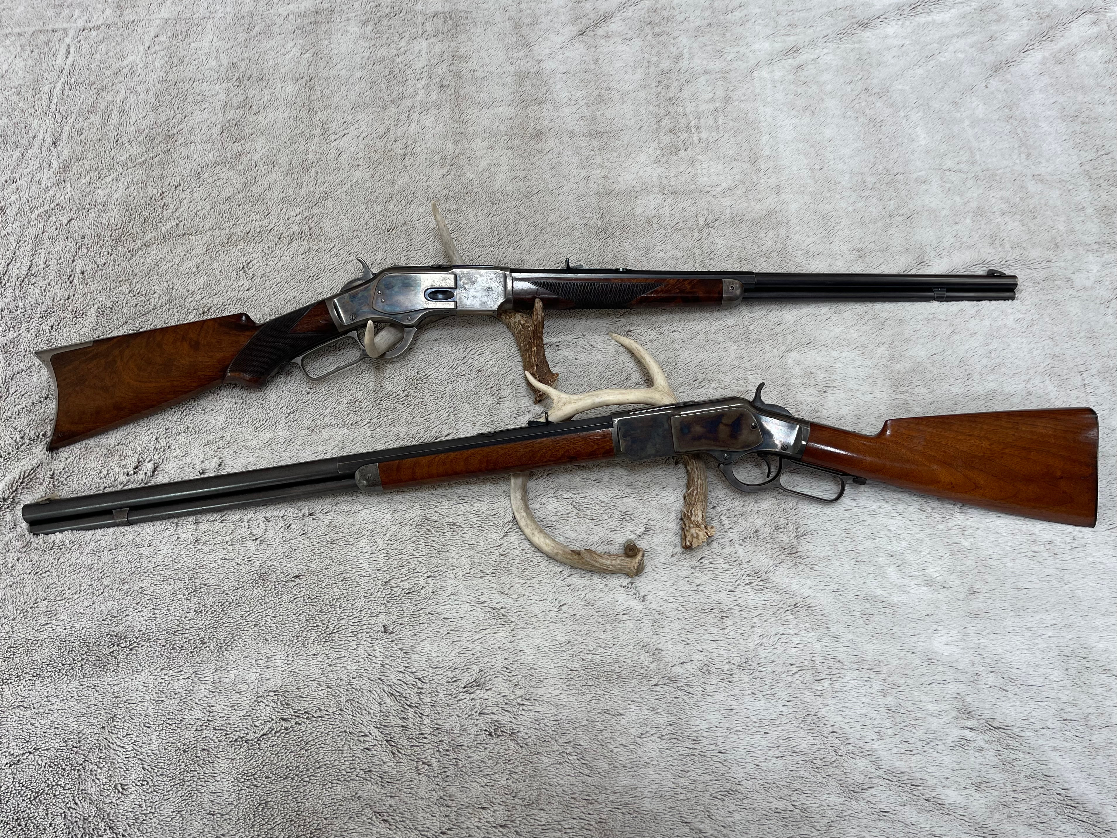

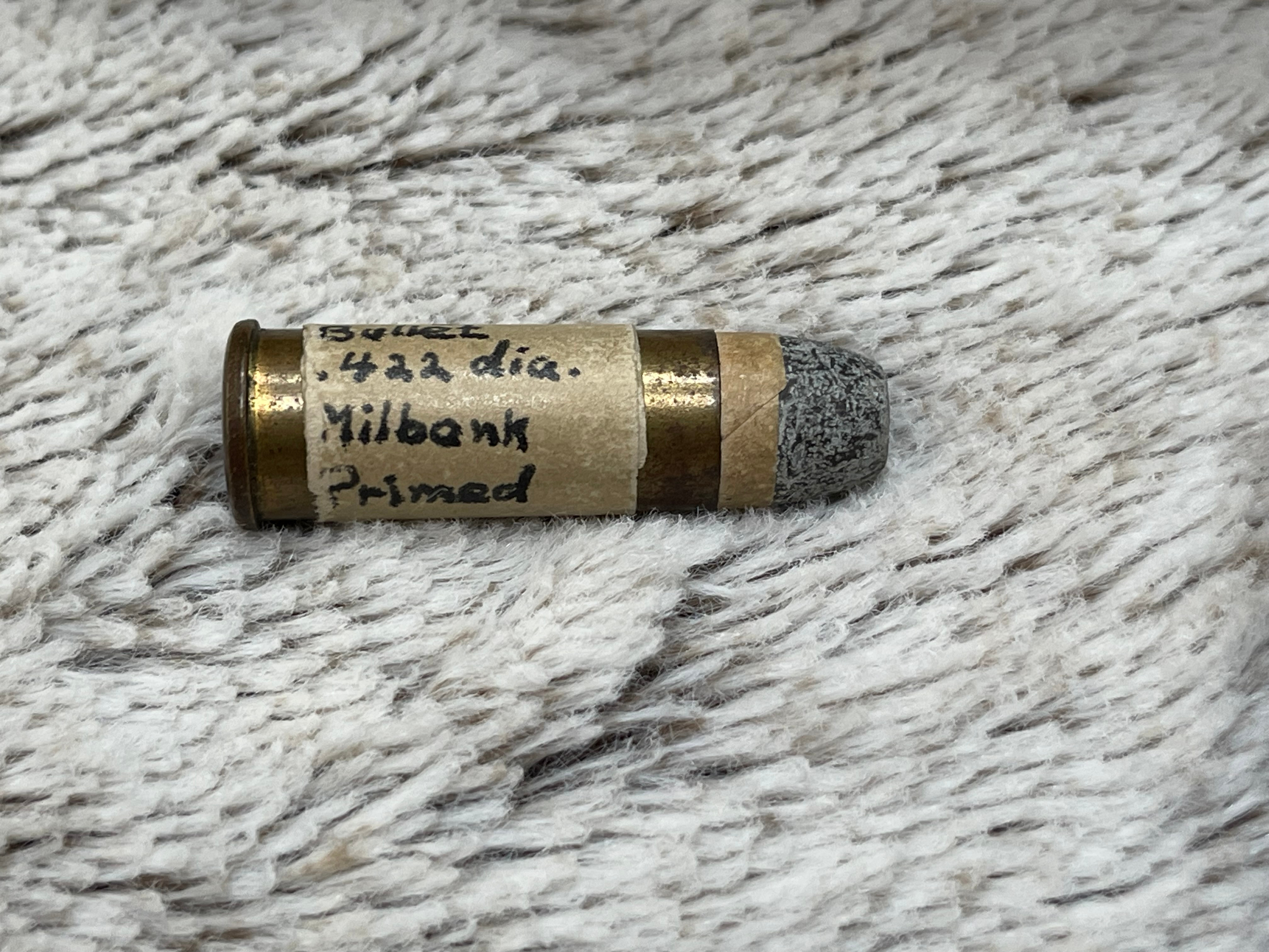

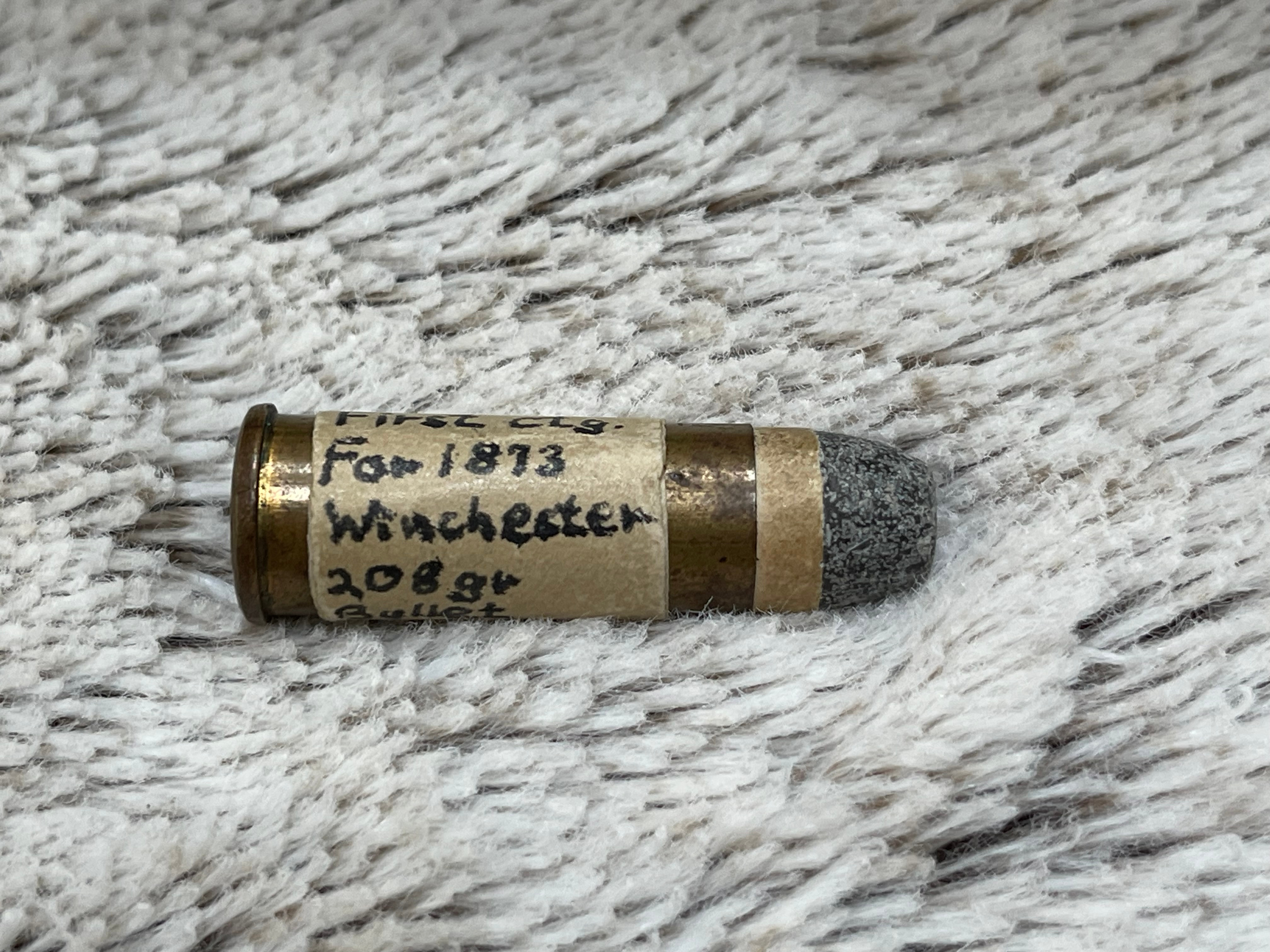

Dan told me he got to look at the Paper patched 44wcf while it was still in the Bill Wooden collection in the 1980s. While it is believed to be the only remaining one in existence. I do wonder how many were possibly made or sold by WRACo.
Here is the Milbank primed cartridge, that Dan Shuey, told us about! Pictured with a couple Winchester 73’s.
This is the ONLY, .44 WCF, paper patched, Milbank cartridge known, as of today. Many prominent cartridge Collectors have owned this in their personal collection.
