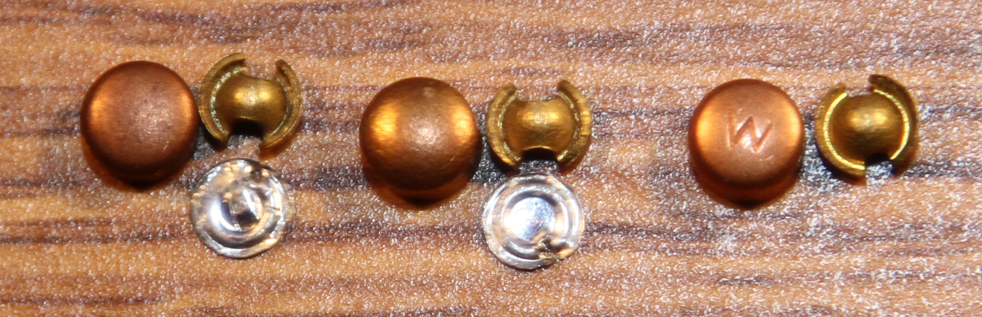

Here is a picture of the 3 dissected Gardner primers that Lou Behling sent me.
This file started out as a 1.1 mb file and was compressed to 533 kb when it was added to this post.  So the site is doing a bit of compression.
The two on the left look like the 1878 patent. The one of the right is a later one, and I’m having a hard time recalling the year. Is it the 1903?
I need to talk with Lou and have him give me more info.  The one in the middle is thicker than the other 2.  All are about the same diameter.
Looking at it again the one on the far right looks like “The No.3 W” Winchester primer. A primer adapted to Nitro or Smokeless powders. WRACo offered the No3W Winchester in October of 1893. This primer was the same diameter as the No. 2 (.210in.). They changed the priming mixture to be better suited for the new Nitro powders. With handgun cartridges the No.3W performed adequately, but with shot shells proper ignition was a problem. Which lead WRACo to develop the No.4 W primer.
What is the diameter of your primer?

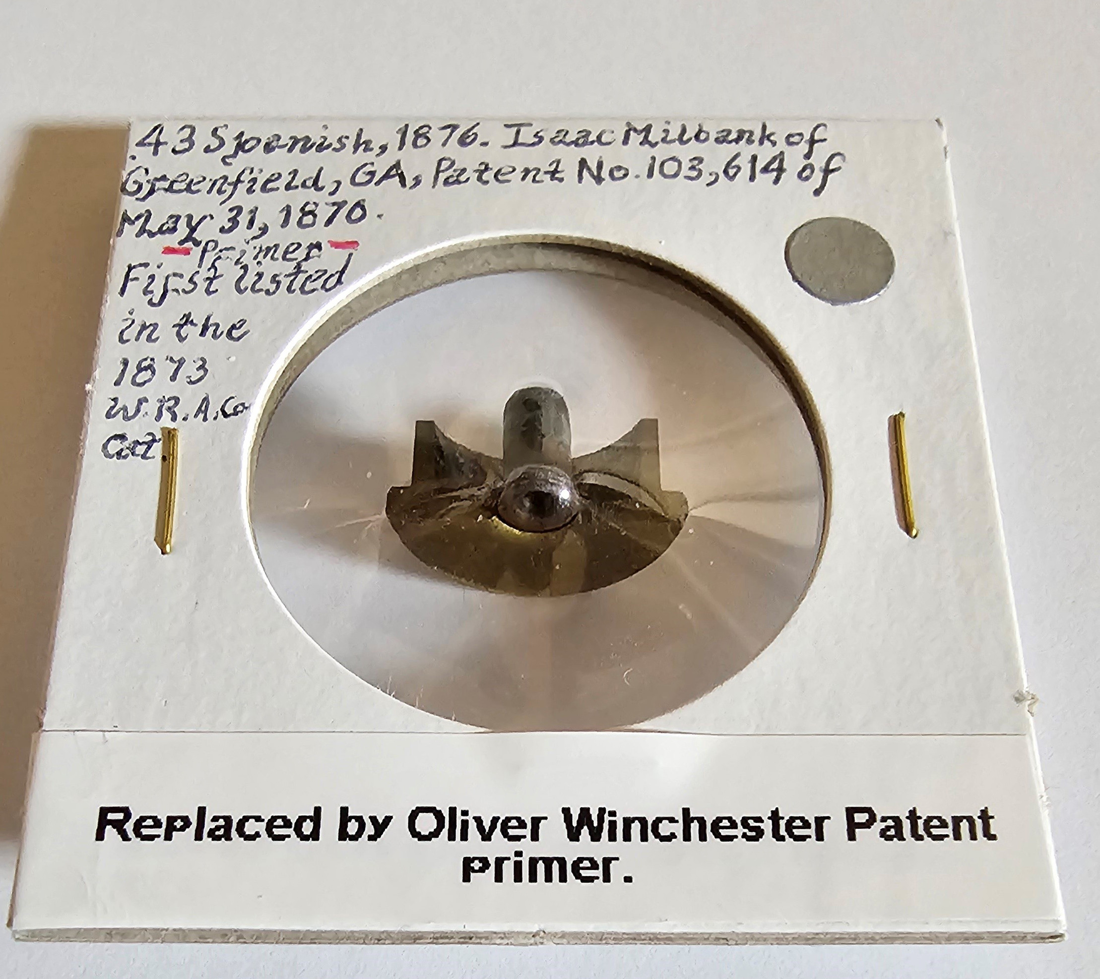

Here is a picture of a dissected Milbank primer.
Forum Posts: 1987
100
February 6, 2025 - 8:42 pm
Very interesting Chuck! Pretty sure you might want to change where Isaac Milbank was from, for you’re records, as I’m pretty sure he was from, Greenfield Hill, in the county of Fairfield, and the State of Connecticut. I’m seeing a different patent number, and dates also.
https://patentimages.storage.googleapis.com/d2/dd/6c/1a36be8da1cd44/US123352.pdf
