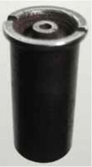

Come to think of it…I wonder if that is the one I refer too that was x-rayed. It is in black and white only and hard to see details
Actually they do indeed look to be two different cartridges. The color photo cartridges does have the cannular.

The x-rayed Milbank primed 44 WCF cartridge was sold through the Pete Decoux auctions in his pre 2023 catalog as item #203. The 2023 catalog replaced the previous catalog and I do not know what year the previous catalog was. He told me at some point what it sold for but I can not remember. It was at least $3,500, but may have been $5,000.
This is what was said in the listing:
203 RARE and early, this Winchester prototype .44 W.C.F. has a copper Milbank primer, {Pat. #103,641 May, 31, 1870,} a 1.177” / 29.91mm long brass case and a flat nose lead bullet. If side-by-side, a M-66 .44 Henry long case mouth would end at the shoulder of this. So this case was most likely too short to support the bullet and would have then been lengthened into the production .44 W.C.F. Weighing 319.4 gr., with uneven toning and oxidization, it is in good condition.

If you look closely at the x-rayed cartridge, the case appears to be of inferior quality, as compared to the superior quality of the paper patched cartridge case. The case looks to be folded rather than “drawn”. The paper patch cartridge appears to be “drawn”…as well as with the cannulur on the case, around the base of the bullet.
This should lead that the x-rayed cartridge is probably the prototype as described. The paper patched could simply be early limited production.

I replicated the prototype cartridge a while back with unsatisfactory performance results and trashed them shortly afterword. I have temporarily added them to the website so I can link to them. I will not leave them there for very long.
If the photo links dont work, go direct here and scroll to the bottom of the page https://sites.google.com/view/44winchester/w-c-f-history/little-bighorn
Milbank Replica Case Size of .177
