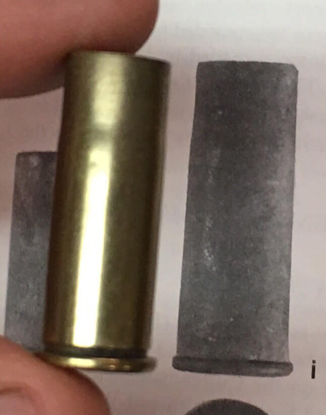

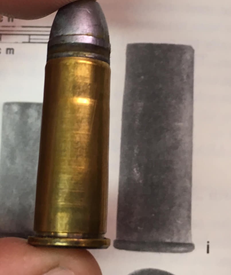

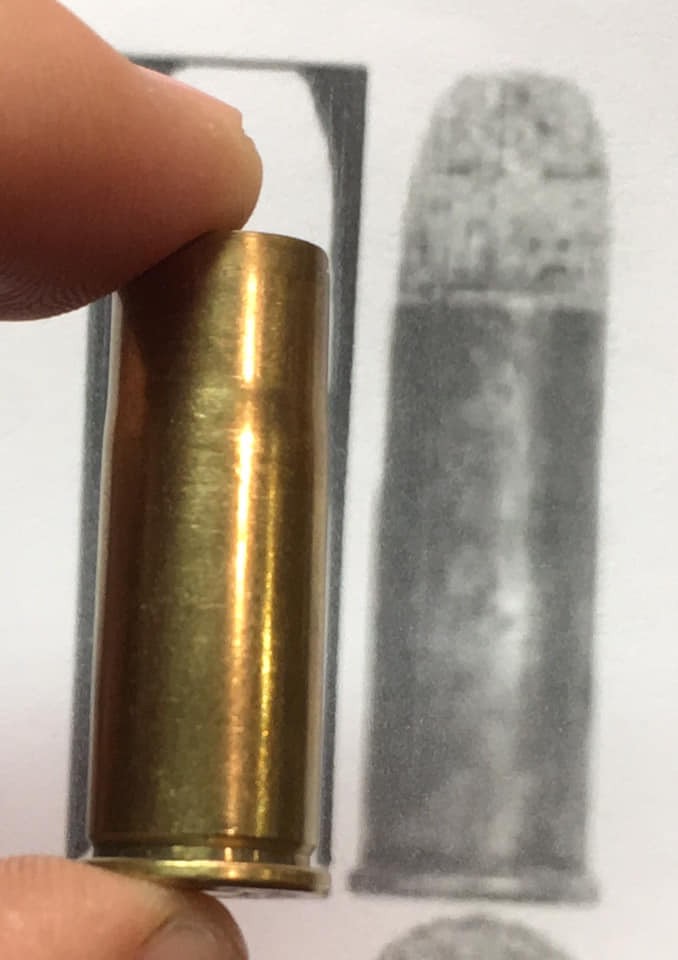

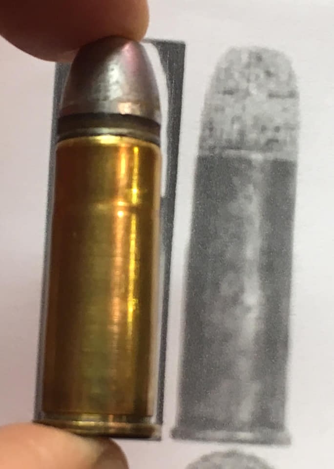

Correct, my line of thought was for the acquisition of ammunition through the civilians, acquired by the Indians…maybe for rifles they already had. Highly unlikely, but not entirely impossible.  So much that I don’t think any were found on the battlefields that I know of….nor the 44-40. Although one was said to have ben found…and photographed…the case neck looks too long.
The first two photos are comparisons of the 44-40 battlefield recover case. I do not think it is a Milbank primed case. The second photo is of the x-rayed cartridges…
48364826_1073873719459877_8362996663337353216_n.jpg48368507_1073873726126543_4345424829491445760_n.jpg48382532_1073901122790470_2389682218235592704_n.jpg99749586f4e51909d90e9aaf14bc2324673e70ac.jpeg

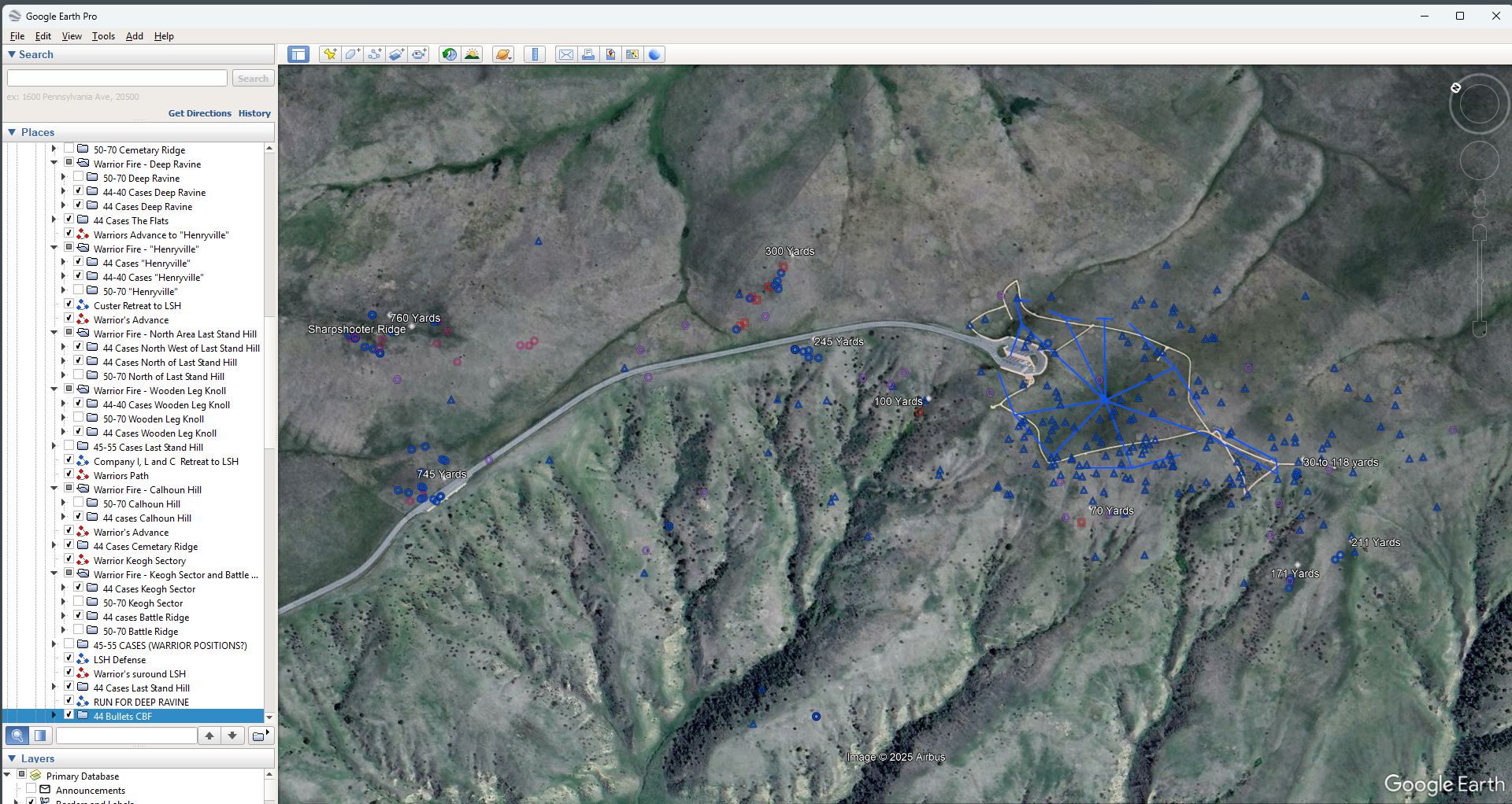

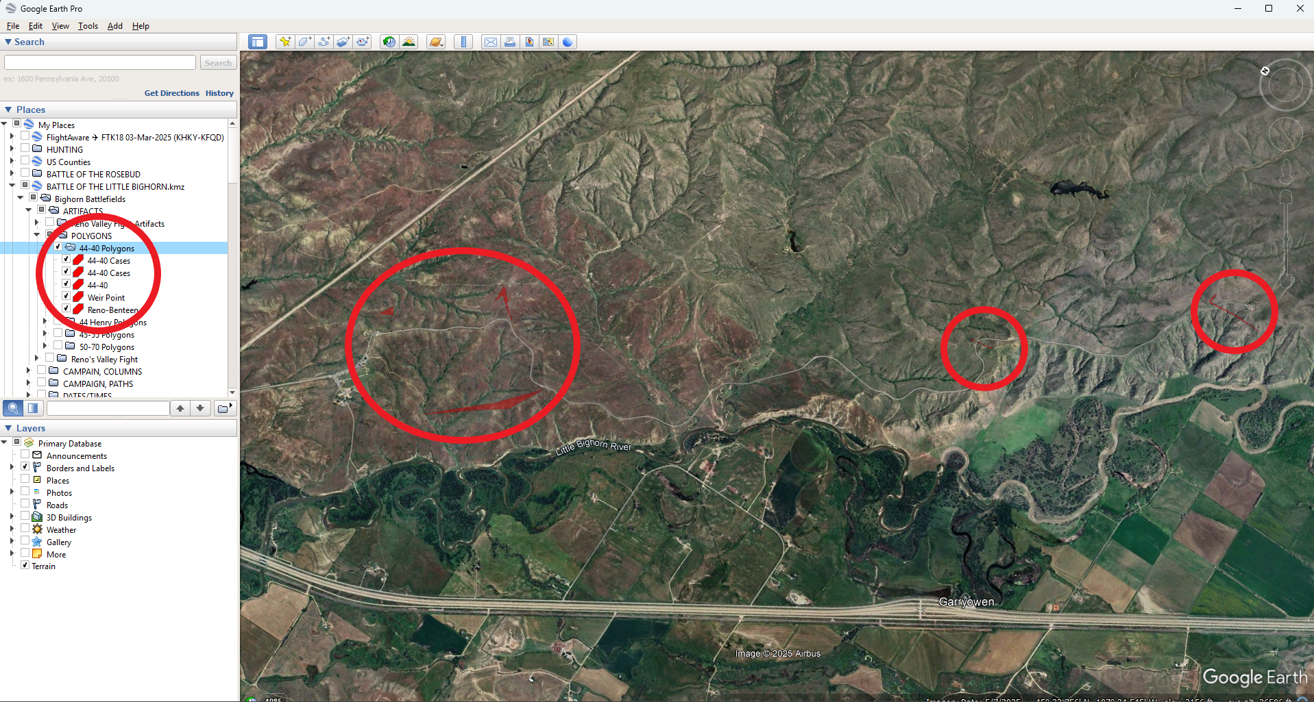

I have some screen shots to share of what I have overlayed onto the Battle of the Little Bighorn battlefield. I put a ton of hours into this project. The following is a map of the 44-40 artifacts uncovered. Namely only cartridge cases. 44 caliber bullets are so numerous and many may be mislabeled as Henry bullets…or maybe none found at all.
I can described the details if you wish…before moving on to other screenshots
Bryan Austin
North Carolina
Forum Posts: 278
February 11, 2018
192
June 8, 2025 - 9:01 pm
Here is Custer Battlefield 44 caliber artifacts. 44 Henry cases and bullets. Cases are blue triangles and 44 caliber Henry bullets are blue circles.
44-40 cases are red squares, very few are seen.
The red lines are the worrier advance, blue lines are Custer’s advance and retreat.

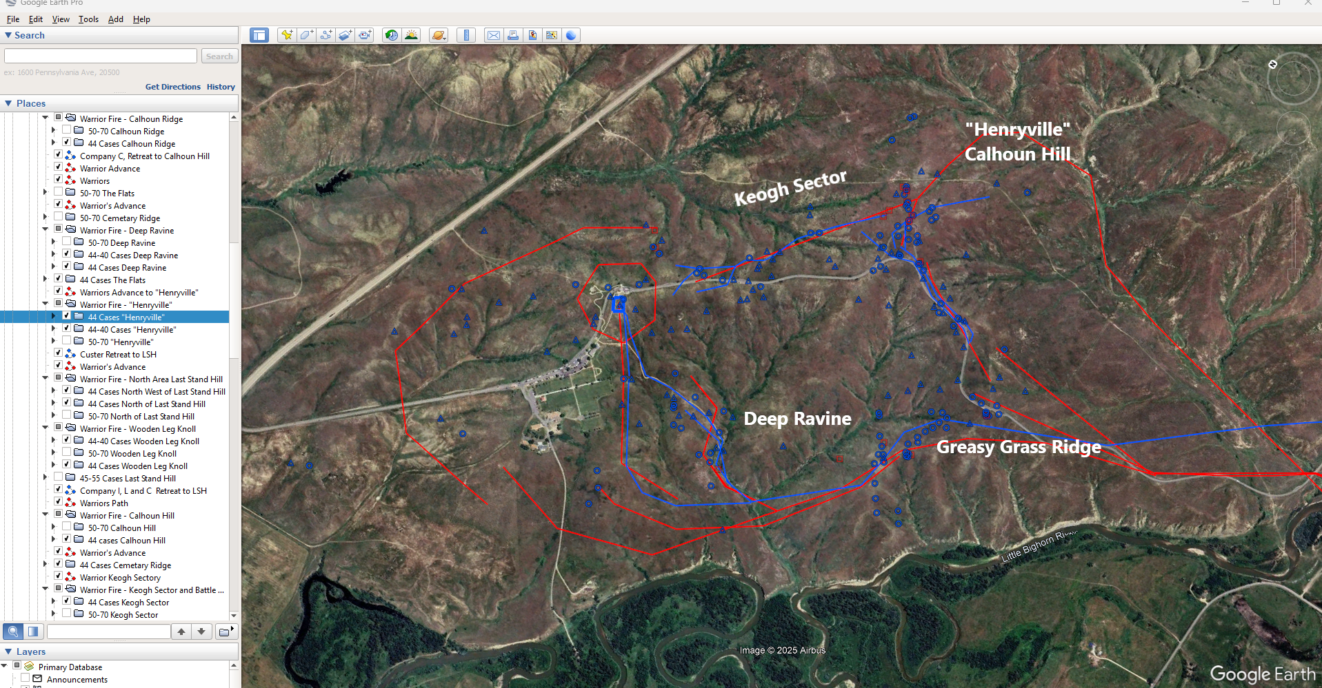

Here is the Reno Defense area 44 caliber items discovered.
Again, the blue circles are 44 caliber (Henry) cases. The blue squares are 44 caliber bullets. The red squares are 44-40 cases.
Also note the ranges used, 760 yards, 300 yards, 245 yards, 745 yards, 100 yards, 70 yards, 171 yards, 211 yards, 30 to 118 yards
