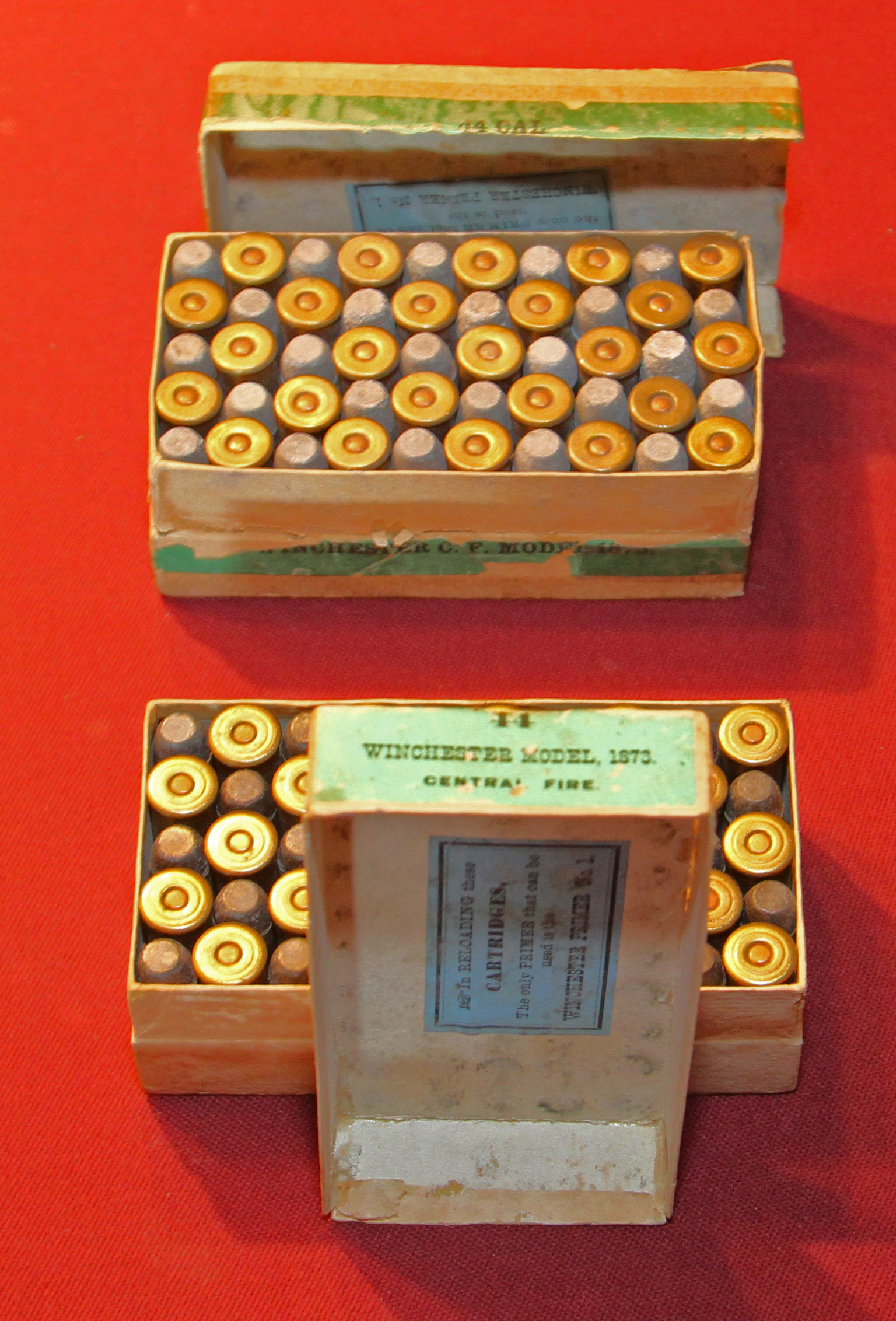

I finally got these boxes in my possession at the Vegas show.  The bottom box is the box right after the Milbank primed.  It is the first version of this box.  The top box is the second version.  The 1st version only has a side label on one end.  The second version has a side label all around the box.  Notice the cartridge heads.  No head stamp but different manufacture.  I forget when the first head stamps appeared?

Chuck,
Congrats on those very hard to find boxes. Those look like the Boxer type primers by John Gardner.(1874-1876, I think, which makes sense to me,at that time)
Do those have the grease groove also?
These UN-stamped cartridge heads are preferred by many, as you’re well aware of. I don’t think it was too long after these we’re mfg. that Winchester started to stamp the cartridge heads, as I’m thinking they we’re in such a rush to get these cartridges out, with all the problems the Milbank primer created, and delayed the release of the first M-1873’s, later in that year, and it wasn’t until 1874 that Winchester was able to deliver their M-1873 with pride, as there wasn’t the time for tooling up, to stamp the cartridge heads, to provide ammunition for Winchesters new rifle design of, “The Gun that Won the West”!

February 2, 2026 - 12:04 am
Very good condition, wow! I’m guessing at some point in time there wasn’t much need for headstamps, just as the elevators for the early 1873’s were not marked.

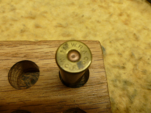

234
February 2, 2026 - 4:13 am

February 2, 2026 - 11:37 am
86Win said
Is this a Millbank primer?
Here’s the one that I posted a few pages back, of one of the known and documented Milbank Primer cartridges, from the Paul Foster collection. Your cartridge looks like a possible mi-hit or mi-strike to me.
In the larger photo, the inside of the primer has a definite shoulder to it.

February 2, 2026 - 11:59 am
Congrats on the box…that is awesome!!
  1. Winchester did not seal their 1874-1876 boxes (Winchester’s second 44 box label), thus the label was only on top and over the right side top end portion…for identification on the self in the stores.
  2. Winchester’s third box was sealed, thus the side “seal” labels.
  3.  The primer patent used in 1874 was Oliver Winchester’s July 18th, 1874 case patent, not Gardner. Gardner’s patent wasn’t until Oct 1st, 1878.
  4.  Notice the “second box label” shows the “Solid Head” cartridge case call-out, which was omitted on the first (Milbank) box label!
  5.  Winchester started headstamping their 44 cal. cases around 1884.
Forum Posts: 1987
237
February 2, 2026 - 12:07 pm
Thanks for that Bryan, as I was hoping that you’d bring you’re expertise, with all of you’re research and time invested, to the table in this refreshed and very informative thread.
