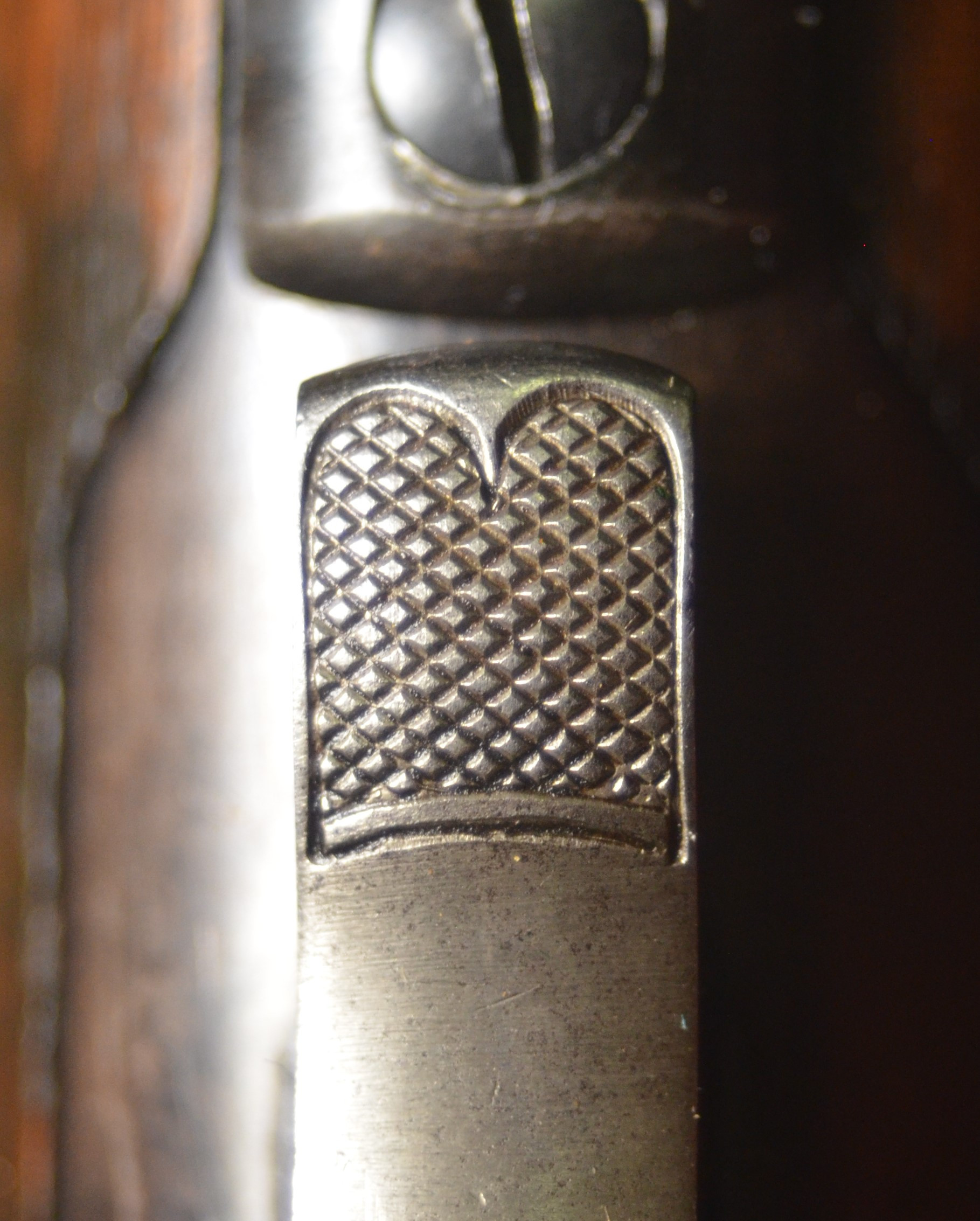

I’m not sayin’ ,I know more than anyone else here, but I just took 8 early, high condition  Mod. 94’s out of the crack and looked at them with a decent magnifying glass, as my eyes are 71 years old , and I can only see 1 minor variation in all 8. This would lead Me to believe these have been machine applied and not done by hand

Here are a couple examples in close SN ranges to compare (couple pics of each with different light).  You can decide for yourselves whether they were cut by hand or not.
SN 10307
SN 10363
SN 12019
SN 85009
SN 88158

Chris, thank you for the pictures.  I really didn’t want to dig out my guns.  It is my opinion that your pictures show so many inconsistencies that I believe they were hand cut.
But inconsistencies are also produced when parts are stamped by hand, as Louis’ photos of the many variations in the lettering of Super Grade floorplates illustrated vividly.
I believe a professional engraver could settle the point conclusively by examining one of these hammers.  Anyone have a friend in that trade who’d perform such a service?  Otherwise, the speculation will never die.
