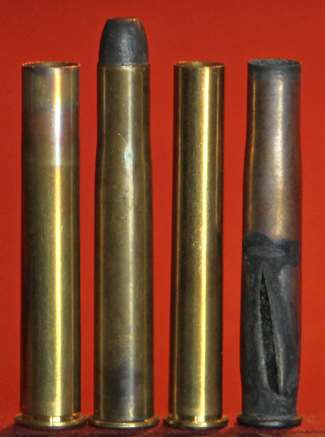

Here is the picture.  I loaded the 45-120 Sharps case with about 50 grs of FFg and then the rest with cornmeal. This case would hold the whole 125 grains but I knew better.  The 50 Sharps case is on the left, next is a Factory 45 EX, then a 45-120 Sharps case and finally the fired case.  Did exactly what I thought it might do.  No damage to anything other than my ego and the case.  The chamber sent all of the junk down the barrel so none near me.  I ordered some different brass and will see where that may lead me.

Chuck,
I would anneal the 50-125 case, lube it, and then run it part way into a 45-90 die to squeeze the first 1.25″ of the case.

Chuck,
Bert, did all that.  I actually got a case to go into the chamber except for the last 1/16″.   I can’t squeeze the base any further with the equipment I have.

Chuck,
Just to be clear, a 50 cal case will not even start into the 45-90 die unless you reduce the diameter first.  I did reduce it but not enough of the the length so when things got tight it crushed the case.

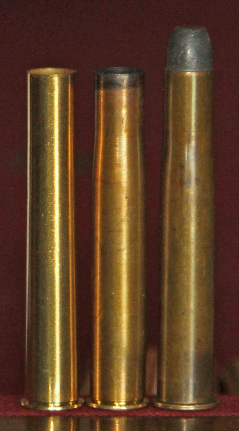

Last night after dinner I received a package from Buffalo Arms.  I had ordered some 45 Cal brushes and a cleaning jag.  I also ordered 5 ea. 450 Nitro Express cases to try out.  I loaded about 3/4 of a case with FFg and filled the rest with compressed toilet paper to the point the bullet would sit on top of this.  Here is a picture of an unfired case next to the fired case.  On the right is a Factory 45 EX.  Looks like I will have to load the other 4 for next week.  I haven’t figured out how to get my chrono to work through all the smoke.
Problems are I don’t have a way to de cap the primer or easily put some back in.  I don’t have a de capping pin that is long enough but may be able to rig something up.  I used a bench vise to put in the primer and seat the bullet.

48
August 13, 2025 - 1:48 am
Interesting!  It appears that the case stretched enough to conform to the 45 Express chamber without splitting.

49
August 13, 2025 - 3:55 pm
Yes, these cases have a larger head diameter than the Sharps 45-120 that split.  So as the body expanded it didn’t tear away from the head. I’m going to call Buffalo Arms and order some more brass.  I will also have a conversation about getting a longer decapping rod.

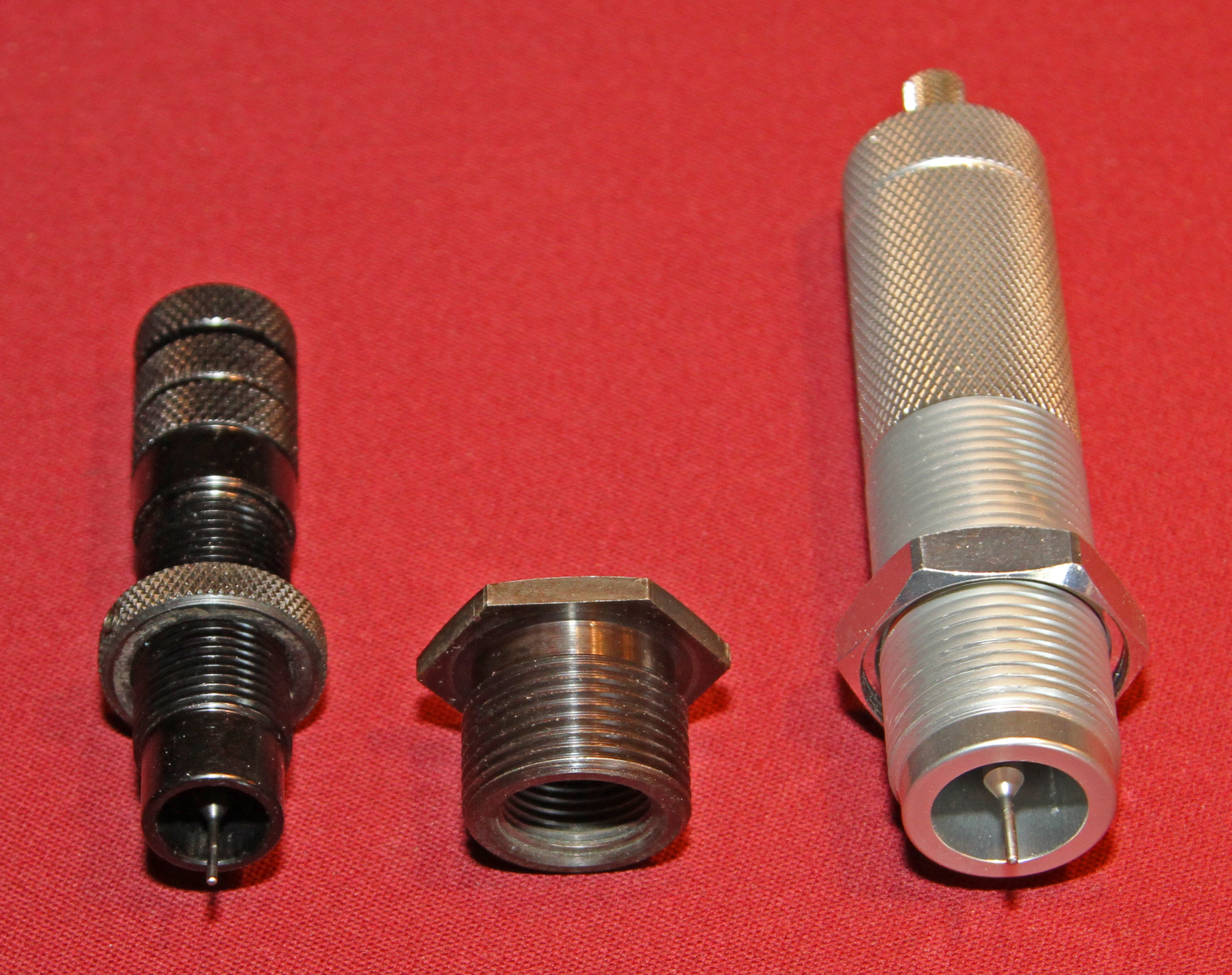

Just got off the phone with Wayne of Mighty Armory.  He has a decapping die that will work. I use one of his universal decapping dies already but it is too short.  Only thing is that I have to remove the threaded bushing on top of my rock crusher press because the threads are 1.25″ x 12.  This die is for the .375 Chey Tac, 50 BMG and the .338 Lapua length cases.  I’ve shot 2 of the 3 rounds and don’t want to own one of these or shoot one on a regular basis.   But if someone is interested there is a Chey Tac with ammo in the shop right now.  Shoulder pad not included.

Here is a picture of the universal decapping die that I use all of the time, the bushing from the top of the RCBS Rock Crusher and the new decapping die.  It worked great.
