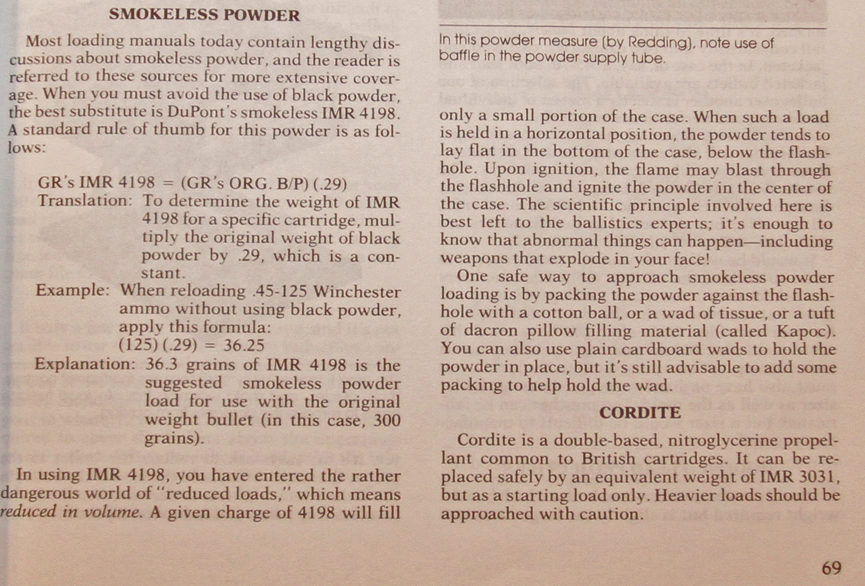

I knew Bert was on to something when he mentioned his rule of thumb when using 4198 in place of black powder. It took me this long to find the actual data.  I have too many old loading books and manuals.
On page 69 of The Handloader’s Manual of Cartridge Conversions by John Donnelly he explains what Bert had mentioned.  Donnelly references information from Frank Barnes, Cartridges of the World.  So if you buy Barnes book there will be at least 1 smokeless load using IMR 4198 for all of the Winchester cartridges.  To my surprise in this example he uses the 45 EX.   Barnes book says to use 34 grains.
Please read the part about the reduced loads and the hazards.

Interesting, but that is not what Dupont published. I am more inclined to go with the Dupont formula.  34.3 grains of IMR 4198 in a 45 EX case appears to be on the bottom end of the scale.  A friend of mine loads his 45-70 high-wall with 34.0 grains under a 405-grain hard cast bullet and it shoots perfectly.  All that said, 34.3 grains would be a good starting point, and I am curious what velocity it produces.

I’d like to see a copy of what Dupont published for my records.
I started with 31 grains because the published data by Barnes that I have said to use 34 grains.  I will let the chronograph dictate how far I will go.  I really don’t like pushing my antiques past factory speeds.  I don’t have the capability of figuring out the actual chamber pressure that is being created.  It is absolutely not true that low speed guarantees low chamber pressure.  Different powders will produce more pressure at the same feet per second.  The old books show examples of this.  Many modern manuals don’t show chamber pressure.
Regardless 34 or 34.3 can be safe loads.  Not 50 grains.  (40% of 125)  The 2 good loads that I shot with 31 grains produced 1,115 fps and 1,136 fps and that was with no neck tension and loose bullets.
I use 31 grains of 4198 in my 45-90 loads.  With the 300 grain bullet I get 1,550 fps.  I can’t find anything that Dupont posted for using 4198 instead of BP.  But I did find this.  Do not use this, it is unsafe.

Chuck,
I am trying to locate the old reference material I have (somewhere) that Dupont published citing the 40% rule of thumb… it is buried somewhere deep in my older files in printed form.  When I eventually find it, I will scan it and make it digital.
I first learned of the 40% formula more than 35-years ago.
While I agree that velocity is not the true test of pressure, Dupont did the pressure testing with the 4198 powder and discovered that the peak pressures were nearly identical to the FFg black powder with the appropriate loads, but that it was slightly slower to create the pressure.  If you are shooting cast bullets (especially hard cast), IMR 4198 may not bump the bullet into the lands as efficiently as BP does.
As far as your “antique” rifle goes, you are not going to stress a high-wall action (or barrel) that is in good condition.  Keep in mind that the action is perfectly safe with significantly stouter (higher pressure) factory loads (e.g. 30-40, 35 WCF, 405 WCF, and 30-06).  I am not trying to convince you to hot-rod your old high-wall, but not to fear hurting it with reasonable loads.  I agree with your approach to work up the powder charge in slow methodical increments.  Again, it will be interesting to find out what your final load ends up at when you reach the factory velocity with a 300-grain bullet.
