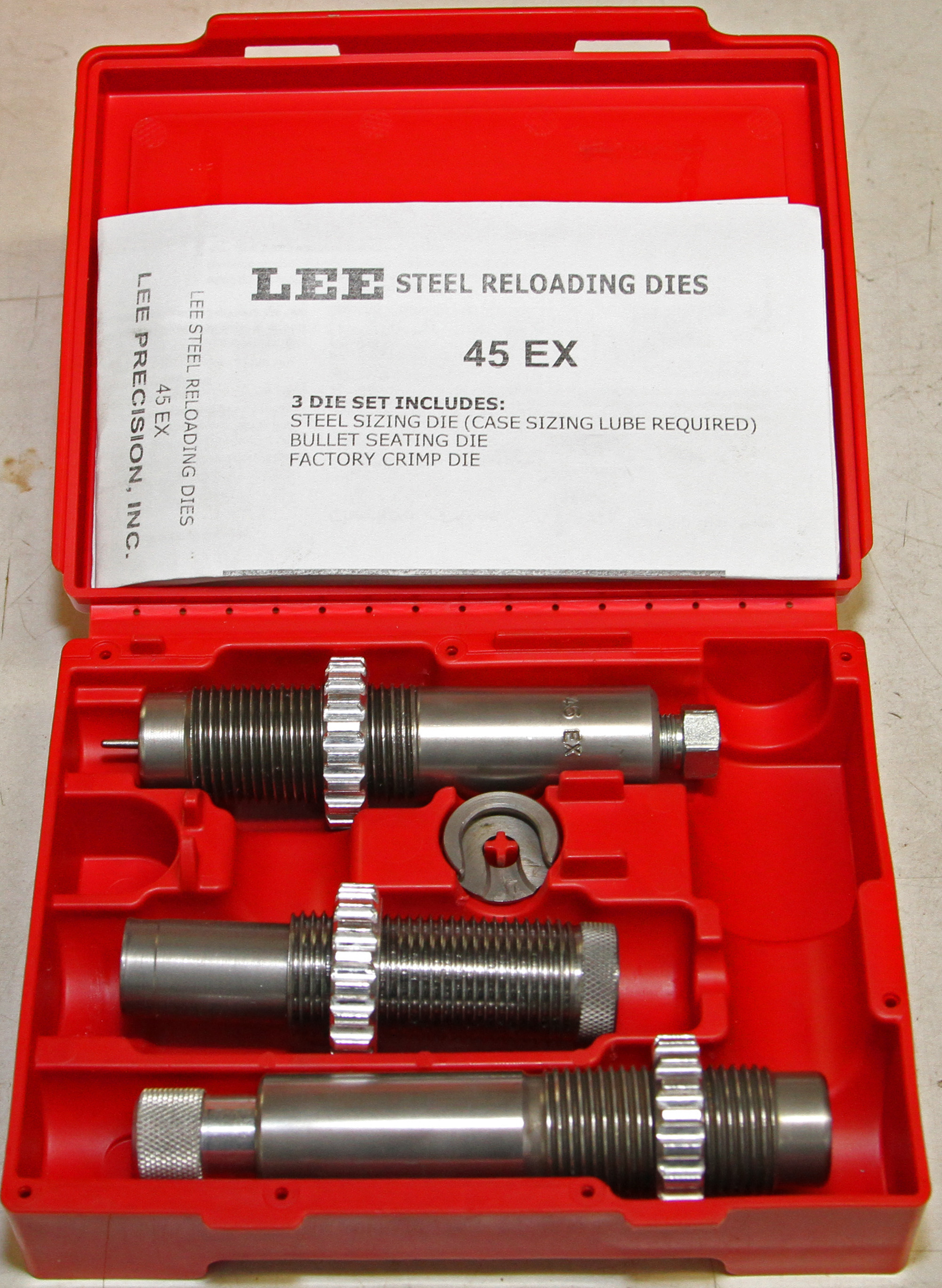

Here is a pic of the 45 EX dies.
When they returned the brass and bullets they also included 1 sized dummy round with a seated bullet.  Loads with no problems.Win-45-EX-Dies.jpg

Nice! I like the new retaining nuts. Good to see a big company like Lee doing custom work. I’ve been part of some bullet mould group buys where if we got enough people that wanted a custom mould Lee would do a limited run for us. A fellow hog hunter from Cuero, Texas had a knack for designing wide meplat heavy hunting bullets that he tested on the hogs frequenting his ranch. I did a bit of Beta testing on the hogs a few hours south of his place. I wonder how Ranch Dog is doing these days.
What was the final tab for those dies?  The look really niceCool

$309 but not anymore.
With the O rings the rings stay put and no tools required.  Redding claims they can make dies too but the cost is quite a bit more.

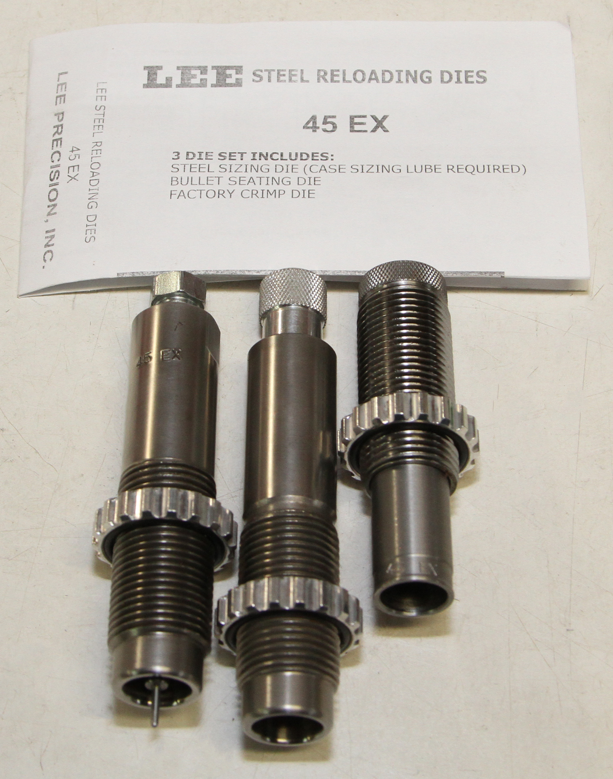

Forgot to post this one.

Haven’t seen that box before. I suppose you didn’t need a case mouth expander. Have you used Lee’s Factory Crimp die?
I assume there is an expander on the shaft in the F/L die.  I haven’t used the die set yet but I do use one of their crimp dies for my 44 WCF.
Chuck-
I use a case mouth expander for most cast lead bullets, especially if they have a sharp base. I use a Lyman M-Die and an expander a couple thousandths smaller than the bullet. It also flares the case mouth so I don’t damage the bullet when I start it down the neck. The FCD will remove the flare.

I have a special expander for my 45 Cal Winchester ammo.  I bought a pin gauge and had it mounted in a universal expander mandrel die.  I chamfered the leading edge so it will easily start into the case mouth.  This works for my .458″ and .459″ bullets.
