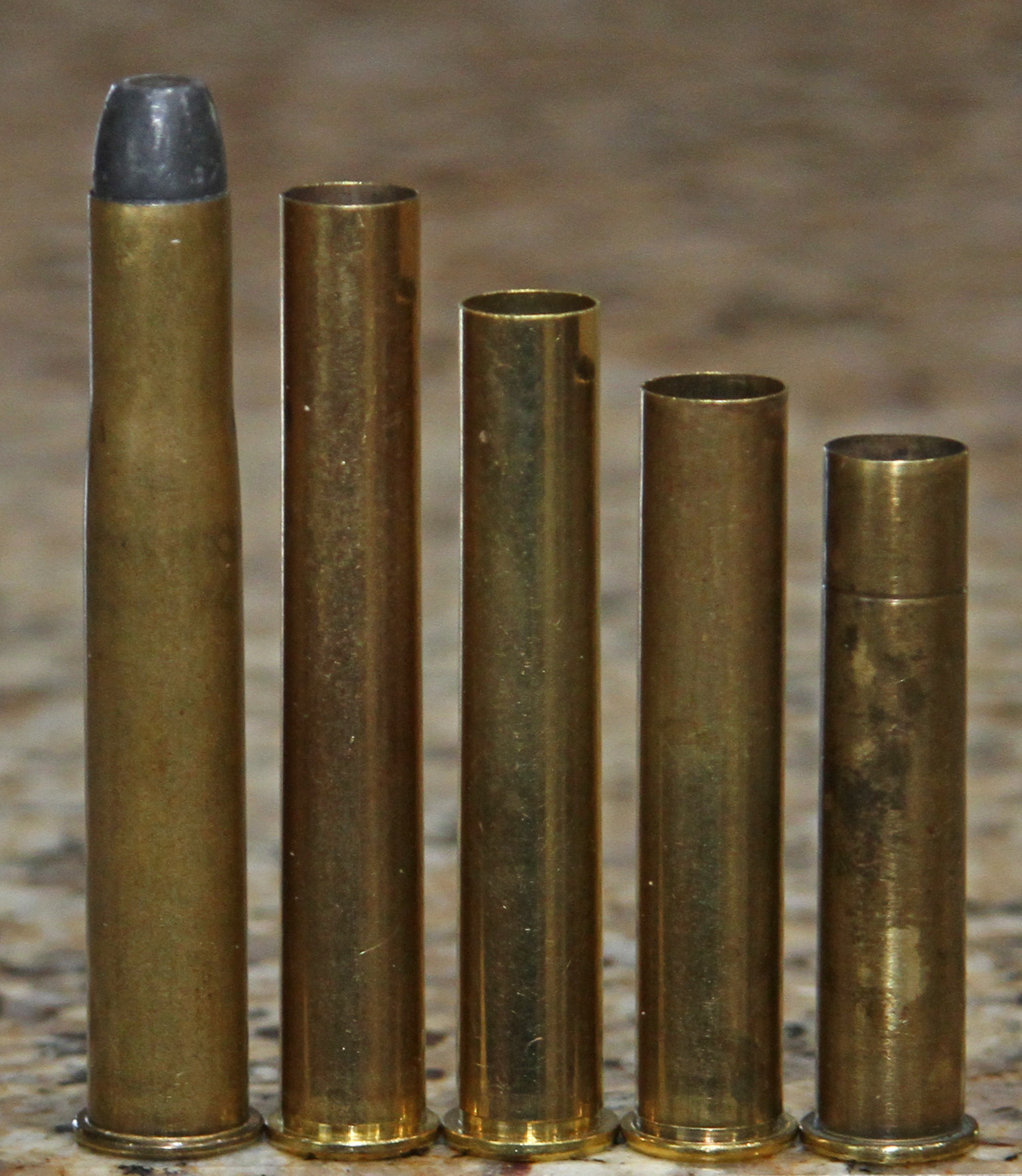

Some of you might know I bought one of these not to long ago.  And me being me I can not stand to have a rifle I have not shot.  I started looking through all the brass I have and found some 45-120 Sharps that I thought might work.  But after comparing the two I decided the Sharps brass would have to be blown out so much it might become to thin and not hold up.
Here are some of the brass I have.  The 45 EX is on the left next to the Sharps 45-120.  Notice how thin the body of the Sharps is compared to the Winchester EX.  The case on the right end is a 45-90.

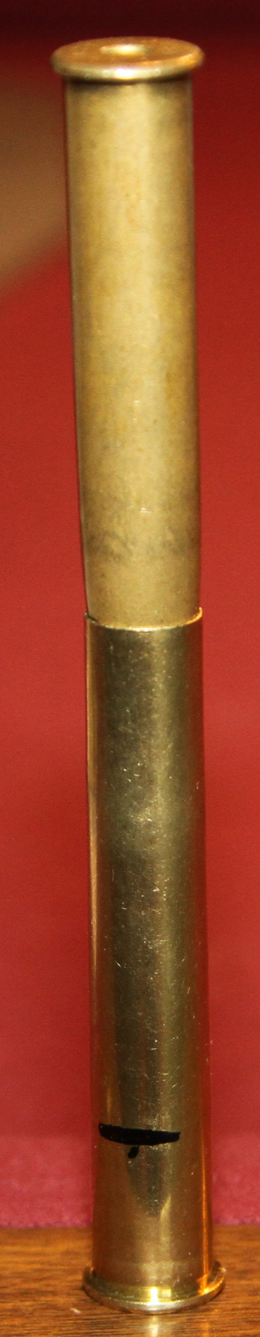

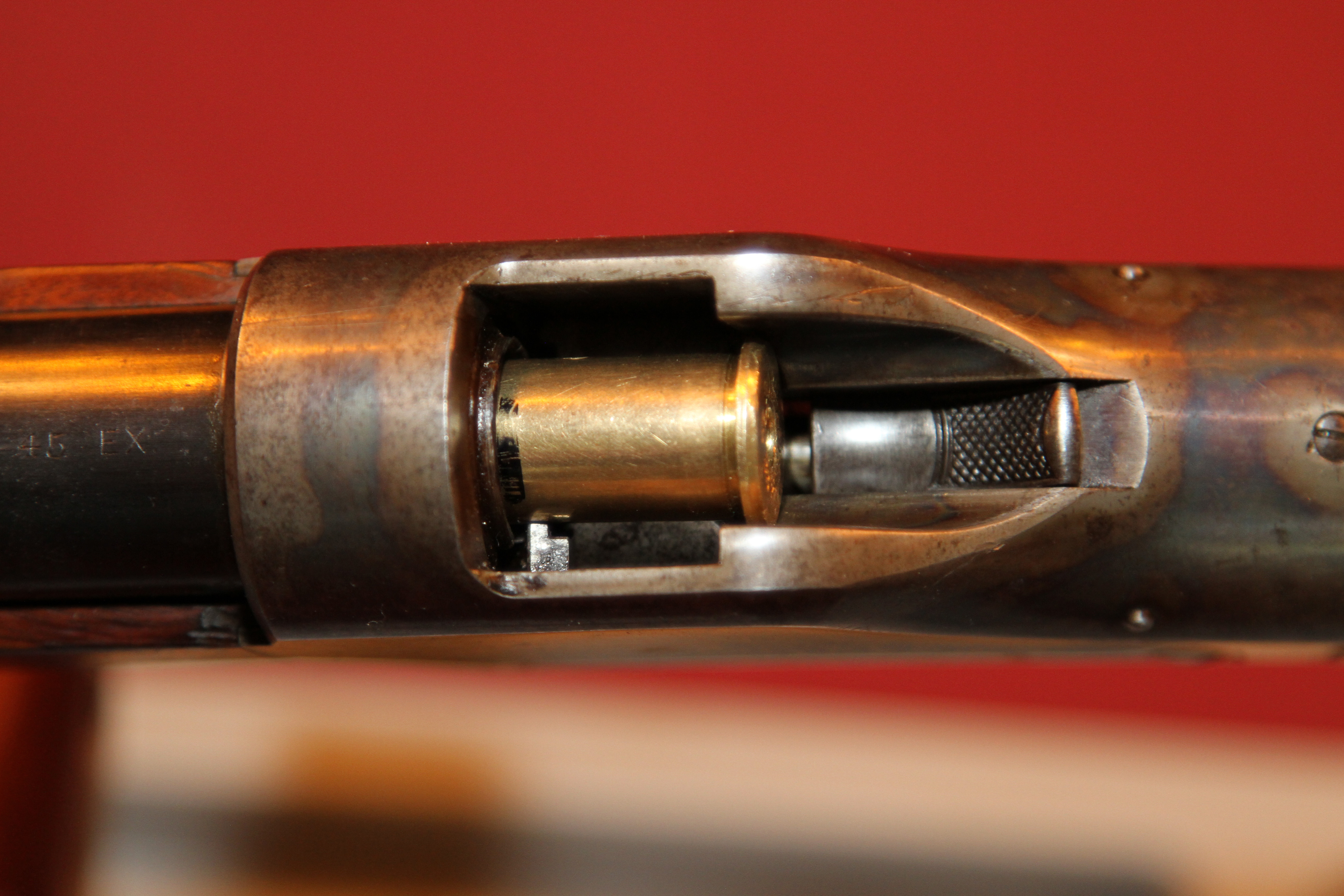

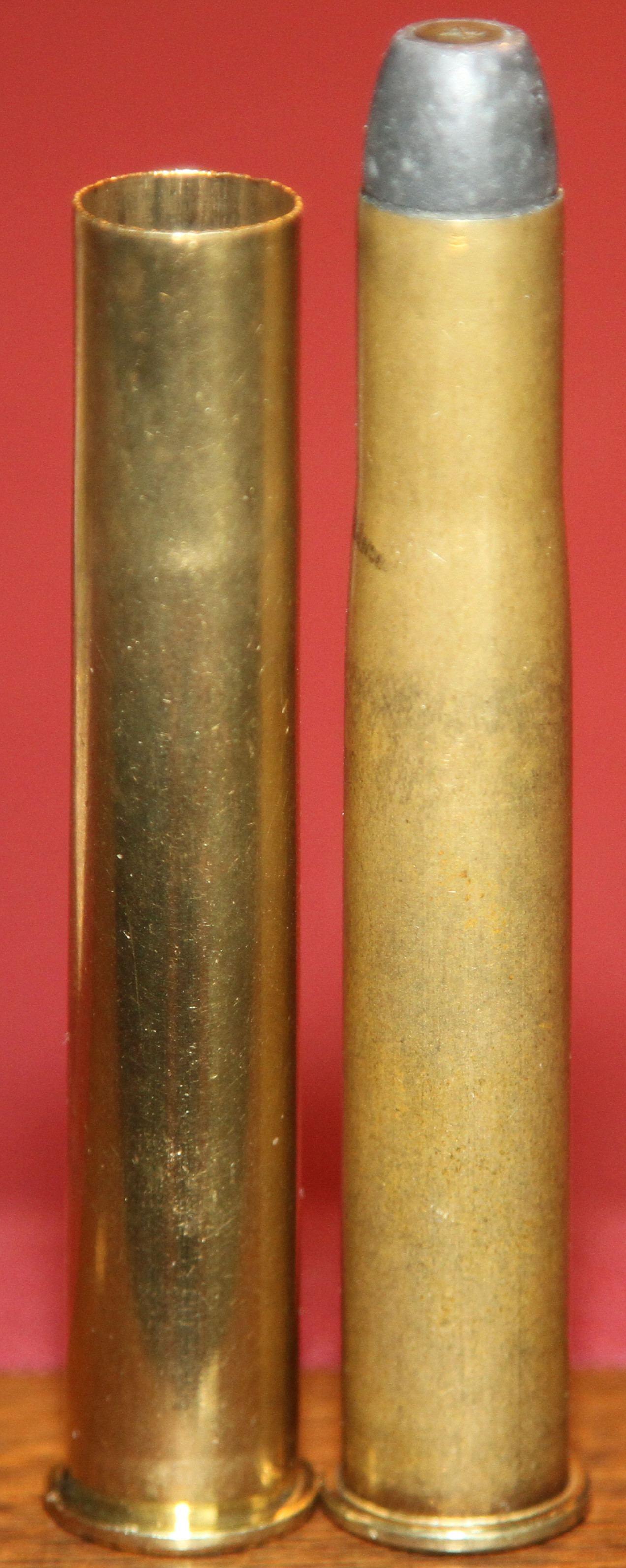

Here is a picture of a 50 3 1/4″ shell next to a 45 EX round.IMG_8013.jpg Next is a picture of a 45 EX sticking into the 50-3 1/4″ case. IMG_8014.jpgHere is how far the
50 3 1/4″ would go into my chamberIMG_8016.jpg

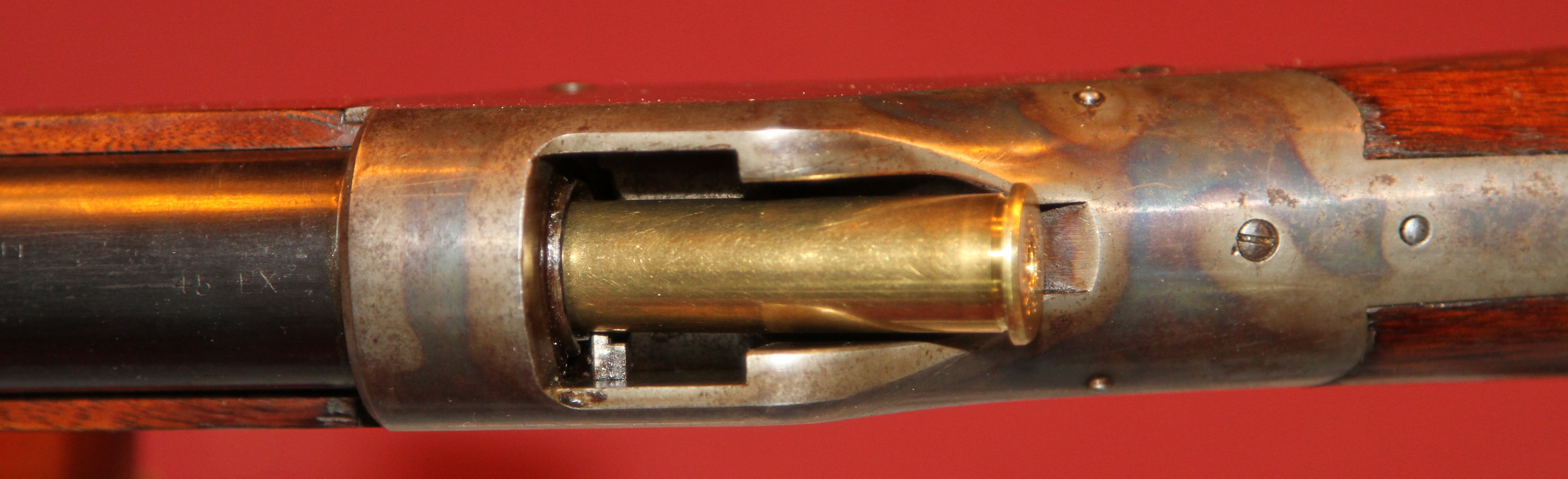

Now after some squeezing is the case as of today.  IMG_8017.jpg  I had to order a couple things to go any further.  I did not and will not use any loading tools to shape the case.  After I fire form a couple cases I will have some dies made.

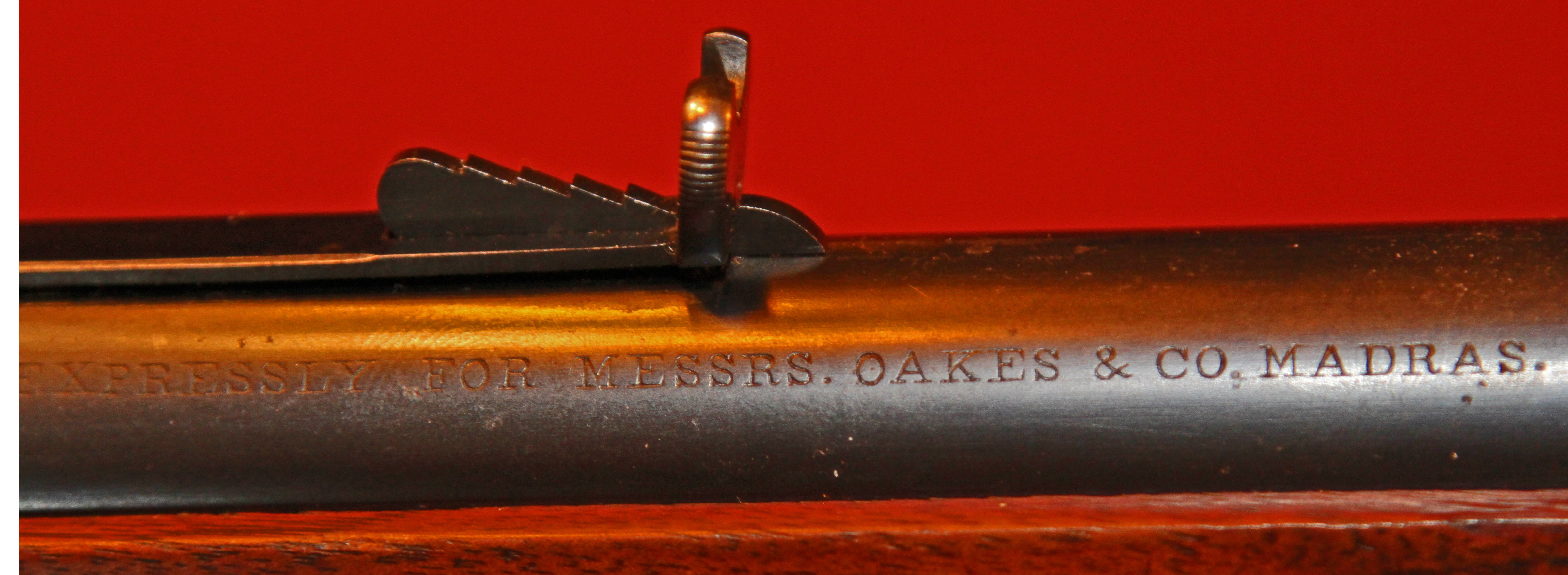

This rifle, according to Bert was one of 5 that went to India in 1887 on the same Order No.  They went to a store in Madras.  Here is a picture of the barrel.

The entire case from the mouth to the rim needs to be sized just to get it into the chamber.  I have not slugged the bore.  I do have a lot of 300 gr. 45 cal bullets in .458″ and .459″ diameters.  Right now I’m doing what I need to do to just shoot the brass a few times.  I sorted the brass and found 2 that the rim was the smallest diameter and actually fit.  The rest are close but will have to be turned.  I also need to figure out the correct shell holder.  I have 2 Forester co-ax presses that use jaws instead of a shell holder.  These come with 2 sets of jaws and each set can be set for 2 different size ranges.  These open up quite a bit and close as the handle is brought down.  I haven’t had time to tear one apart.  I have a custom expander but I need something to grab the case when I try to pull it out.   As you can see I am about 3/4″ from getting the brass into the chamber.  I have to work at each end of the case as I go.  I need to make something to squeeze these areas that’s why I ordered a couple of things.  Considering that I got home from Cody with the brass late Sunday and everyday after I’ve had other duties to fulfill.  I’ve still made some good progress.

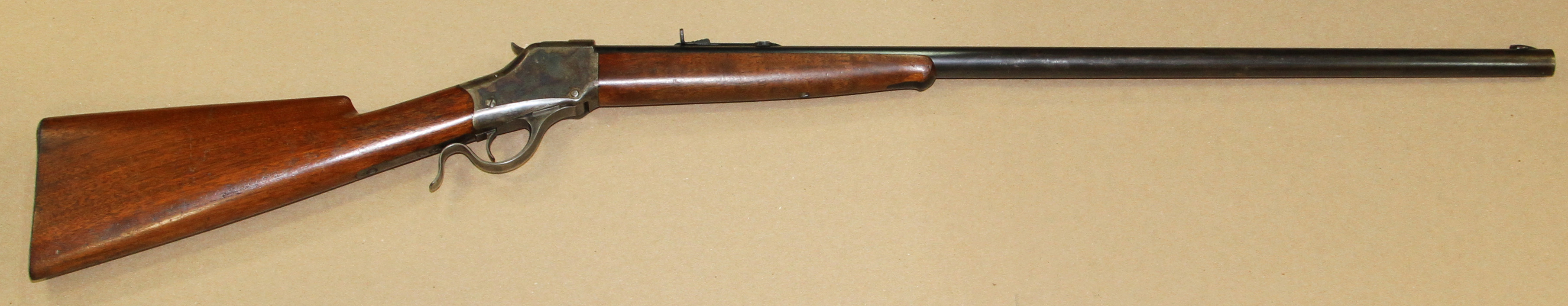

Lets see the whole rifle Chuck! Looks nice from what we can see so far…

July 20, 2025 - 1:53 am
OK, I had to take some pictures for my files anyway.

When you get tired of looking at it, send it my way… I am sure that I can find a good home for it Cool

I might be able to find a use for it if the Texas Legislature passes an open season on T-Rex during their special session starting Monday. Some are not happy about being called back to Austin so anything could happen. Maybe Shrapnel could use it for especially unruly gophers. Looks like it hasn’t been shot much, understandably.

Not sure how much this rifle has been shot but it does have a very good bore.  When I pulled the wood the underside appears to be untouched and very dry.  I may have been the first to remove the stock.  I oiled the metal surfaces, noted any markings and put it back together.  Appears that the butt plate and stock were marked for proper assembly.   Stock was marked 11 and the buttplate was stamped 11.
An interesting side note is that the ledger page that this rifle is listed is full of large caliber rifles.  A hand full of 40, 45 and 50 Ex.  Smallest caliber is a 22 and a 38-90.  About half of the 50 rifles went to the same store in India.  There were 2 50-95’s and the 22 with 26″ barrels and a 45-70 with a 32″ barrel but all the rest were 30″.  We need to do some shopping in Madras, India.
