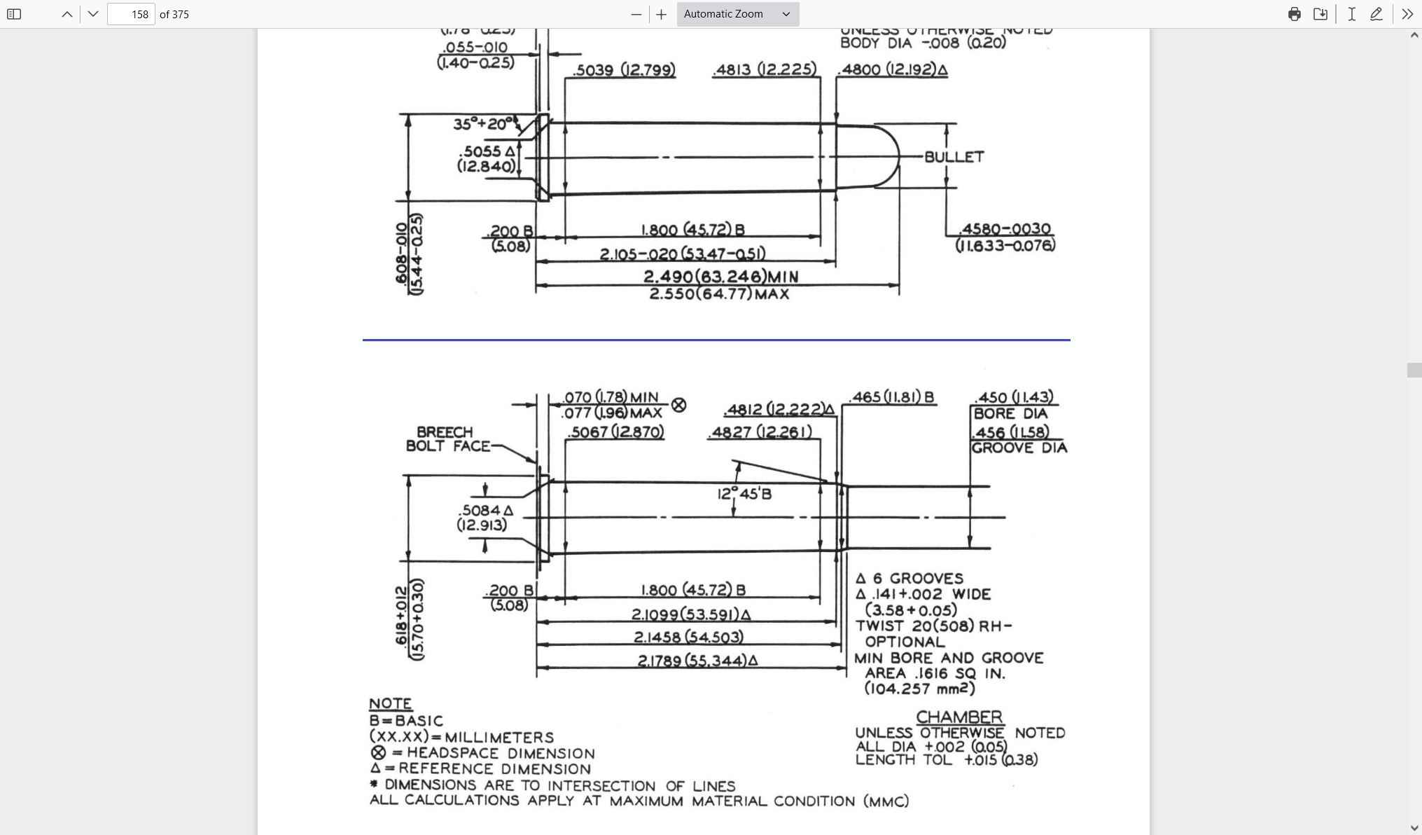

I found a Saami drawing and the Winchester head space is .063″ to .070″.
EDIT:  See next couple of posts.
Forum Posts: 6931
November 10, 2022 - 9:07 pm
I just found another Saami Dwg for Winchester 45-70.  All Win rimmed cases have the same head space.
This one is different that the first one I found.  This one says .070″ to .077″.
Screenshot-2022-11-10-at-13-02-14-VELOCITY-AND-PRESSURE-DATA-ANSI-SAAMI-Z299.4-CFR-Approved-2015-12-14-Posting-Copy.pdf.png
EDIT:   I went back through my last couple posts and removed my comments about the head space.  I was exactly wrong.  .06″ inches is too thin.
