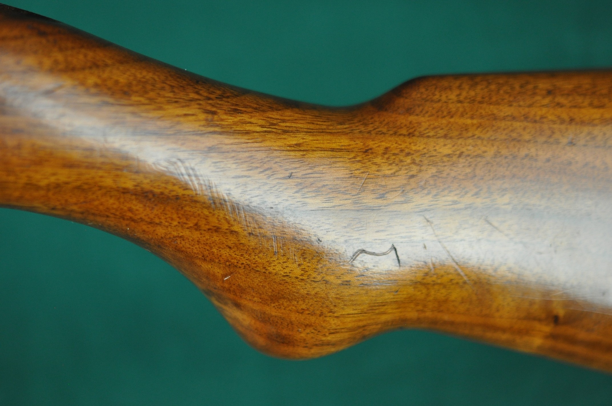

seewin said
Based on the pictures of the inletting, I believe you have a customized factory stock from a later “Speedlock” model 52. This is based on the fact that the inletting around the trigger is much larger than the original early rifles. The reason for the later difference was because the Speedlock triggers required a stamped steel housing, which in turn, required a larger inletted area for clearance. Your stock could either be a modified/customized target stock, or a “let in” stock blank which was sold by Winchester for shooters that wanted to customize their 52 to meet their personal physical requirements. See below for the inletting on #12 which will be the same on all early pre Speedlock rifles.
     Also, your barrel is exactly like #12. I have attached pictures for your comparison. Note that neither barrel has “MODEL 52” in the rollstamp, indicating that the early barrels most likely used Winder Musket barrels, which used exactly the same profile.

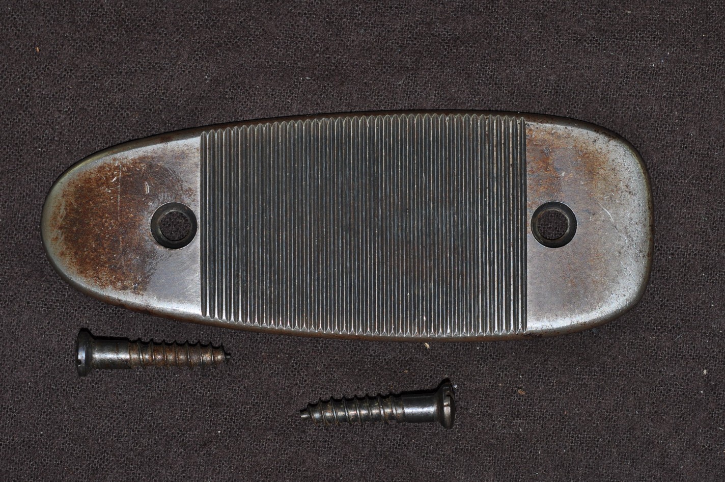

MFoster,
Very nice & cool rifle!
Now that it’s apart, there is some opportunity to do some clean up.
It has been suggested to use a small brass or copper wire brush or wool (pref. copper/bronze wool vs. steel), which will work OK.  A common alternative in the collector community is to use a Big 45 pad to clean up steel parts, and mineral spirits/wood oils for the stock, both followed by an application of Renaissance Wax for long term protection.
There are many threads on the topic both here and at Rimfirecentral.com, and a few different opinions as to the very best approach, but most work pretty well; just don’t get carried away!  Here’s a thread to get you started:  https://www.rimfirecentral.com/threads/winchester-model-52.1240615/

Thank you everyone for the info,  lots to go on.  I cleaned the small parts today.   It seems the wax is the way to go and is safe for both metal components as well as the stock.  I will order some of the wax for the final touch.  Once I reassemble I’ll get it out to send some rounds down range.  Any suggestions on ammo, I have a  large mix of standard bulk as well as some various match and target rounds,  I typically shoot till I find what the rifle likes best,  but if there is a round that is commonly liked by the 52 I can narrow the work down a bit.  Please let me know if any additional pics are needed.  Once I get the rifle cleaned up and reassembled I’ll send some more as well as some groupings.   Thanks again for all the info.

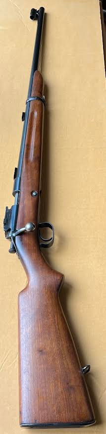

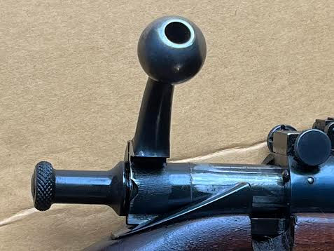

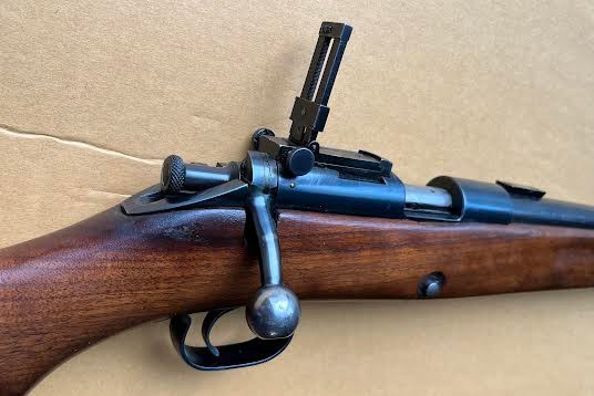

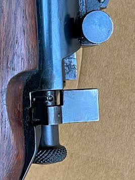

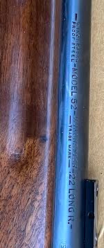

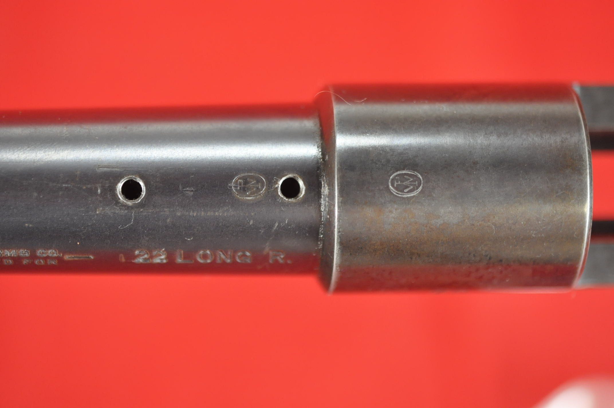

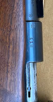

Number 118 is an interesting rifle. I question why it has proofmarks on the LH side of barrel and the receiver. On a rifle this early, they should be both be on the top side of the rifle. Winchester started putting the barrel proof on side of the receiver around 10XXX. Early in production, Winchester moved the barrel proof to the LH side, but only about 45 degrees down from previous vertical location. This was to prevent it from being hidden by the rear scope blocks when supplied. The receiver proof remained on the top side. At about 10XXX, both proofs were moved to the more familiar location seen on later rifles. #118 has the much this later proofmark location. DSC7478.JPGDSC_4177.JPGDSC_4155.JPGThe stock looks to be off a much later rifle as well. The end of the pistol grip should be almost round on an early rifle up to about s/n 3000. The buttplate should have horizontal lines only also. See below.

Steve,
Additionally, the barrel on S/N 118 is marked “PROOF STEEL”, indicating it is a post 1931 production piece, and approximately 12-years too late for the rifle in question.

Steve,
Bert, the earliest Proof Steel barrels I have seen on 52’s are dated “31” and in the 21xxx serial number range.
Steve

August 17, 2026 - 2:31 am
seewin said
Steve,
Steve
OK, that is good to know.  On the center fire rifles and shotguns, the Proof Steel barrels are all marked “32” or later.
That stated, Model 52 serial number 118 should not have a “PROOF STEEL” barrel on it (unless it was rebarreled at a later time).

Since I am working on the Model 56/57 book today I will add my .02 cents to the “Proof Steel” discussion.  FWIW, The Model 57 barrels were made from Winchester Proof Steel commencing mid-1931 and the barrel roll-marking was changed to reflect the new material commencing at serial number 23851 (23850 is NOT marked proof steel).  As usual, there is a bit of an overlap to use up the existing barrels, but in this case the survey does not show many.  All 56/57 barrels made after June, 1931 were made with Winchester Proof Steel.
This coincides with Steve’s observations on the 52, which are always pretty accurate 😉

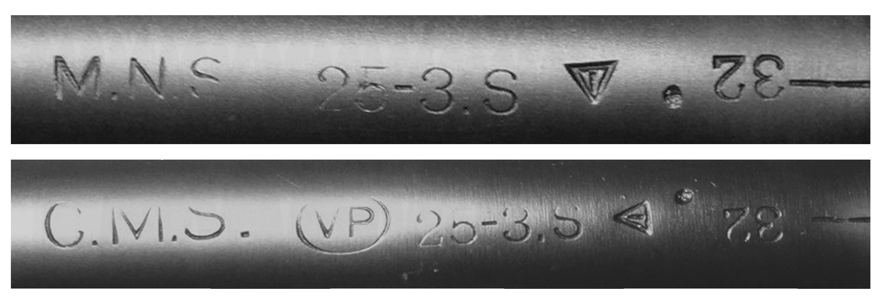

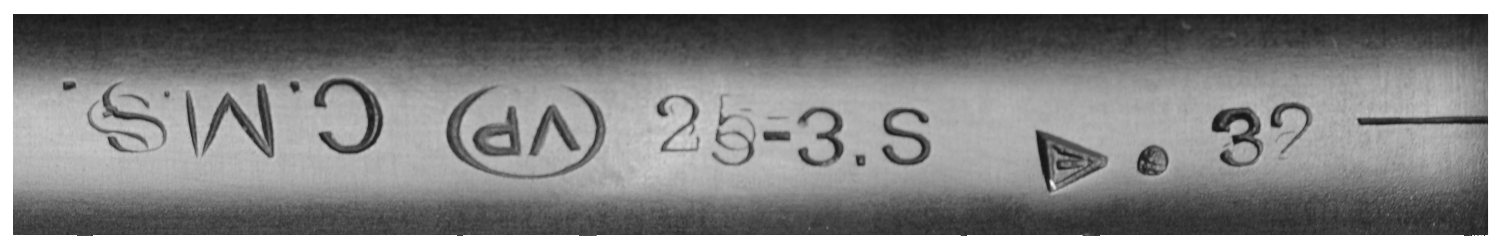

The M54 the nickel steel barrels (that say “NICKEL STEEL” in the exposed roll marking) usually have a steel/foundry identification stamp under the chamber. Early M54 proof steel barrels were also commonly stamped, but the practice was soon abandoned.
So here are three ’32 dated PROOF STEEL barrels in 250-3000 Savage.  These are all on M70s, which is not uncommon for 250 Savage.  Apparently they made a lot more 250 Savage barrels than they were able to sell on M54s and they can turn up on M70s as late as 1946 (fourteen years late!!!).
Two of these ’32 date barrels are stamped “C.M.S.”, which I believe Steve says stands for “Crucible Moly Steel” for the foundry and type of steel.  But what’s going on with the first one that’s stamped M.N.S. which would be “Midvale Nickel Steel”?  All three barrels are marked “PROOF STEEL” and have the correct integral forged front ramp.
I’ve never seen “M.N.S.” on a M54/70 barrel.  Did they make any of the later M54/70 style barrel out of Nickel Steel, as the “M.N.S.” would imply, and stamp them “PROOF STEEL”?  Is this an error in the under chamber stamp?  Or am I just confused (as usual)??? Laugh

Lou,
First, the underbarrel markings were applied well before the roll marking on the exposed side of the barrel.
My bet is that the “M.N.S” marked barrel is an incorrectly roll marked Model 54 Nickel Steel barrel.
This is of course just my opinion.
80
August 17, 2026 - 4:39 pm
Lou,
The “M.N.S.” & “C.M.S.” are hand stamps along with the other under barrel markings. So easy enough to grab the wrong stamp.
I have some of these stamps. I do need to look through my research and see what means what.
I suppose the only way to truly know is that you would have to somehow test the metal between the two stamped barrels and see how / if they differ.
Good luck with that!
