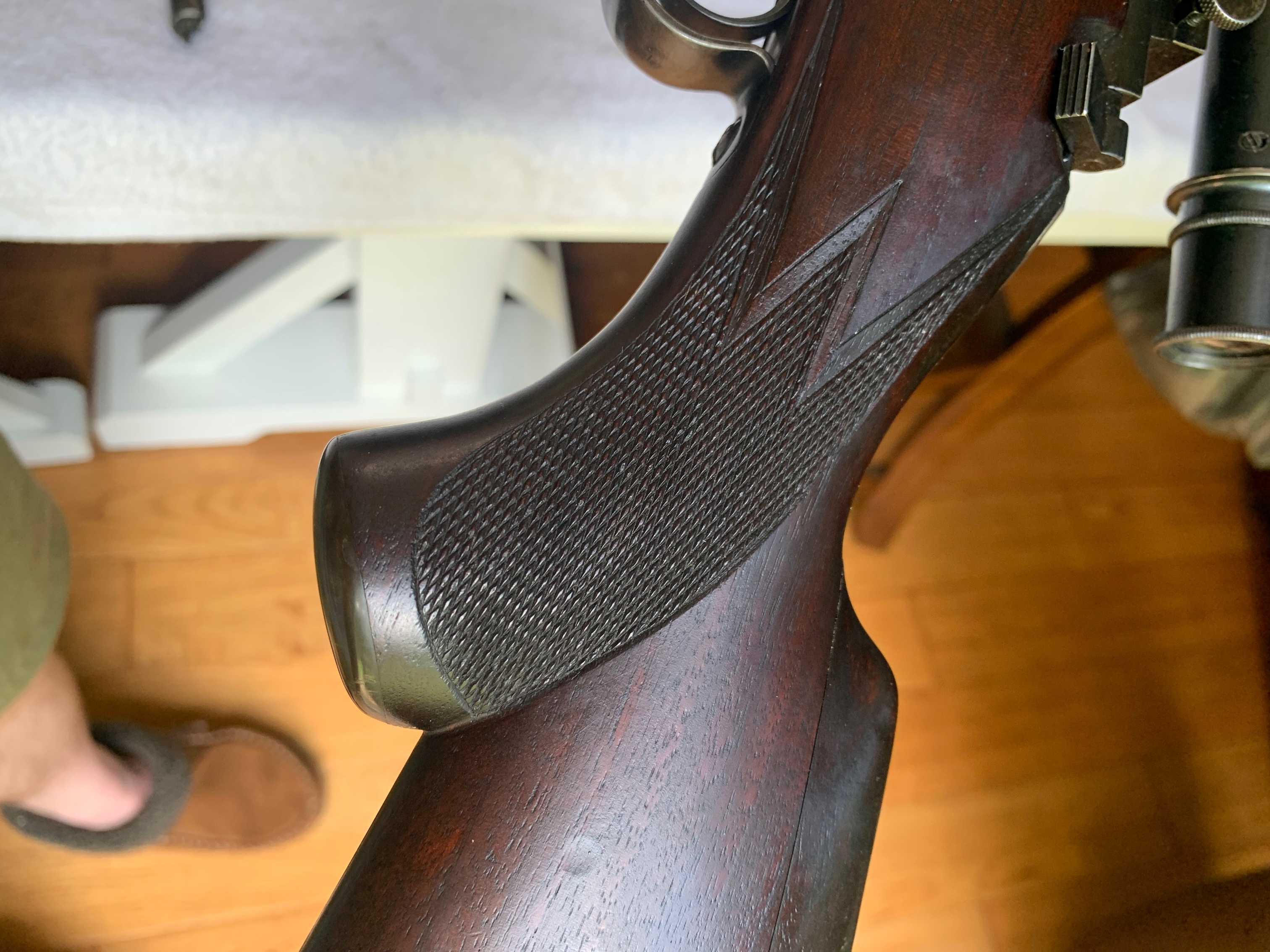

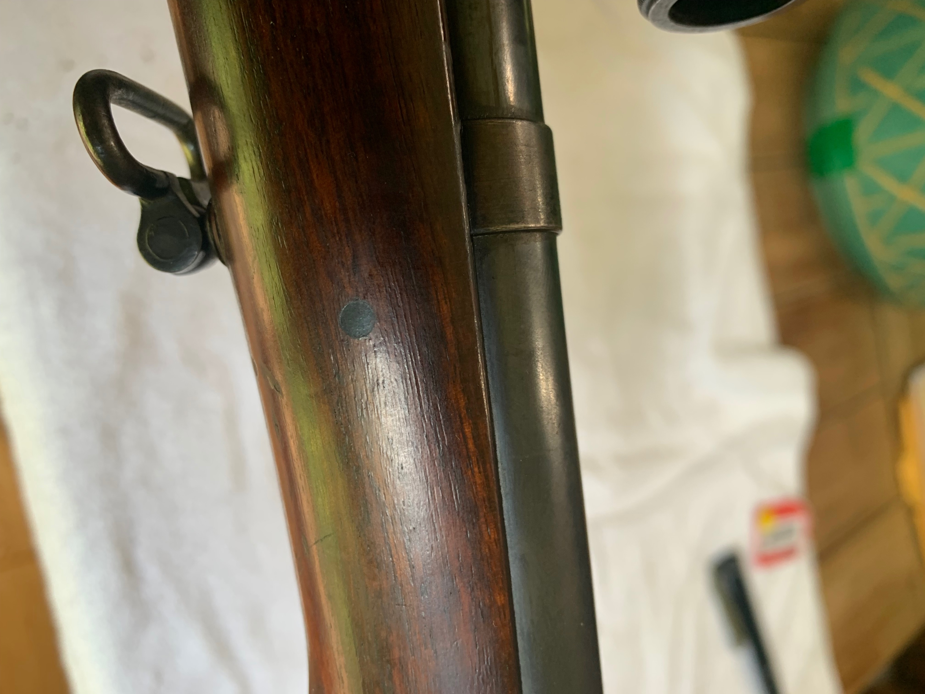

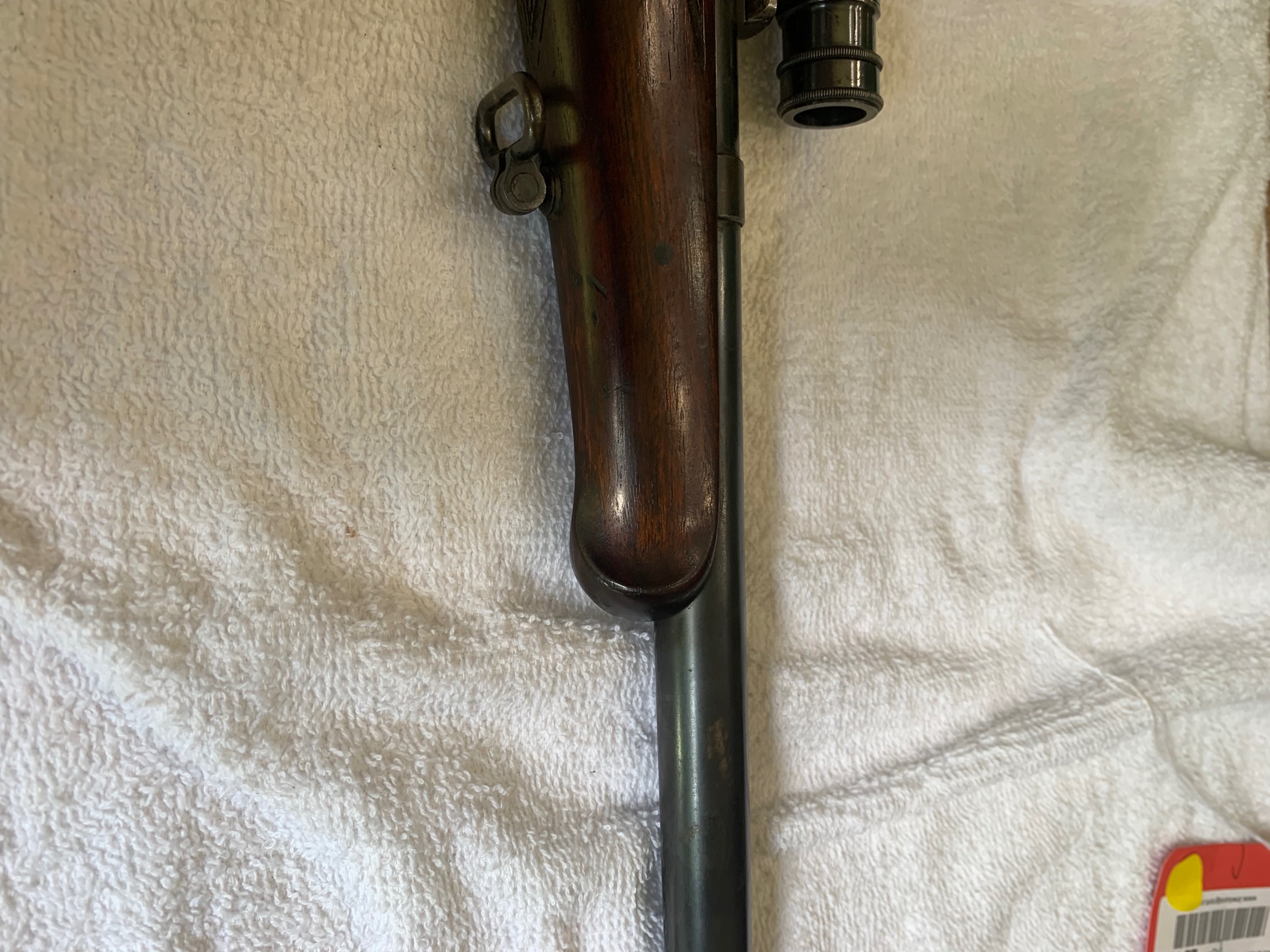

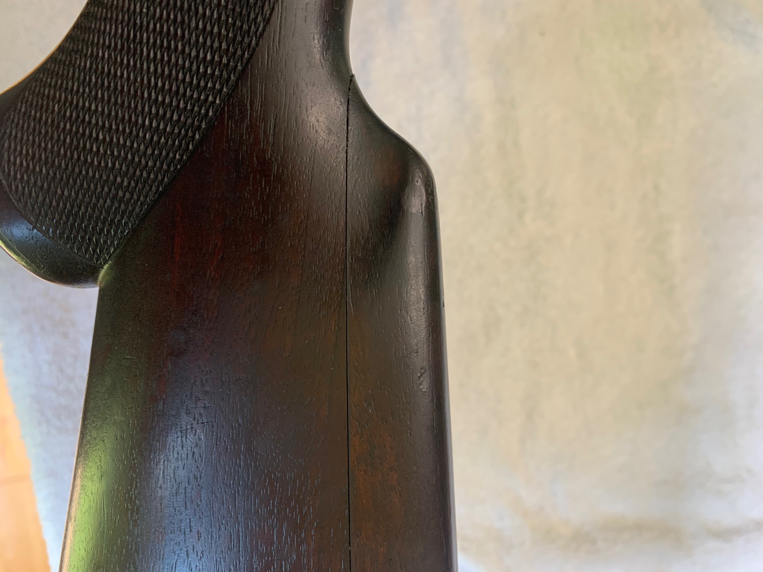

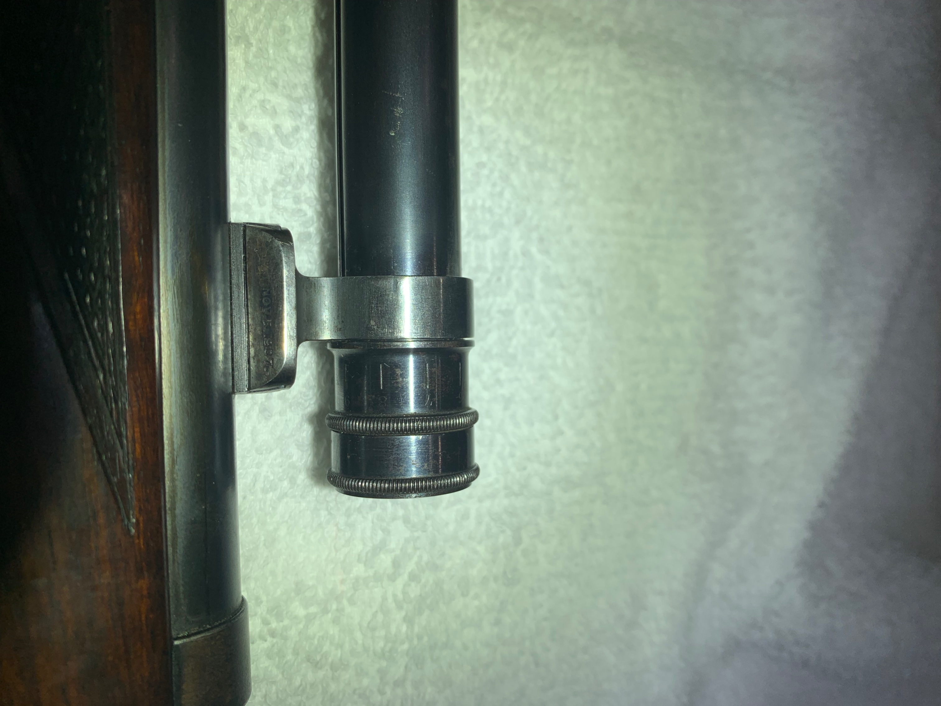

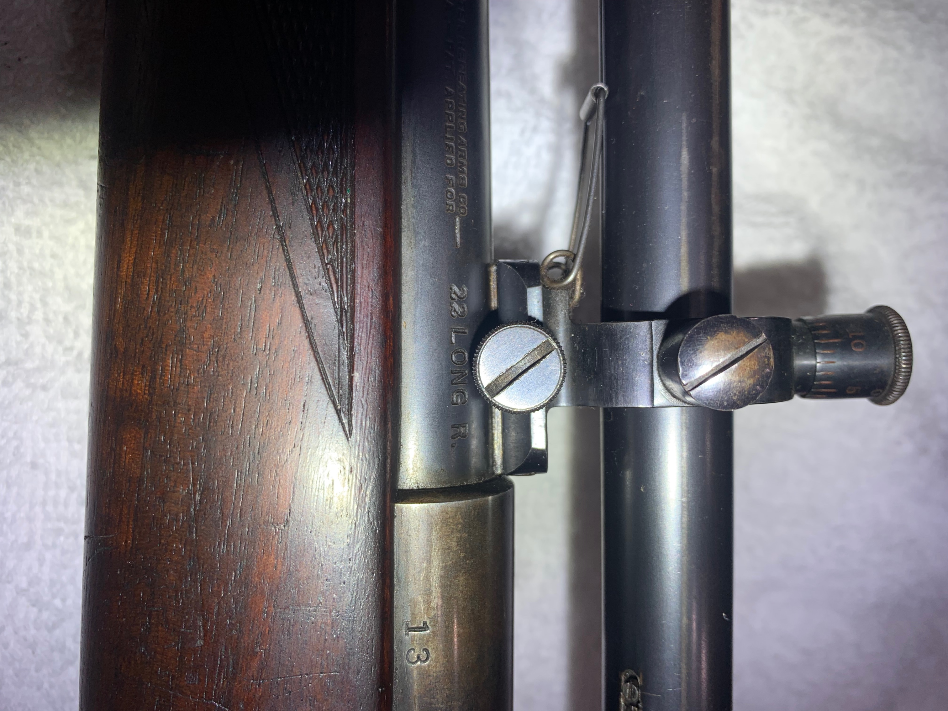

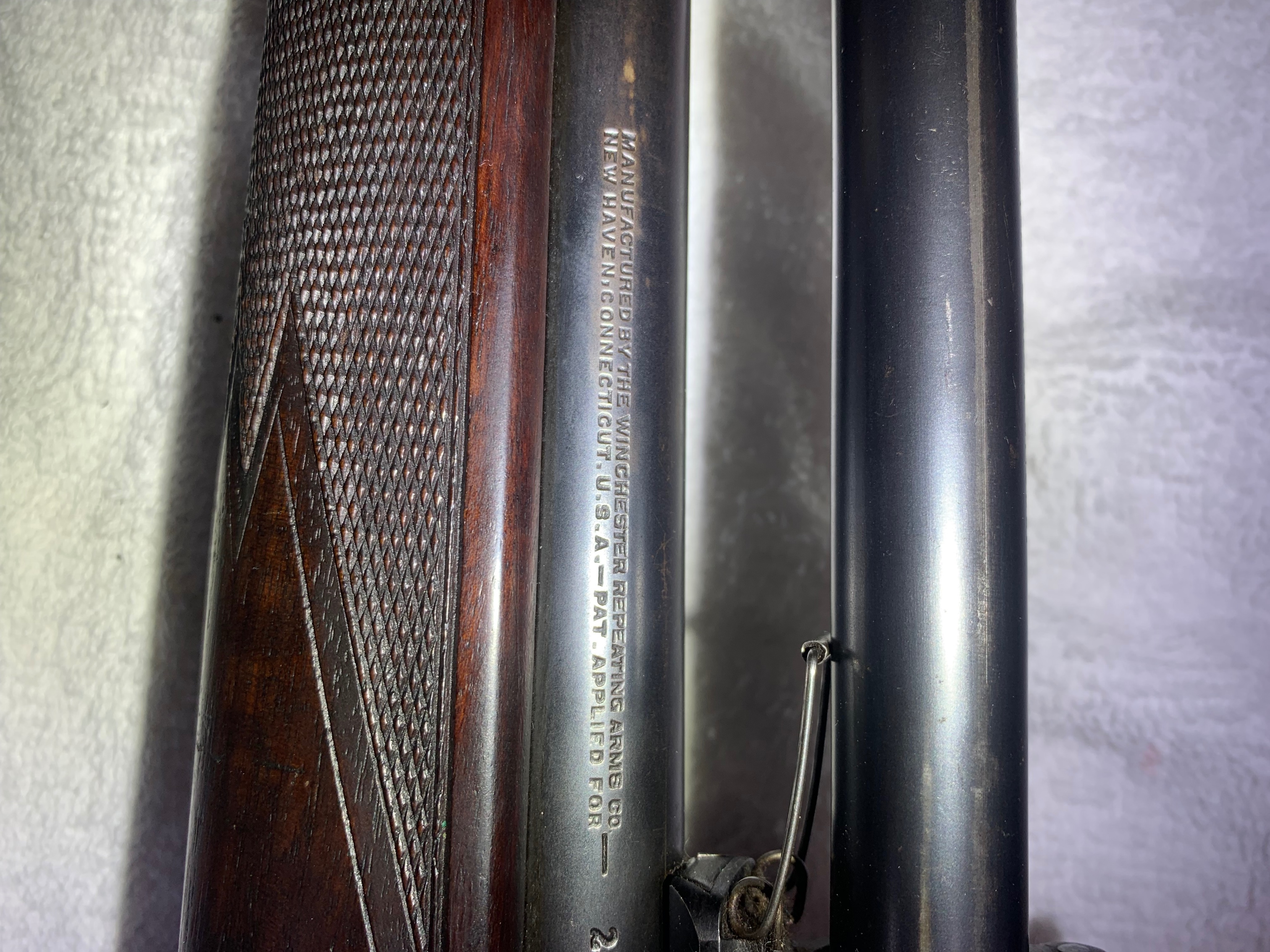

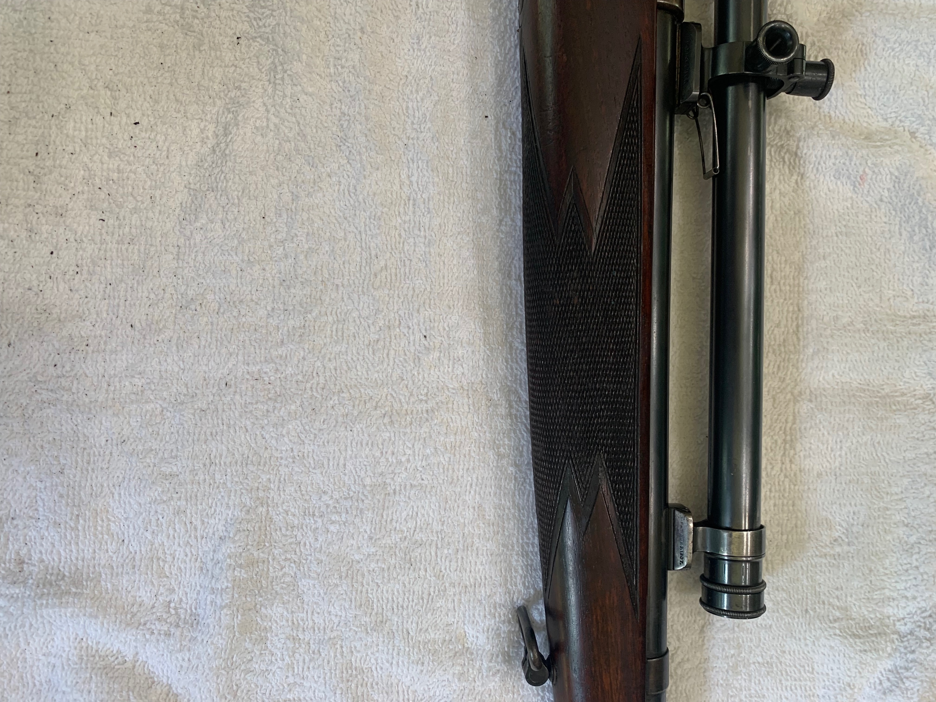

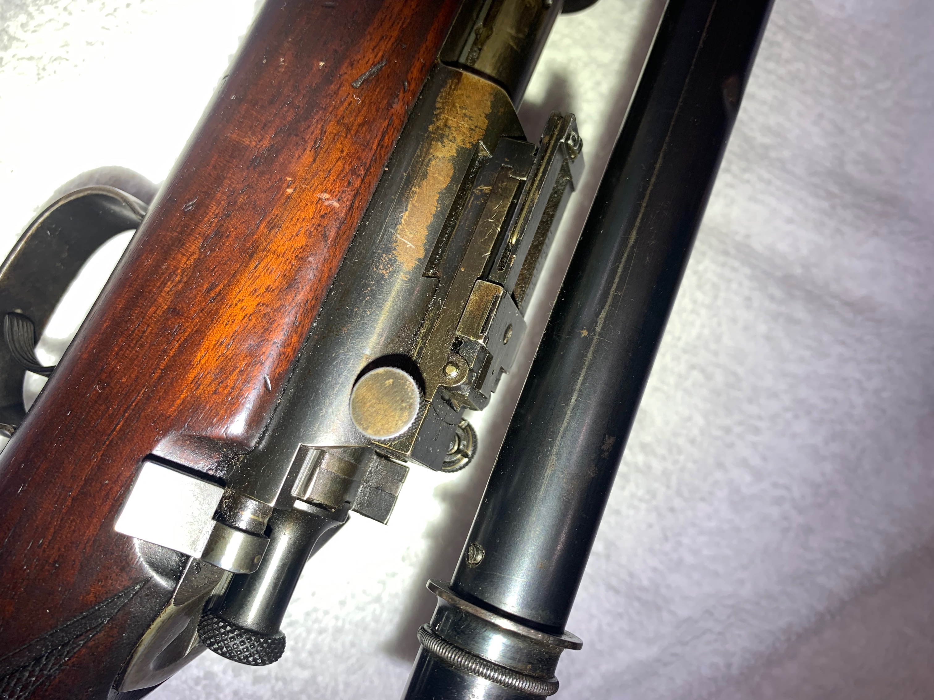

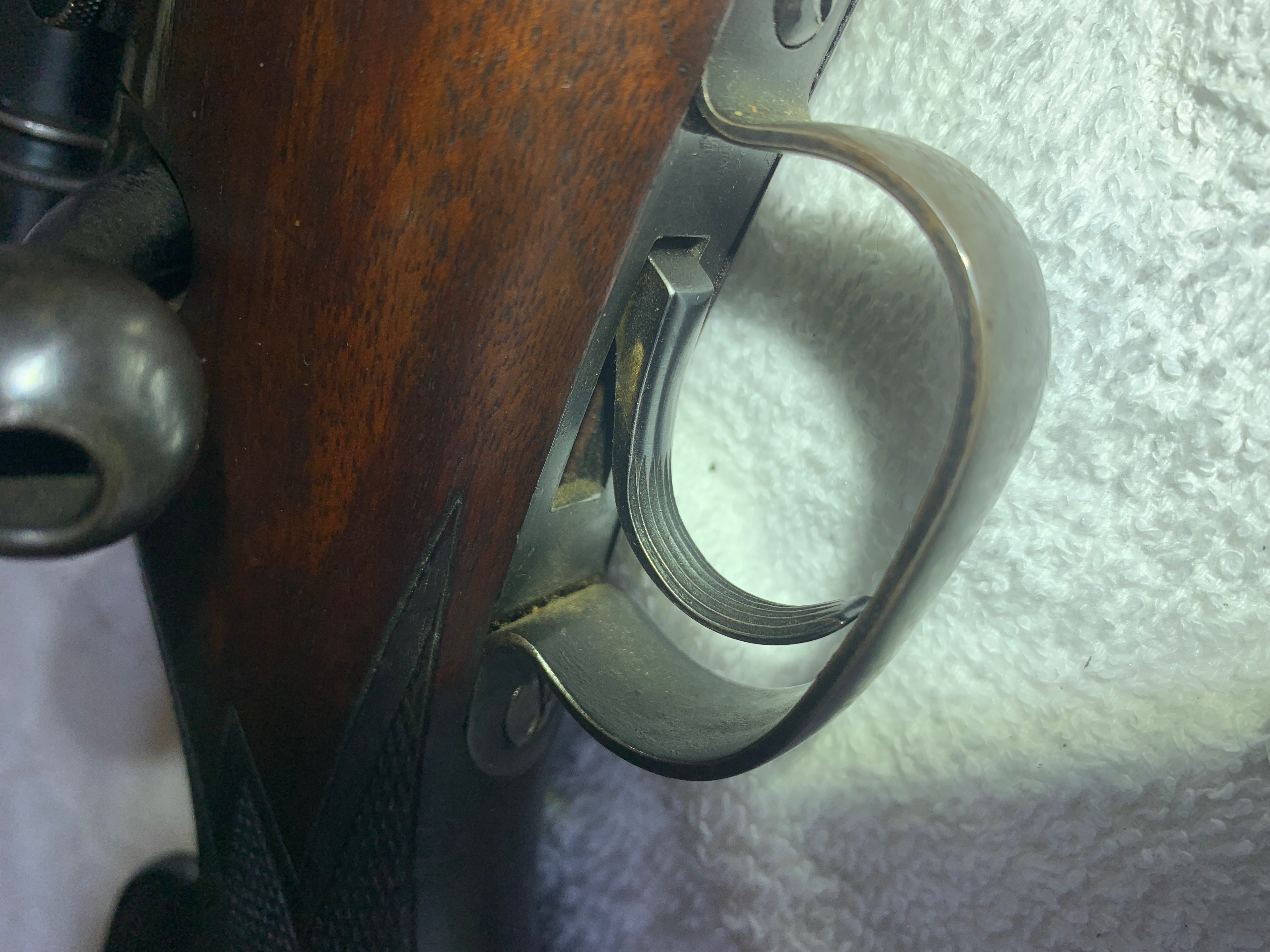

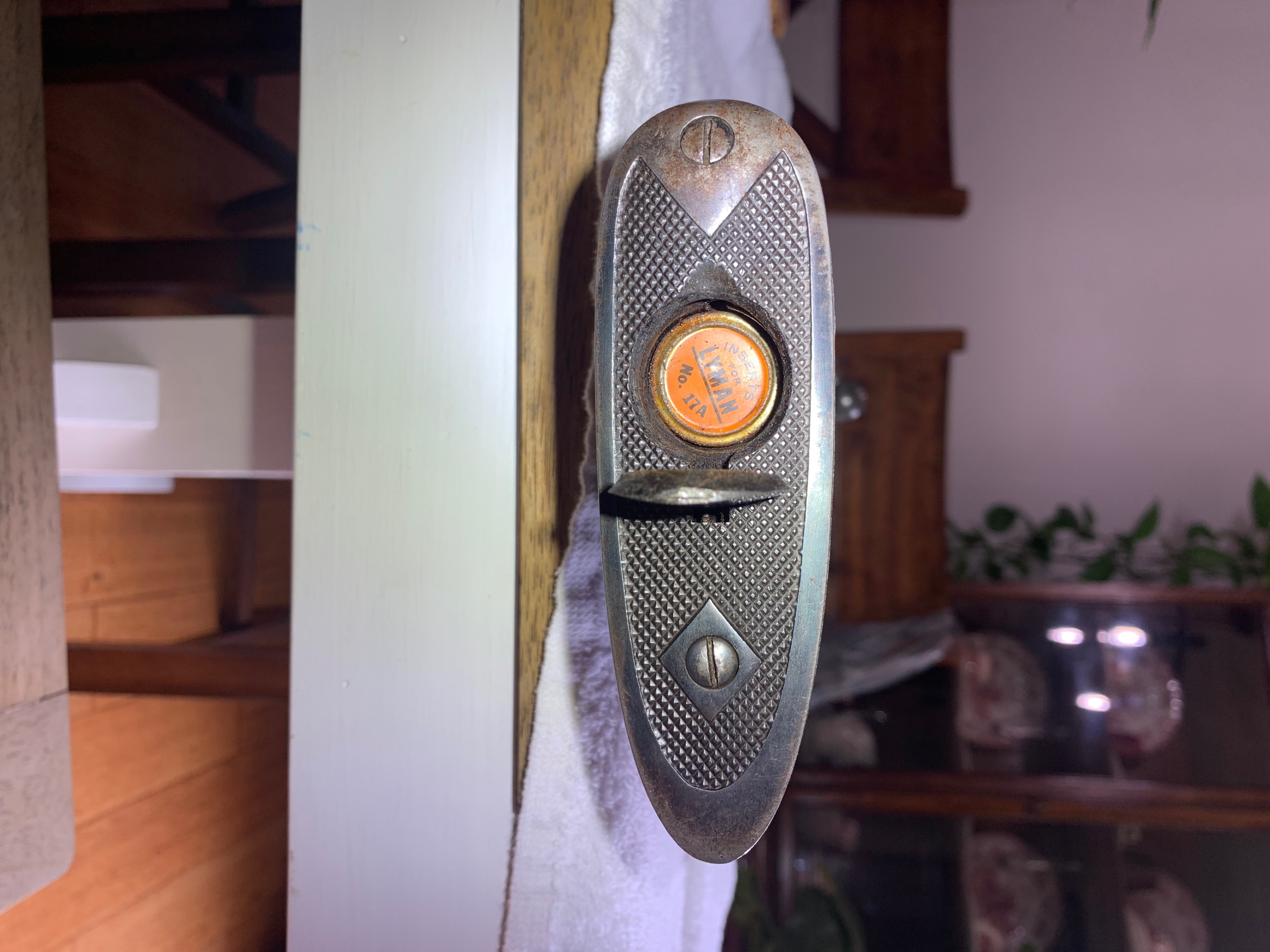

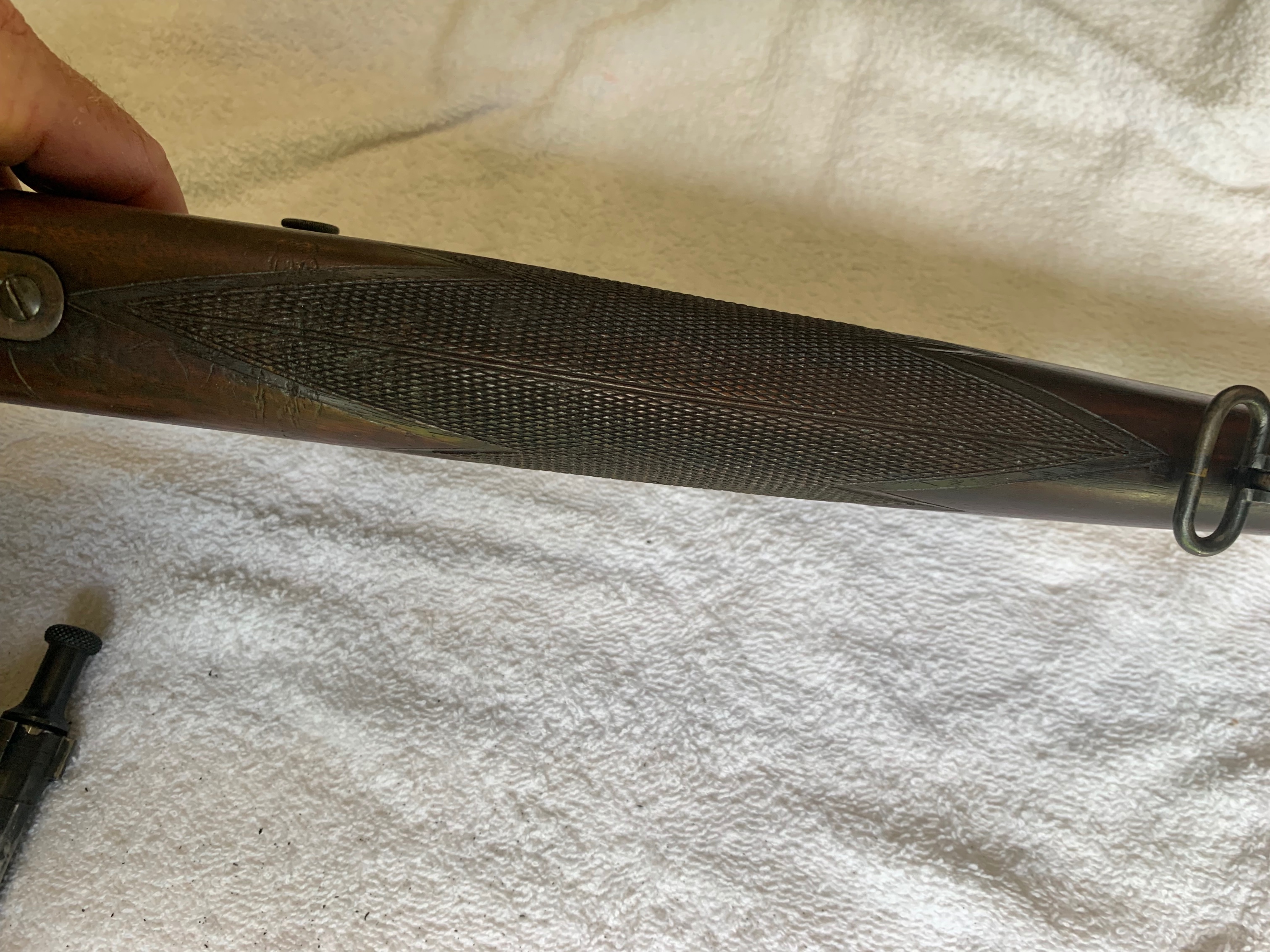

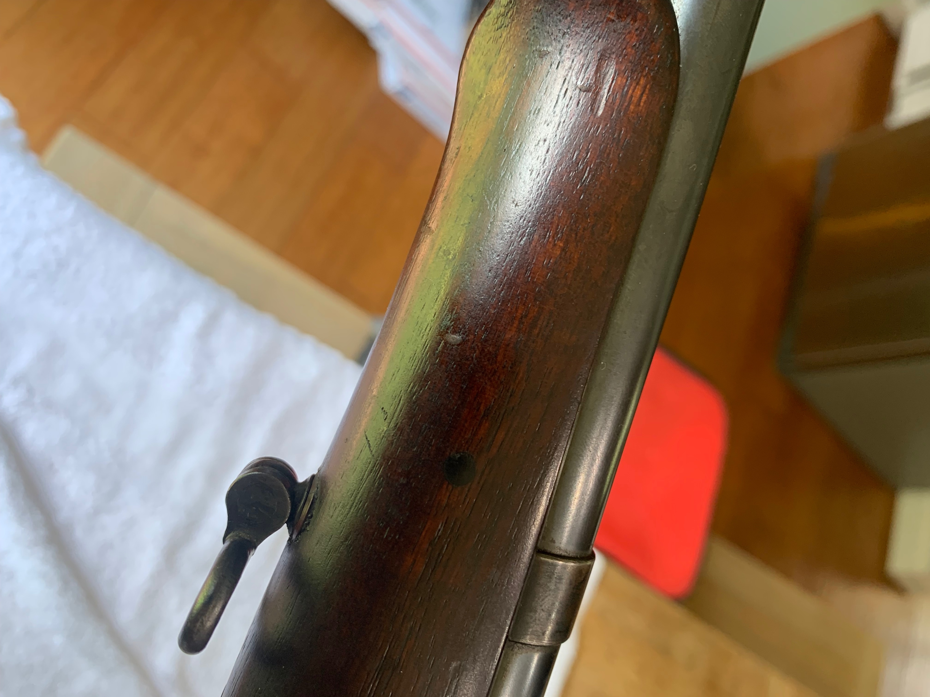

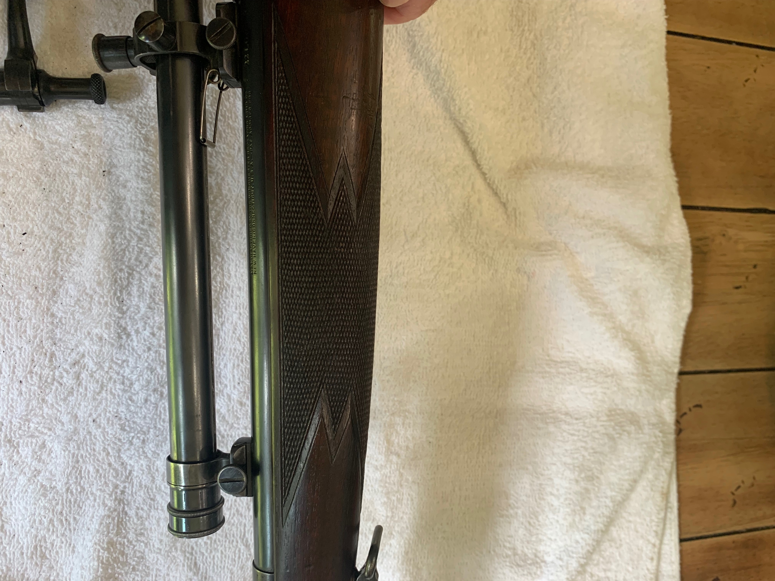

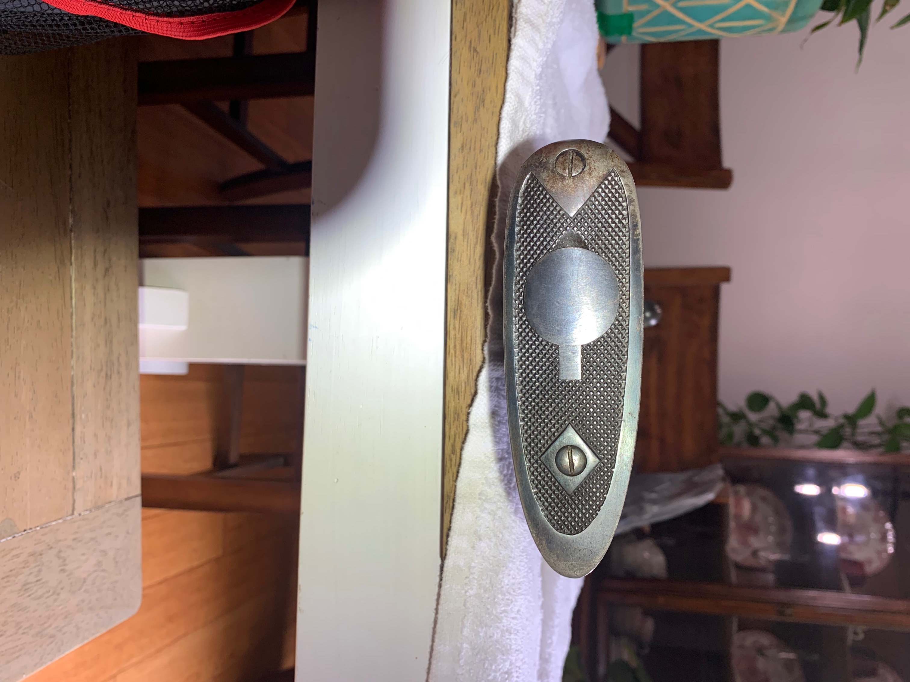

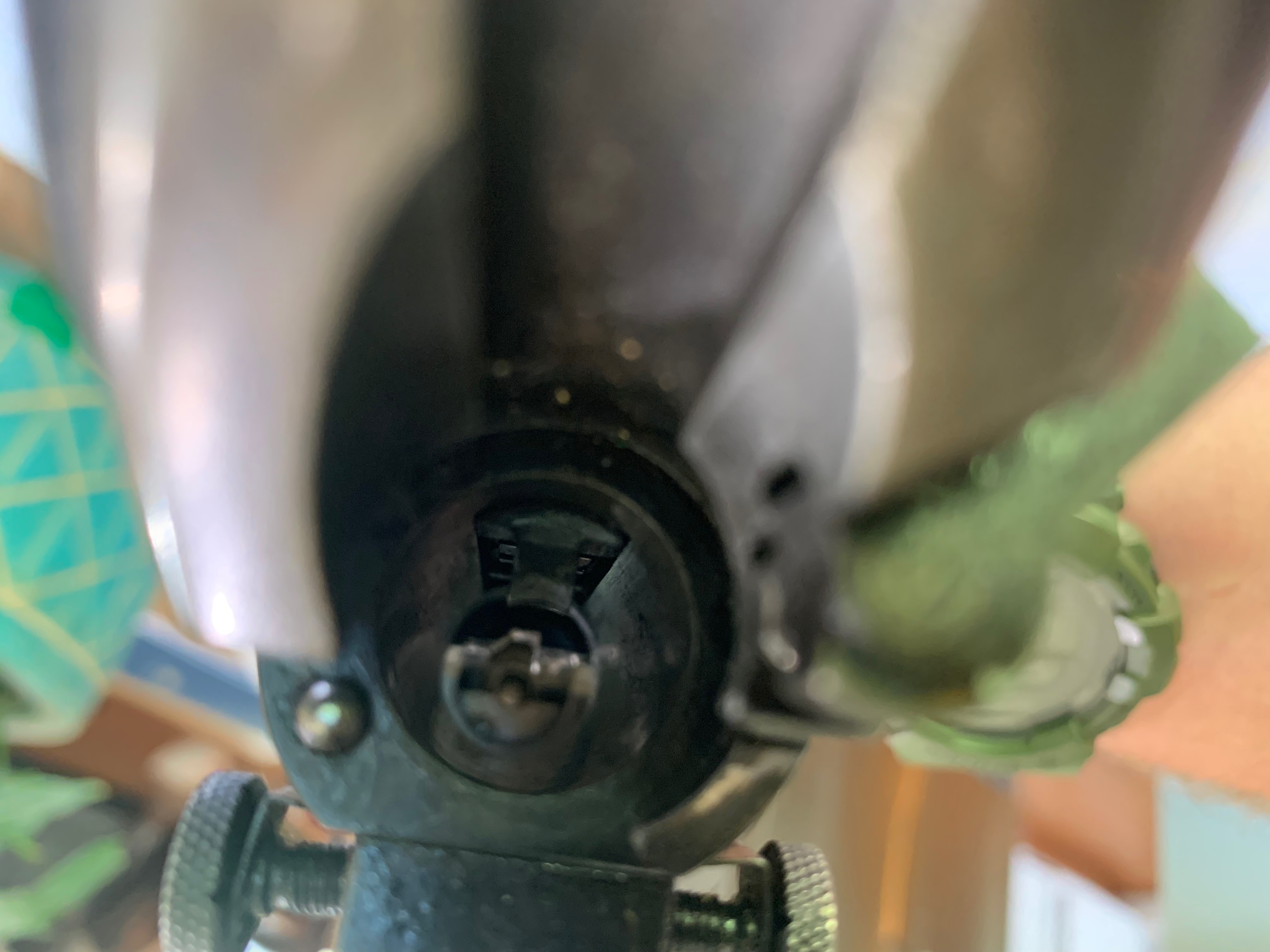

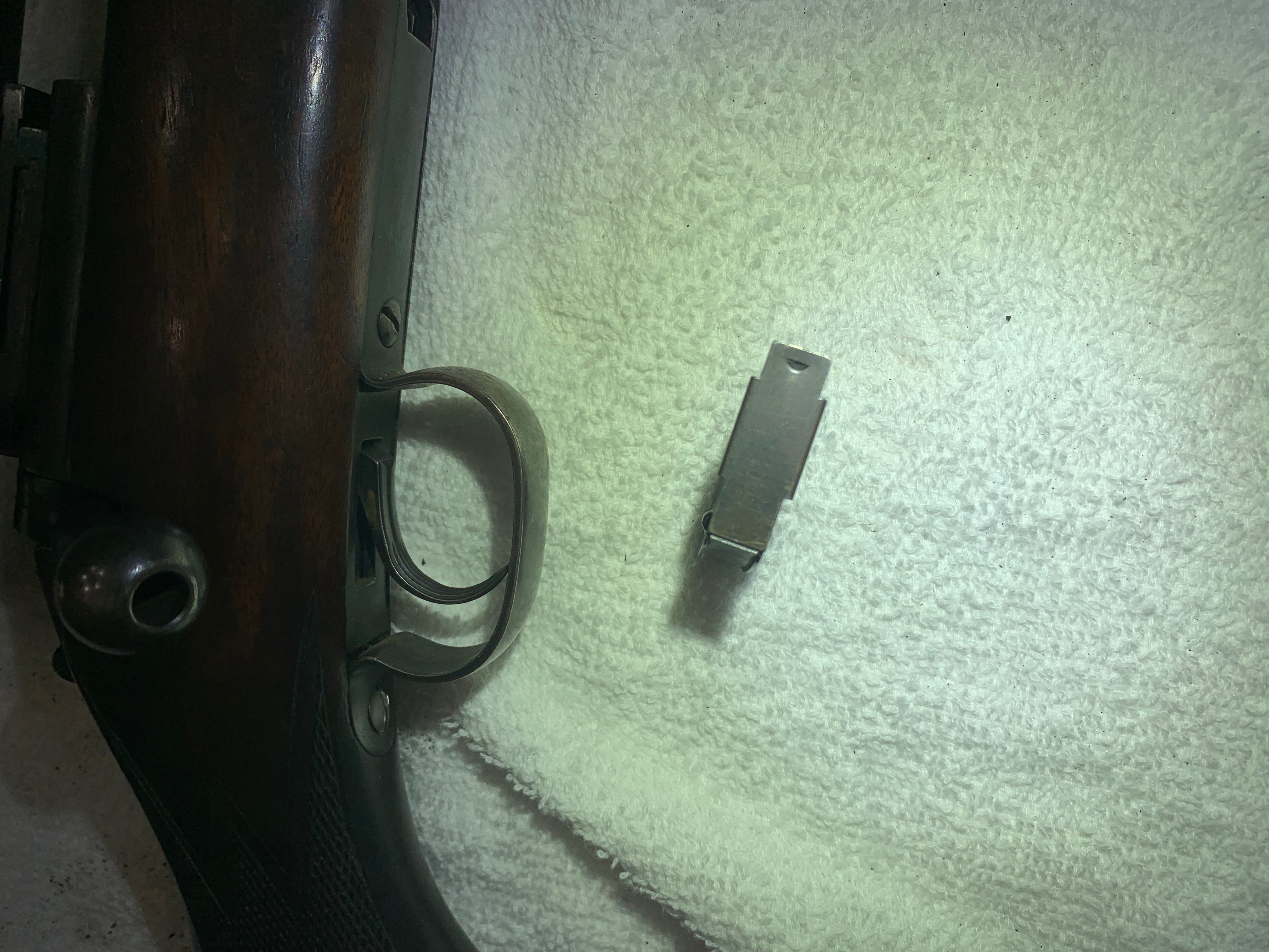

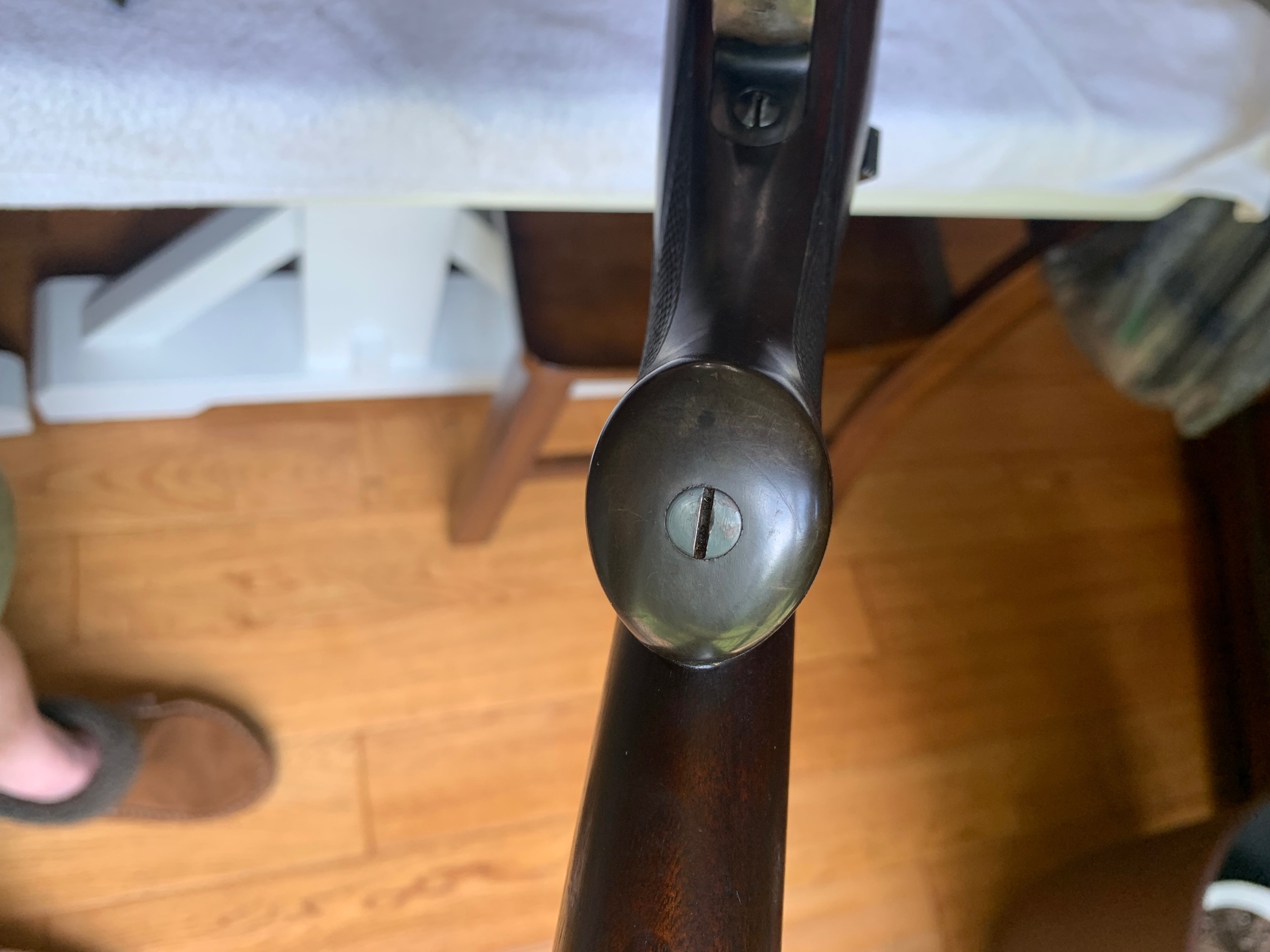

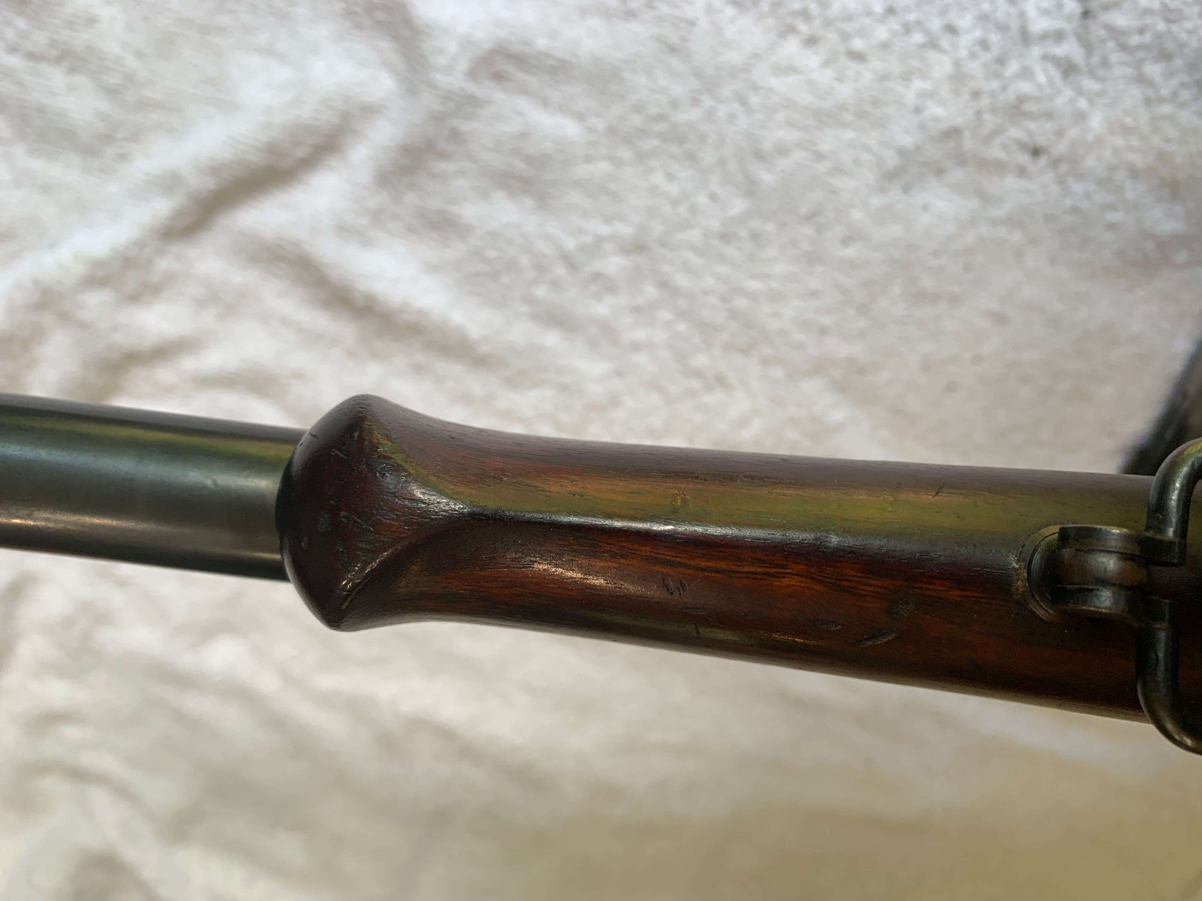

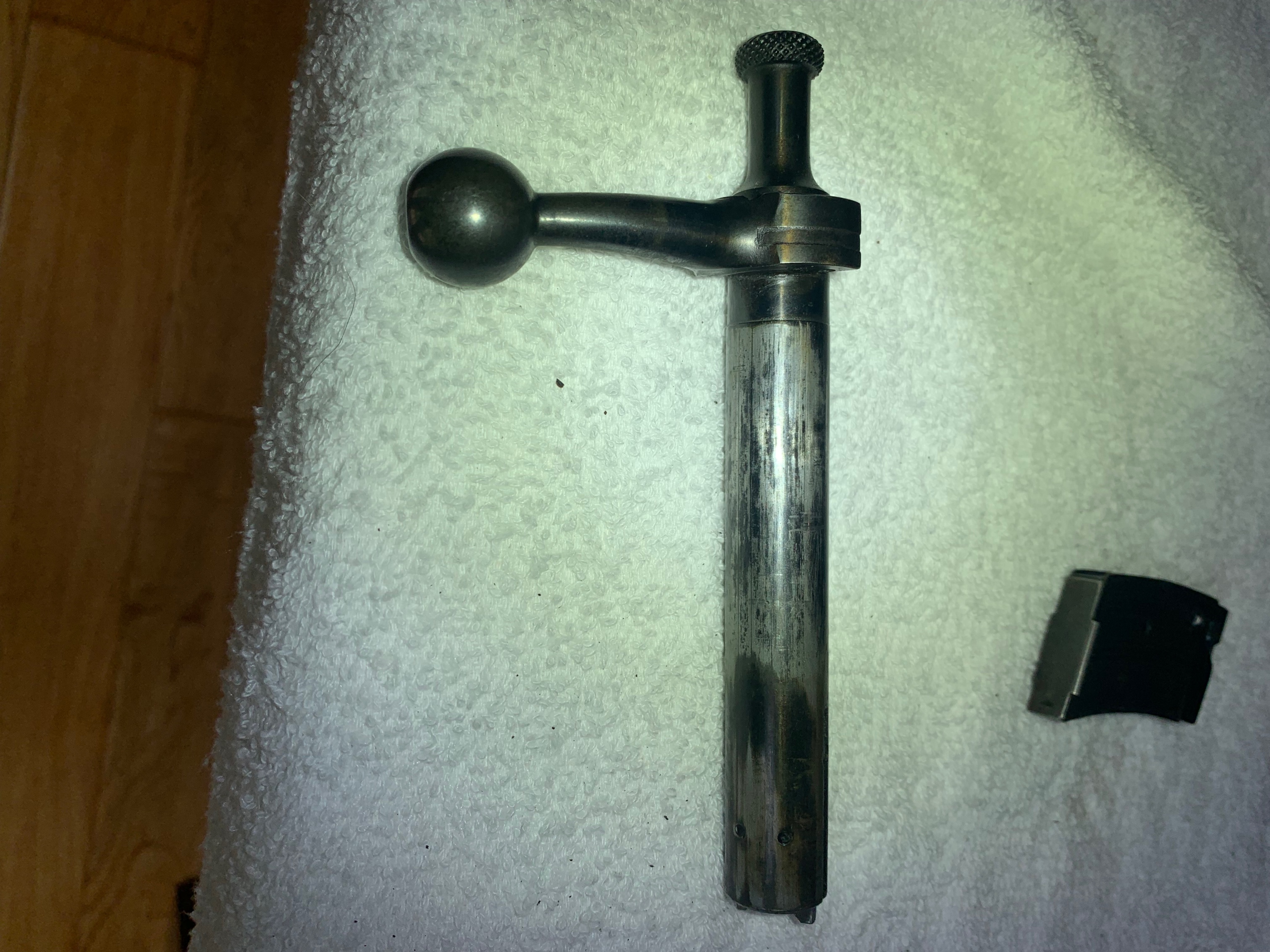

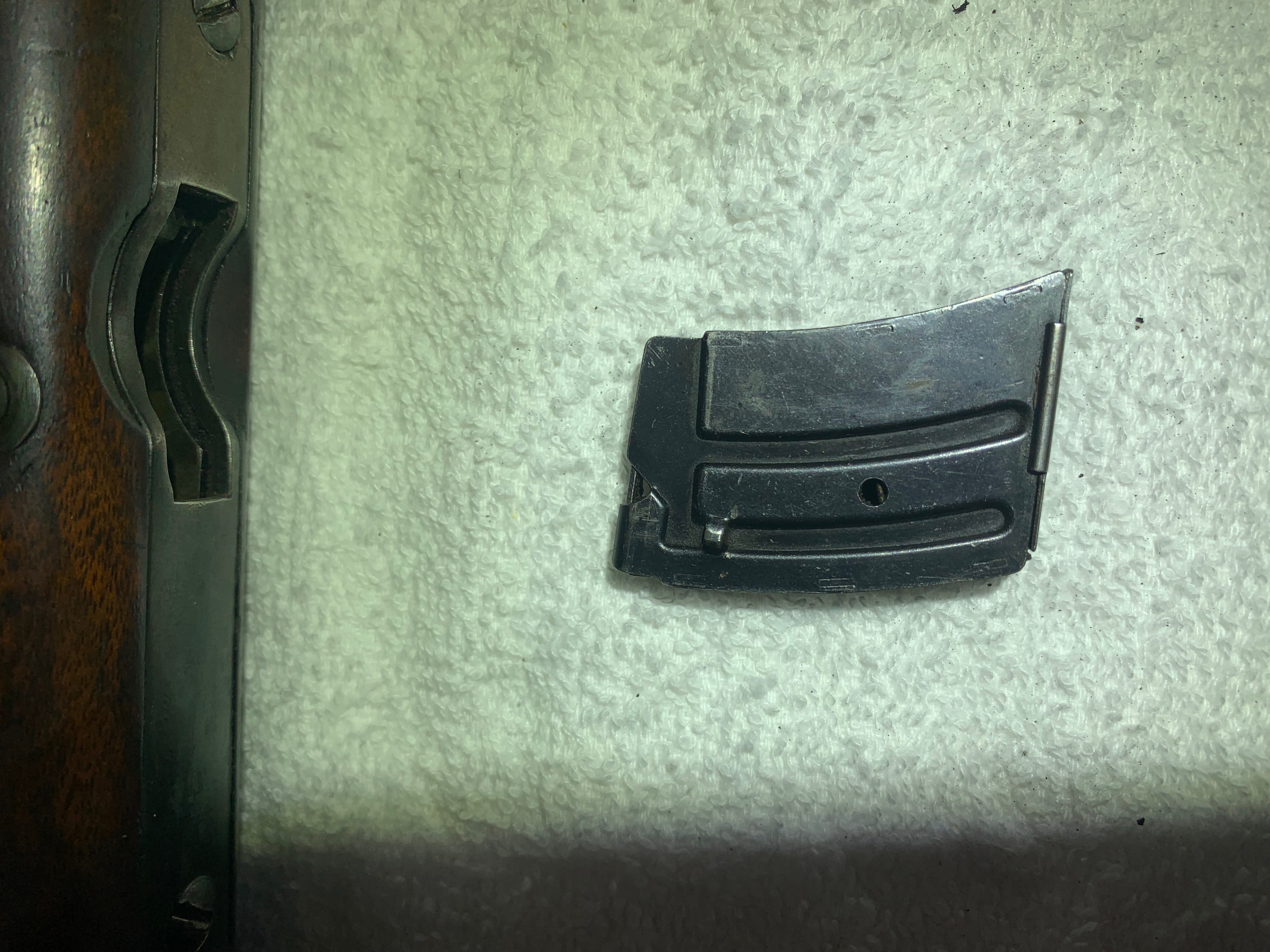

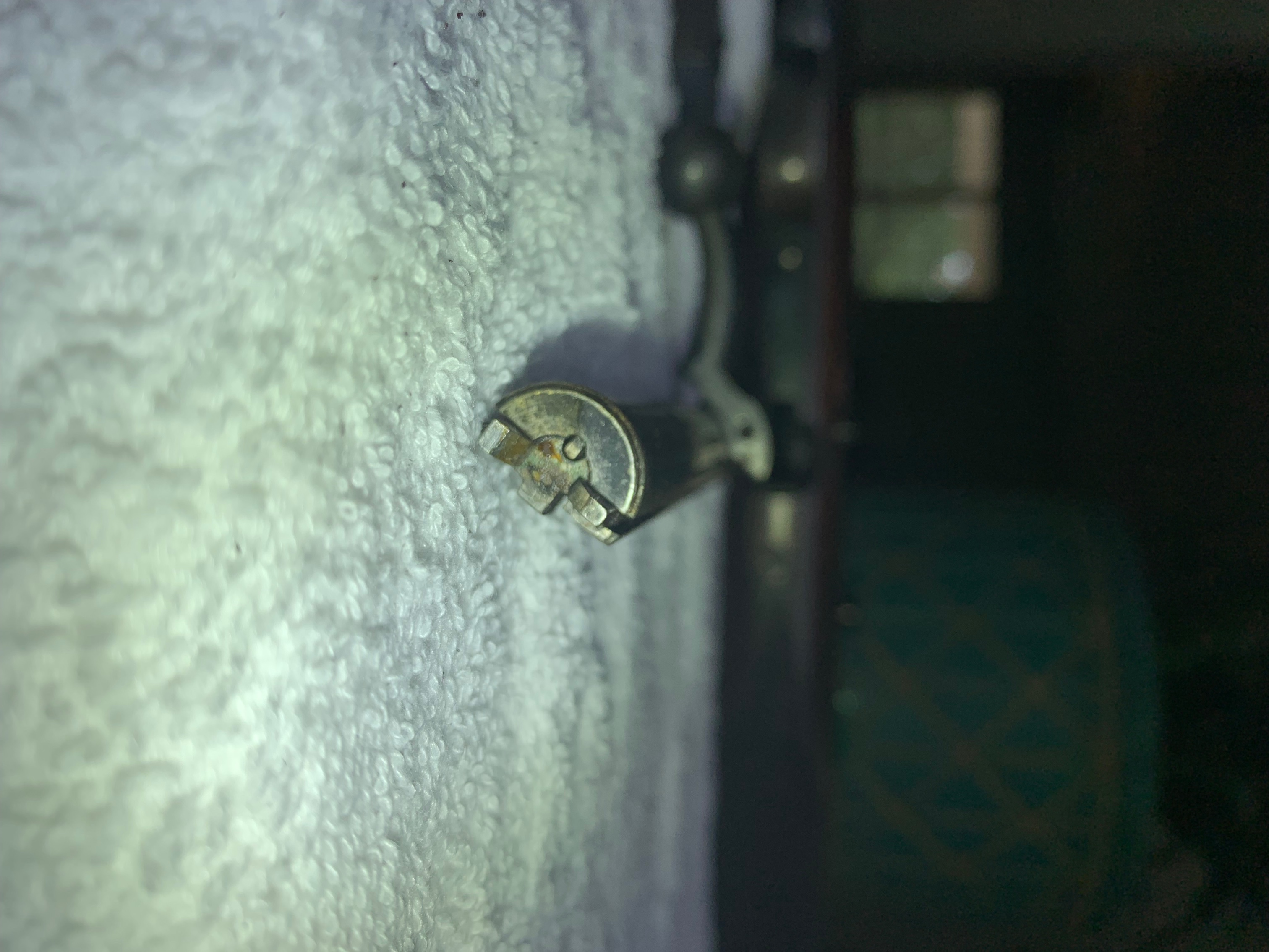

Not the best pics but will have to do for now.  I was surprised to find the sight inserts in the trap on the buttstock,  however they seem to be stuck currently.

That’s a very nice rifle with a host of custom touches. I like it.

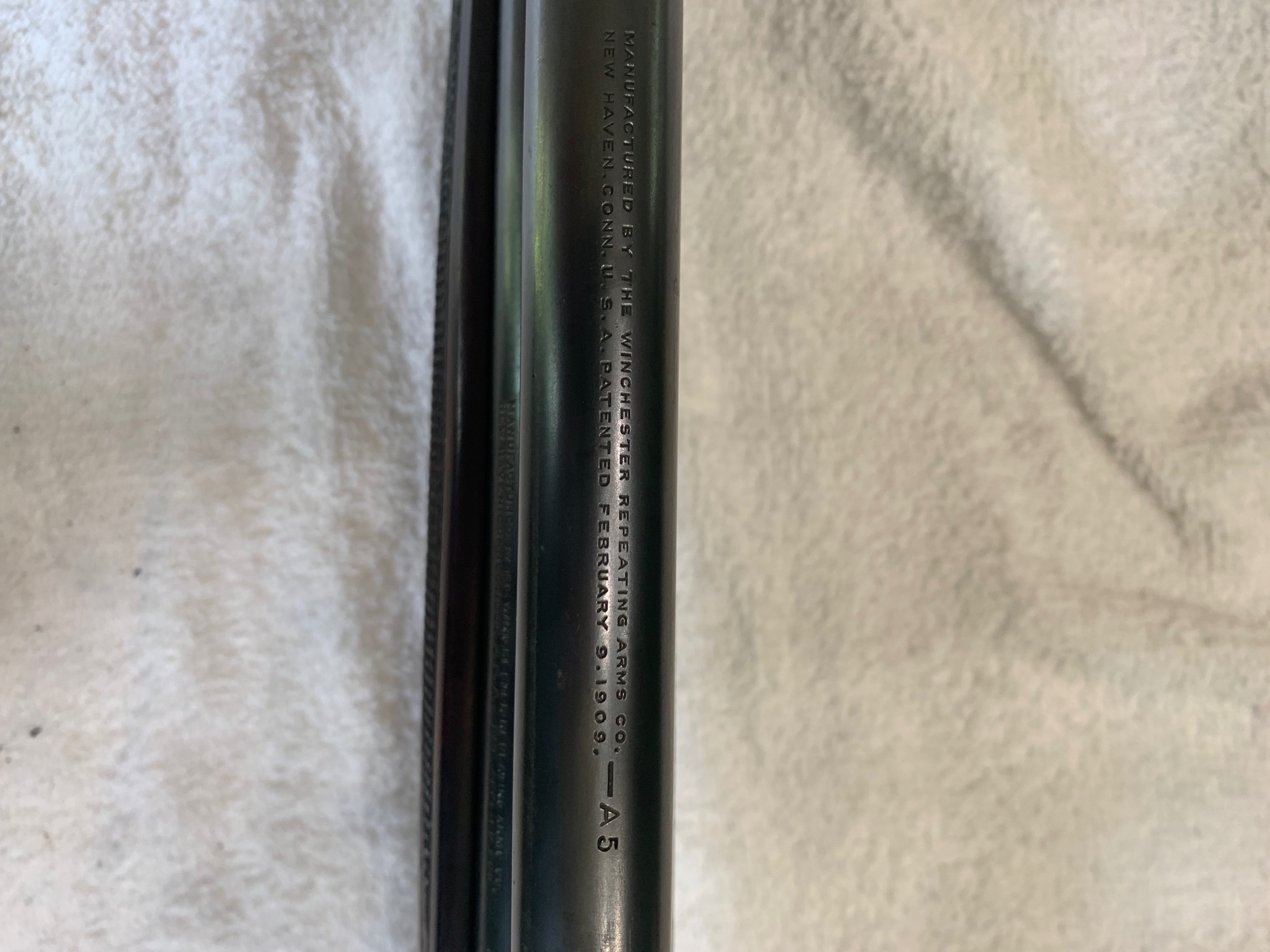

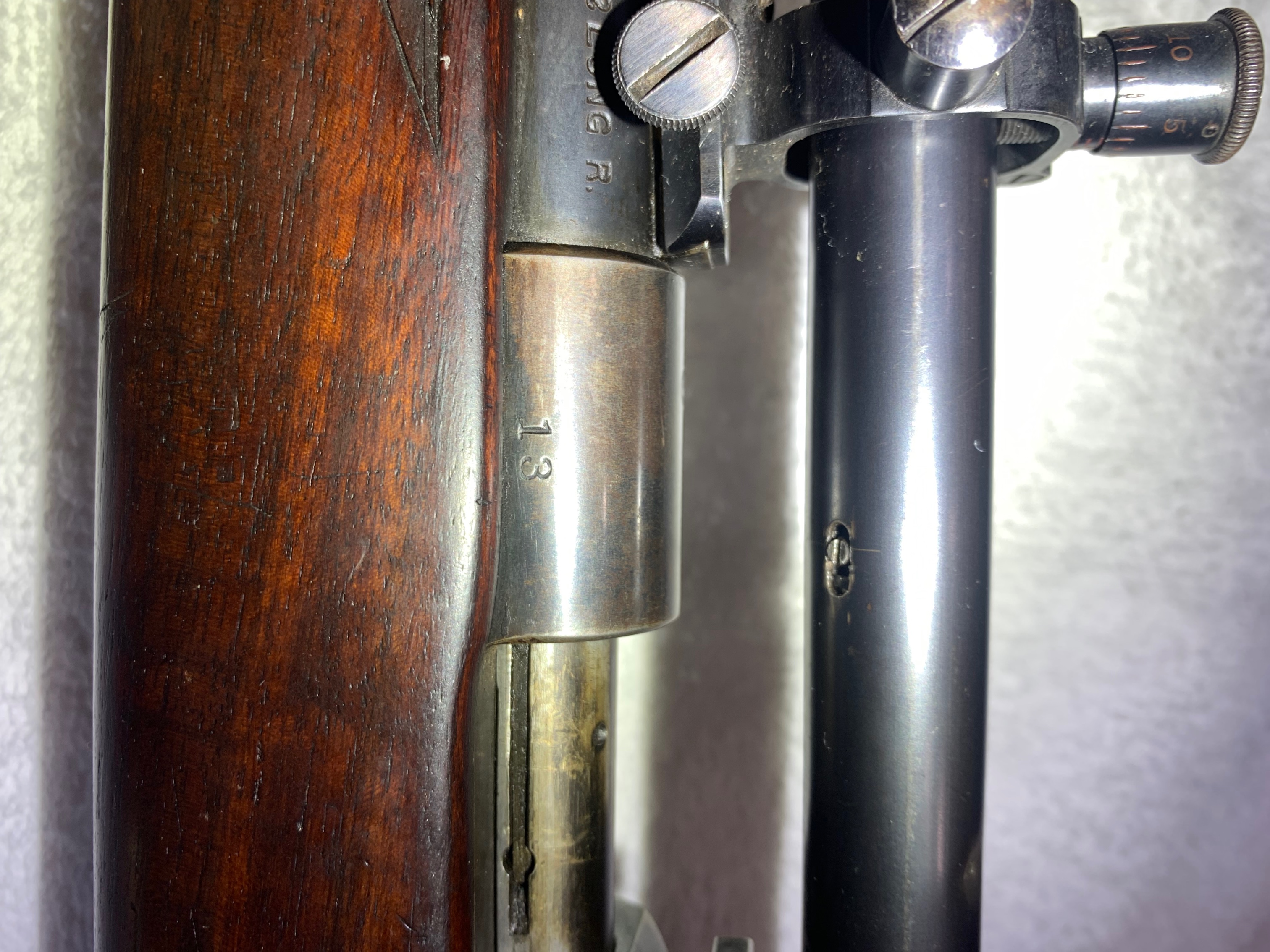

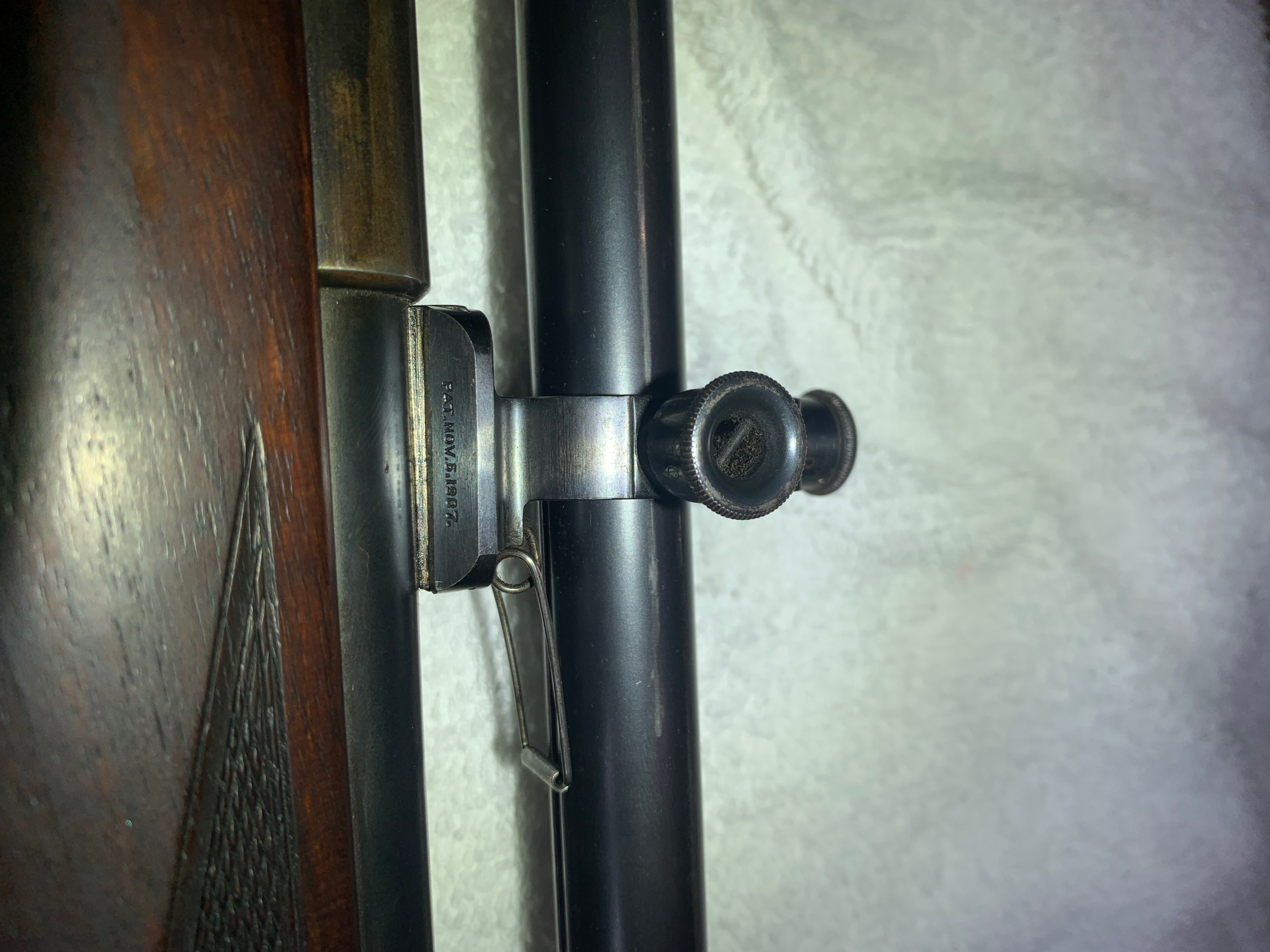

That’s a neat old 52.  The “Patent Applied For” marking is one you seldom see.  I also tip my hat to the craftsman who altered the (later era) Winchester butt plate by creating a trap door.  The A-5 scope looks to be in excellent shape.  Nice find!
BRP
Forum Posts: 1446
June 19, 2026 - 7:46 pm

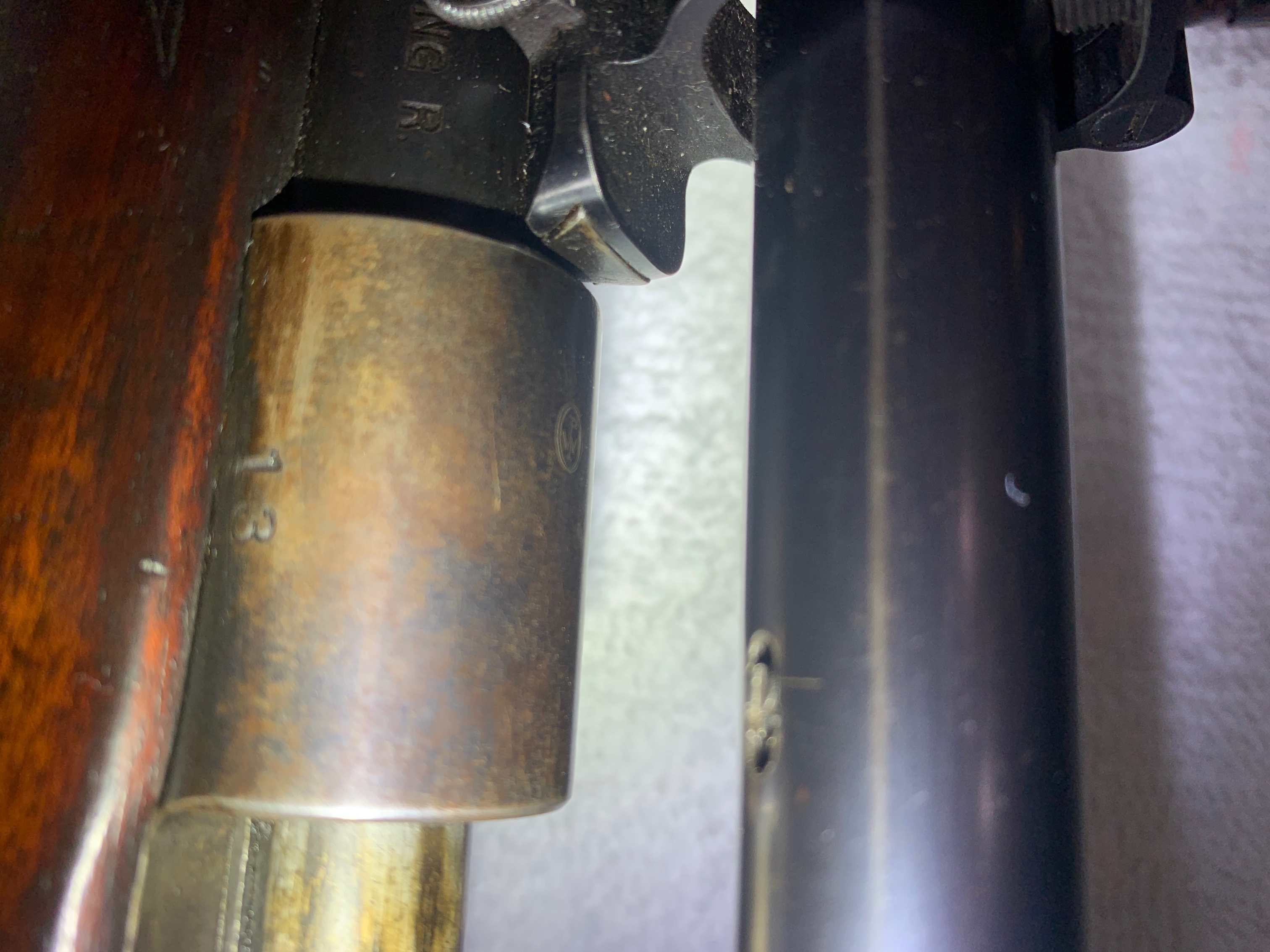

I quite like that rifle, lucky “13” alone would have sold me on it!
I would try a glue stick tip, melt it and stick it to the lyman tube and see if you can pull it out.
Forum Posts: 7757
June 20, 2026 - 2:15 am

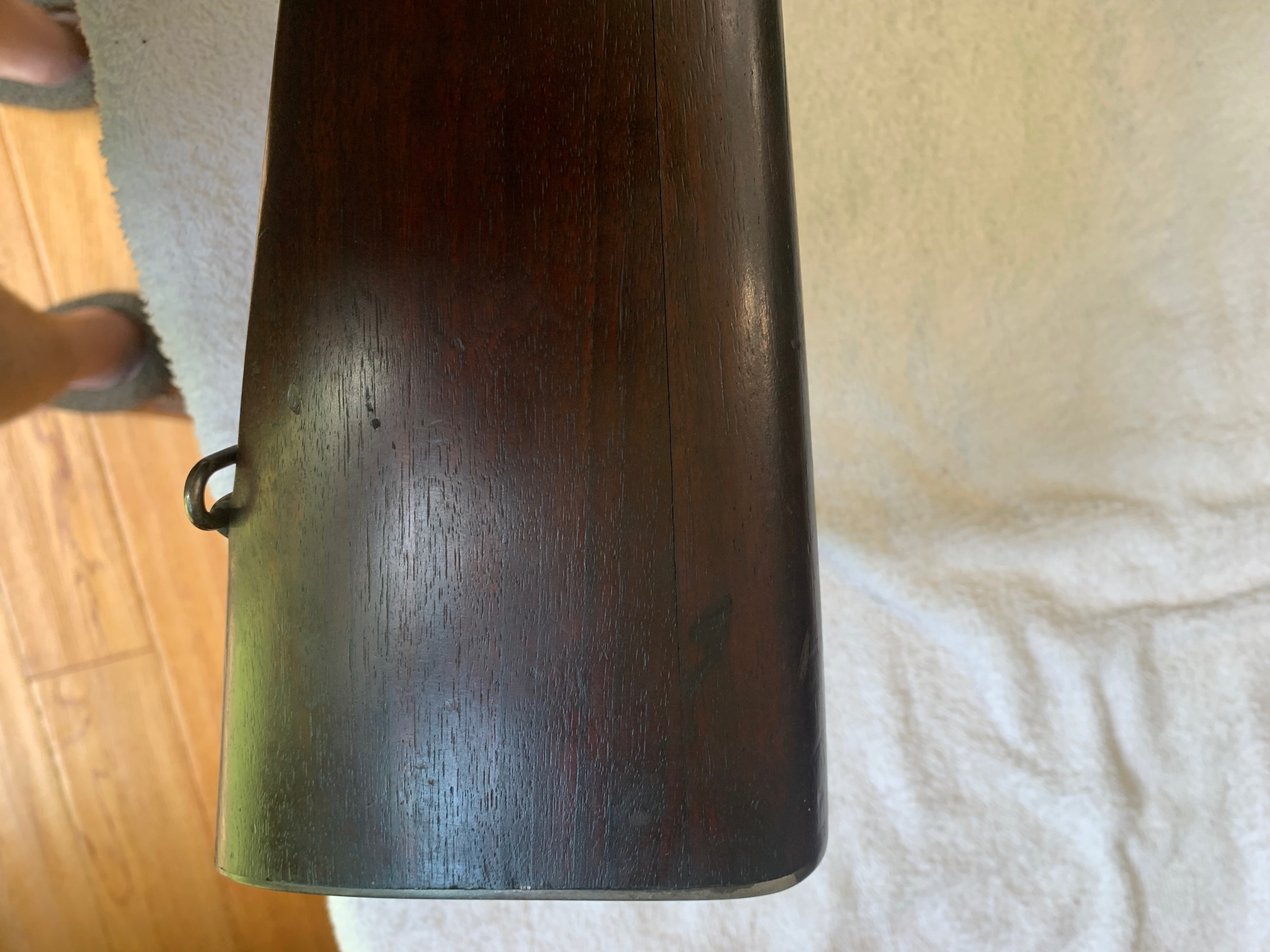

Sight insert tin appears to be hung up on the butt plate; have you tried loosening or removing the butt plate?

Wonderful!  Oh, I can’t wait for the rest of the story to be discovered.  That trapdoor buttplate is classy… if you do take it off to inspect, please take pics of the mechanism… what auction was it on?

I’m in agreement with the others, as that sure is a nice specimen. Different in a lot of very interesting ways. Originally when this was posted, and before the OP was able to post pictures of it.  I thought it might be a  good candidate to remove the custom stock and find a donor rifle, and replace/install an early finger grooved stock on it, like the other early examples. Now that I can see better pics than we’re first listed in the Auction, I also like it, and would leave it alone. Maybe time will provide some more details on who did the custom work on this early number #13 model 52.

A picture may be worth a thousand words but I can only come up with a few: “Nice, leave it alone!”

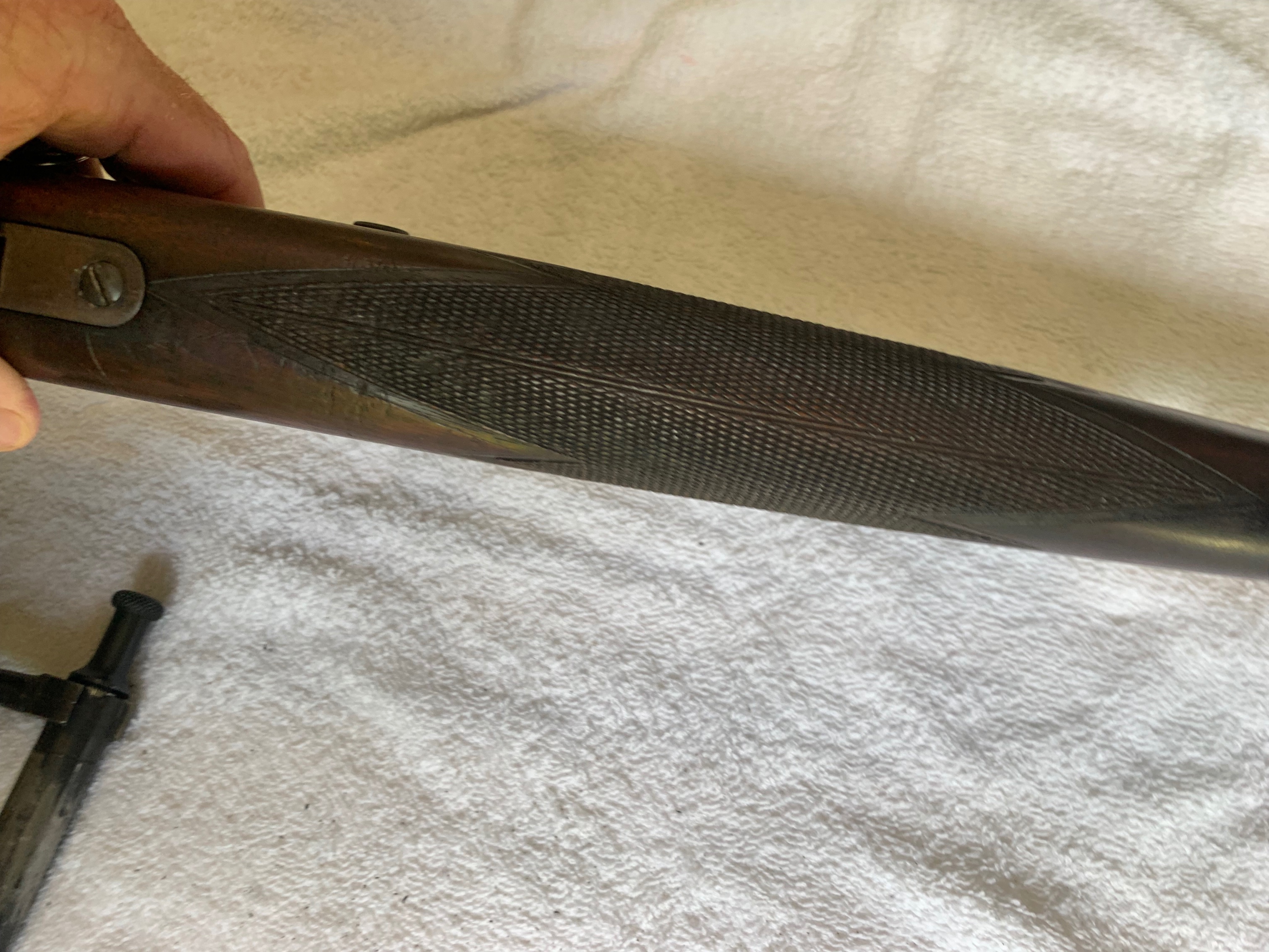

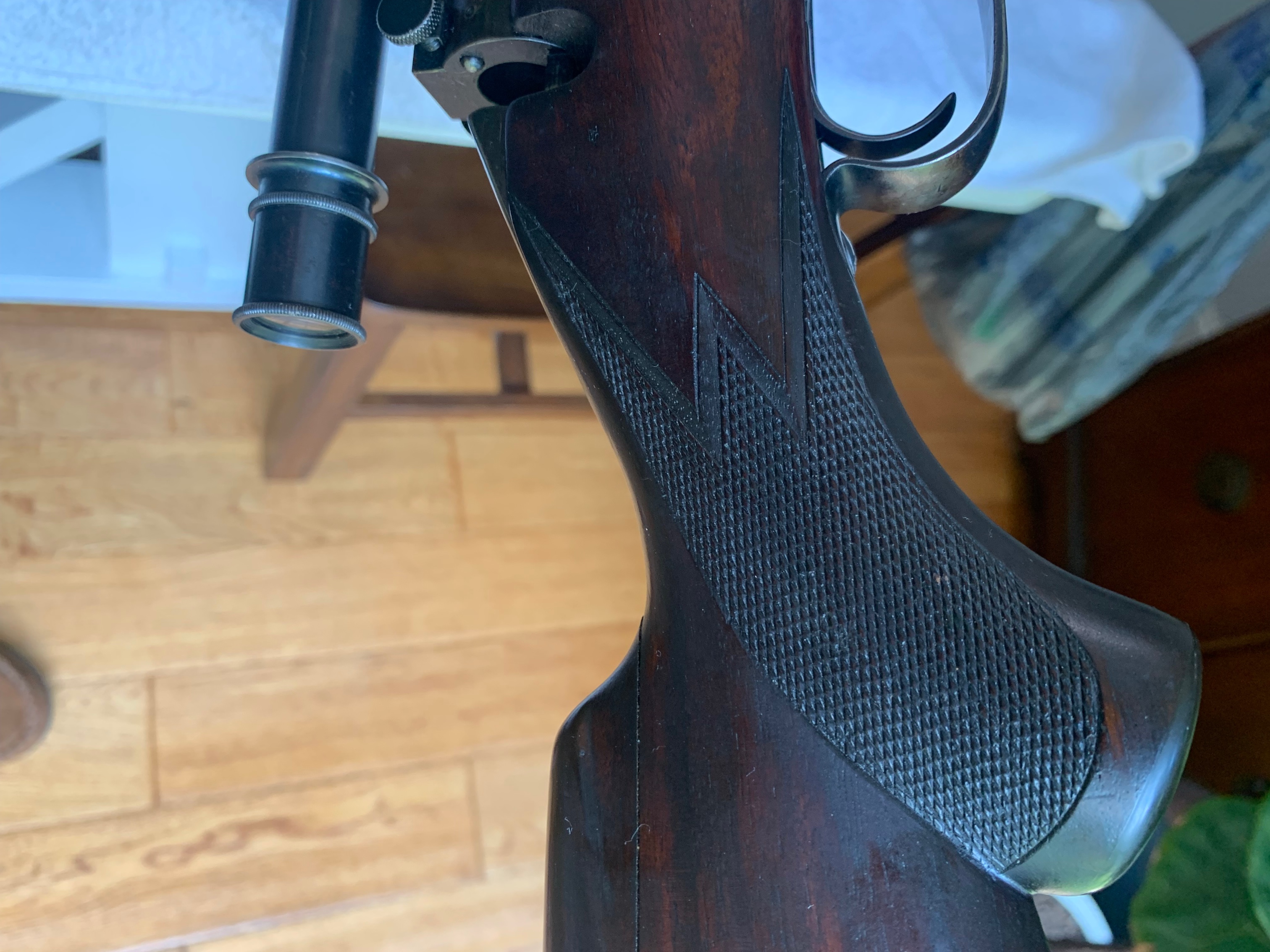

That custom work is first class and it would be foolish and disrespectful to the craftsman to destroy it.  The point pattern checkering looks very well done and is typical of the work of Griffin & Howe that I’ve seen. No blacksmith did this job and I would look very, very carefully with the barreled action out of the stock for evidence of the maker.
Between the World Wars, there were many fine immigrant craftsmen come to the Connecticut River Valley and St. Louis and Chicago, fully capable of doing this level of work and whose names we will never know. But the work speaks for itself.
A Biesen or Brownell or Goens custom model 70 is as “original” as it ever needs to be. So is this Model 52.

Thank ya’ll for the comments.  I’ll try and take the buttplate off once I get home in a few weeks.  Any other advice or thoughts on the rifle please continue to post.  I’ll post pictures once the buttplate is removed.  Would y’all recommend removing the action to see any stock makers marks or leave it be.

I always remove the stock and butt plate whether factory stocked or custom. I like to record all the information on the bottom of the barrel and always hope to dig up some markings possibly related to past owners etc.

Even Proto or SnapOn mechanics’ screwdrivers are not suited for gunsmithing. Their tips have tapered sides. If you don’t have a set of gunsmithing screwdrivers, get a set before doing anything else.  The tips have parallel sides and a selection of thicknesses and widths. Brownell Magna-Tips are the standard. You’ll use them a lot, so don’t hesitate. And get a set of pin punches while you’re at it, although you shouldn’t need to remove pins right now. The screws may be frozen so get a small can of Kroil penetrating oil in case you need to loosen a screw. Take your time. Leave a Kroil treated screw overnight to work. Beefing down to turn an ancient screw usually results in a buggered screw slot. Let chemistry do the.hard work
If you already have the right tools- or once you get them — get, borrow or download an exploded drawing of your gun and study it carefully.  Then look for a YouTube video on how to disassemble a Model 52. You aren’t going to do anything but take the buttplate and the wood off to get a look at what’s underneath. No need to go further.
Best thing is to photograph every mark and stamp while the wood is off and anything you see under the buttplate. Then you can reassemble. While the furniture is off you can seal.the unfinished wood of the inletting with wax or shellac.

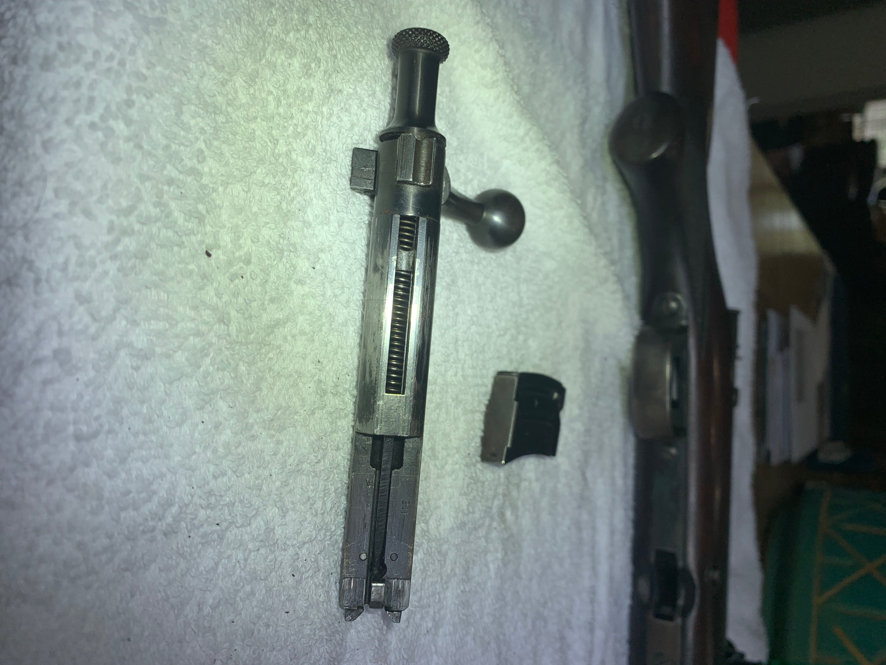

There should only be 2 screws to remove. The front action screw is just in front of the of magazine at the front end of the trigger guards. The second screw should be the barrel band screw. Based on pictures, it appears that the front swivel acts as both a swivel and also the attaching screw for the barrel band. Remove the magazine and bolt prior to removing stock. I would look at the stampings on the bottom side of the barrel just in front of the receiver. There will be possible inspection stamps and maybe a barrel date. Look also in the barrel  channel of the stock for possible stampings, as well as under the butt plate. If not too much of a problem please take a picture of what is stamped on the bottom side of the barrel.
