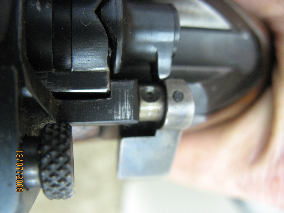

On the original 52’s, it’s common to see the metal cracking at the back of the receiver, on top, right where the bolt contacts the stops as you pull it back to open. The raised “wings”/bolt stops are what will crack (presumably from the repeated “whacks” as you throw the bolt open)…it takes a lot of light and maybe even a magnifier to really see them. This is one main thing I had been told to watch out for in the past when evaluating them for purchase.
Sure as the sun, the one I was looking at a little while back had them although the rest was very nice condition. It’s up to you to decide if something so “common” is a deal breaker. To me, if “they all do it,” then it’s not a deal breaker really, just something to be aware of.

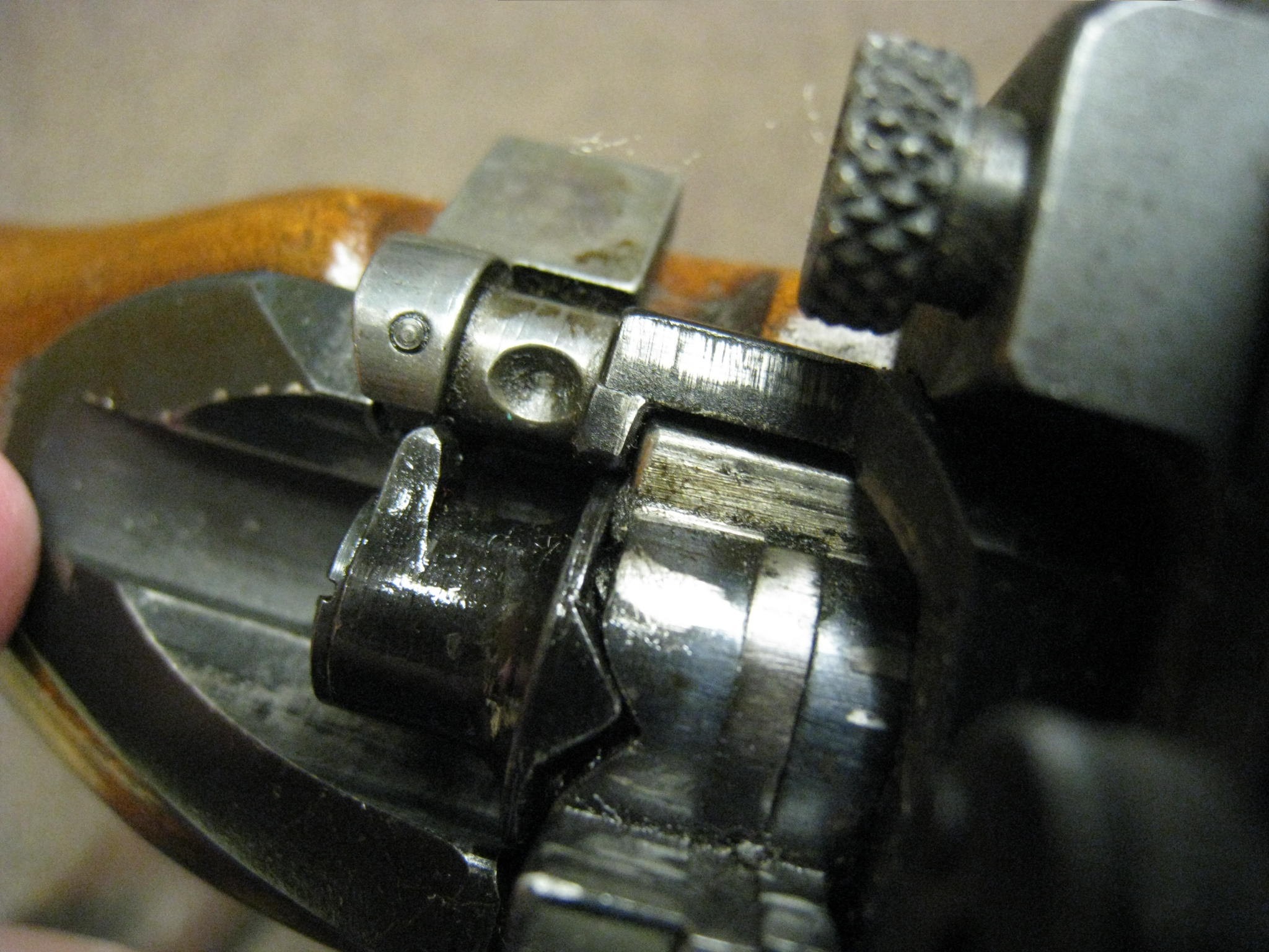

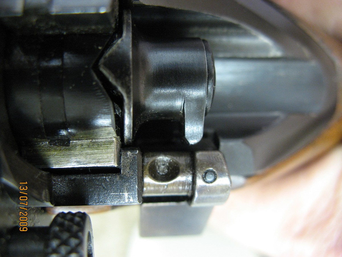

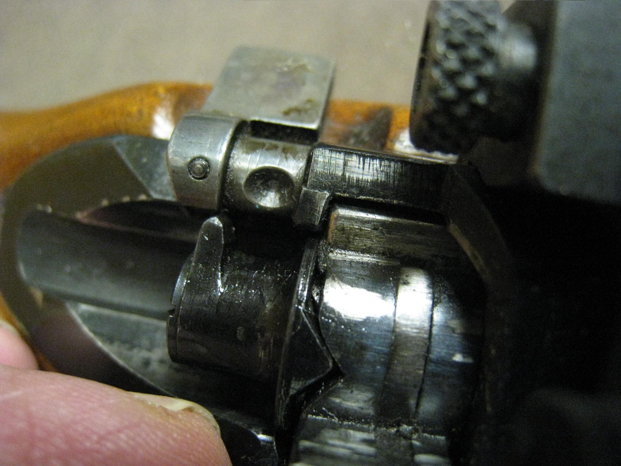

Just to somewhat clarify the cracking problem associated with the pre “A” model 52’s and it’s location, below is a picture. I have included 2 more pictures showing a pre A lug and a redesigned “A” model lug which eliminated the problem. This entailed making machining the locking lug approximately 50% thicker(.080″ additional thickness if memory serves me correctly). In order to accommodate this increased lug thickness, it was necessary to reduce the safety lever hub the same amount. This is the only crack I have ever heard of concerning a model 52 receiver. Most that you will see are very small and not near as severe as the one in the picture. The crack always starts and propagates from the interior sharp machined corner of machined bolt lug recess in the receiver, which is a textbook stress riser just waiting for a crack to happen. Hope this helps.
Steve
1st picture shows crack
2nd picture shows the Pre “A” model LH bolt locking lug
3rd picture shows the redesigned “A” model LH bolt locking lug
Cracked-LH-receiver-bolt-locking-lug-1.jpgPre-A-model-LH-locking-lug-2.JPGA-model-LH-redesigned-locking-lug-1.JPG
Forum Posts: 1446
June 19, 2026 - 4:54 am
No worries Tony!
Steve, you may have been the one to tell me about it originally iirc. Thanks for the photos! On the one I was looking at that one day it took me a minute of staring in poor lighting and fumbling around but once you know it’s easy….like most things I guess!
