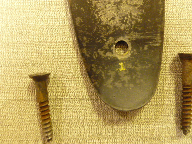

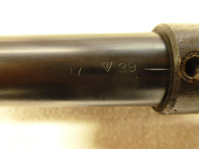

My 1920 rifle has been rebarreled with a 1939 barrel. What is significance of J in a triangle on underside of barrel. Also has (hard to see) C7 stamped there.
The butt plate has a 1 stamped on back side below screw hole.
Forum Posts: 2847
84
September 6, 2026 - 5:11 pm
Hi 86Win,
What is stamped on your rifle is an “I” in the triangle which is the normal “general inspection” marking.  The light “C7” you mention is likely part of the normal “.217” marking which is the bore diameter.  If it is truly a “C” in front of the 7 then I will have to defer to Seewin since I am unfamiliar with a “C7” marking.
