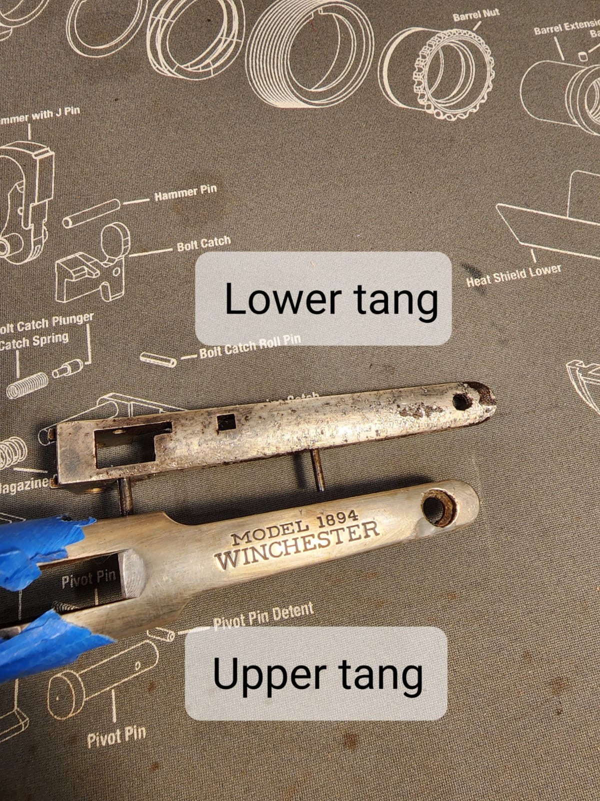

I still have 2 issues :
1-removing the oil from the wood.
2- how to restore the lower tang as its silver coated yet very corroded.Inclosed is  a photo.
Thanks
Forum Posts: 4995
47
October 22, 2022 - 1:50 pm
Here is a link to a recent discussion about removing oil  from wood.
https://winchestercollector.org/forum/restoration-repair-and-maintenance/safe-temperature-1886/
As to the silver plating. The cheapest and quickest is to clean up the area with a rust remover chemical and then get a plating kit and touch it up. You will still see the rust pits and the silver may not match. You can go a step farther and sand the pits away and replate the area but you will probably see the difference in silver plating areas. The most expensive but one that would give you the best look is to have the gun professionally refinished but would cost more than the guns worth and if you sent to someone that doesn’t do quality work  the gun would look worst than it is now.

The receiver is OK, it’s just the lower tang. I will attach some photos of the lower and upper tang for comparison.
Thanks
IMG-20221023-WA0012.jpgIMG-20221023-WA0015.jpgIMG-20221023-WA0014.jpgIMG-20221023-WA0013.jpg
