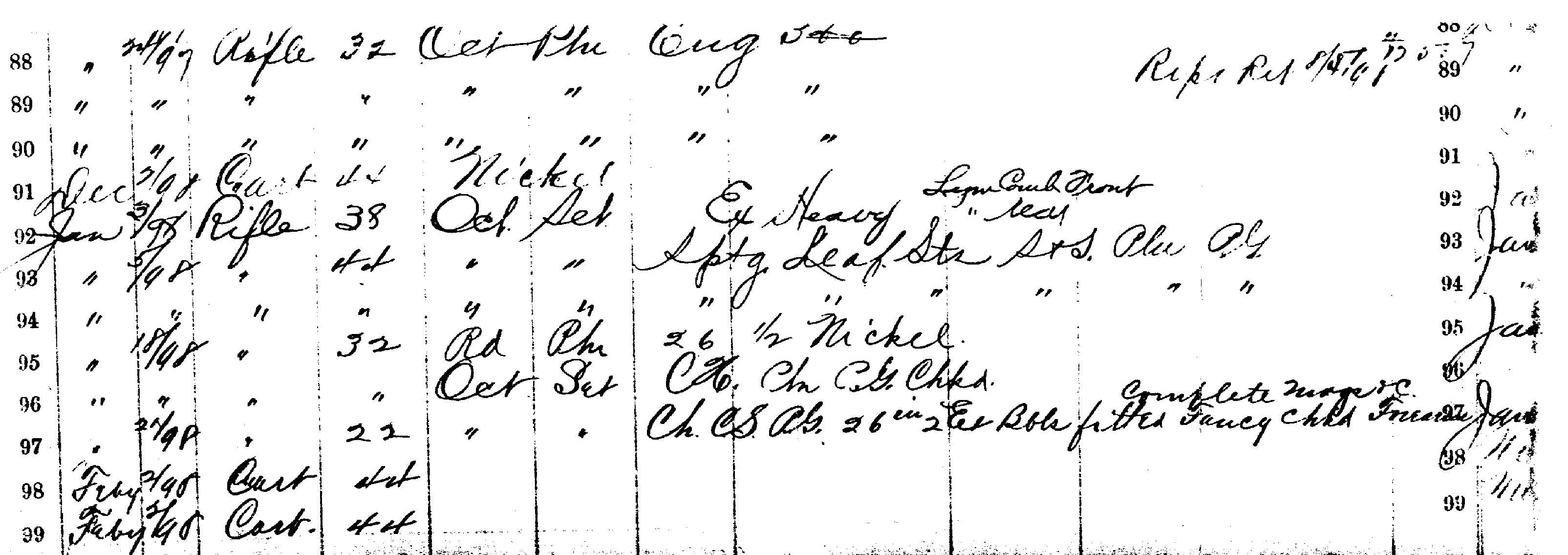

Thanks, that answers my original question. There could in fact be authentic 1 of 1000s that will not letter as such. I don’t care about this guy’s gun, I’m just trying to learn more about 1 of 1000s. I asked another question- Is picture 83 in his auction the actual Winchester ledger? If so, I can see how mistakes were made, difficult to read scribble. Are these copies of the actual ledger available when you get a factory letter?- I have never gotten a copy of the ledger with a letter, will they send it if you ask for it?.
The picture you refer to is a copy of the ledger, but it is not full size, which makes it slightly more difficult to read.  As for the entries being so-called “scribble”, they most definitely are not.  They do require that you can read cursive hand writing.  In the many many thousands of ledger entries that I have examined, 99.99% of them are very easy to read.  In regards to receiving a copy of the ledger page entry with a factory letter, if you ask for it, and you are a CFM member, Jessica will usually oblige you.

August 9, 2017 - 2:19 pm
Here is a sample of a typical ledger entry. The problem most guns will encounter is someone forgot to put the ditto marks in. In that case the person reading the ledger can’t assume. The gun I have and wanted to see how the ledger was written was number 97. Its a 73 in 22 with a Octagon barrel, set trigger, case hardened, checkered stock, pistol grip, 26″ barrel and then it has 2 extra barrels fitted with fancy checked forearms and complete magazines etc. The deal with this gun is it was not a takedown so you would have to unscrew the barrel to change it out and why would you need extra barrels complete with the hardware.  After read hundreds of these entries you do learn the persons handwriting and it comes a lot easier to read but sometimes you come across abbreviations you don’t know.
