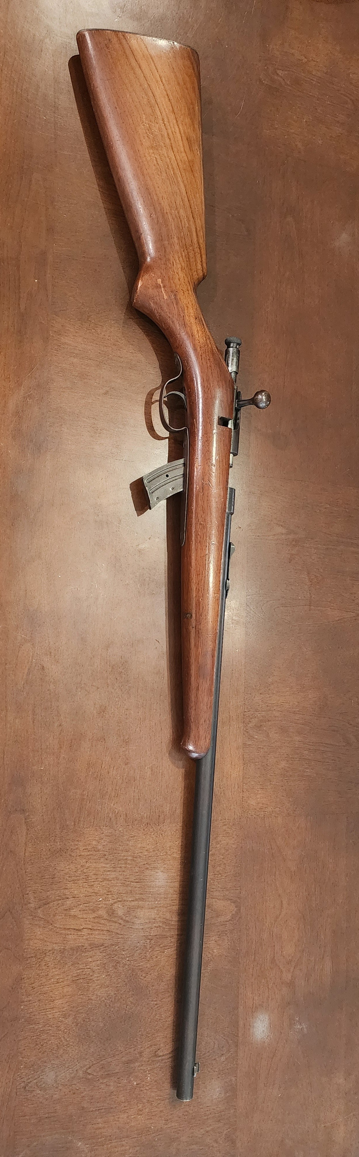

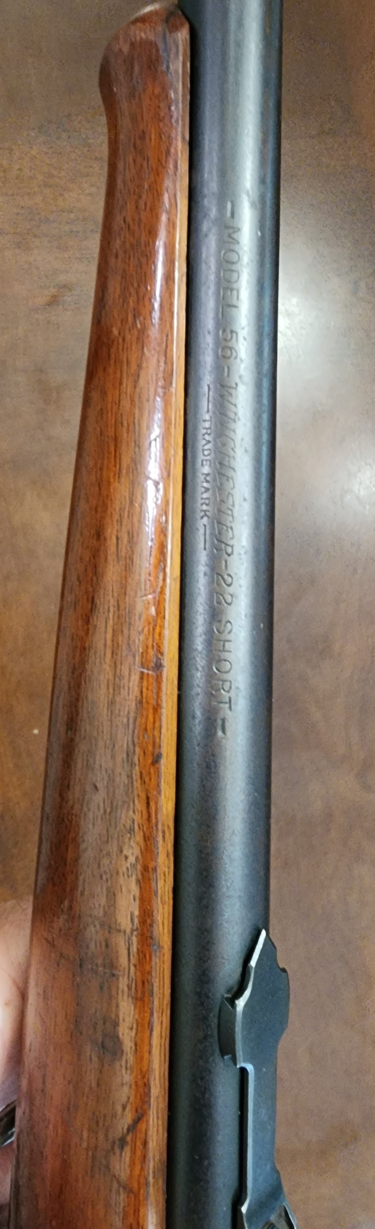

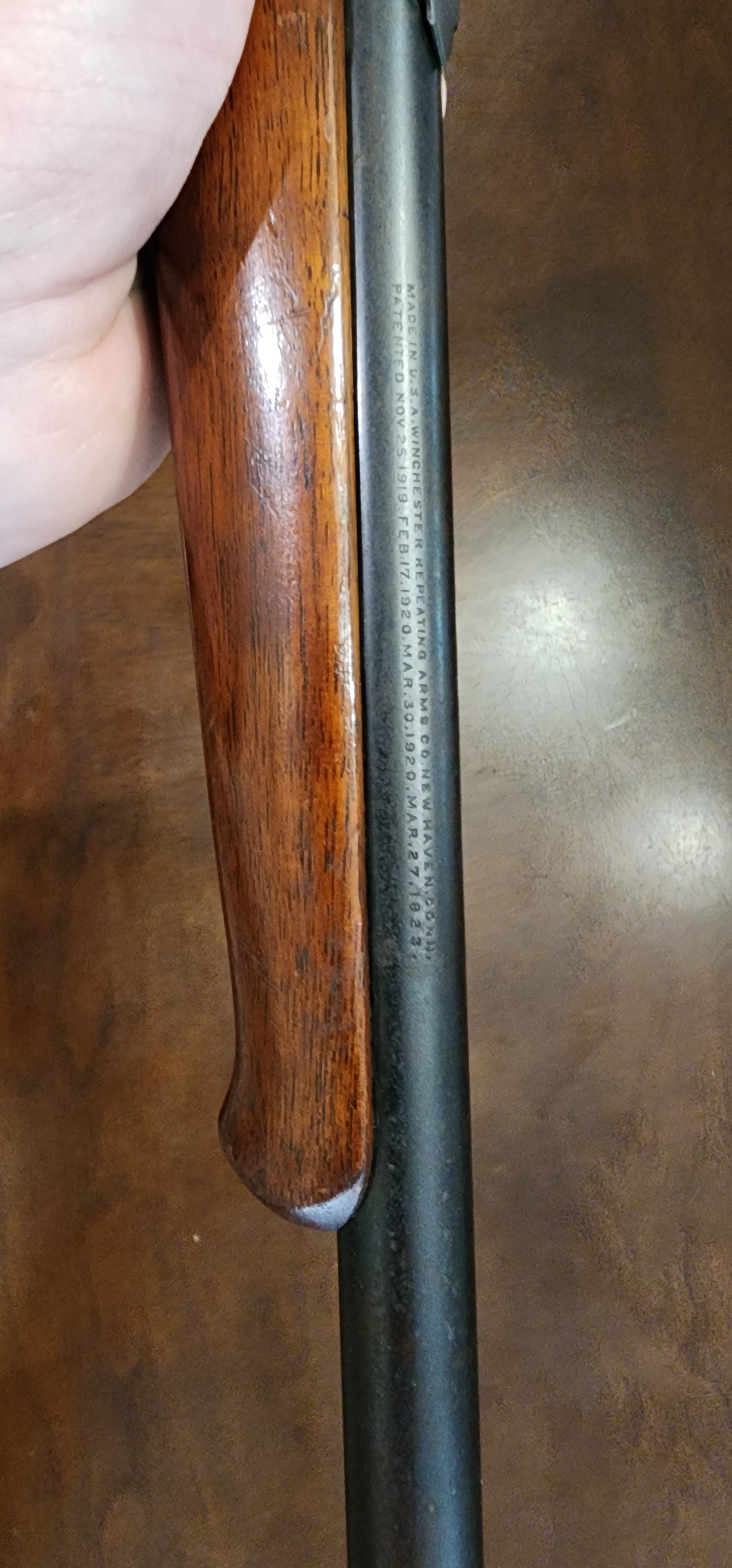

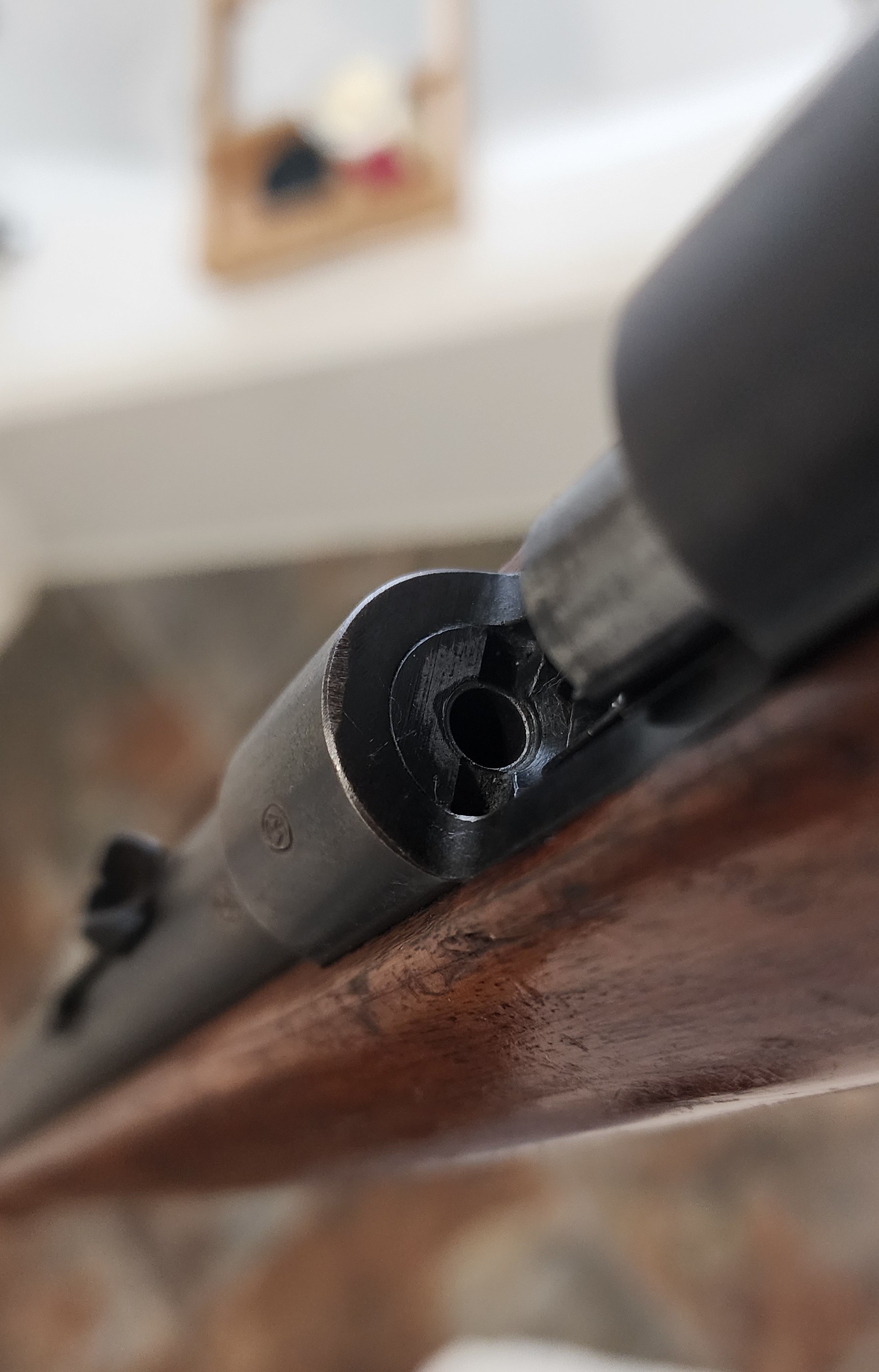

Rob,

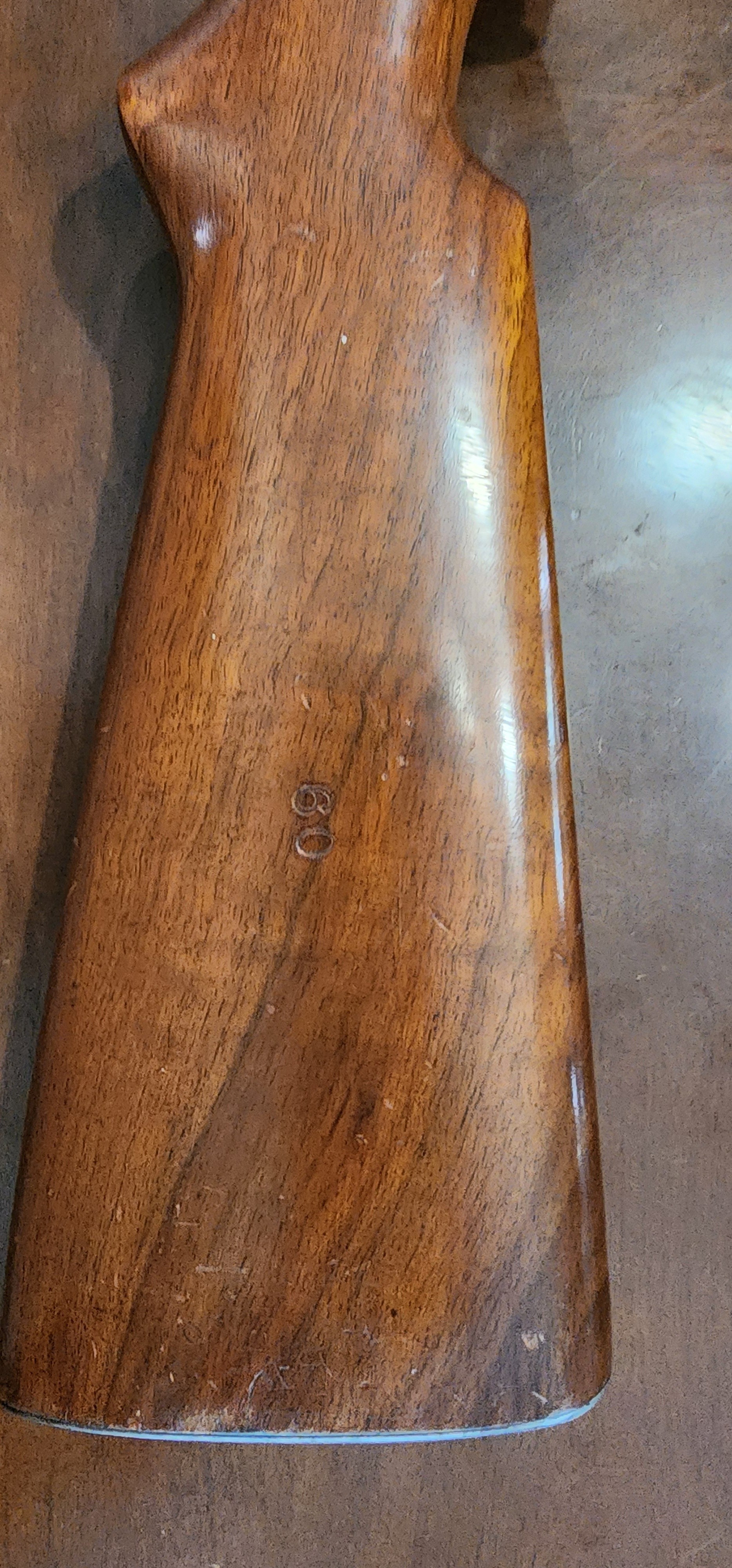

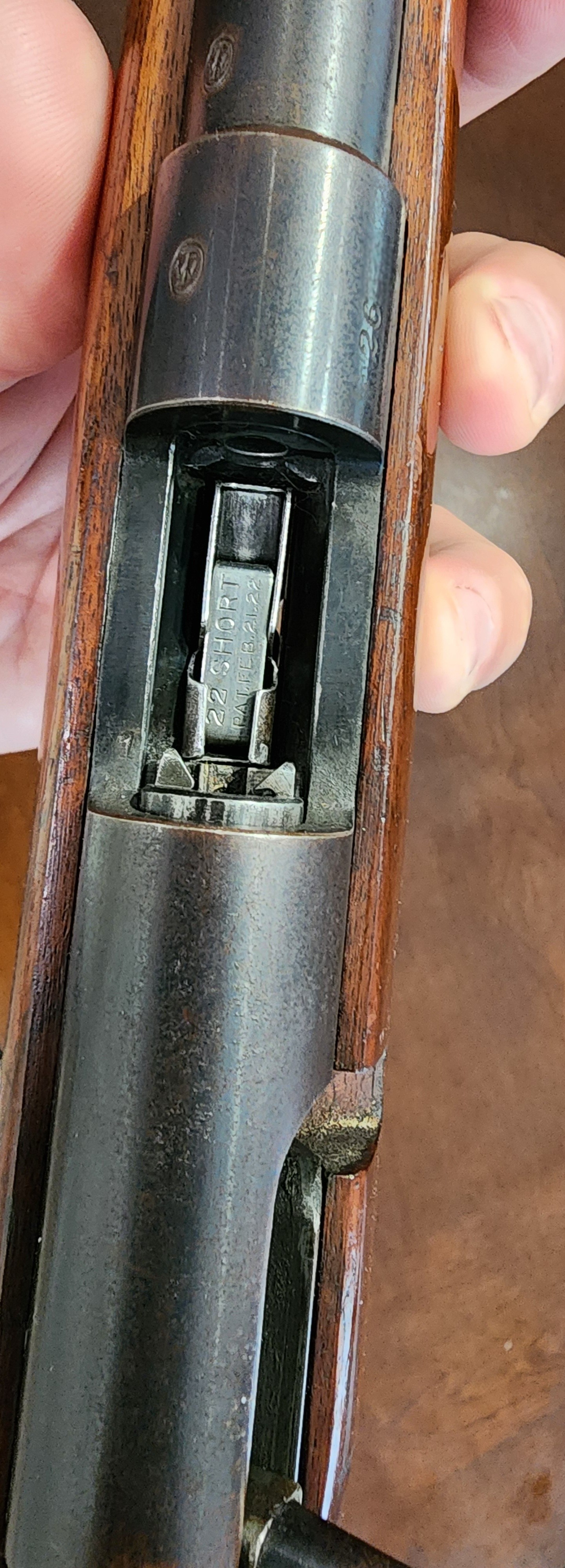

Thanks for sharing your information, you have a great looking Model 56 and a new entry in the survey!  Serial #2660 was made in 1926 and is a first year of production rifle.  Not only is it chambered in the lesser manufactured .22 Short, but it has the optional (and VERY hard to find) .22 short 10-round magazine.
Your rifle appears to be a great condition and all original.  I am sorry I cannot shed any light on the “60” on the stock, I have never seen one with a number stamped in that location before.
Your pictures worked fine with the imgur links but I have embedded them here so it is easier for everyone else to view your great heirloom.
undefined-Imgur.jpgvifw78C-Imgur.jpg7IQsXJ1-Imgur.jpgundefined-Imgur-1.jpgundefined-Imgur-2.jpgundefined-Imgur-3.jpgundefined-Imgur-4.jpgundefined-Imgur-12.jpg

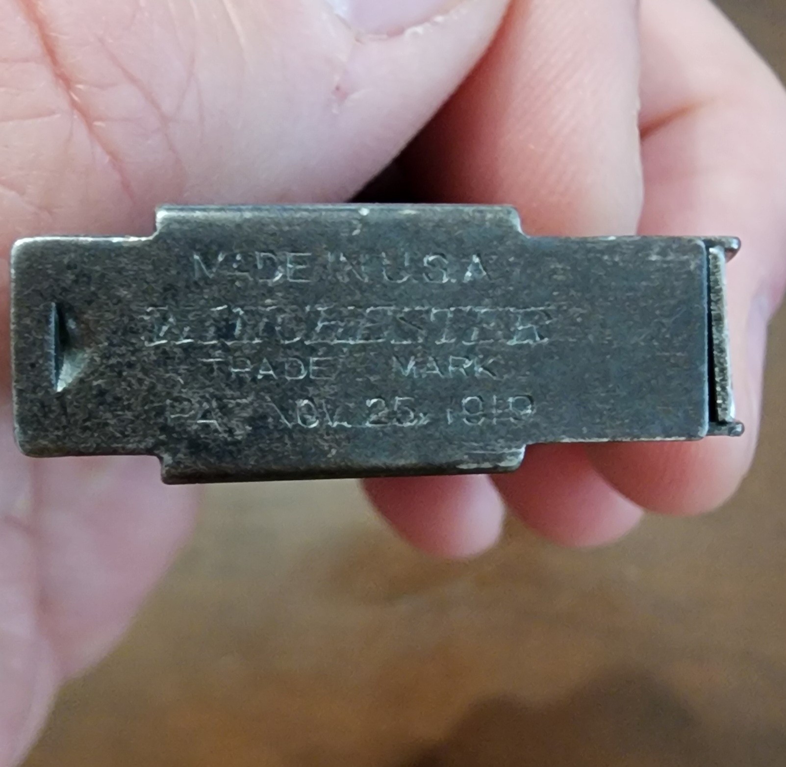

I have not yet shot the rifle.  But it is cleaned and ready to go.
I have 3 mags for it.  2 original 10 rounders and a new 5-shot I just bought on ebay.
The 10 rounders  are stamped on the floor plate:
MADE IN U.S.A.
WINCHESTER
TRADE MARK
PAT. NOV. 25, 1919
I don’t know how to add pictures of rifle.
