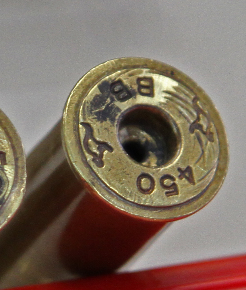

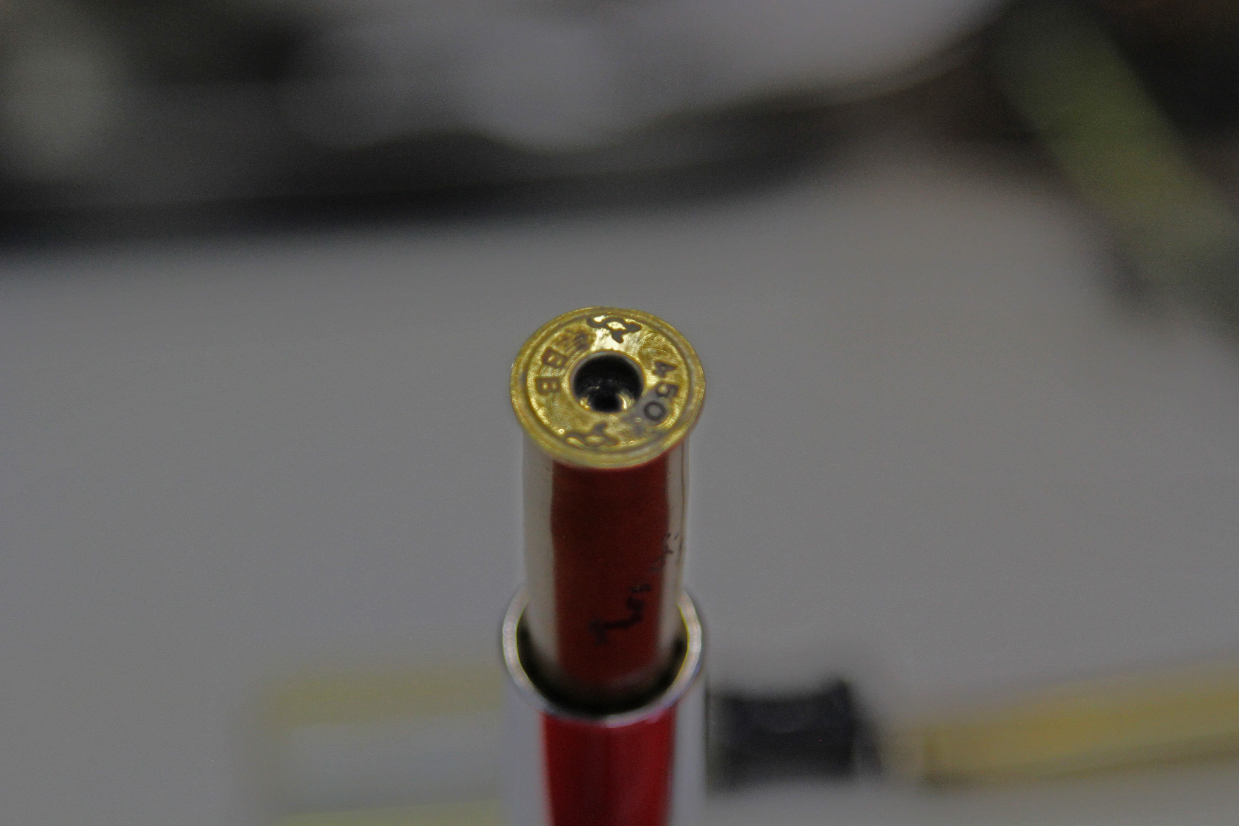

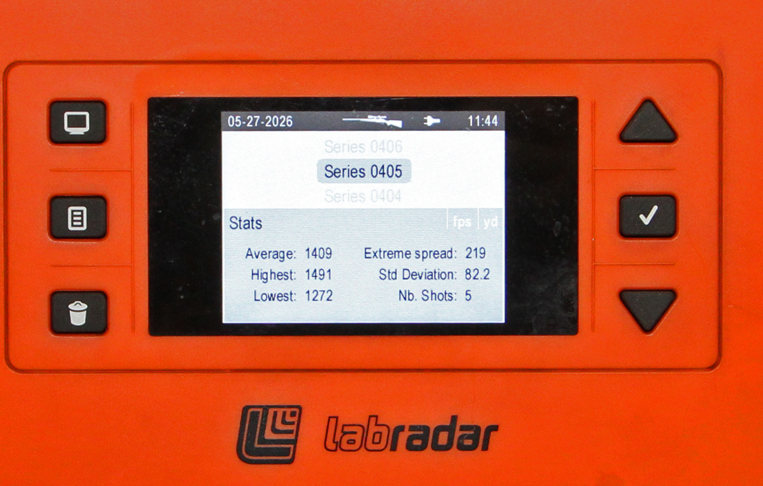

I shot these on 5/26.
1- 30 grs    1,272 fps  Cold bore  Ambient temp was 61 degrees.
2- 30.5 grs  1,446 fps  has a slight extractor rub from pressure.
3- 31 grs     1,417 fps
4- 31.5 grs  1,420 fps
5- 32 grs     1,491 fps      has an extractor rub from pressure.
The new primers worked this time.  All of the rounds ejected fine.   Looks like I need to stay in the low 1,400’s.   Barnes says to use 32 grs of 4198 for 1,617 fps but I’m getting pressure signs above 31.5 grains and only getting 1,420 fps.  My load in this barrel tells me to stay around 31.5 grs of 4198.  I used an over the powder card and then toilet paper rolled into a tube long enough so the bullet pushed it down some against the card.

Progress! What was the SD for the 4th load?
Forum Posts: 6931
103
May 28, 2026 - 7:35 pm
I’m not sure what you are asking?

Mike,
If I understand what Chuck did, he does not have an SD for just the 31.5 gr load because he shot just (1) round.  If I understand it correctly, he loaded (5) total cartridges, each with a different charge weight.  In his shoes, I would have loaded all (5) empties with the exact same load, shot them, and recorded the results, then repeat with the next powder charge weight.
There is no explanation for his #2 load being both faster in velocity and harder to extract than loads #3 and # 4 except for uncontrolled variances in his over-powder card placement and/or the (unneeded) rolled toilet paper between the powder card and the bullet.
The only way to control (eliminate) the oddities that he is experiencing in his load performance is to stop using the over powder cards and toilet paper.  It is not needed with IMR 4198.

I misunderstood, I didn’t realize you were only shooting one of each load. Maybe I just like loading, shooting and data but I don’t feel like one round will tell you much. I’m glad you addressed the primer issue. They almost never cause problems but it’s an easy thing to try when things get wonky.

Mike, at this stage I was just testing the charge weights trying to find the max load.  I will pick the one I like and do some 5 shot groups.  I only have 5 cases that are fire formed.  I don’t want to ruin anymore brass.  When I have the loading die set made I will fire form some more.
