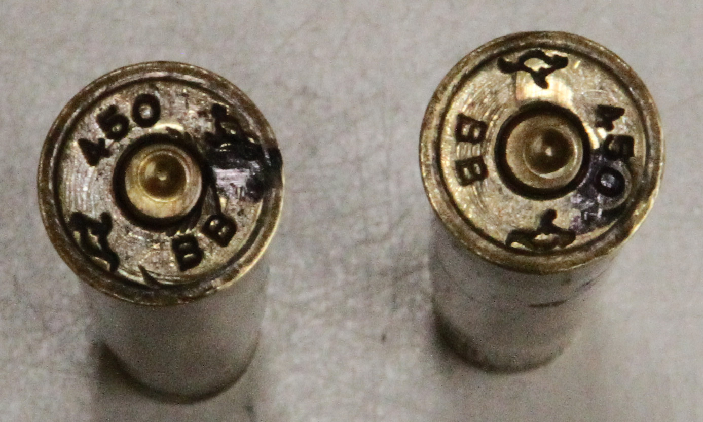

I loaded the 5 cases.  30 grs, 30.5 grs. 31 grs. 31.5 grs and 32 grs.
I did not use the filler material nor the process I did the last time.  I used toilet paper and let the bullet compact it just a bit.
Forum Posts: 6931
95
April 21, 2026 - 10:58 pm

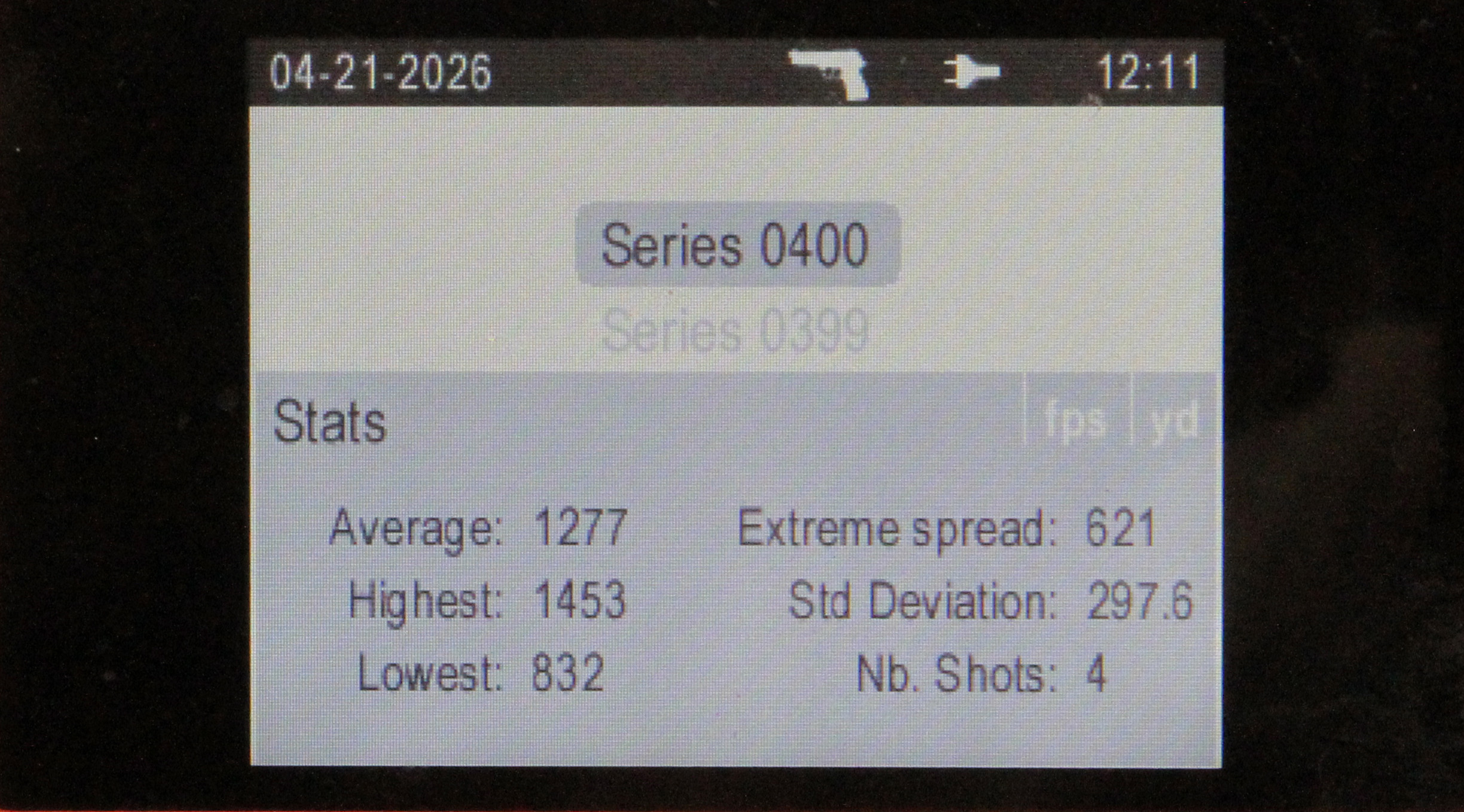

Shot the five cases today.  I messed up on #1 at 30 grs.  I forgot to change the chrono from rifle to handgun so I didn’t get any data.
Shots 1, 2 and 4 shot OK, ejected well, and extracted fine.
But shots 3 and 5 not so good.
#1- 30 grs. no data.
#2- 30.5 grs. 1,396 fps
#3- 31 grs. 1,426 fps    This round did not ignite immediately and left a shiny spot on the case.
#4- 31.5 grs. 1,453 fps
#5- 32 grs.  832 fps      This round did not ignite immediately and left a shiny spot on the case.  Also there was a lot of un burned powder left in the barrel.
I tried to make sure the cartridges were not turned upside down to let any powder move from the primer area.   Obviously some didn’t stay put on #5.
#3 and #5 both showed signs of pressure. I had blacked out the old shiny spots with a black magic marker before firing.
The mail just came and I got some 38 cal and 40 cal over the powder wads that I will use next time with the toilet paper.  I might try another lot of primers too.
Next update may be after Greeley.  But if I have time I’ll try to load before Greeley.
