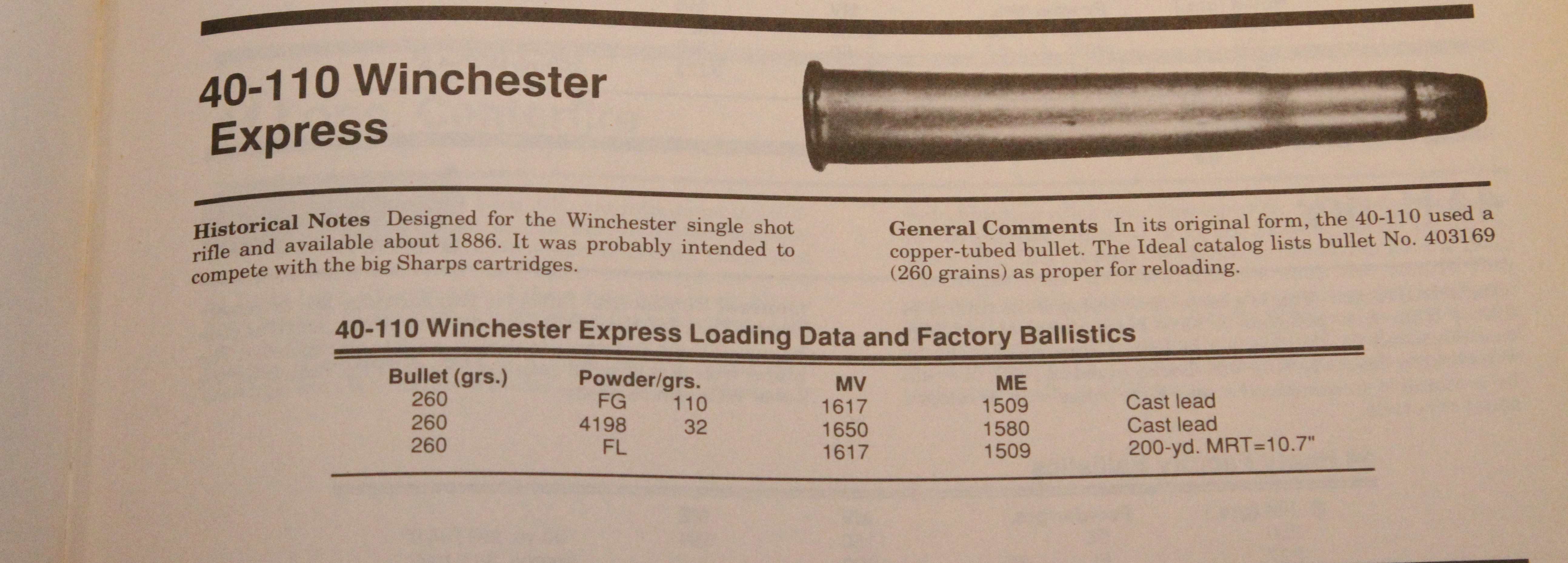

Yesterday I loaded 3 cartridges with 30 grains of 4198.  This is several grains lower than what the Barnes data says.  I need to contact Lee and see if I am ever going to get the 45 dies.

I fired, or tried to fire, the 3 cartridges yesterday.  The first one graphed at 1,221 fps.  Low but it was a cold bore shot.  I was expecting the next 2 to speed up some.  The second one did not fire.  Bad primer.  It shows a good firing pin hit.  The third one really surprised me.  The chronograph showed only 981 fps?
I guess I need to shoot some more and increase the powder by another grain to 31.

You know I won’t do that.  I start under the recommended load and work up.  I do not have any data that shows more than one load.  Barnes says to use 32 grains of 4198 for 1,650 fps.  Factory black powder loads shot at 1,617 fps.

The problem is there is no recommended load data for the EX calibers.  Actually that is true for the majority of our old calibers.  If anyone has some reputable data I’d love to see it.  Cartridges of the World by Frank Barnes is the only source I know of that has data for all of our old calibers.  But, it is usually just one load per bullet weight and the Factory black powder load.

I have no idea where Barnes got his information for the 40 Express cartridge, but using Dupont’s (old) published information, the 40 Express (40-110) can safely be loaded with 44 grains of IMR 4198 (40%).  At just 30 grains, you are at just 27%.  In your shoes, I would bump it up to at least 36 grains as a starting load.

Again, where did Barnes get his load information from ?? He most certainly was not a ballistics expert.  Are you certain his published information is correct ? I most certainly am not of that belief.  Further I without any hesitation would load a 40 Express cartridge with 36 grains of IMR 4198 and then shoot it in an original high-wall rifle and think nothing of it.  All of that stated, you need to do what you decide is reasonable. Let us know what 4198 load you eventually land on that equals the original factory load.

Exactly.  We’ll see.  I plan to up the powder.  I will load some at 31 grs and then 32.  I need to figure out what caused the one last time shoot so low while my first shot was around 1200 fps.?
