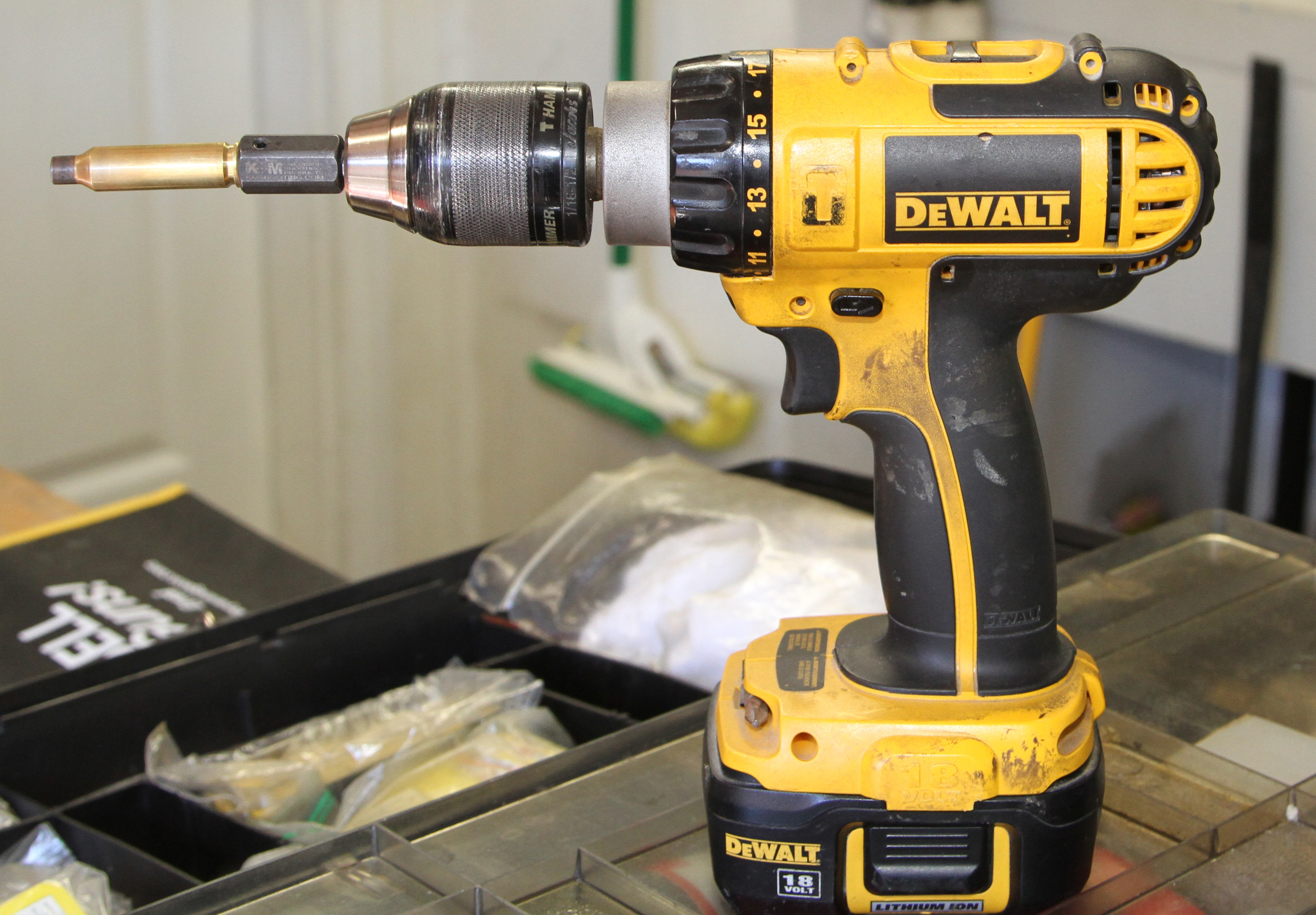

OfflineHere are some pictures from today. The first one is how I clean the primer pockets using a drill.
Next is the residue from 50 pockets.

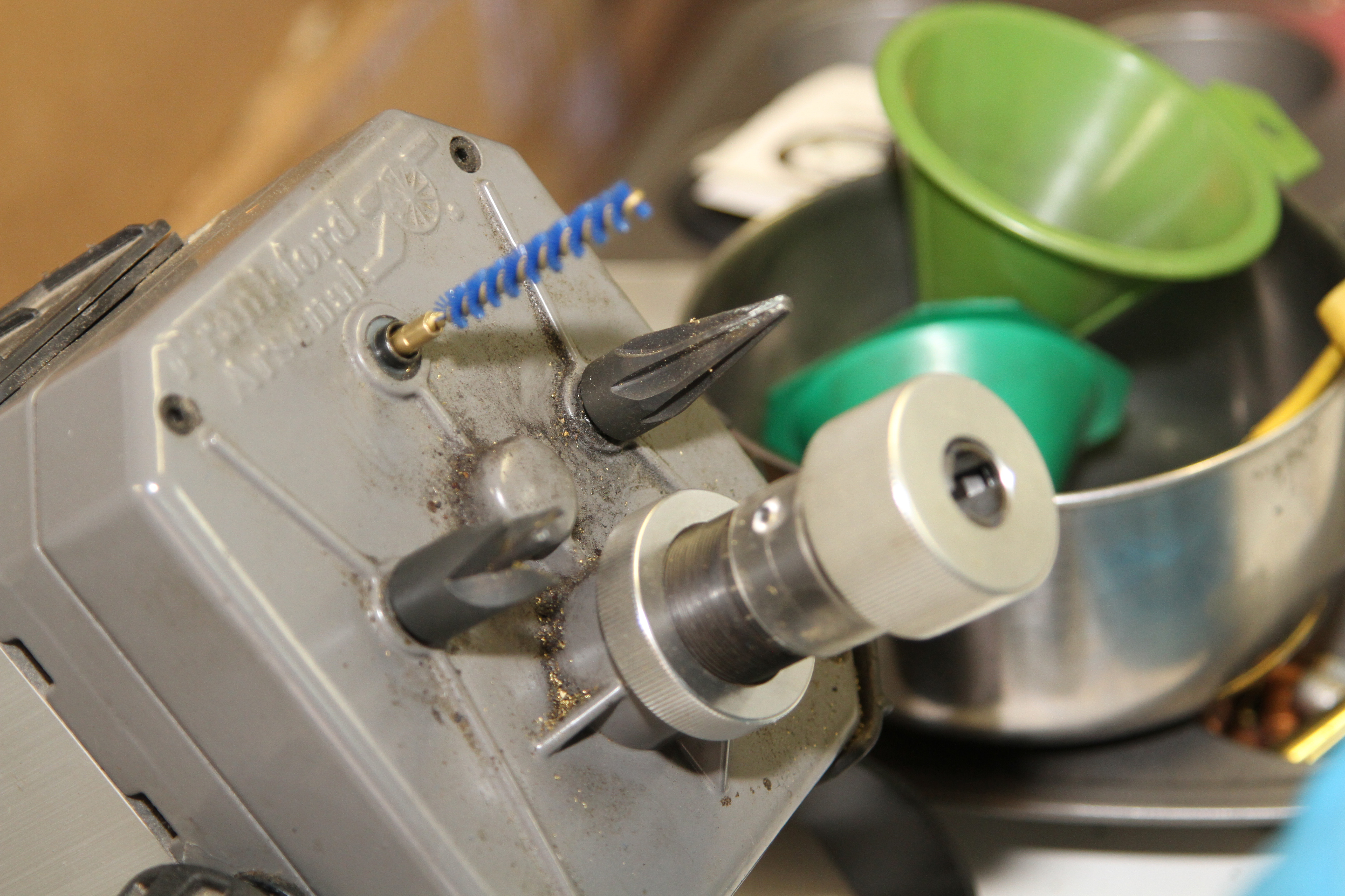

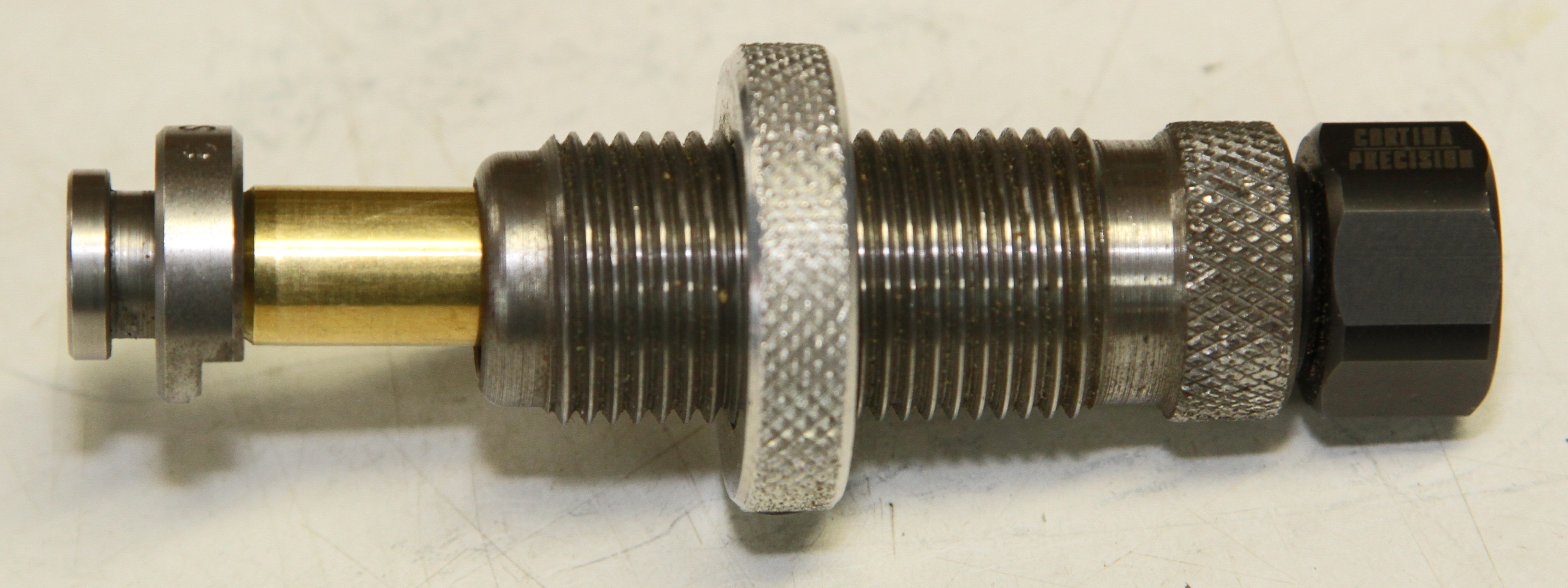

Here is how I brush my necks. ![]()
This tool can be placed on a press but if you accidentally bend the brush it becomes a hassle to use. The shell holder helps me get it out of the die.
Here is an automated tool I have. You can spin the tools but it isn’t always fun getting the brass over the brush. So same goes if you bend the brush.

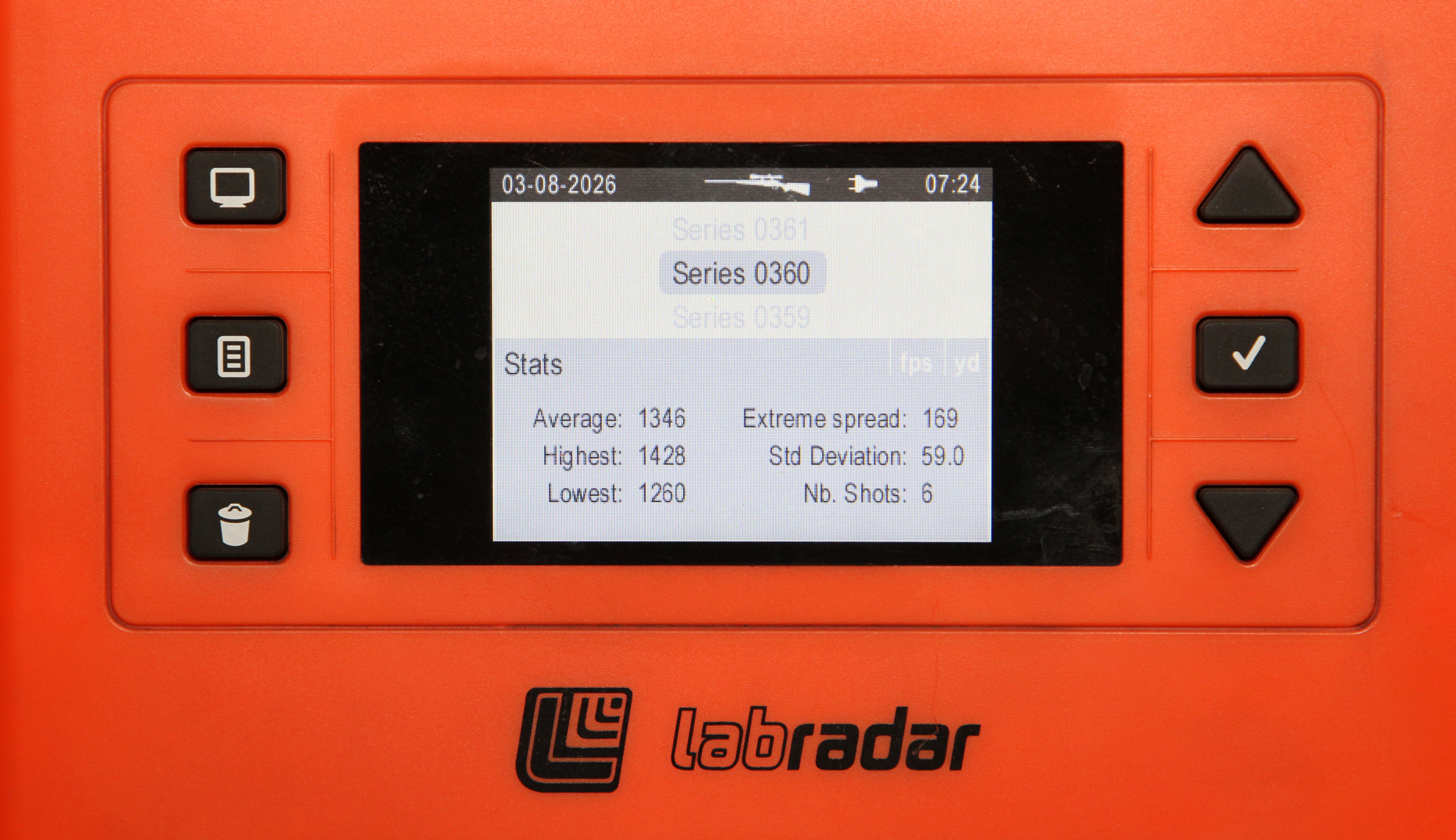

OfflineNot that Bert is losing weight isn’t important but here are my latest shooting results.
Shot the six rounds. All went into the chamber but one is still tight coming out. I had been soaking the rounds and looked at them today and found that one of them has a circumferential split near the neck. I’ll cut the bad portion off. I can probably still use it but if not I never throw out long pieces of brass. I think I’m going to re shoot the 1 piece that is tight and not the others?
I need to bug Lee Precision and get an update on the 45 EX dies. The 38 EX and 40 EX brass is ready to ship to them but I’d like to see the 45 EX first. I want them to make an additional die/dies that will pre form the brass enough to get into the full length sizing die.
