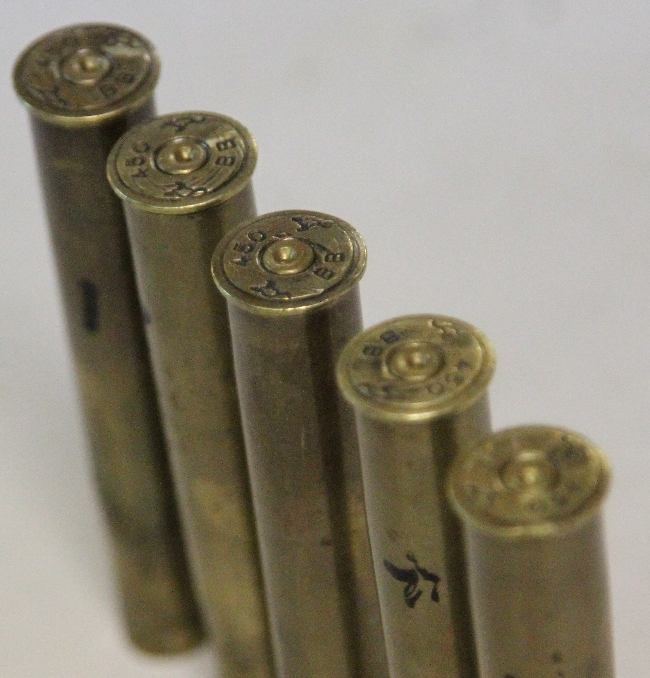

I just reloaded five of the 40 EX cases.  The first 3 were charged with 31 grs. of 4198.  The last 2 were charged with 32 grs. of 4198.
This time I used a 44/45 felt wad on top of the powder.  It was not easy getting the wad to slide down the 40 cal neck and sit flat on the powder.  I need to order some 38 and 40 cal wads.  I then used a small cotton wad on top.  All of this to keep the powder near the primer.  We’ll see the results on Tuesday.

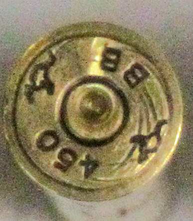

Not only hard bolt lift and a primer that backed out some, I had to use a cleaning rod to get the case out.  All clear signs of over pressure.  The headspace for most Winchester rifles is .007″.  So even a highwall can have a primer come back that far.
I have been using fillers for at least 30 years.  Theory and assumptions are one thing but facts are facts.   I’ve quoted several times the Authors who say to use fillers.  I also have quoted the Authors who have documented an explosion that was caused by flash over.  You are ignoring the facts.
Currently I just put a thin wad made to go over black powder and then a 1/4″ thick piece of cotton to make sure the powder stays by the primer.   We will see what happens tomorrow.  Base upon the facts I will make adjustments as needed.

Sorry, the breach block was very hard to open and it took excessive pressure to move the lever.  Primers backed out and cases got stuck.  It only did this when the pressure got too high.  When I lowered the powder charge the problems went away.  This is all spelled out in the Forum posts for the 38 EX.

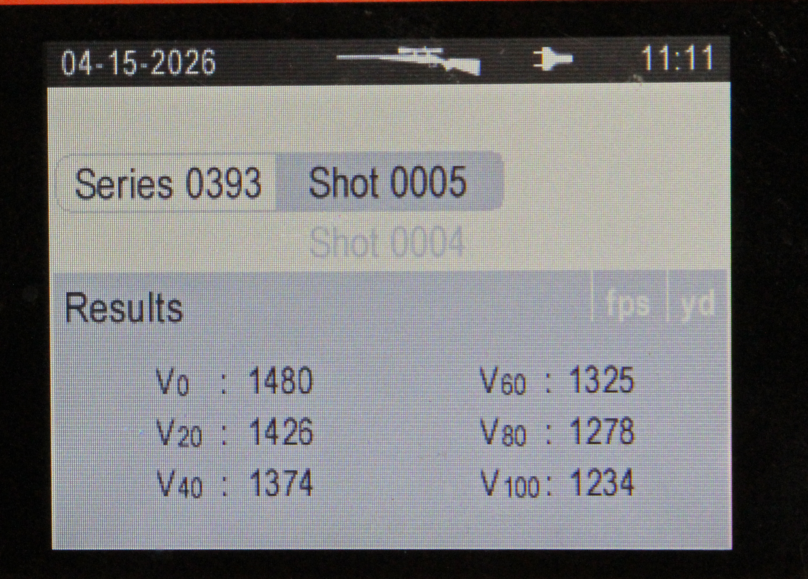

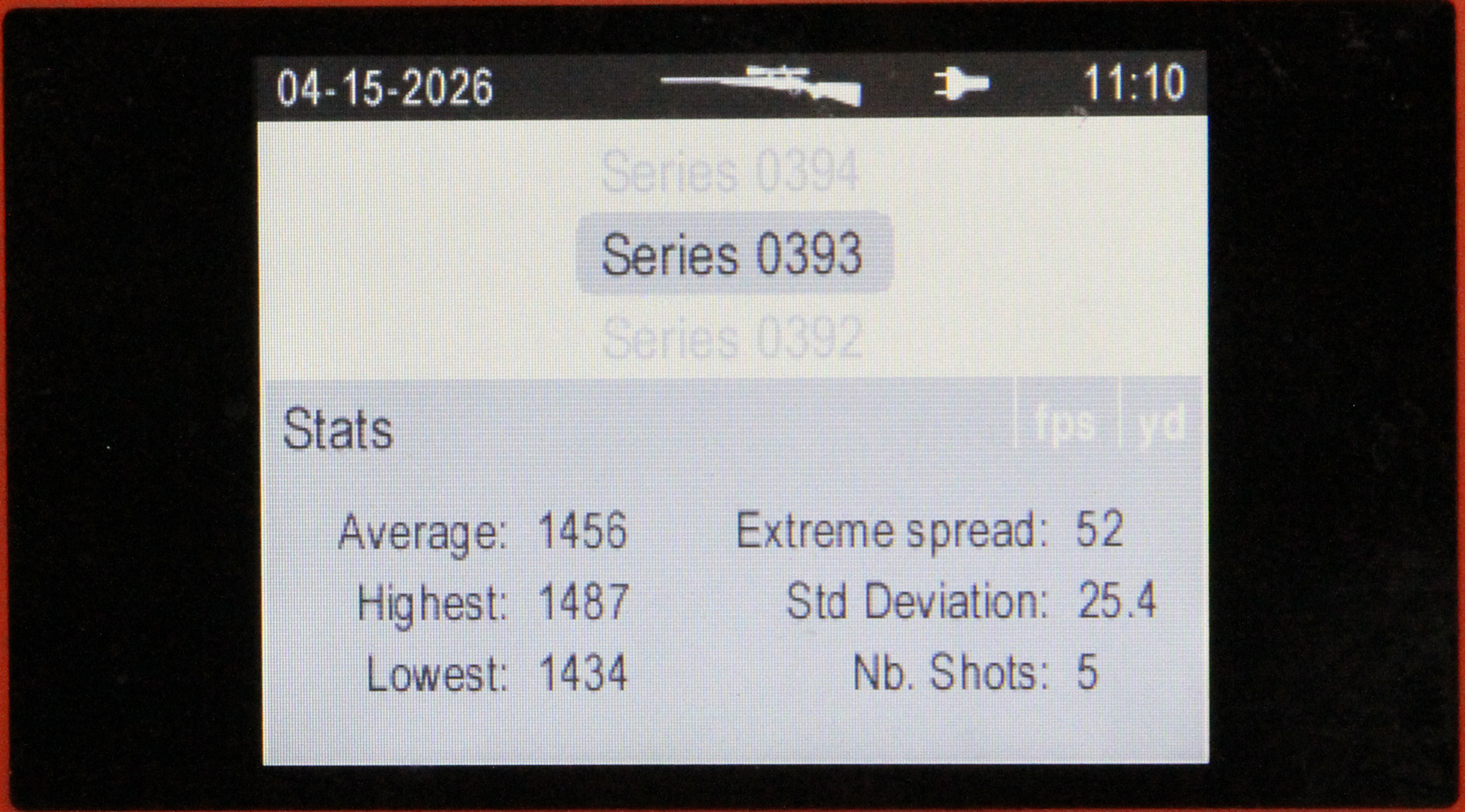

April 15, 2026 - 8:47 pm
I shot the 40 EX cases yesterday.  All seemed to fire OK.  I did something I usually don’t do.  I jumped the load by 1 full grain.  I should have re shot the 30 grains and gradually worked up from there by .5 grains.  I have no idea why these pics are loading so large and why they are loading out of order/
So here is the data for the 5 shots.  The first pic shows shot 5 data and the next pic shows the Summary of the five.

Because the pics are not loading correctly I will post a couple here.  31 grains shot 1,437, 1,434, and 1,441 fps.  32 grains shot 1,487 and 1,480 fps.  I was shooting for a little over 1,600 FPS.   But here is what happened next.  The first 4 showed no signs of pressure.  But #5 wouldn’t eject.  After I looked at the cases I saw marks that are caused by over pressure on each case.  These marks are called ejector swipes.  Look it up.  I tried my best to get a shot of these marks at 5 different angles but no individual shot would show the marks on all 5.  Here are a couple pics.  You can see the shinny spot at 12 o’clock on the first pic and the top of 2 case on next pick.
I am going to redo the 30 grains loads and go up by .5 grain jumps. I am also going to think about my filler procedure.  I may have packed these too much trying to get the wad in.

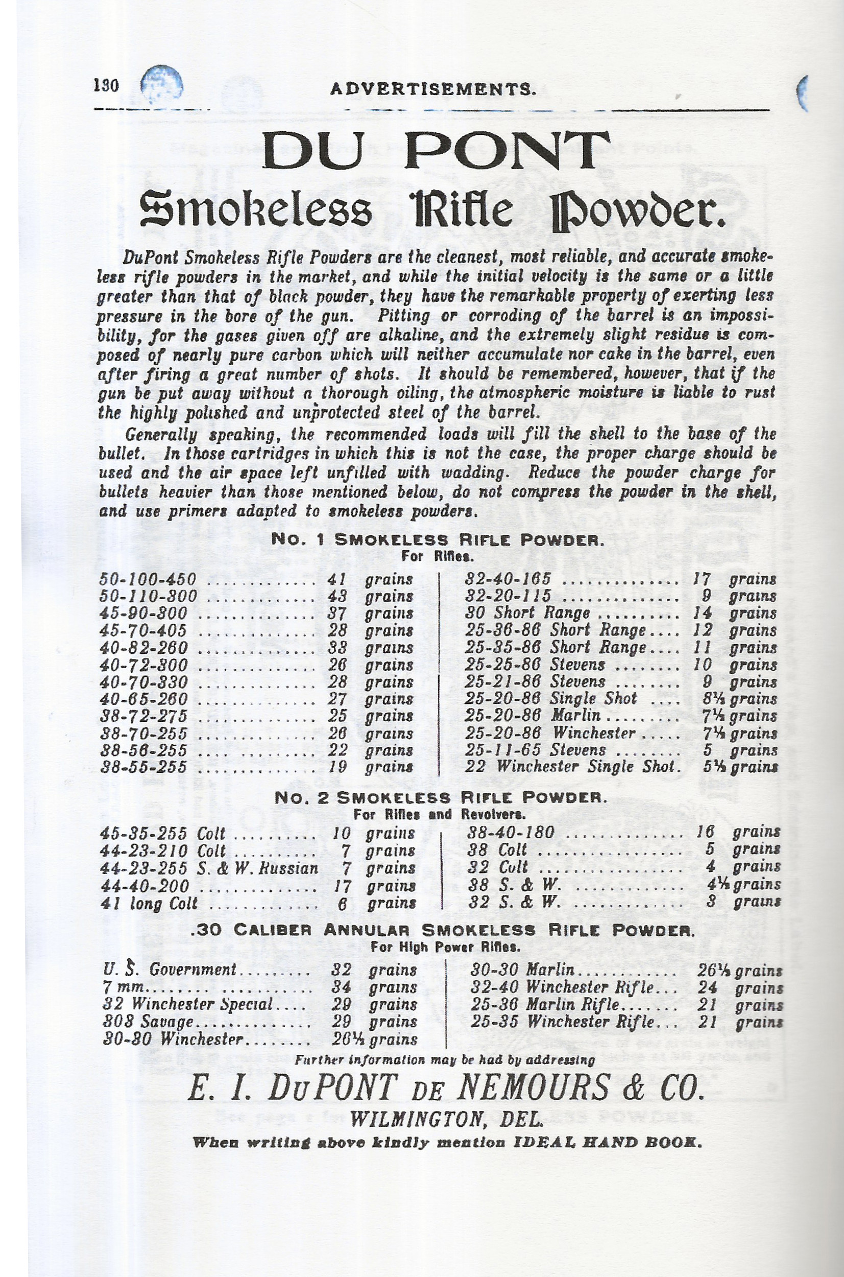

OK, I have some time between my wife’s plans for me today.
Here is a page from the Ideal #15 catalog on page 130.
Please read the second paragraph.  Dupont says to use filler.
We have to remember this data was accurate at this time.  It does not mention the 40% rule of thumb or 4198.  Nor the fact that the modern equivalents produce more pressure at the old equivalent charge a lot of the time. It also says not to compress the load like I did the last firing. Dupont-Add.jpg

Chuck,
You are back to the “apples vs. oranges”.  Dupont did not introduce IMR 4198 powder until the 1930s.  The “IMR” powders replaced the older No. 1 and No. powders because they were “Improved”.  While the older No. 1 and No. 2 powders undoubtedly needed fillers, the more advanced (modern) IMR powders do not when loaded properly.  I am of the very strong opinion that you are creating excessive pressure by using a filler to pack the IMR powder into the base of the cartridge.

Chuck,
That second paragraph does not say to use a filler… reread it carefully!  It very clearly states;
“the proper charge should be used and the air space left unfilled“

You could be right?  I read and re read that several times.  But if I’m wrong there still are credible sources that say to use a filler which I’ve always done where there is large empty space.  And these EX cases leave about a 2″ void.
Chuck,
You are back to the “apples vs. oranges”.  Dupont did not introduce IMR 4198 powder until the 1930s.  The “IMR” powders replaced the older No. 1 and No. powders because they were “Improved”.  While the older No. 1 and No. 2 powders undoubtedly needed fillers, the more advanced (modern) IMR powders do not when loaded properly.  I am of the opinion that you are creating excessive pressure by using a filler to pack the IMR powder into the base of the cartridge.
Yes, I know that but we need to find how they went from the  No. 1 and got to the 4198.  Then see what Dupont had to say.  This was the first time I had packed a load and Dupont says not to do it. I was taught not to do it.  But I did.  I will try another way to keep the powder down by the primer. “The more advanced (modern) IMR powders do not when loaded properly”.  This is conjecture on your part.  We are looking for facts.
I’m going on vacation.  Why don’t you see if you can find the link between No. 1 powder and the 4198.
