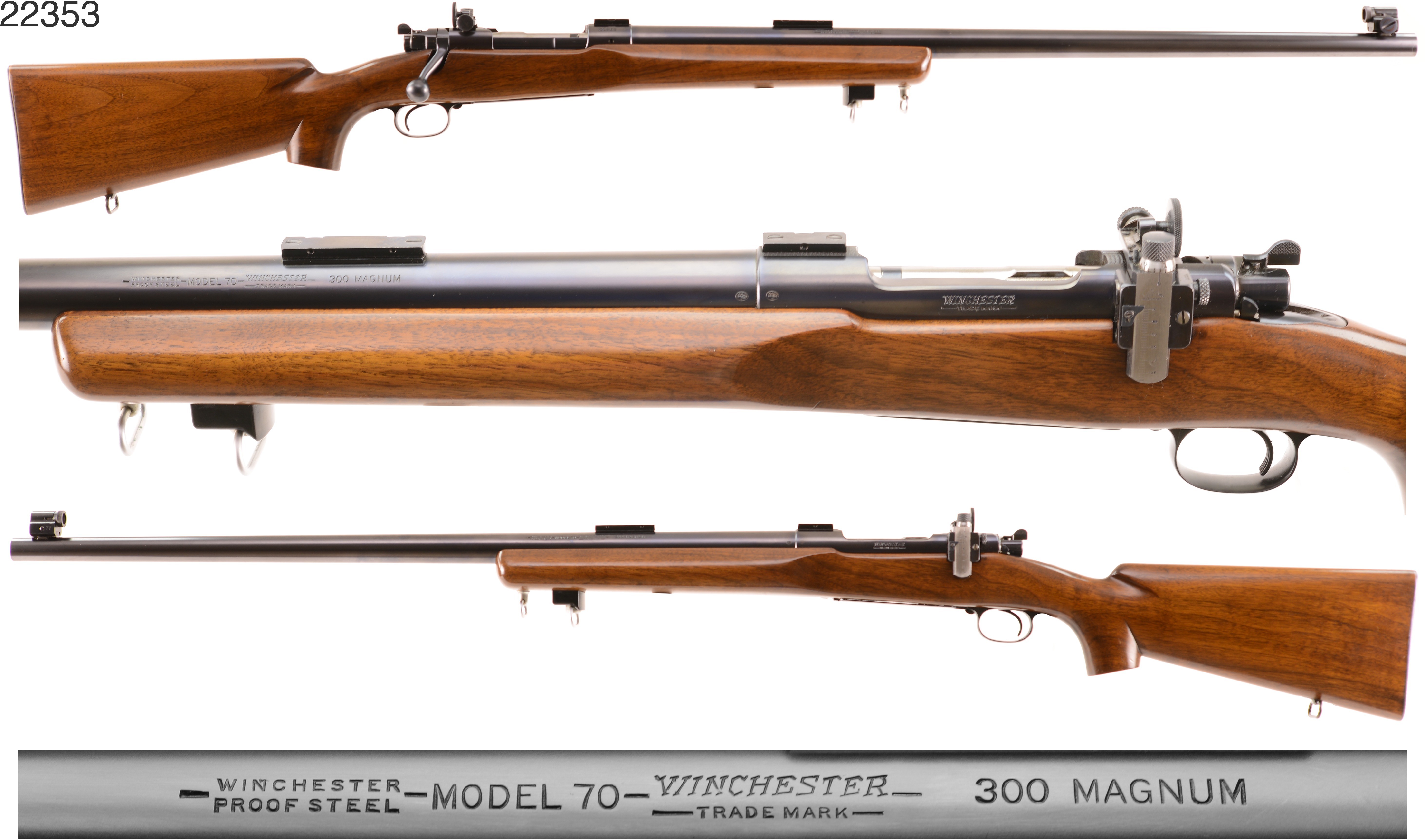

While it’s not exactly “bench rest” shooting, somebody thought that the pre-64 M70 was a Target Rifle… Wink
This from American Rifleman in 1938. New World Record of (106) consecutive bull’s eyes at 1000 yards… Laugh
Very interesting Lou.  I wonder how large the “bullseye” was.
Chuck,  you beat me to asking the same question — and I’ll hazard a guess it was big enough to see.
I found this information about Palma matches, which may or may not be the same setup as the Winchester ad was concerned with. We do not know how much of the winner’s rounds went into what size “bullseye.”  My knowledge of long range high power competition comes out of books only.
My limited understanding of “bullseye” means everything within the black scoring rings.
“A standard Palma target for long-range shooting at 800, 900, and 1000 yards has a 44-inch aiming black, which includes the 8, 9, and 10 rings. The 10-ring has a 20-inch diameter, and the X-ring (the innermost scoring ring) is 10 inches in diameter.”

That is not to low rate the shooter or the Winchester bull gun. Anybody who can dope wind and control trigger well enough to put 90 consecutive rounds from a Super Thirty into 44 inches at 1000 yards is no ordinary mortal.
However, I would argue that the accomplishment is almost completely attributable to the skill of the Rifleman, not the inherent accuracy of the rifle.
A rifle capable of 2 MOA can deliver 20 inch groups at 1000 yards. If the rifleman can keep center on the target, that is more than sufficient.
My experience with the Model 70 bull gun has consisted of picking one up at a DGCA show and wondering how long I could remain on my elbows while holding the thing in firing position. Not long.

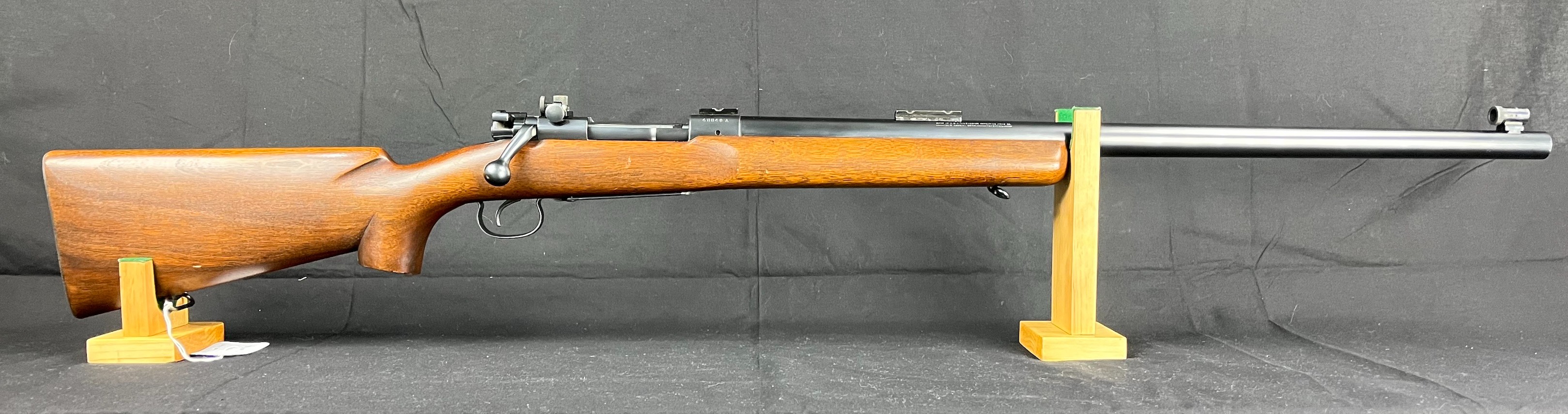

Hi Zeb-
As long as I’m doing some quick “Google-Fu”….  Laugh I found this article from the NRA Shooting Sports USA…
https://www.ssusa.org/content/the-wimbledon-cup/
In it is a brief description of the target that Ben Comfort shot at to win the Wimbledon Cup in 1935. The Wimbledon match consisted of 20-shots (plus two sighting-in shots) fired at 1000 yards with any rifle (telescopic sights were permitted).  Comfort used a 300 H&H Magnum rifle built on a 1917 Enfield action with a Winchester barrel and a 5X scope. The barrel was one of the first 28-inch Extra Heavy contour barrels in 300 MAGNUM made by Winchester.
The 1935 Wimbledon match used the “V” target, which had a 36-inch five-count bulls eye and a smaller 20-inch V-ring.  We’d call it the “X” ring on a small bore target with ten scoring rings; the “V” and “X” representing Roman numerals.  Comfort’s winning score was 100 (20×5)-14V.  So he hit the 36-inch circle 20 consecutive times, of which 14 were inside of 20-inches.  I believe that, to even be visible at 1000-yards, both the 54-inch 4-ring and inner 36-inch 5-ring of the “V” target were black, as on the “C” target I mentioned above.
What’s interesting to me, as an aside, is that in 1935 Winchester was making the M54 “Sniper’s Match” rifle.  This was the forerunner to the M70 Bull Gun and had a 26-inch Extra Heavy barrel (same as the bull gun contour just 2-inches shorter) in 30 GOV’T’06.  The Model 54 receiver as never adapted to the longer H&H cartridges, so Comfort’s Wimbledon rifle had to be built on a 1917 Enfield action with a Winchester 300 MAGNUM Bull Gun barrel…
Here’s a pic of Tedk’s M54 Sniper’s Match rifle for comparison to the M70 Bull Gun.
I’m sure Comfort’s exploits added impetus to Winchester’s decision to market the M70 Bull Gun in 1937 in 300 H&H MAGNUM as well as 30 GOV’T’06…
As for what they were using for a target in Peekskill NY in 1938, they don’t say…  But if Sam Tekulsky’s score for the 100 shot match was (99)x5 plus (1)x4 as it says in the ad, it was probably the “C” target with no “V’ ring.  So (99) consecutive shots into a 36-inch circle at 1000 yards would be my guess.

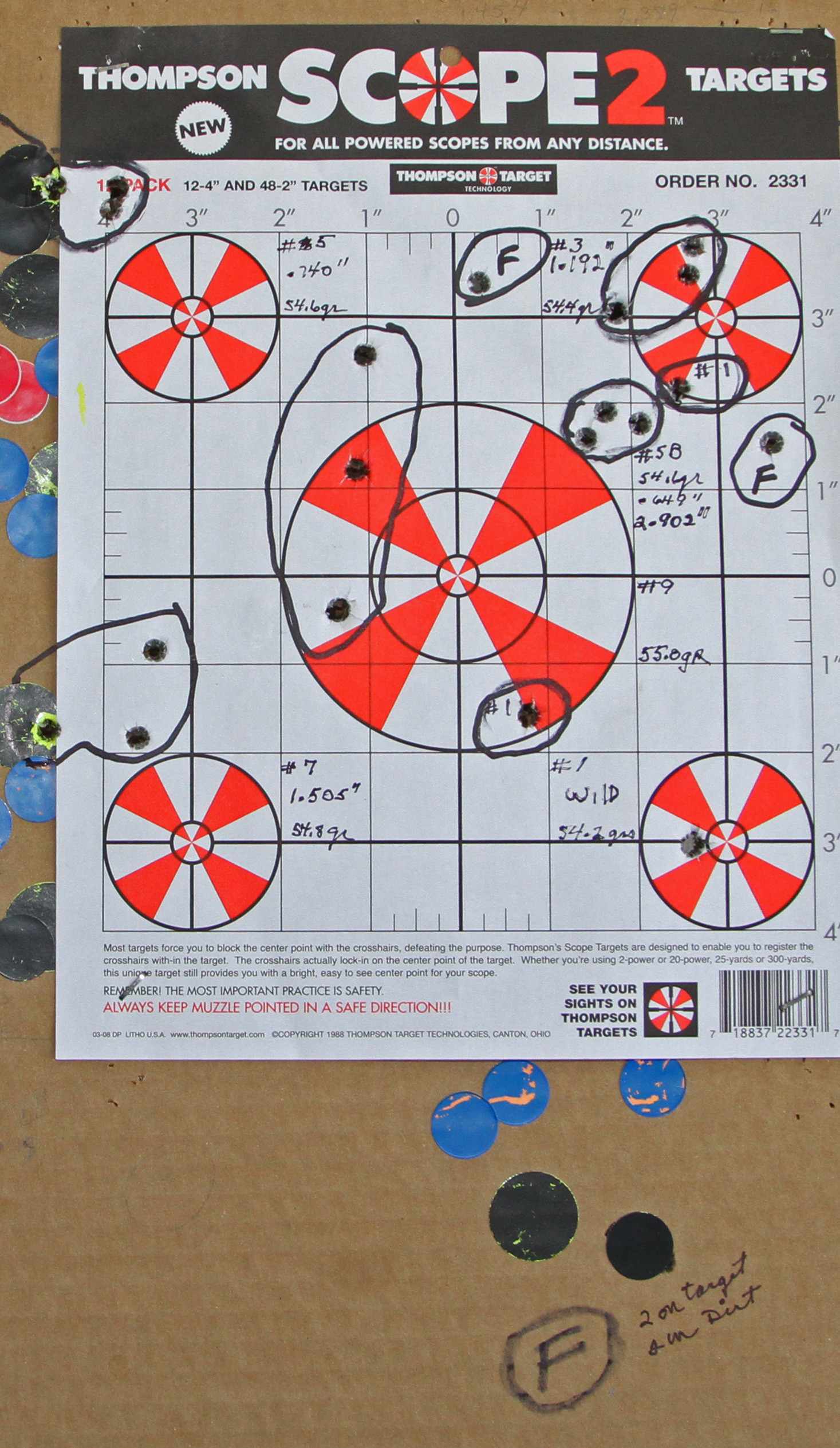

I had a weird day at the range yesterday.  I had been shooting some Fiocchi 130 grain factory ammo as foulers.  They had been shooting just over 3,000 fps.  Yesterday my first shot with these only went in the high 2,800’s and hit the target at least a foot high.  The second shot the same so the last 2 were shot in the dirt.  All were at least a 120 fps slower than before?  The first 2 messed up my target by making extra holes. I had been holding at a spot way below the target.  But each of these created a hard bolt lift?  This means higher pressures but at a slower speed?
Last week I bought a box of Hornady 130 grain flat based bullets to test.  These are my first shots.  I screwed the forearm screw in by about a 1/2″ to be in the area where the bullets were shooting the best.
I started on the lower right and shot 5 ea 3 shot groups going counter clock wise and ending in the middle while shooting a mini powder ladder.  I was looking for 2,800 fps.  The first group at 54.2 grains shot at 2,707 fps but was so wild. 5.159″.  One of the bullets hit in the target in the upper right.  The next group at 54.4 grains produced a group of 1.156″ at 2,719 fps. (the target is not marked correctly)  Third group at 54.6 grains produced a group of .740″ at 2,745 fps.  Fourth group at 54.8 grains produced a group of 1.505″ at 2,769 fps.  The next group at 55.0 grains produced a group of 2.915″ at 2.808 fps.  I keep notes as I shoot.  Good thing, it was hard enough to keep track of the holes.
I really liked the group at 54.6 grains so I shot another one that was the same load.  It produced a group of .649″ at 2,764 fps.  I was aiming at an intersection on the very right side and in the middle of the target.  It grouped high and to the left of my point of aim.
The 2 that are circled and have a F are the 2 foulers.   Below the target there is another circled F where I was aiming when shooting the first 2 foulers.

Nice! As you know I have a few Post-64 M70’s that do very well with the flat based Hornady .30 bullets so it’s no surprise your .270 likes them. Even when bullet weights varied by 3-4 grains they performed well in my rifles.
I’m puzzled by the Fiocchi performance, sounds like a bad lot of powder or bullets or both. I have no experience with Fiocchi brass so I don’t know if it would even be worthwhile to pull the bullets other than to satisfy your curiosity about what kind of garbage was stuffed in there.

Chuck,  I’m with Mike.  My knowledge base doesn’t cover this!  They are supposed to be high quality ammo makers.  Kind of wonder at bullet diameter or such, but I am definitely out of my depth here.  Tim

The biggest question is why did they shoot OK pressure wise the week before?  And faster?  I’ve been thinking about this and wonder if I didn’t clean the chamber?  An oily chamber can cause pressure issues.  The temp was 20 degrees hotter but it is still weird.  I will shoot at least one more on Tuesday.
If I have time I’m going to pull the bullets and reload the powder for the 32 that I have left.  I’m going to experiment each side of 54.6 grains.
