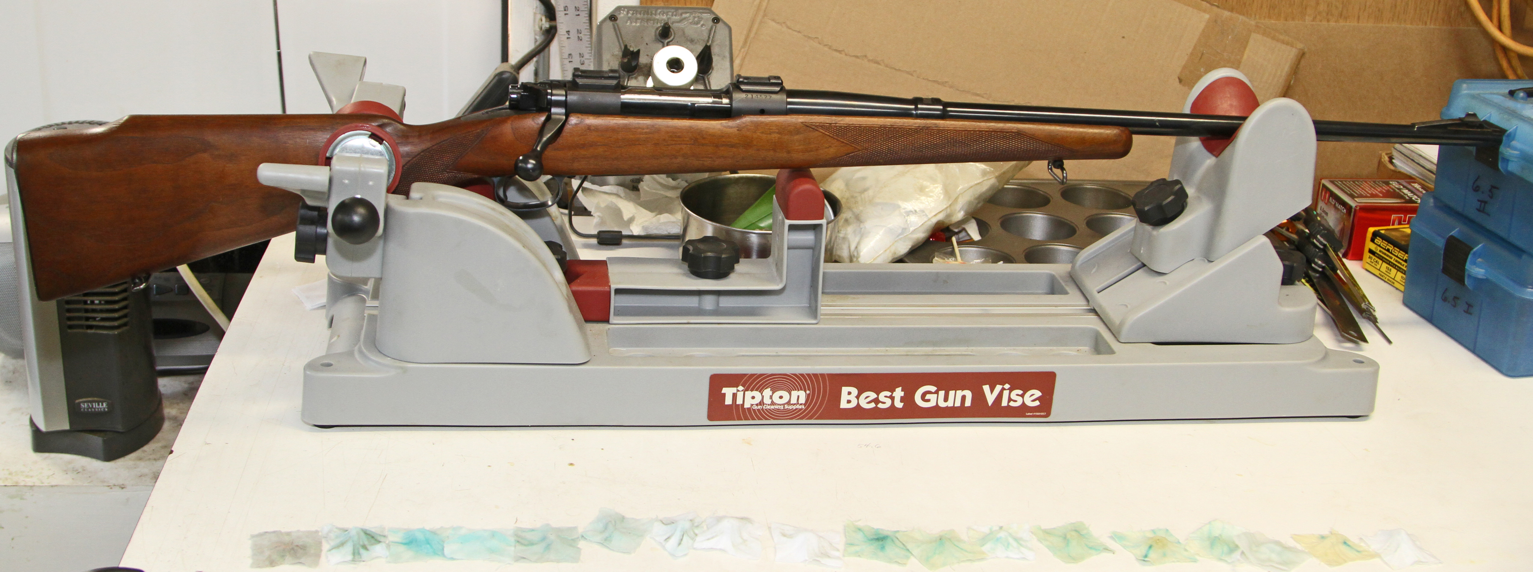

I know I said I was done posting but after getting everything done I took a couple of picks.  The rifle is cleaned, stripped and ready to go into the safe.  I won’t miss cleaning this rifle.  Look at all the patches it took to get the copper out.  I used both sides of each patch.
