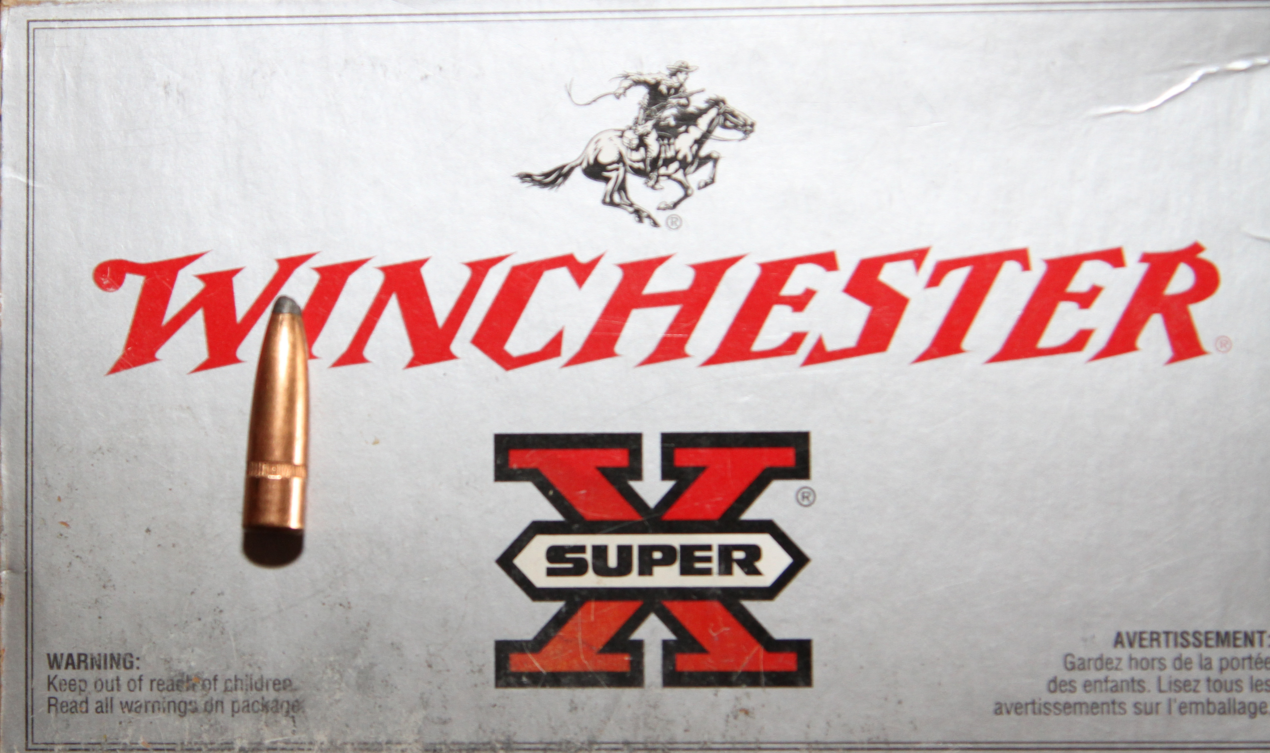

I pulled one of the bullets from the Winchester ammo I was using as foulers.  Flat base.

I’ve never had much luck with BT bullets, I think they generally don’t offer much ballistically inside of 300 yards and my rifles seem very happy with traditional Spitzer bullets. The only exceptions for me are .223 and 22-250. I don’t recall the twist in your M70 so it may like them. My 30-06’s seem to have a dislike for them but I’ll be revisiting that in a future project. I think my 30-06’s have too slow a twist to keep a BT bullet happy but that’s just a hunch. Just started my second cocktail so tables and calculators are not on my agenda tonight.
