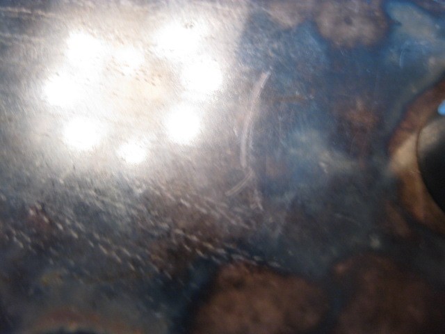

Based on the above discussions I still am not sure what I have, A really nice old gun or a restoration. I have contacted Sara Turnbull and she was nice enough to search their database and the gun’s Serial Number it was not found. Checked the lower right tang for Rodger’s mark and it is not marked. So here it is for all to see and comment. Note the only visible wear is on the two high points of the butt plate as if it was stored upright sitting on the plate. The wood is not fancied up as with a lot of restorations.
NOTE: When you comment I would appreciate a confidence factor, on a scale of 1 to 10. One (1) being, I just logged on for the first time, I’m a Democrat and I just wanted to provide my expertise. Ten (10) being, I taught Bert everything he knows. Thanks.
Cheers
Kirk
IMG_2996-2.JPGIMG_2998-7.JPGIMG_2999-3.JPGIMG_3001-1.JPGIMG_3002-2-3.JPGIMG_3003-2-2.JPGIMG_3004-2-1.JPGIMG_3005-2-4.JPGIMG_3008-2-2.JPGIMG_3010.JPGIMG_3011-4.JPGIMG_3012-2.JPG
You need to put a LED light on the barrel.  No matter the age and condition, an original barrel will show brown deep in the blue.  If no brown a 100% factor for a new barrel.

Like Chuck said, in a dark room, take a flashlight and shine it on the barrel and magazine tube and you should be able to see the underlying rust or patina/brown.  Then compare that to another winchester barrel known to be original finish and compare the two.  Its odd the weld for the front sight post did not take the blue, note the lighter halo around the post.  The wood on the forearm, at least in the photos, shows a little more open grain than does the buttstock.  Is that open grain due to finish wear and how does that relate to the overall condition of everything else.
There doenst appear to be much of any wear on the high points of the barrel bands.  Would anticipate seeing some fading on the CCH whether on the buttplate, lever, or receiver if original.  Especially the buttplate where the weight of the gun sat on an underlying surface for the past 100+ years if stored that way.  Would expect to see potentially more yellow/red/blue and less of the heavier brown in the CCH.  Would compare the CCH to other known original guns to compare the color, CCH pattern, etc before making a call.  You may also compare the CCH to other restorers work besides Turnbull to see if there are any similarities in the CCH color combinations or patterns. There are a number of them out there easily found on an internet search.

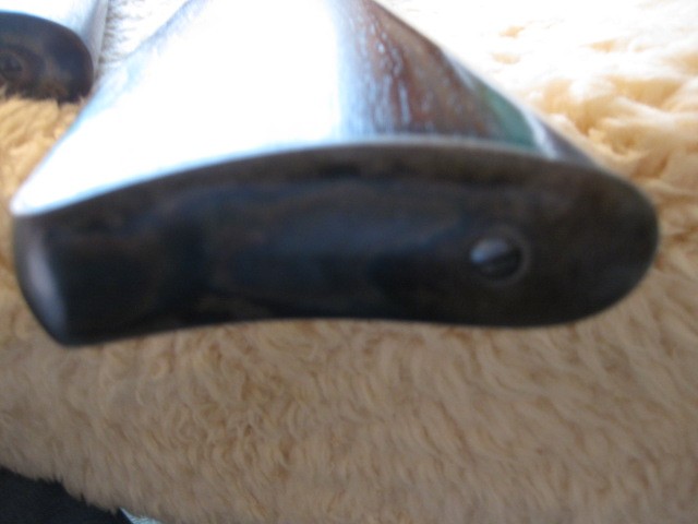

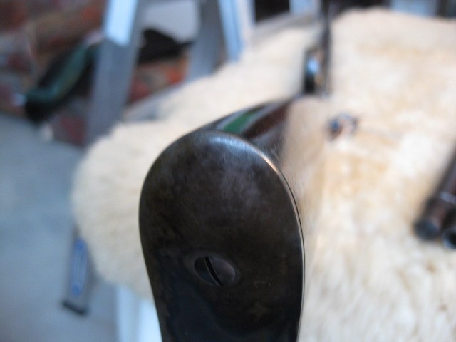

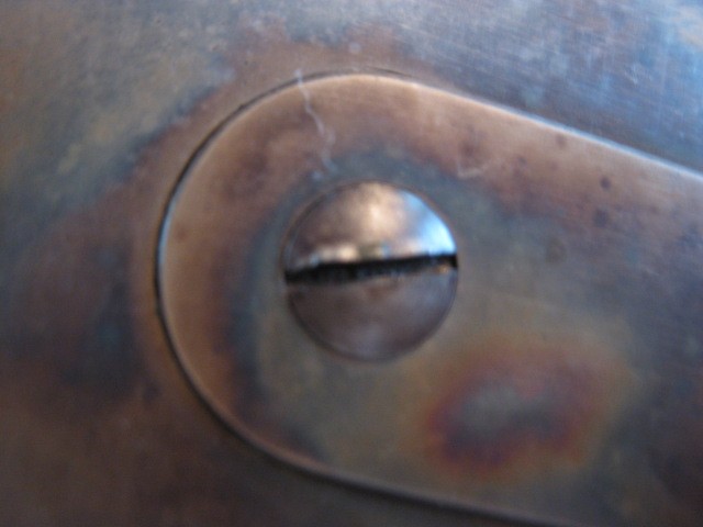

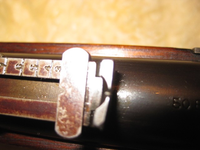

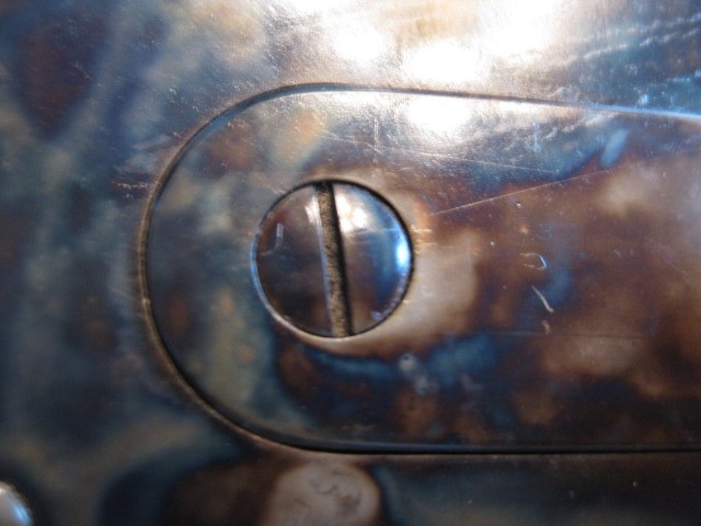

IMG_3196.JPGIMG_3204.JPGIMG_3205.JPGIMG_3210.JPGIMG_3212.JPGIMG_3207.JPGIMG_3208.JPGIMG_3217.JPGIMG_3218.JPGIMG_3222.JPGIMG_3198.JPGIMG_3202.JPGIMG_3203.JPGThanks to TR, Mike, Clarence, Mavrick, Marcus, Steve004, Bob, 1892takedown and Henery Mero and anyone else I may have missed.

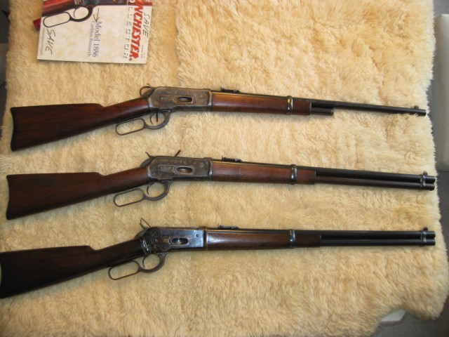

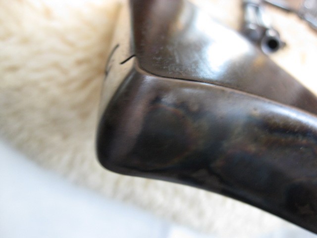

You guys have raised several issues and requested additional info/photos.  Additionally, I have pulled out a couple of my Model 1886 Carbines to make comparisons and to better understand what you are telling me. See photo 1. The top is a 1/2-barrel Carbine Cal. 50/110 Manuf. 1899. The middle gun is a Cal. 45-70 Manuf. 1884. The bottom Carbine is the gun in question Cal 50/110 Manuf. 1893. All have lettered as described. I have addressed the issues you folks have raised as follows:

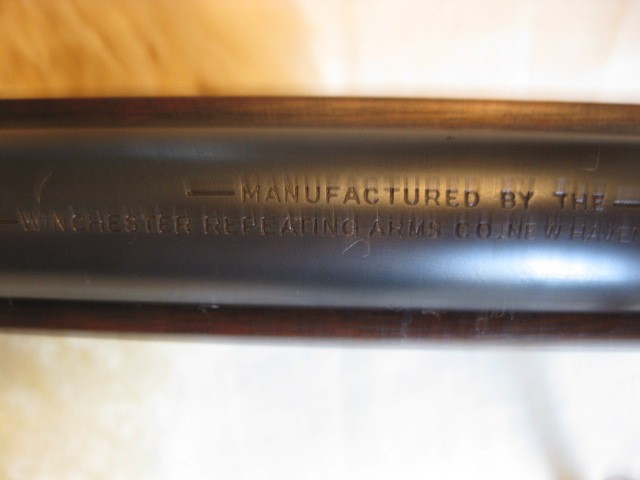

1 Mavrick/Issue: The forearm barrel fit should be “nice and square with the barrel”. Photo 2 the question gun. Photo 3 is of the other Cal. 50/110. The photos show a difference. Explanation?

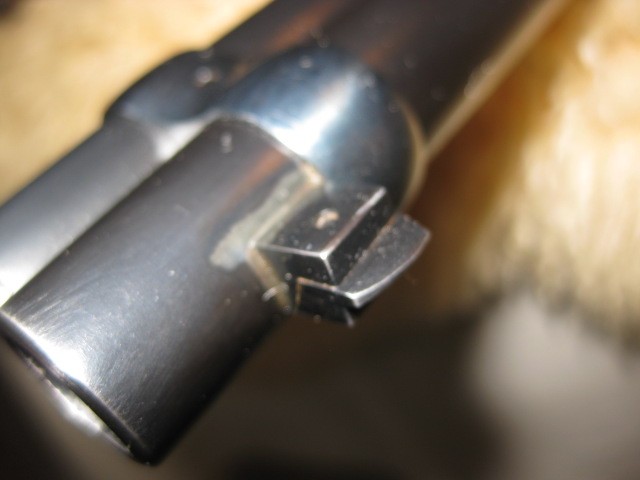

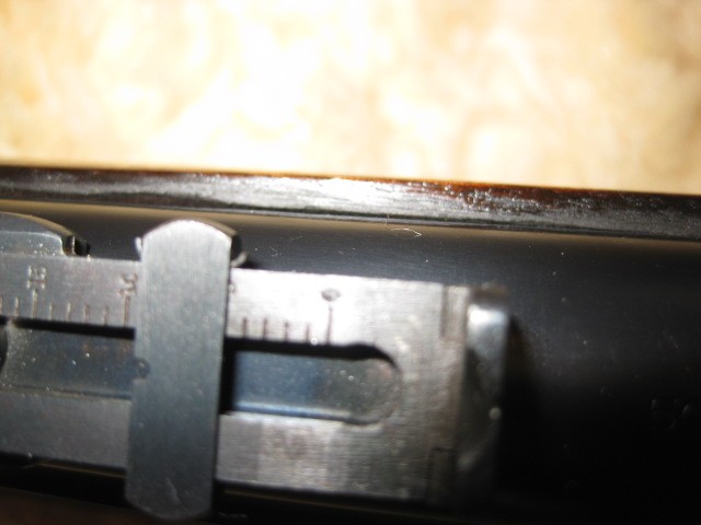

   Issue express rear site: Photo 4 is the rear site on the question gun. Photo 5 is a photo of the other 50/110. The 45-70 also has the same site. All three have the same sites.

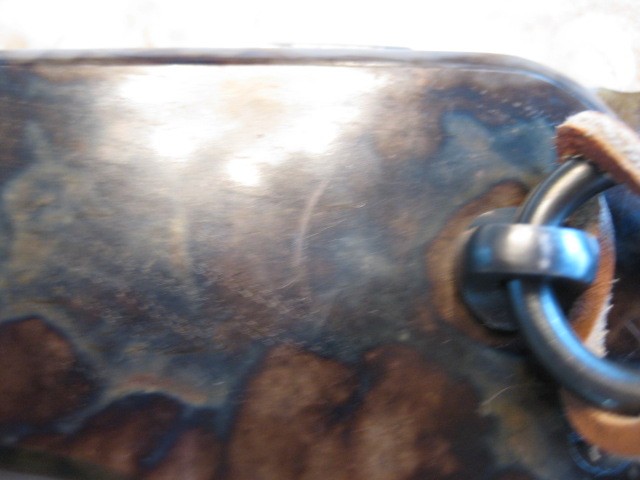

2 Marcus/ Issue: Wanted photos of the saddle ring ware. See photos 6 and 7.
3 TR/Issue: Chatter marks on the screw heads. Not sure what that means but I have provided photo 8 of the screws of the other 50/110 and photo 9 of the gun in question.
4 1892takedown/Issue: “Front site post did not take the blue”. See photo 9. Good eye. Explanation?
    Issue: Wood grain match and condition. The photos are misleading. The wood grain is a match in both grain and finish. The condition of the wood is consistent with the rest of the gun.
     Issue: CCH The comparison with the two other Carbines shows a similar color and pattern. See photo 1. Needs more research.
5 Henery/Issue: Lack of ware on sharp edges ETC. The only visible ware is on the two high points of the butt plate see photos 11,12 and 13.
6 Issue: Bright light on barrel and tube. A couple of you have mentioned using bright/LED light to show brown in the original blue. I have done this, and I see no brown. I have used this method before. It seems to work fine on guns that have some aging/patinaing on the blued surface’s. What I have also noticed is that on very high condition guns with 95%+ blueing it does not always show the browning. Comment?
COMMENTS/CONCLUSIONS?
Cheers
Kirk

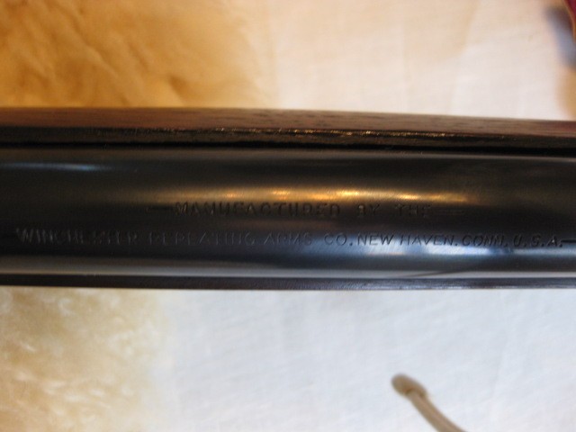

I had concerns about the shallowness of the barrel address.  The recent photos (#2 and #3) are dark and blurry.  But, you had posted a much clearer photo of the barrel address earlier.  I compared that to photo number 3.  Given you are able to hold them in your hands, what is your assessment when you compare the barrel addresses?

  When Winchester made the screws in the late 1870’s, 80’s, and sometime into the 1890’s the screw heads had a machine chatter look. If you look at a minty original head you see tiny flat cuts, to the best of my knowledge no one has duplicated this. If the screw face is cleaned up, worn, or replaced with a after market screw the face is perfectly smooth or has circular marks. The chatter marks are visible on the the larger screw heads. If the screws are replaced or cleaned that does not make the gun restored, but if some of the screws do have the chatter marks and haven’t been turned, in my mind Winchester put them there. Original screws that have not been turned is one of things that separate mint from high end restored. T/R

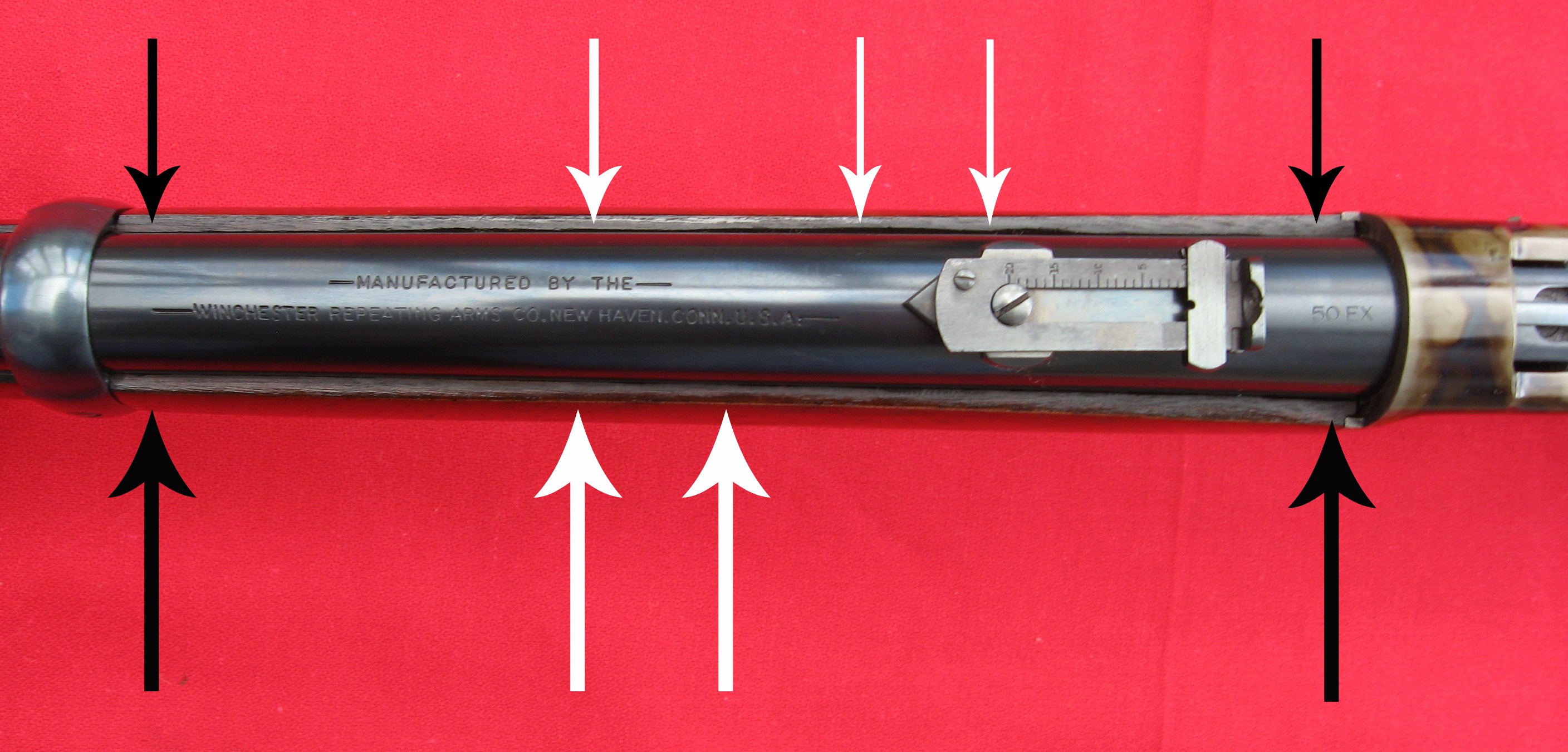

BarrelWoodFit.jpgIf you compare where I have put the white arrows verses the black the appears, the white areas appear to indicate wear vs black no wear. Which I would expect this as for normal wear on a SRC to have with some use. But I find it inconsistent with the rest of the wear on the carbine. But this is hard to tell from photos the level of wear.  I would expect the level of wear on the wood to be on a gun with lesser condition in my humble opinion.
Of the two photos shown, the measurements on the leafs are at different increments.
