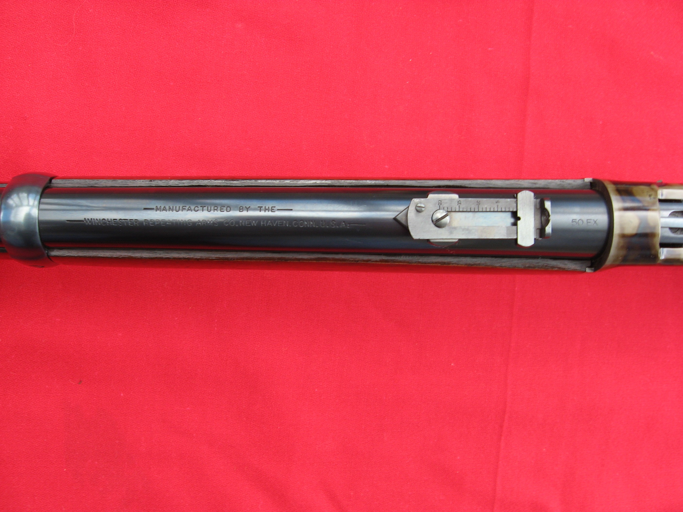

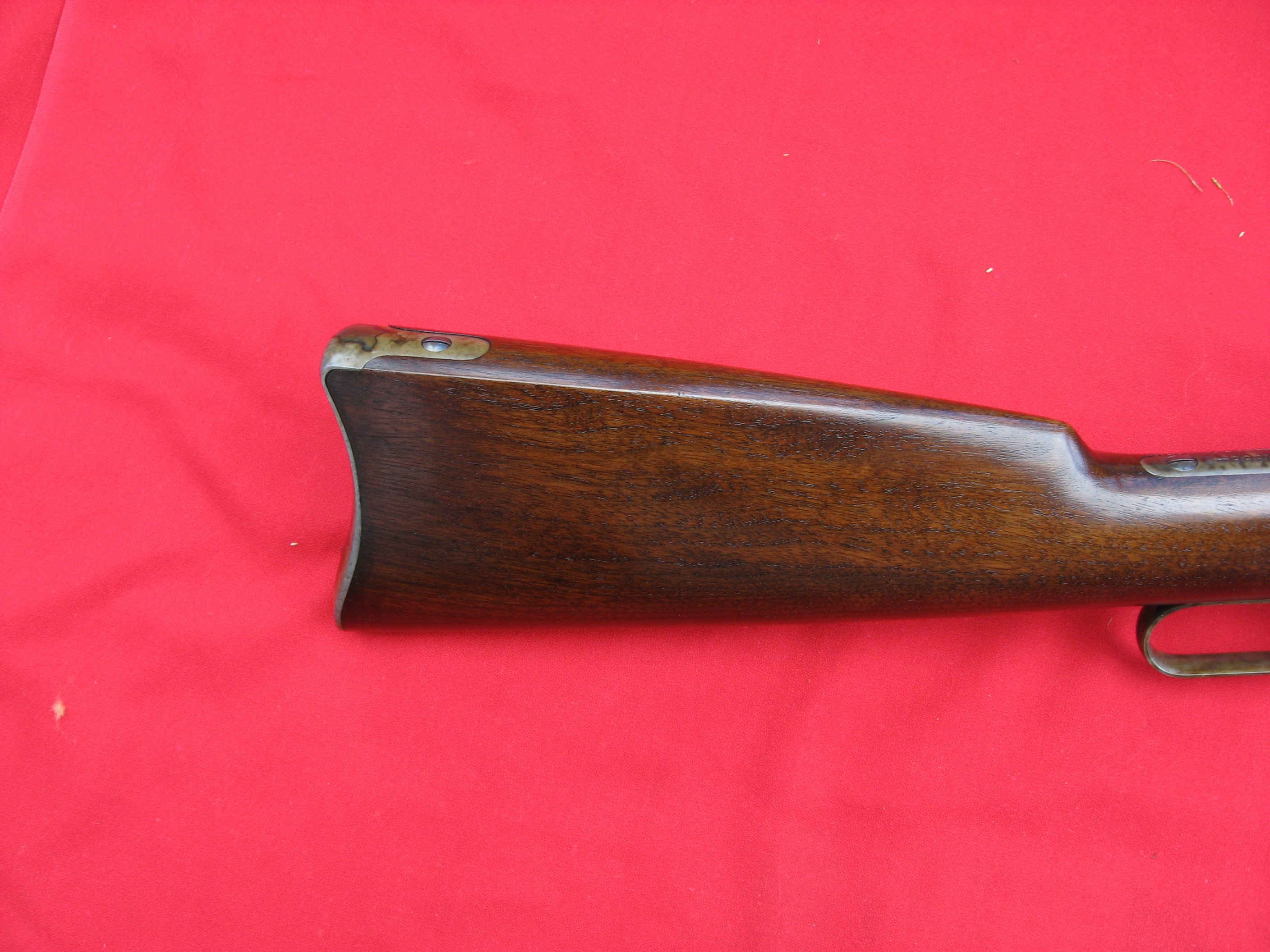

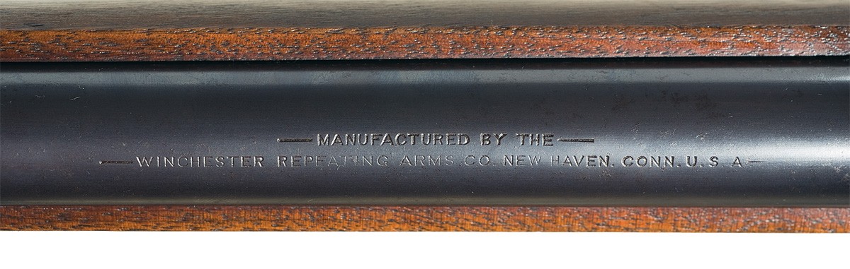

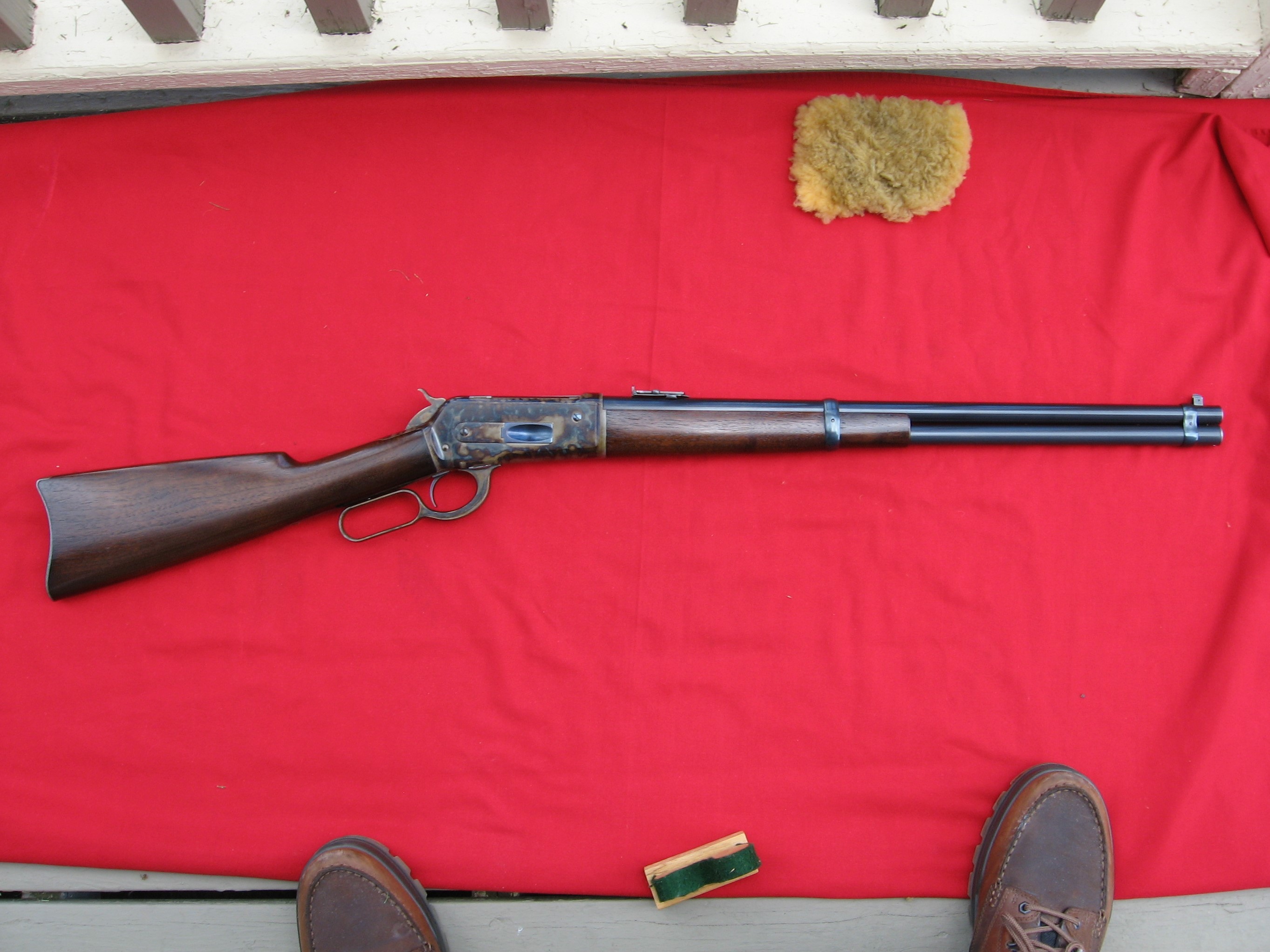

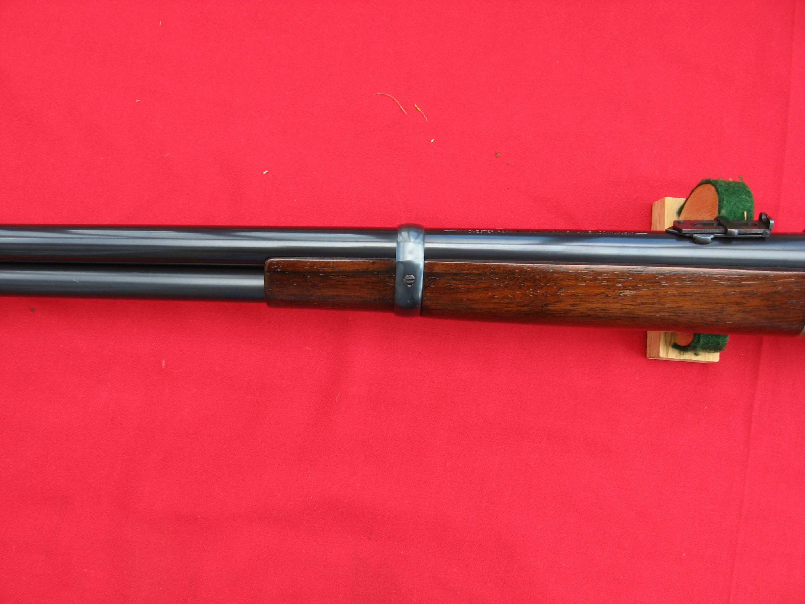

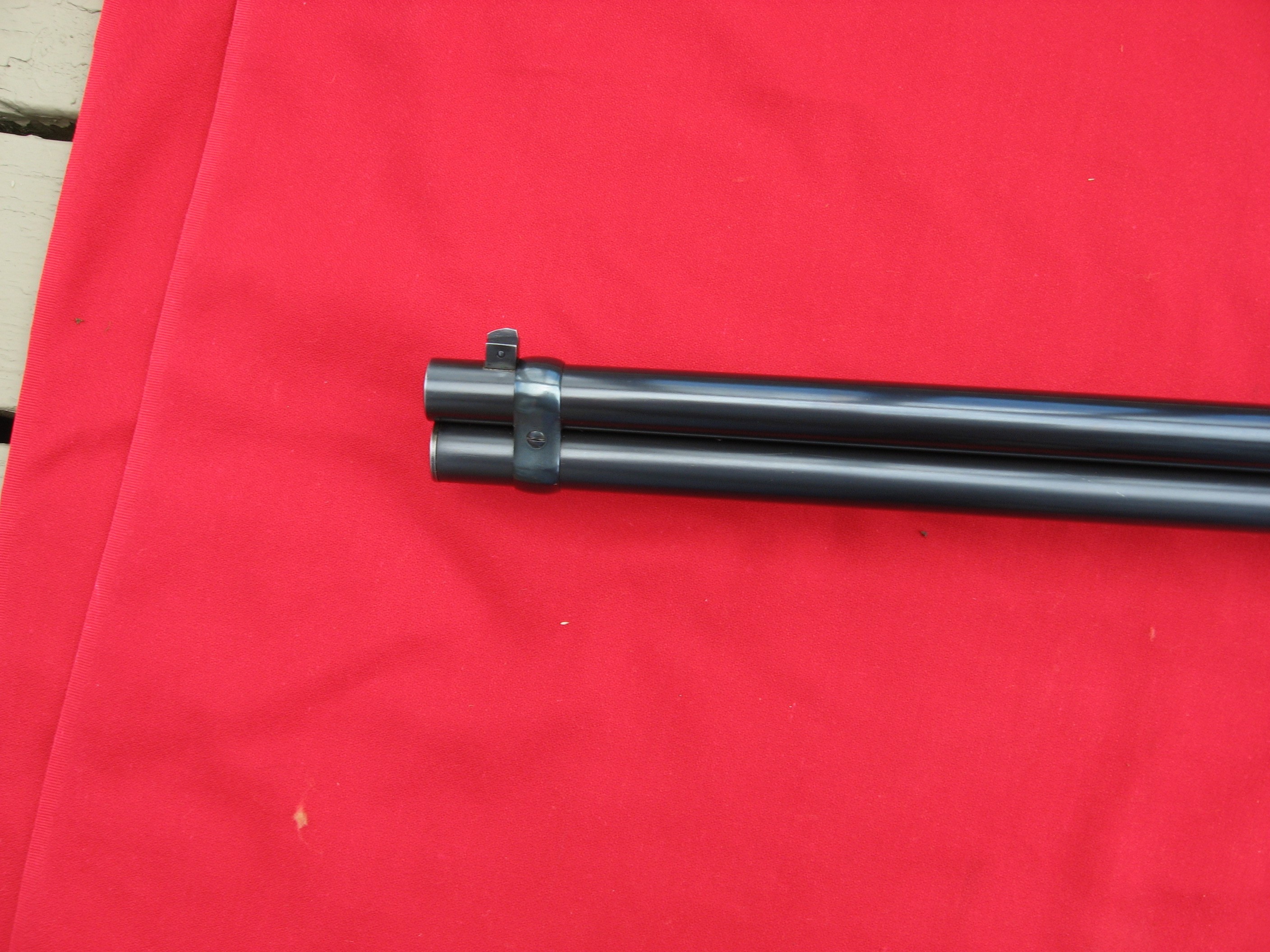

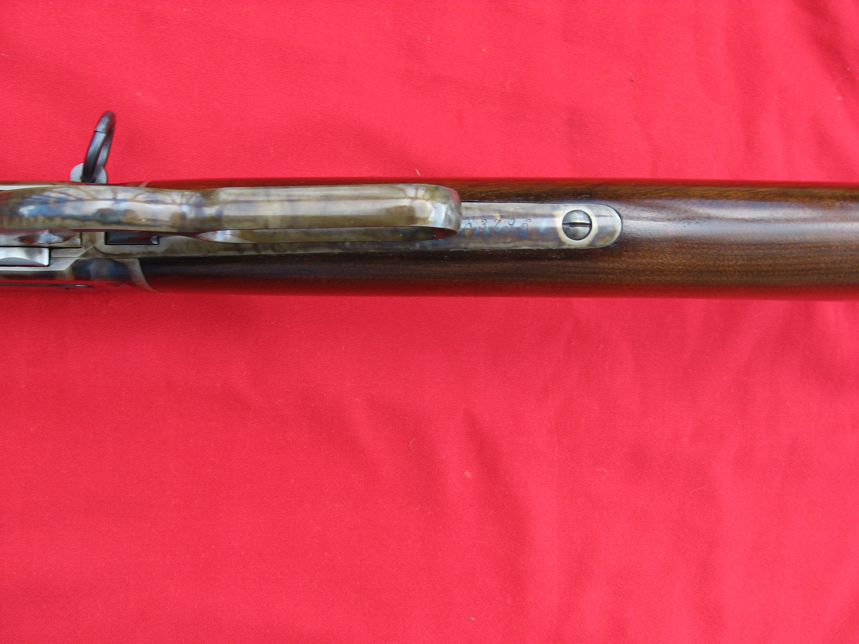

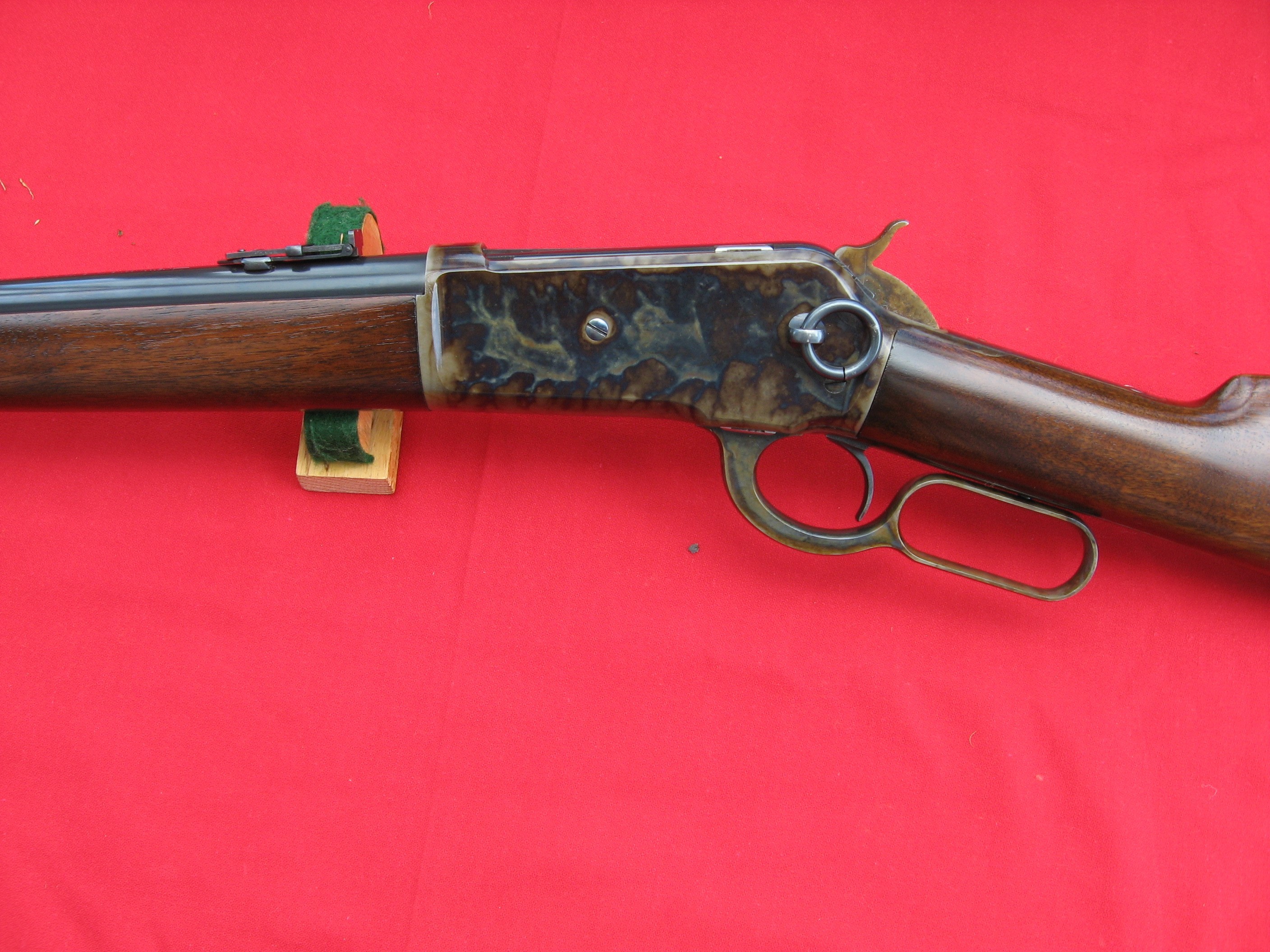

Based on the above discussions I still am not sure what I have, A really nice old gun or a restoration. I have contacted Sara Turnbull and she was nice enough to search their database and the gun’s Serial Number it was not found. Checked the lower right tang for Rodger’s mark and it is not marked. So here it is for all to see and comment. Note the only visible wear is on the two high points of the butt plate as if it was stored upright sitting on the plate. The wood is not fancied up as with a lot of restorations.

Looks like a 10 to me, perfect wood to metal fit…

The shallowness of the stamping of the barrel address (middle section) leaves me wondering.

That alone is not conclusive, because the best restorers can achieve such a perfect fit.  However, I’m inclined to believe it’s the “real thang,” stored in a nitrogen chamber, bank vault, or who knows how.  Ought to be provenance for a gun in this cond., like being in the personal collection of Edwin Pugsley, or some other famous collector.

With a confidence factor of 2.3 I’ll opine that we are looking at a very nice restoration. To my eye the only clue is the wood finish but there are likely others for those who are more familiar with the correct stampings. My biggest problem with the gun is that it’s simply too good to be true. I hope I’m wrong.

How’s the underside of the barrel, tang and wood marked? Does it have matching numbers? Is the barrel marked as it should be? Any sign of pitting on the barrel?
If it hasn’t been restored, its most certainly been well cleaned. I’d expect some dirt, dust, grim around the receiver and barrel. Along with other areas. The lack of wear, even slight wear in areas is odd to me. Normally you see where the sling ring has rubbed on the receiver, leaving a mark. Also it being a SRC, the receiver itself doesn’t show much handling. I’d thought you would have slight wear on the CCH finish.
I don’t like the forearm / barrel fitt. I would expect for such a high condition throughout that the top edge of the forearm to be nice a square with the barrel. But the light marking of the barrel address doesn’t bother me though as it appears common. I’d be more concerned if it wasn’t light in the area.
barlad.jpgThis is the kind of forearm to barrel fit I’d like to see. I’m also surprised it being in 50 Express caliber that it doesn’t have a Express rear site.
I’m on the fence with at a score of 5. I’m hopeful that’s its real but can see reasons for some doubts.
My two cents, for what its worth.

The fit of some components, especially the forearm, is troublesome.  As Maverick already suggested.  Also, the bluing hue isn’t quite right, but that could be the photographs.
Can you provide enlarged photographs of the contact area of the saddle ring with the receiver?  I would expect at least ever so slight wear.
