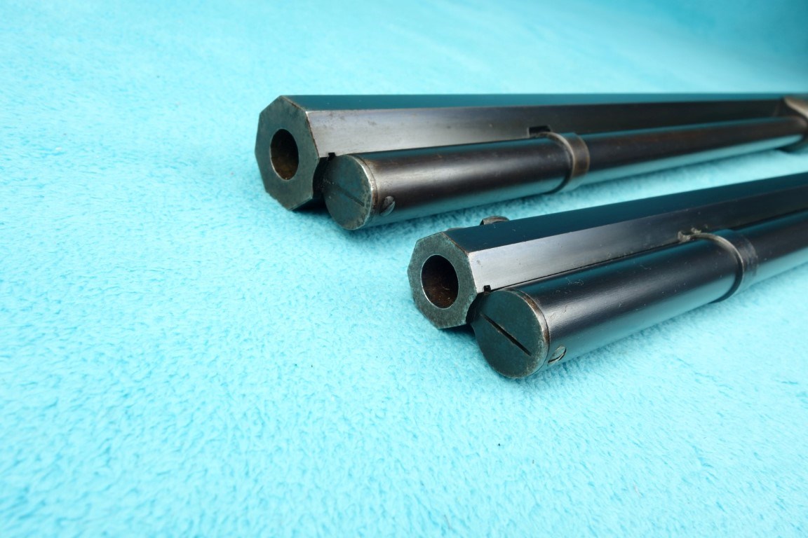

Austin,
What is the barrel diameter (opposing flats) just forward of the frame ring?  I suspect that the extra heavy barrels Winchester used on the Model 1886 rifles were reworked Model 1885 No. 4 or No. 5 barrels.
Bert, Dimensions as follows:
Muzzle – 1.095″
Forend cap – 1.157″
Breech – 1.196″
Austin
Standard .50 caliber muzzle comparison:
Forum Posts: 14830
45
March 6, 2018 - 3:39 pm
Austin said
Austin,
Muzzle – 1.095″
Forend cap – 1.157″
Breech – 1.196″
Austin
Thanks!
The dimensions you provided indicate that it is larger than a No. 5 barrel, but not quite as large as a No. 6 barrel, which tells me that Winchester specially made the barrel for your rifle.  It would be interesting to measure several Model 1886 extra-heavy barrels to see if they are consistent in size.
