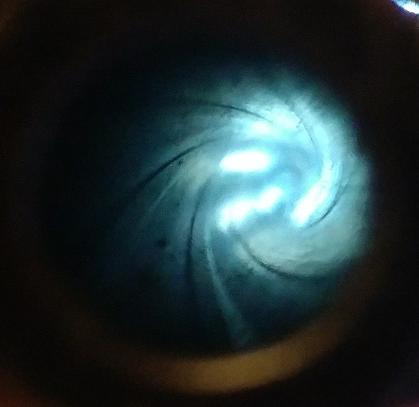

The bore is what I consider frosted, sort of a matte stainless look, with strong rifling and no signs of pitting or dark spots. I had difficulty getting a good picture of the entire bore. Every strike against this rifle will be used during negotiations, after all you make your money when you buy a rifle.

I would like to thank both of your fellers for your input, which pretty well confirmed my own feelings on the subject. I have found reference to the Madis research being flawed and that these are the numbers found in the Blue Book and used on all of these “calculate the age” websites. Using that scale this rifle does show as being from 1894 but also shows my rifle as being from 1899, which has now been confirmed to be from 1903. Oddly enough it seems the ATF still recognizes these numbers as being the correct way to date a firearm.
I did manage to get a few “better” shots of the bore on the 36″.
Bore 1
bore 2
bore 3

That looks like a great bore, especially for its age.
