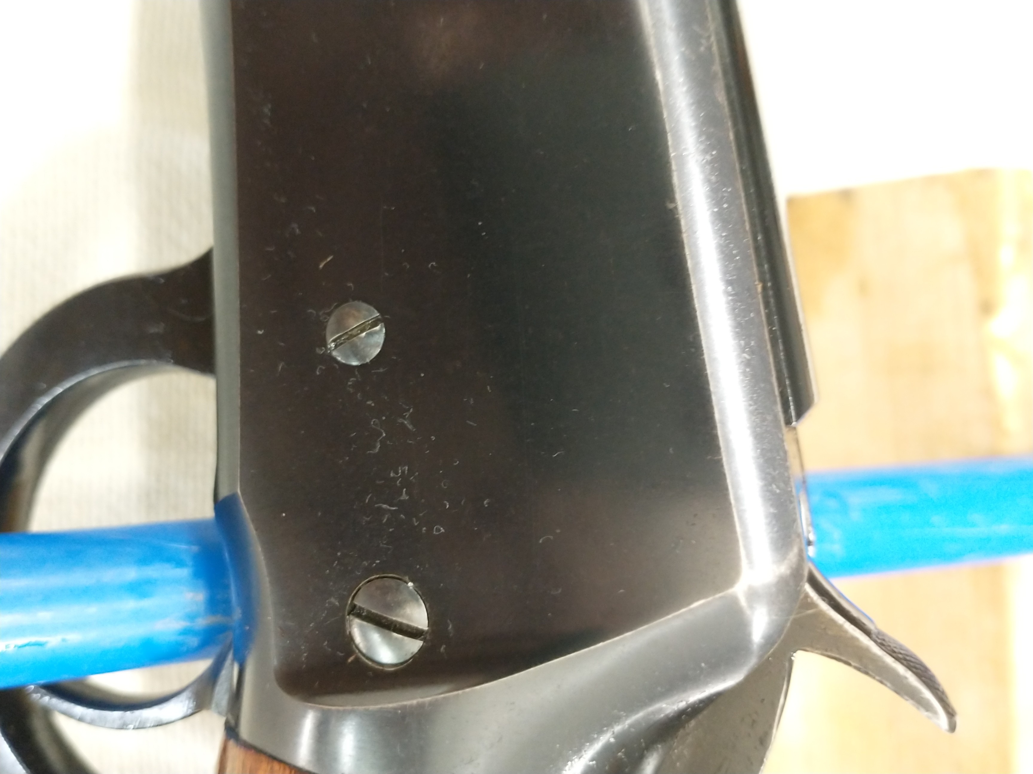

I think I can only send 2 pics at a time. No one ever showed me how to post this stuff.IMG_20220830_103124515-1.jpgIMG_20220830_102615870-1.jpg

Welcome, Jeff. Nice looking carbine! Good job figuring out how to post from a phone, pretty amazing technology once you figure it out but a constant source of frustration for some of us. I’m thinking a pic of the front half of the barrel from the side would be helpful.

REALLY nice carbine! Lots of finish remaining. And a deluxe as well.

Unfortunately I have bad news for you.  When I originally surveyed the S/N on your Model 64, it was a standard Model 94 Carbine in caliber 32 W.S.  I am relatively sure who it was that intentionally reworked it to sell resell it for a large profit. Contact me directly if you want more information.
