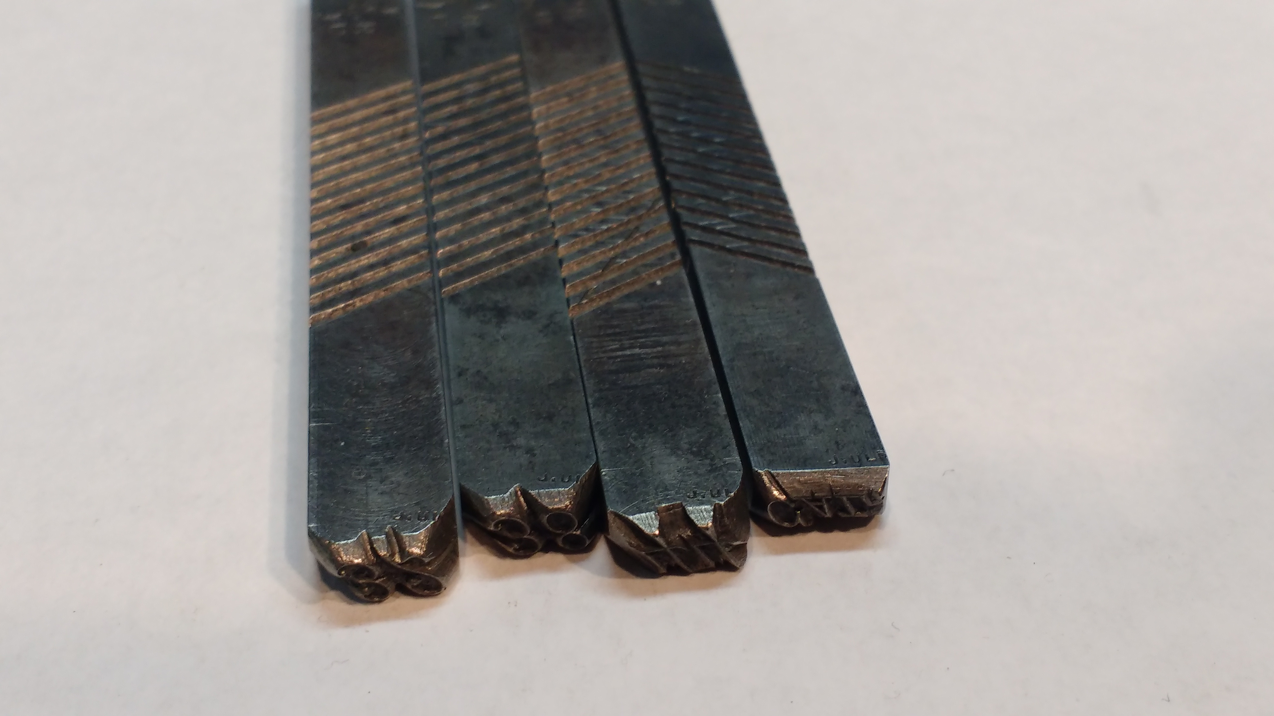

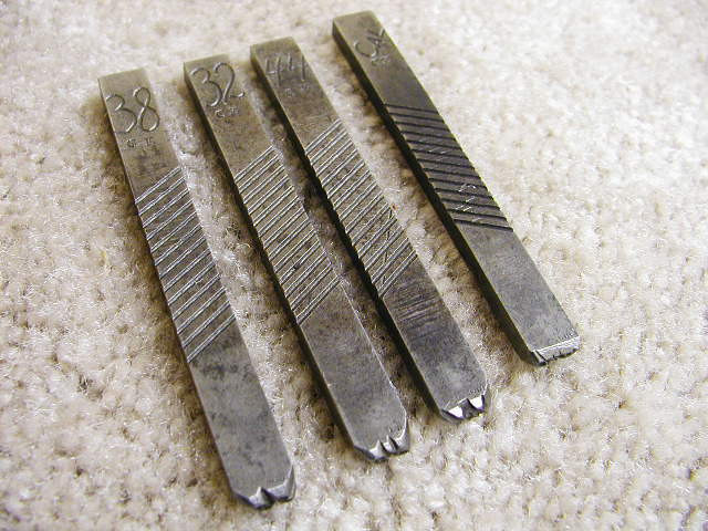

Some of you have seen these before but here are the actual elevator stamps for the 73. These were made J Ulrich and are marked . They put their names on them so they could be returned to the engraver to get repaired. There would of been several copies of each one depending on how many workstations were stamping them and you need extras to replace ones that get damaged or worn and have to be repaired. With each one a hand made stamp their would be difference in the shape of a letter or number from one gun to the next.
Forum Posts: 5882
48
May 26, 2020 - 12:58 am
Bob – I had not seen those before.  I’m glad I have.  Very cool.

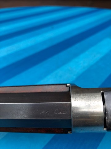

Here are some photos of markings on a later gun of mine to compare- serial # is 50062.

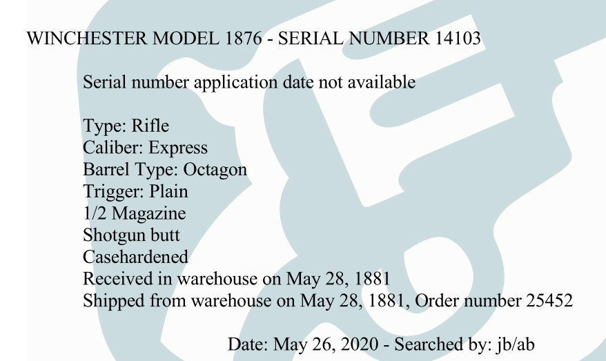

I been holding back some information about this gun and wanted to verify it before saying anything. This gun showed up in a old survey I got from another collector and described the gun except it said it had a Shotgun Butt. I just got the Cody email and it letters Shotgun Butt. That is why there is no letter with the gun.
Forum Posts: 5882
52
May 27, 2020 - 1:35 am
It is indeed a small world. So, when a previous collector had it, it had a shotgun butt (presumably the buttstock it was originally shipped with).  That means that the current stock was added far after the inscription dated 1884?
Forum Posts: 5002
53
May 27, 2020 - 1:59 am
I would say the bear story is just that or was from another gun.
Bob-
Listing now includes a search result with the same date as yours.
