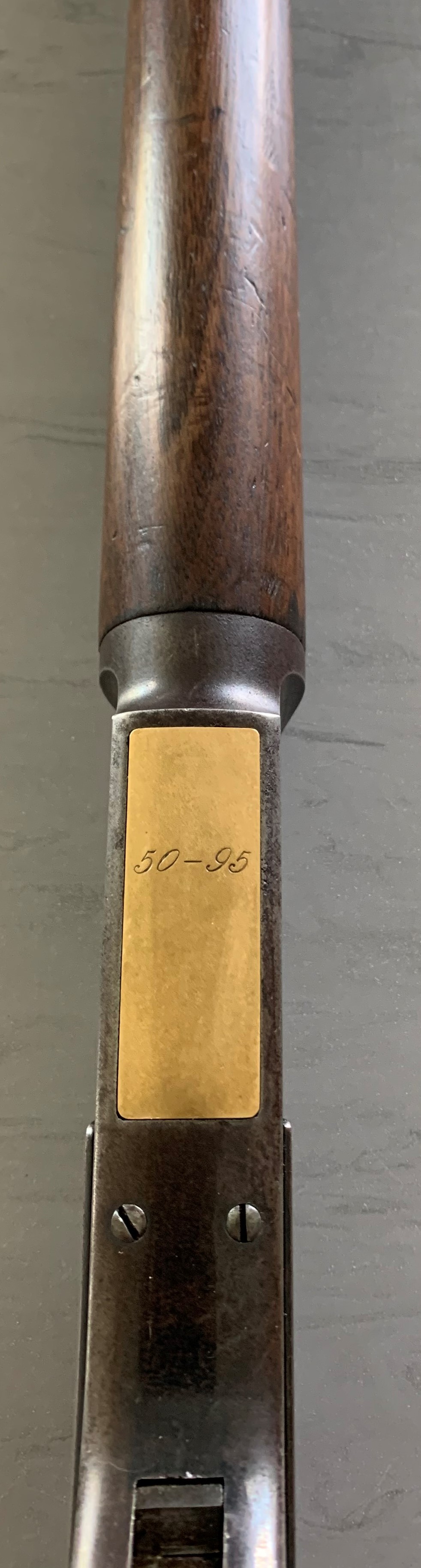

This gun has many things that when you put them together they don’t add up. The caliber stamp on the elevator with the ghost stamps and it does not fit the receiver like it should pointing to its a replacement or has a lot more wear than the gun shows. The case color has been helped in some way. There is color in areas that normally would not have it given the amount of pitting and usage. The metal finish of the forearm cap does not look right. The whole gun has been dissembled including the dust cover rail which normally is not necessary.

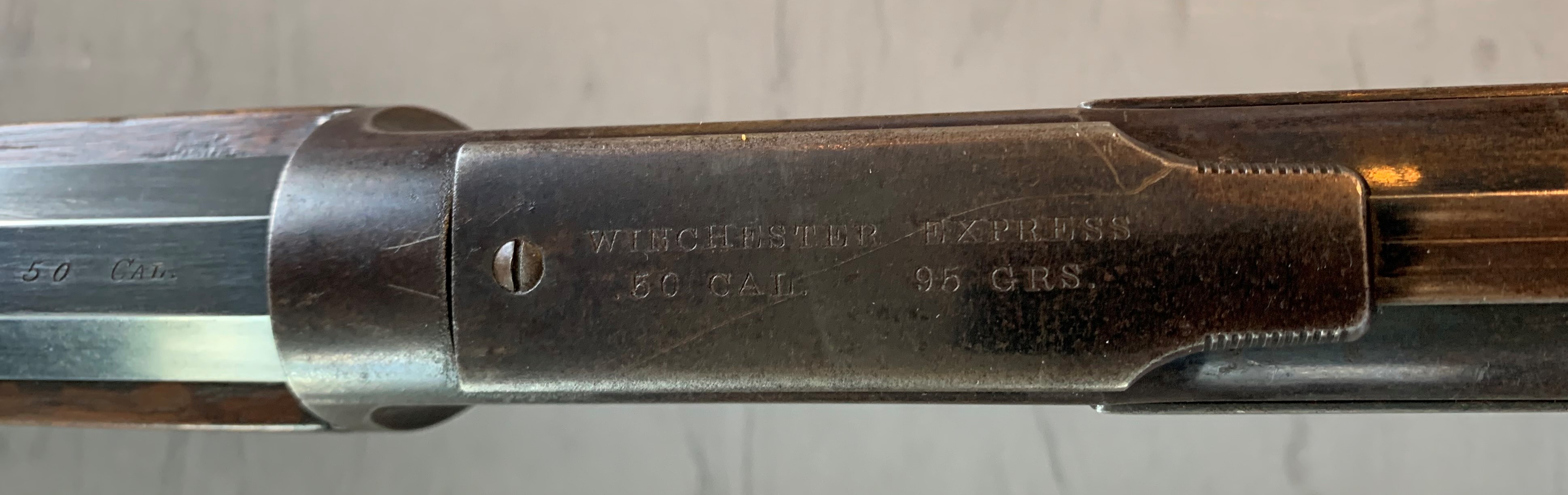

I am surprised no one had mentioned the dust cover. The stamping on it looks like a child did it. Look at the number 5. Overall, too many things add up to turn me away.
Chris
I agree with you.  The 5 does look wrong.  Also the L in CAL looks wrong as well.  So, we have suspect markings on the elevator, suspect markings on the dust cover and no letter.  Not to mention the case color.  One really does wonder what the entire story is behind this rifle.
Chris
I don’t think the dust cover is wrong.  It looks like the one I have.  5’s on mine are similar and not everything is straight and perfect.

Forum Posts: 6889
May 24, 2020 - 8:13 pm
Bill your dust cover looks like mine and I still say the one in question is OK.  Many other things are not though. It always leads me to think what is the seller hiding when they don’t have a Letter on a gun like this???  I guess I have gotten like this after about 40 yrs. of hearing and seeing all of the horror stories.
Forum Posts: 2007
May 24, 2020 - 9:46 pm
 I have an original well used dust cover in my parts and after comparing the two, they are the same, with the same die flaws. The 5 is the way Winchester cut that die. T/R

I’m with the recent posts on this.  Here’s one I found on Gunsinternational.  The 5’s look the same:
https://www.gunsinternational.com/guns-for-sale-online/rifles/winchester-rifles—model-1876/winchester-1876-rifle-in-50-95-express.cfm?gun_id=101134433#mob-9
Forum Posts: 2007
May 24, 2020 - 10:19 pm
 Steve, also note one serif on the N is missing. T/R

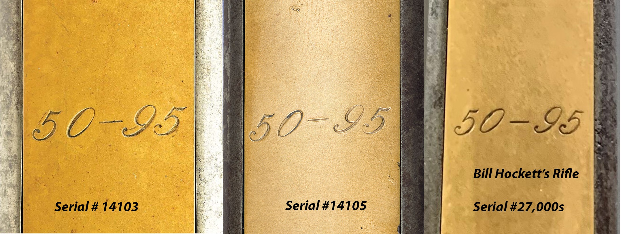

I’m surprised no one doing a 76 survey has chimed in yet. I don’t keep my database up like I use to, but that said.
Two serial numbers off #14105 has identical features as this rifle. It was sold at Julia’s in 2007/2008 time frame.
I would agree the gun in question has been disassembled in the past, but that goes for a lot of guns. Other than the stock markings, all the other markings look good to me. The only remaining item is the condition / finish of the rifle. And I’m not going to offer an opinion on that. To each their own.
Photography can definitely make the finish of a gun look quite different than it actually is. I’d want to see it in person either way.

Maverick –
I appreciate your comments.  What is your opinion on the elevator stamping?

Here is a study of the auction rifle #14103, #14105, & Bill’s Rifle.
ElevatorStudy.jpg Looks like the first two are identical, and Bill’s Rifle is different. I would conclude that Bill’s Rifle was cut using a different stamp than the earlier two.
But I do find the first rifle’s markings a little odd. Almost as if the stamp bounced and left the shadow mark. But who really knows?
I don’t know if the factory used individual stamps for the marking of the calibers early on, as I doubt they were individually engraved. The last caliber marking looks a like a more uniform stamping.
My humble opinion, take it or leave it.
