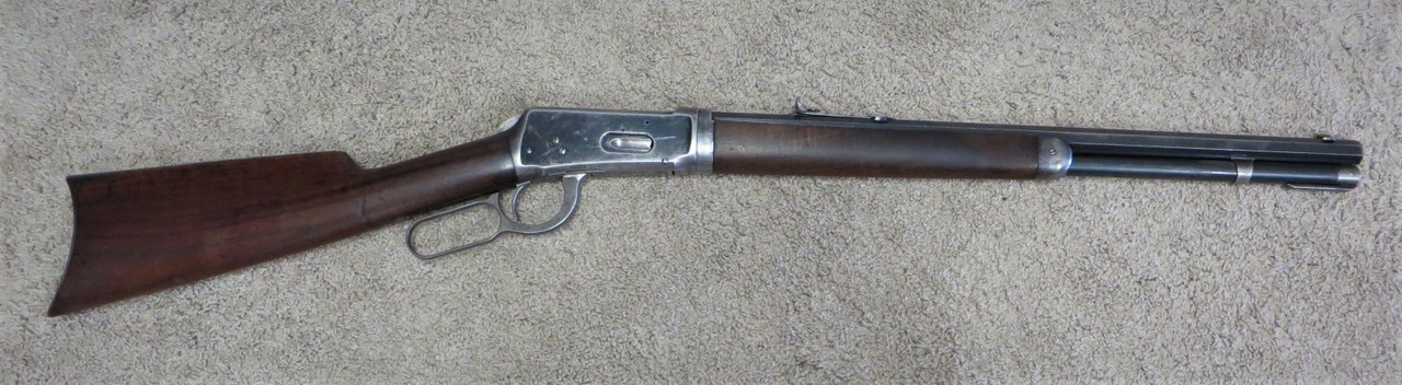

Here’s my 1894 38-55 short rifle.  It has the long 9 3/8 forearm and letters with everything minus the shotgun butt.  I’m 100% sure the shotgun butt is original factory configuration and was just left out of the ledger records.
P1070717.JPGP1070719.JPGP1070722.JPGP1070724.JPGP1070725.JPGP1070726.JPGP1070727.JPGP1070729.JPGP1070731.JPGP1070734.JPGP1070736.JPGP1070738.JPGP1070740.JPGP1070791.JPGP1070793.JPGP1070794.JPGP1070884.JPG

Unless I’m looking wrong, I don’t see that barrel measuring 22 inch’s
Forum Posts: 3098
February 18, 2023 - 8:27 pm
There’s some weird optical illusion in that last photo.  I just held a measuring tape to it and it’s 22 inches from the bolt face to the muzzle.

That is a beauty, Don. The one I’m looking has been hunted a lot. Rear sight is standard distance from receiver. Sight itself is original 22 but elevator isn’t. Priced really high if it’s a modified standard rifle. Low if it’s original Imo even with the finish loss.
