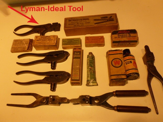

Brad, these are plain everyday items. I got them to go with rifles I have.
Molds:
25-20 R
2 @ 32 W C F
38 W C F
Tools:
25-20 W C F
2 @ 32-20 W C F
 I know my photo is of poor quality but if anything interests you I will try to provide better.

I take it that the 25-20 R marking is on the Lyman-Ideal Tool?

l didn’t show this on my photo as it is so rusty I can’t make out the name. It MAY say Lyman Mfg. Co. New Haven, Conn.  USA. The 25-20 R is very apparent though. Don

I’m assuming that you’re talking about the tool in the top left corner of your photo. The nickel plated tool is made by Lyman-Ideal or the Ideal Reloading Tool company depending on how its marked. Based on your last description its a Lyman-Ideal manufactured tool, after the Lyman corporation bought the Ideal Reloading Tool company in 1925.
It does have somewhat of a connection to Winchester Reloading Tools but its not a Winchester tool. John Barlow used to work for Winchester and had several patents credited to him while at Winchester. He later branched off and started the Ideal Reloading Tool company. Years later Lyman purchased the company. This being about 1925. By all accounts Winchester was out of the reloading tool business by then.
Boxed sets of the Lyman-Ideal reloading tools are not all that uncommon to locate. The 25-20 R being Lyman-Ideal nomenclature for 25-20 “Repeater” a.k.a. the 25-20W.C.F. not to be confused with the 25-20S.S. The advantage the Lyman-Ideal tools do have is that the mold and reloading tool are all in one tool. Winchester always sold their tools and molds as separate items and not a combined tool item.

No, as I said, it is not in my photo. It was too rusty to be of interest. You will note 6 tools in photo. but I itemized 7 in my list.
Sorry for the confusion. Don

Okay, well then you have two Lyman-Ideal Reloading Tools then. The one I’ve pointed out in the photo is also a Lyman-Ideal Tool.
