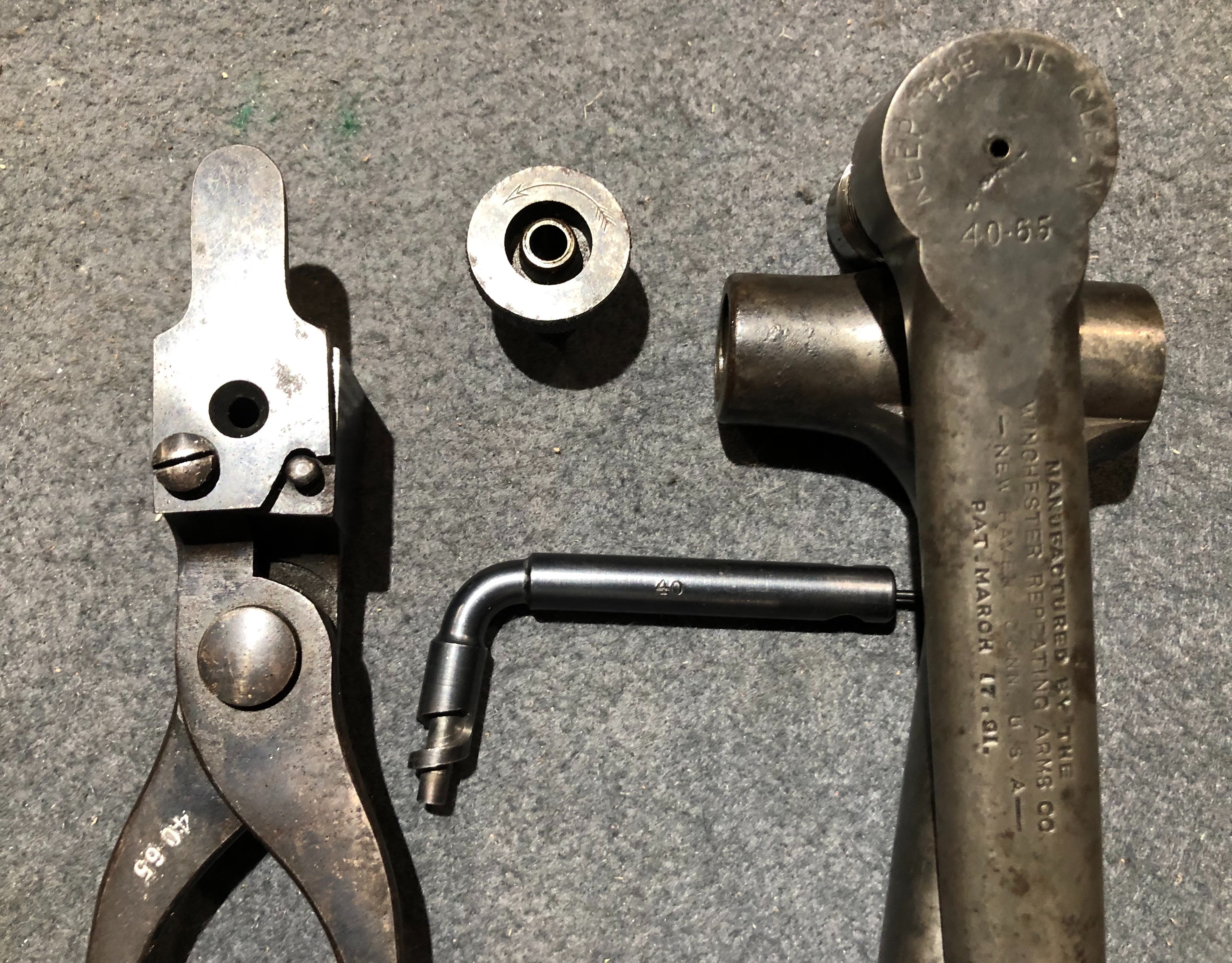

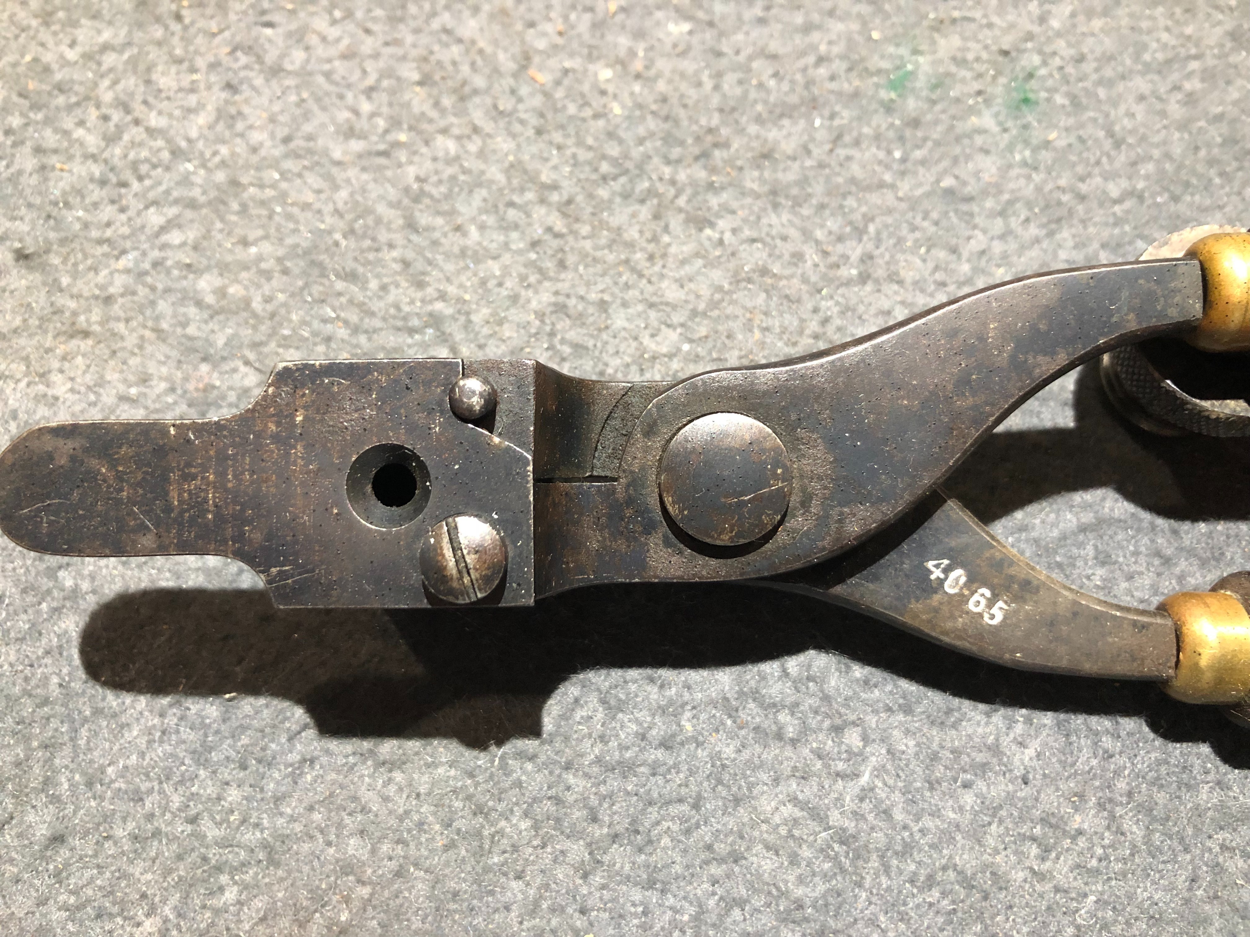

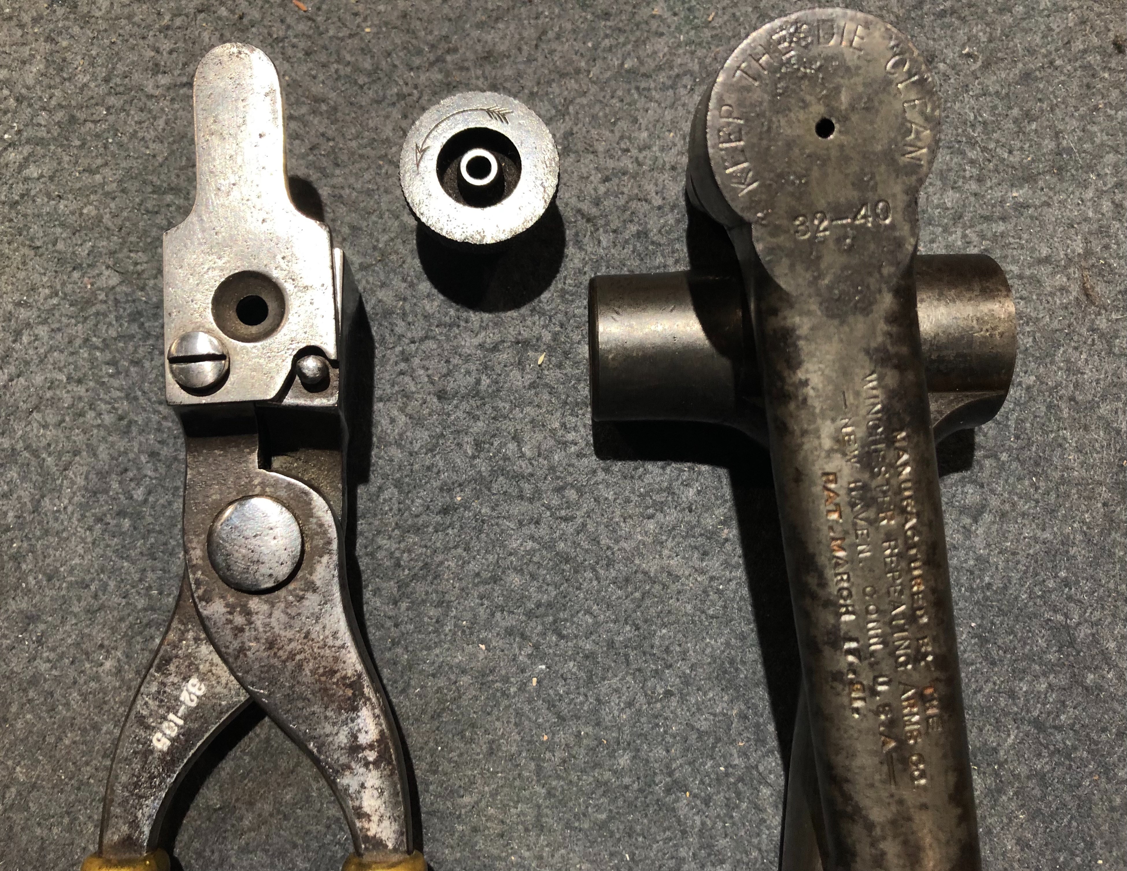

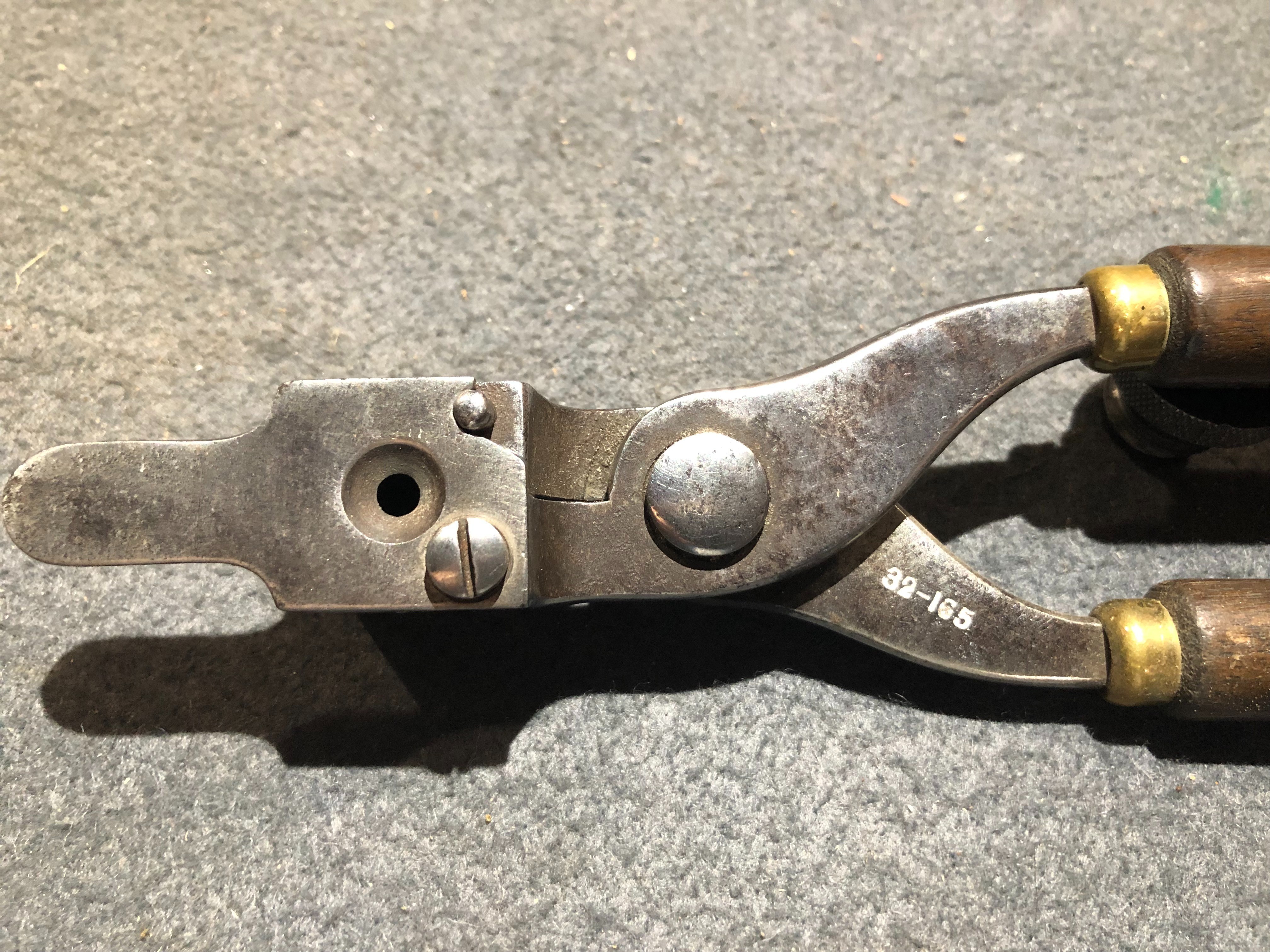

February 25, 2022 - 2:26 pm

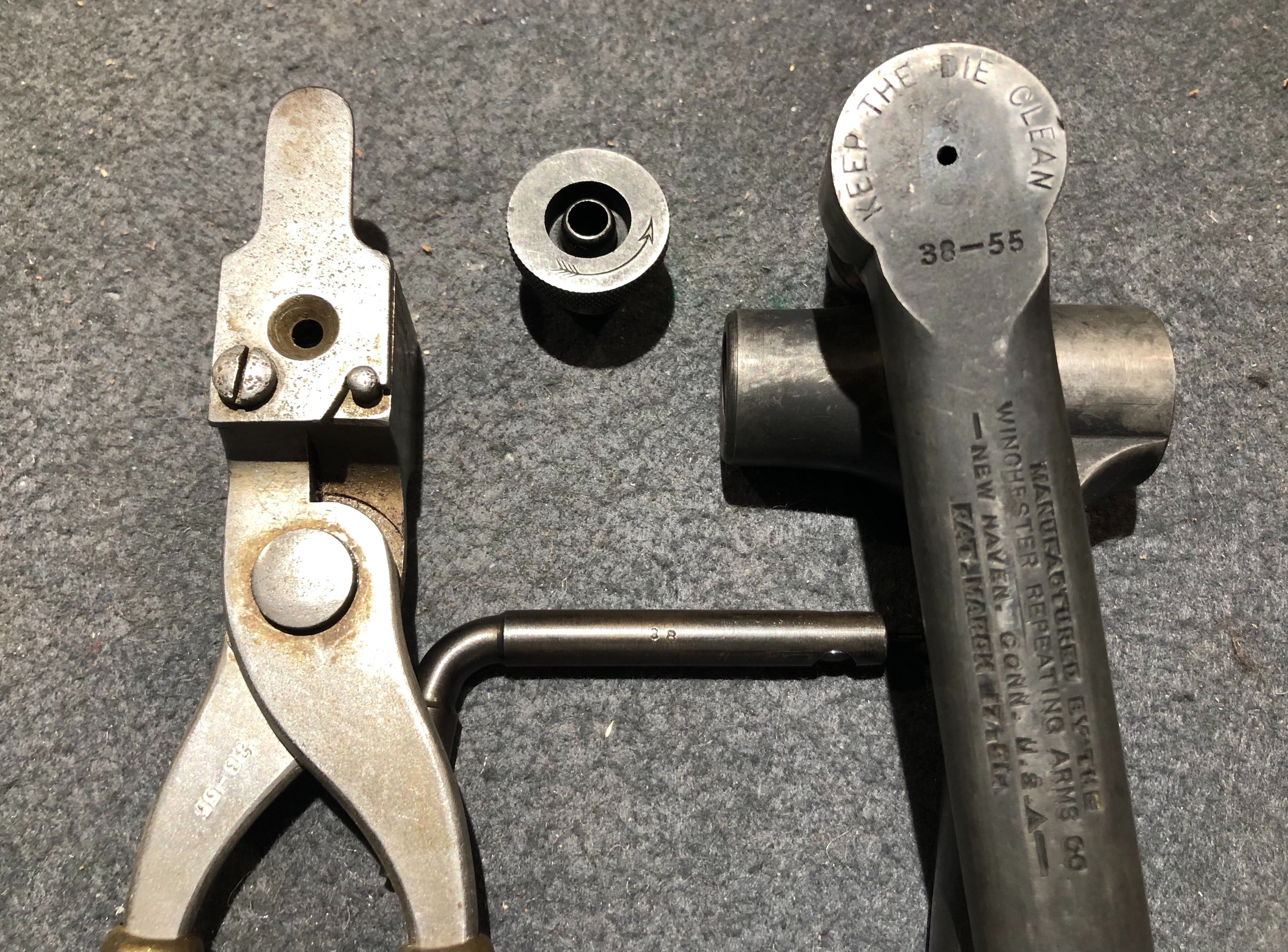

Brady,
I thought I would add these pictures of my 1891 reloading tools and bullet molds so everyone could see them. Not sure how many pictures I can down load at one time. Here are the first three sets. 32-40, 38-55 and 38-56. I have to attend to some things for the Mrs. so it will be awhile before my next post. I hope this adds to the survey.
Glenn

February 25, 2022 - 5:29 pm
Brady,
Here are the next set of pics. 40-60, 40-82 and the 45-70 set. Like I said I do not have the 45-70 500 bullet mold.
Glenn

February 25, 2022 - 6:45 pm
Brady,
This is the last group of pics. They include the 45-90 and 50-110 EX. If you need any other angles from what I have shown let me know I will be happy to provide. I have also included a pic of one wall of my gun room showing how I display the reloading tools.
Glenn
IMG-3899-8-1.jpgIMG-3900-6.jpgIMG-3934.jpg IMG-3902-8-1.jpgIMG-3906-4.jpgIMG-3898-5.jpg

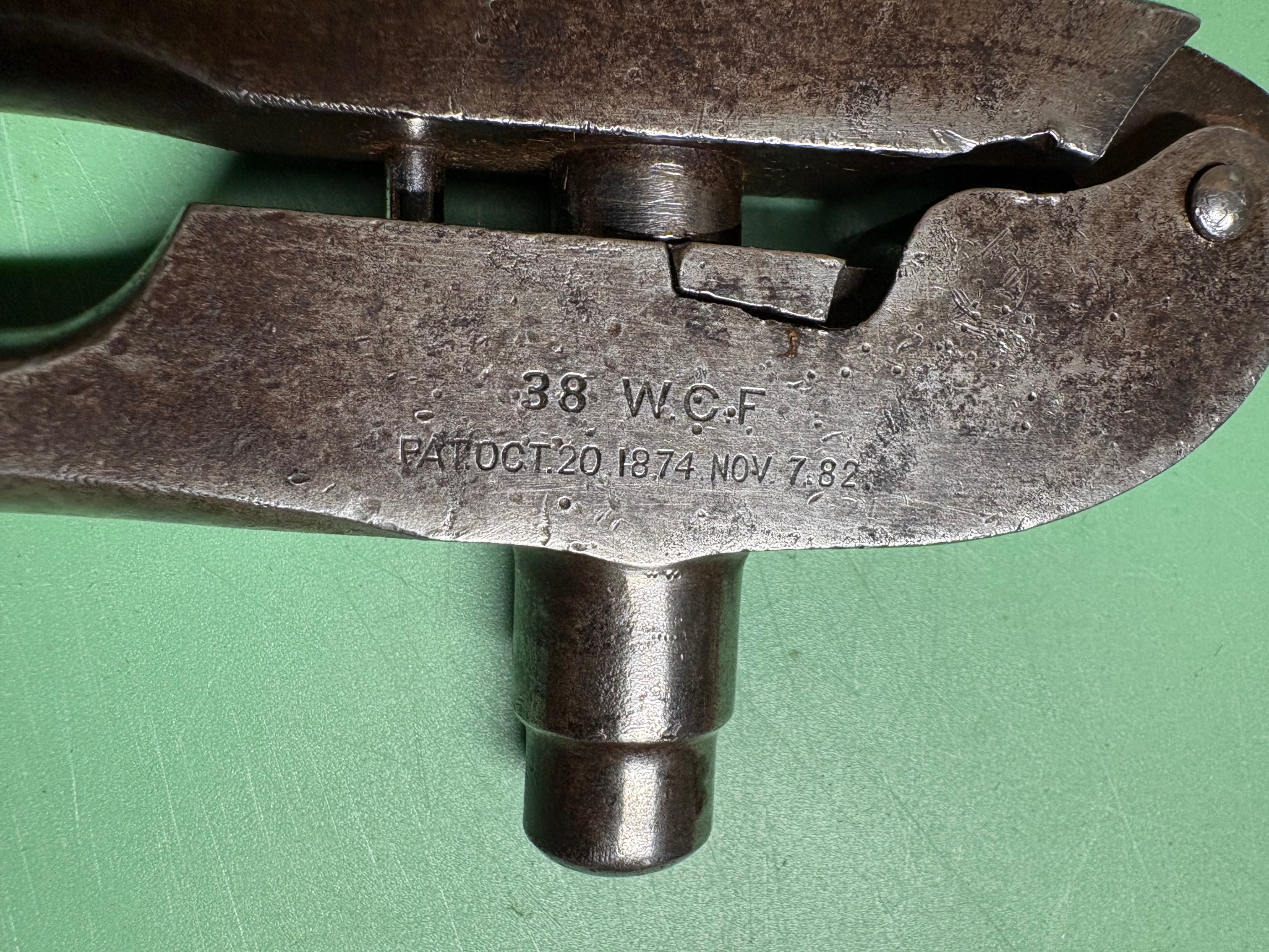

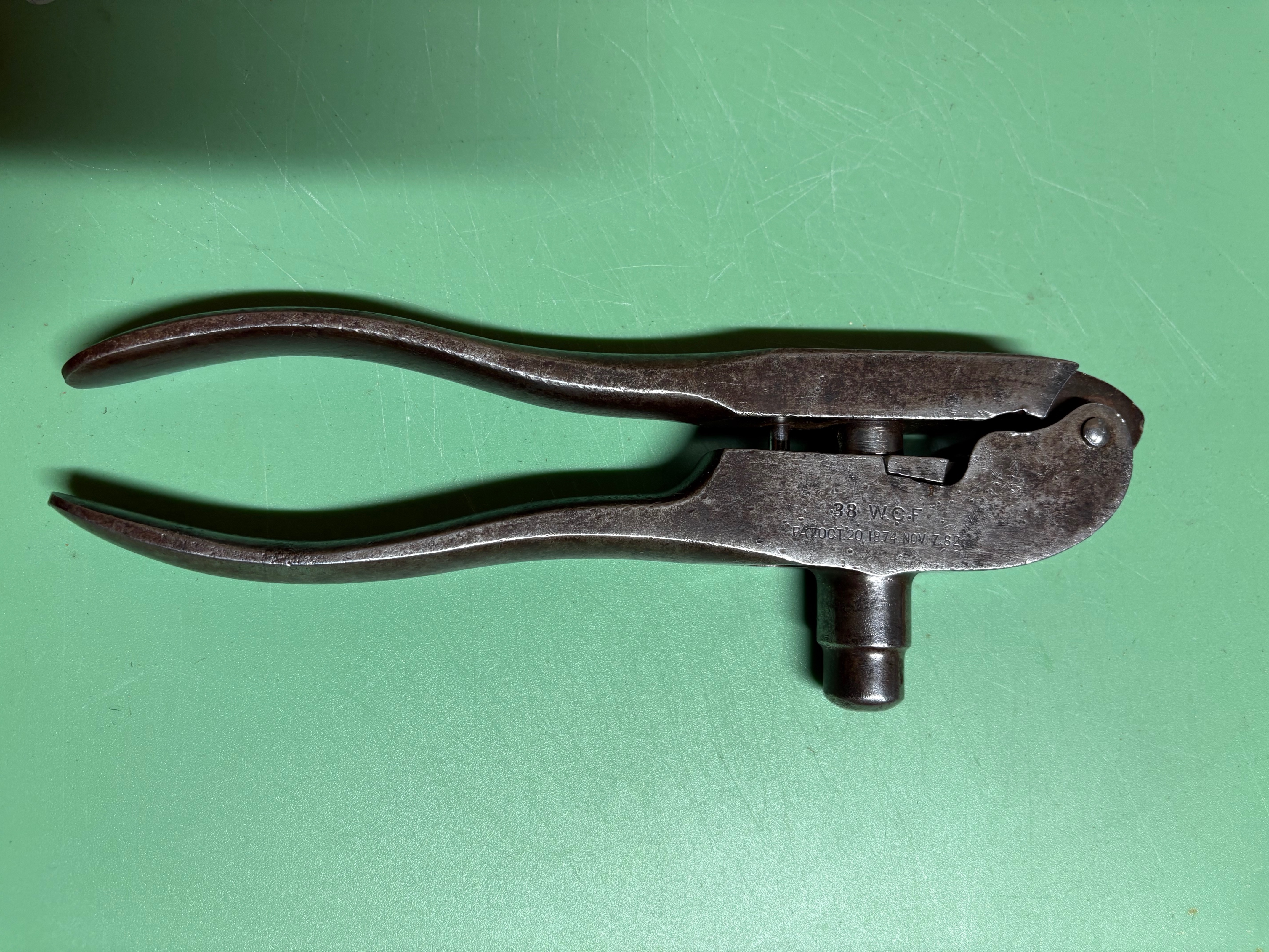

May 21, 2025 - 1:57 am
Mav,
I got this off eBay a few years ago. I know nothing about it.
Forum Posts: 2243
59
May 21, 2025 - 4:49 am
Its known as the 1882 Tool a.k.a the Lever Tool and its chambered for the 38 W.C.F. (38-40) cartridge. You can hand reload 38-40s with it until your hearts content.
I would imagine that on the back side of the tool it has the standard 3-line address, “Manufactured by the Winchester Rep. Arms Co. New Haven Conn. U.S.A.”
In about 1883 Winchester started putting the 3-Line address on the Tools. Some time between 1883 to 1890 or so they moved the 3-Line address to the same side of the tool to be located on the top handle. So likely your tool was made from sometime 1883-1890.
If it is missing the 3-line address on the back of tool then its pre-1883. Since it has the patent date of Nov. 7th 1882, it wasn’t made any earlier than that date. Some early Lever Tools will be missing this 1882 date.
It would have came from the factory with a de-capping pin, a powder measure, a set of instructions, and also most likely a bullet mold in the factory box.
That is about the jest of it, Do you have any other questions about it?

May 21, 2025 - 1:29 pm
Thank you for the information, it does not seem to have the 3 line address or I would have included a picture.  It was advertised as Winchester.  What would be an approximate value?
