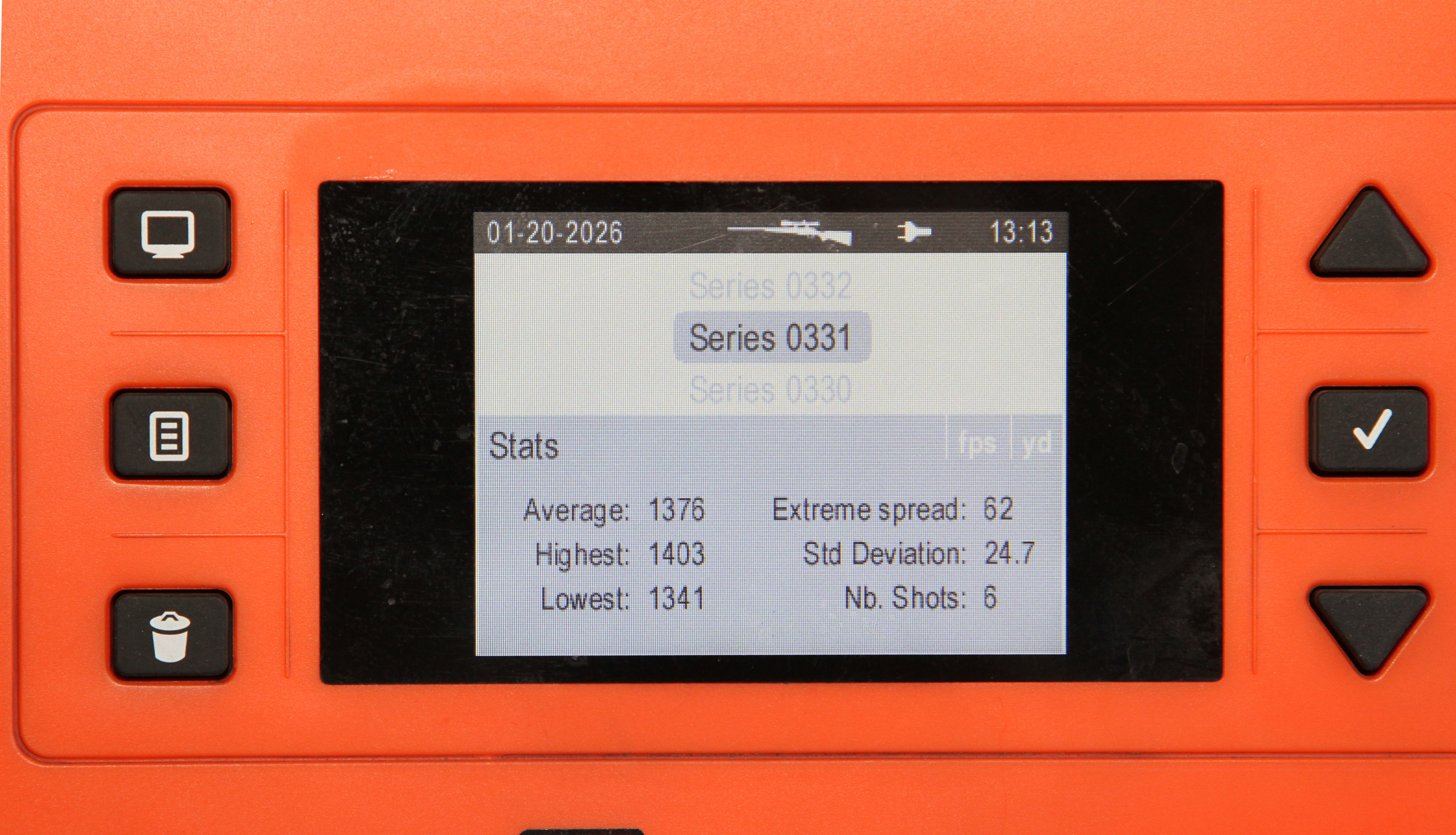

I shot the 6 rounds today and was able to get the data on my Lab Radar chronograph.  All cartridges were loaded with 23 grains of IMR 4198.  Case 1 used a .380″ bullet and the other 5 used .379″ bullets.
    Bullet weight     Filler            Speed
1.  212.2 grains,  1/4 of a wad, 1,370 fps
2.  202.82 grains, 1/4 of a wad, 1,341 fps
3.  204.04 grains, 1/4 of a wad, 1,394 fps
4.  212.42 grains, 1/2 of a wad, 1,403 fps
5.  213.72 grains, 1/2 of a wad, 1,394 fps
6.  212.14 grains, 3/4 of a wad, 1,356 fps
All of the cartridges loaded but I had to push them in.  All the fired cases ejected but were very tight.  Except #4, it stuck and I had to knock it out.  So obviously I am getting more pressure than the black powder loads produced.

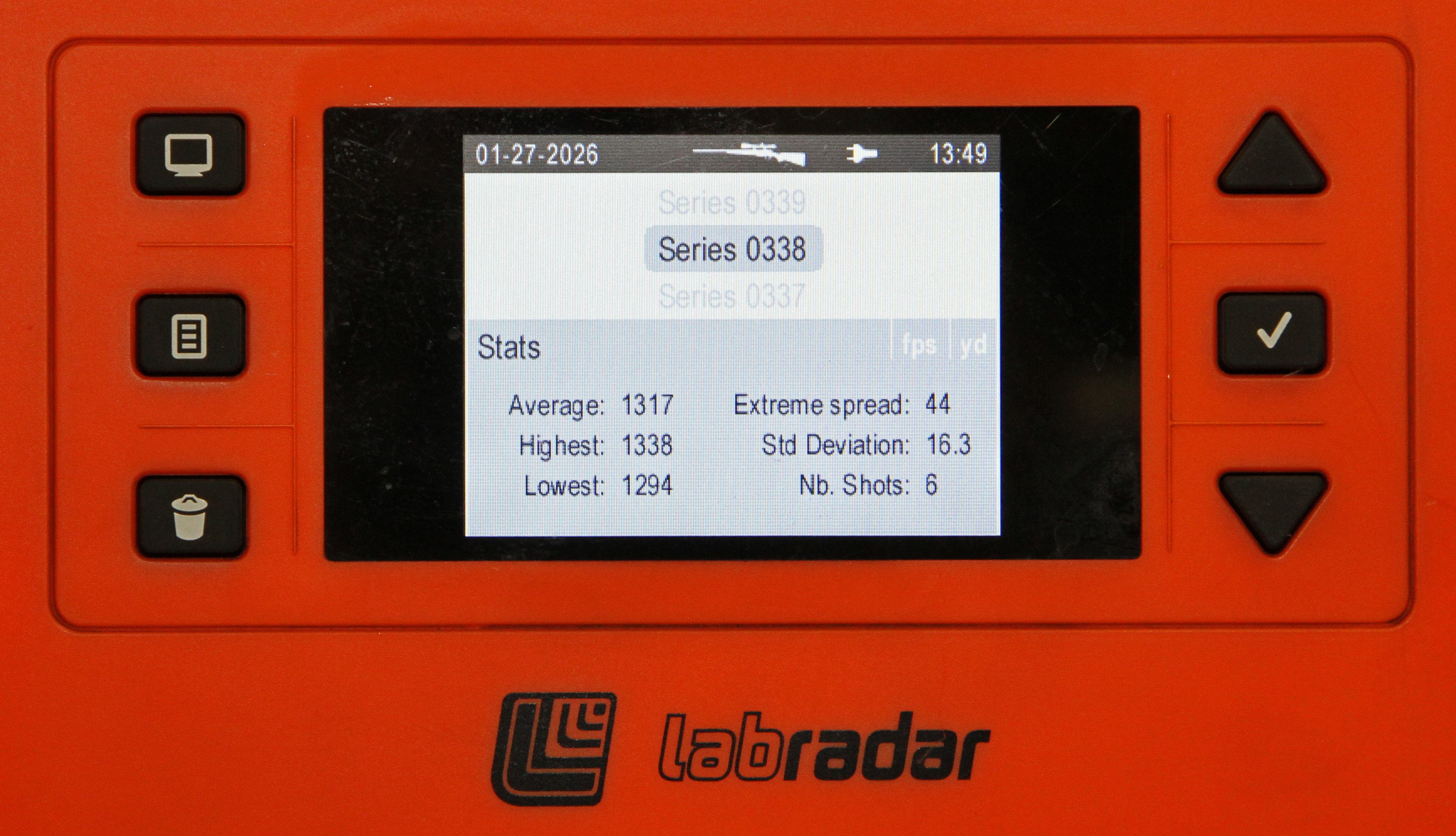

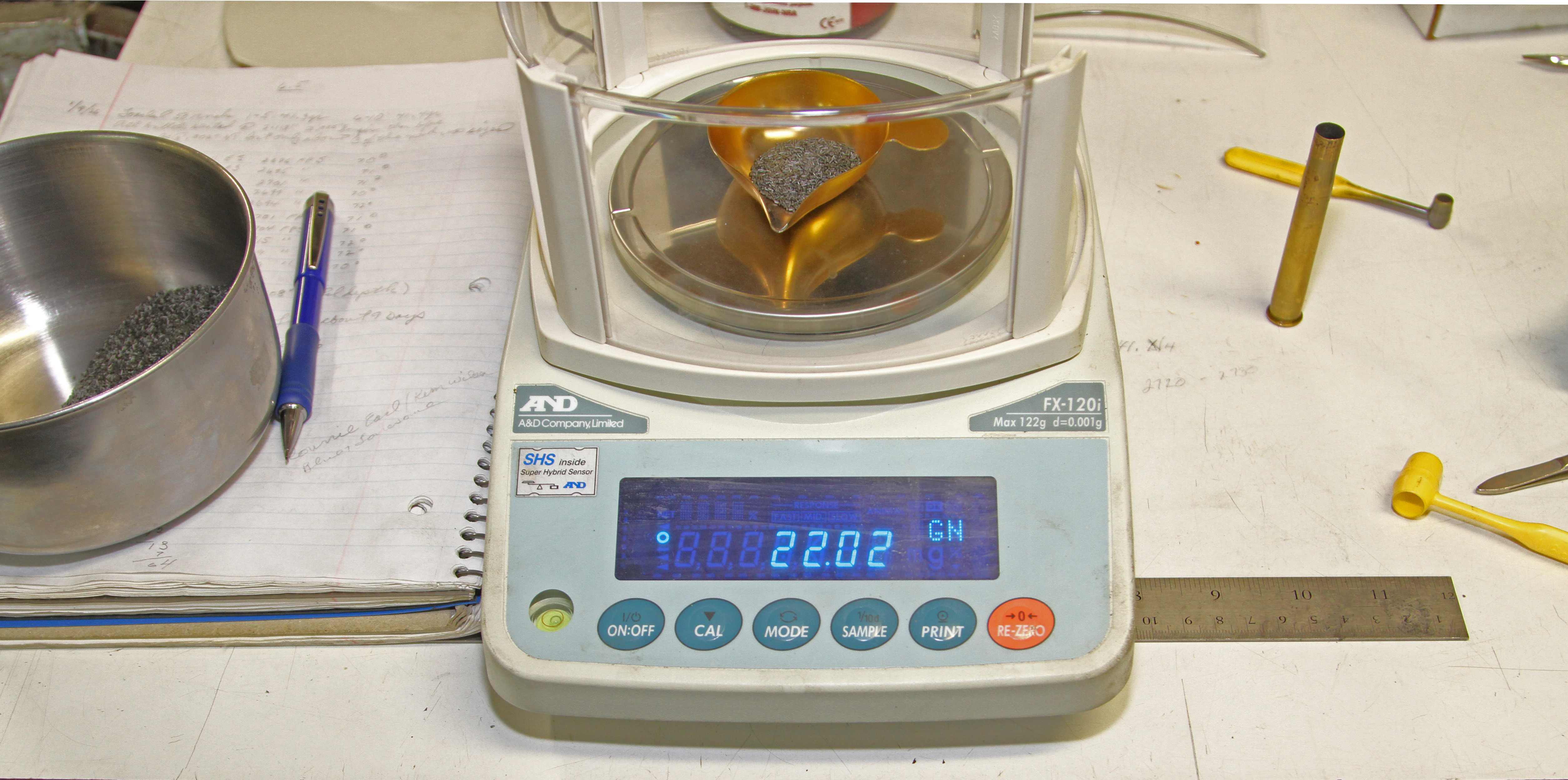

Here is the data from yesterdays shots.  I dropped the charge 1 grain to 22 grs of 4198.  No problems loading, ejecting and no pressure signs.2nd-Powder-Charge.jpgChrono-22-Grs-4198.jpgNext week I’m going to fine tune this load and go up .5 grains and see what happens.

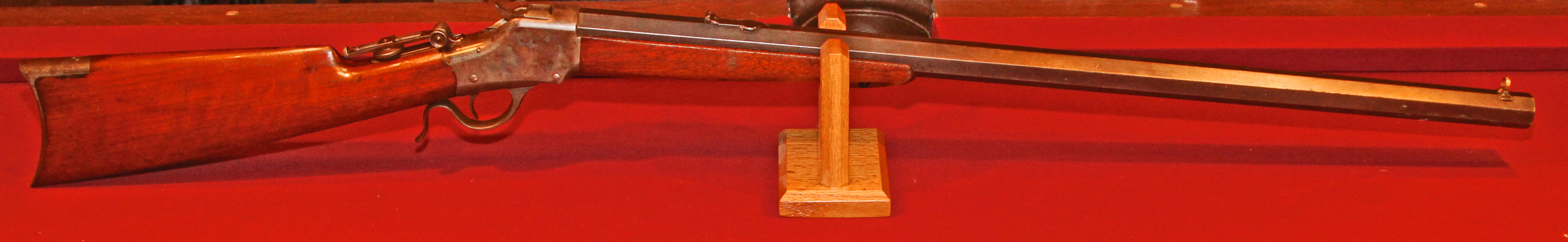

Here is a picture of the 40 EX I bought.  The case color is brighter in the picture.  It does not letter with the Beach front sight nor the vernier tang sight.  I messed around with a case last night.  I’m going to have to squeeze these too but not as much.  Case isn’t pretty but it goes in.

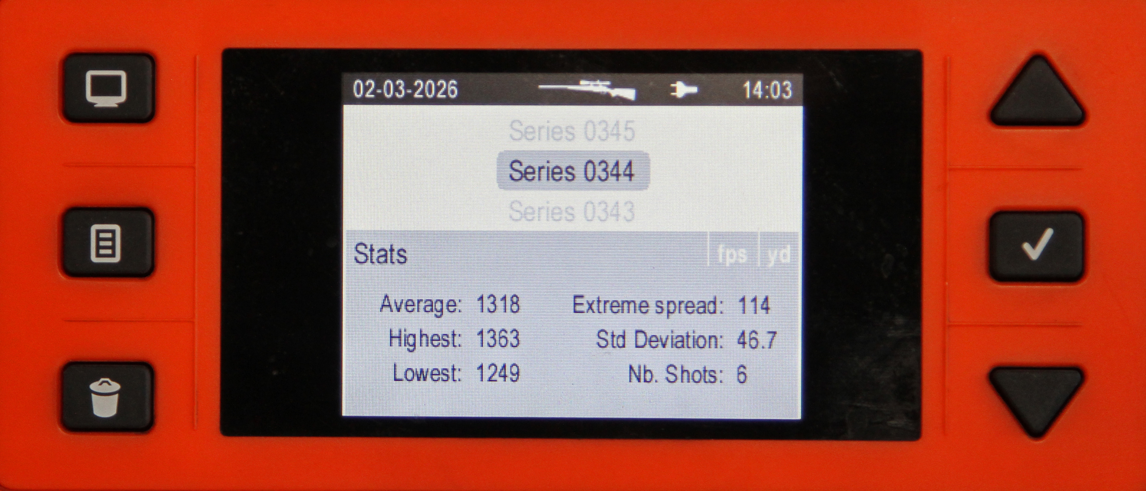

The first 2 were loaded with 22 grains of 4198.  1350 and 1274 fps.
The second 2 had 22.25 grains, 1321 and 1249 fps.
An the last 2 had 22.5 grains, 1352 and 1363 fps.
The 2 with the 22.5 grains caused the ejection to get harder.
So I’m going to use 22.25 grains for now and may adjust as I shoot these some more.  The temperature was 74 degrees.   I need to test these again when the temp is in the 90’s and in the 60’s.  The 50 degree weather into the 60’s I can probably add some powder.  But the 90’s I may have to lower the charge.

Here is the chrono results.
