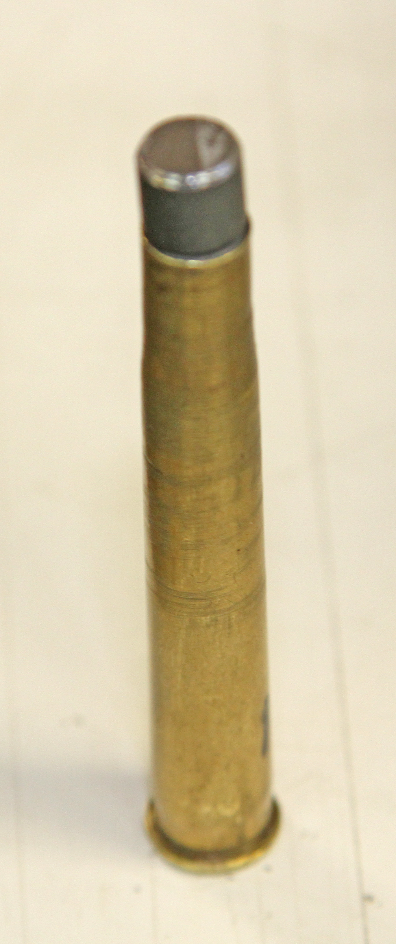

I loaded the 38 EX rounds with 23 grains of 4198.  I am testing the filler quantity to see if I get more pressure with more filler, or not.  I’m hoping that a small amount of filler that fits tightly against the power will work.  These rounds can finally be chronographed.  I want to get somewhere between 1400 and 1500 fps.
I suspect that you will find that 23 grains is going to be a very light load and well short of 1,400 fps.  I load 38-55 cartridges with 22 grains of IMR 4198 under a 255 grain bullet, and it produces 1,500 fps in my high-wall 30″ barrel.
Well, you know me, I like to start low and work up.  Especially when using fillers.   I am using around 220 grain bullets.  My radial arm saw method is not exactly accurate.  Nor are the bullets.  They come out the same length but not the same weight.
I ordered 2 bullet sizing bushings from Lee Precision.  .378″ and .379″.  2 sizers with punches, $36 delivered.

I have been shooting this cartridge for some time now and I have not been able to chronograph any of the shots.  I thought it was all the black powder smoke causing the issue.  So yesterday I shot my first smokeless loads and still no luck with the chronograph.  When changing to another rifle I had an epiphany.  Stupid me had forgotten that this caliber is so slow I have to set the chronograph to the pistol setting and I still had it on the rifle setting.
The cartridges fired with no problems.  Only 1 of the 6 goes into the chamber easily.  I got a notice from Lee that the bullet sizing bushings have shipped.  I did spend some time talking to my friend about the issue.  Not only is he an expert at shooting black powder rifles he is a retired machinist.  He says paper patching could work on a smaller diameter bullet and it is easy once you learn how to properly wrap the bullet.  The biggest issue is finding the proper paper.  On reaming the cases he says that it will work also but he recommends using a lathe to turn the tip of the reamer to the inside diameter of the case necks to keep things aligned while reaming.   This would probably require me to buy some pin gauges to measure the inside ID of the case so I could buy the proper reamer to stay within a .001″ tolerance.  I do have a ball micrometer but I am not very proficient with its usage.

I received the bullet sizers from Lee Precision.  I tested the .379″ and the bullets slide right into the case.  I then figured a way to pinch the end of the case so the bullet would stay put.  The big test was to load the case with a seated bullet into the chamber.  It took a slight push to get it to chamber.  I will size more bullets and shoot the 6 rounds on Tuesday.

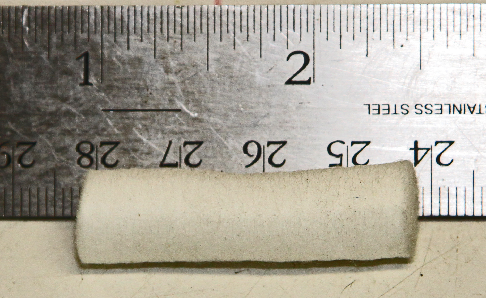

I’m going to use the powder charge that Frank Barnes shows.  23 grs. of 4198.  He is usually close and safe.  I’ll use a small piece of dense cotton to hold the powder next to the primer.  I want to see what happens with the 75% void left in the case.

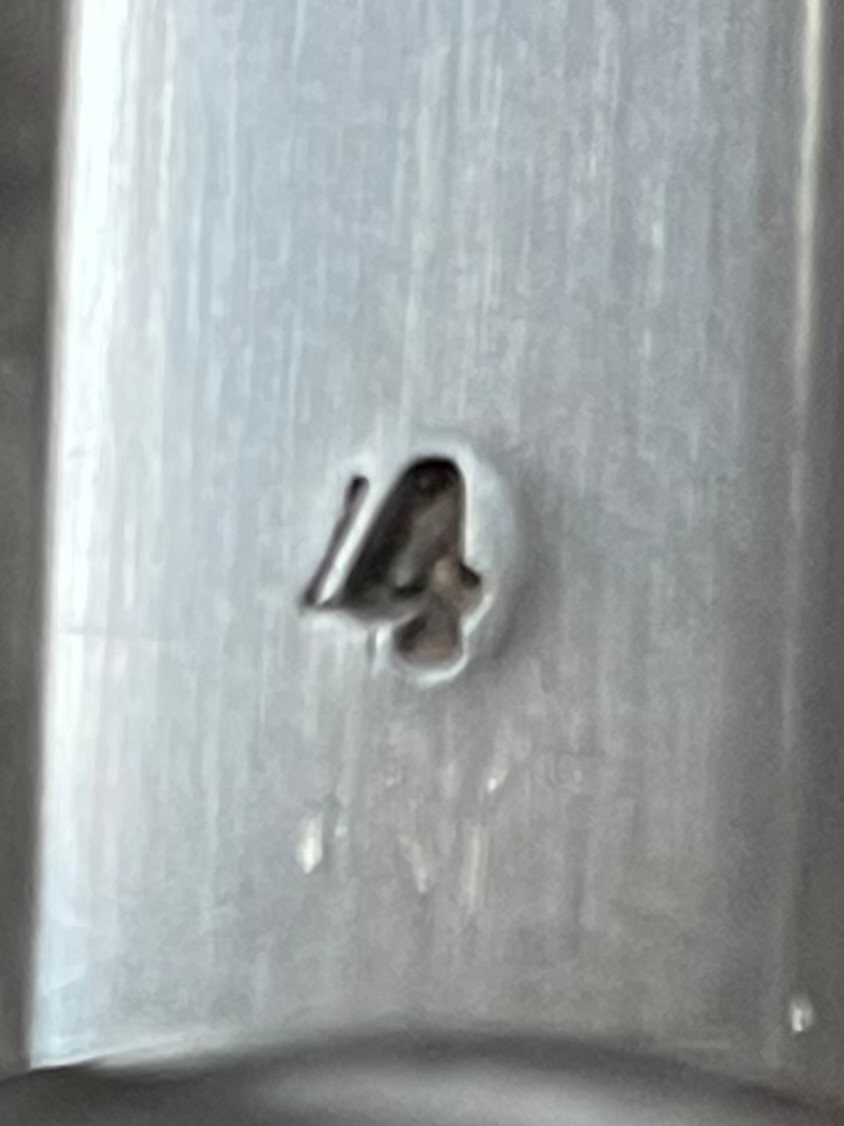

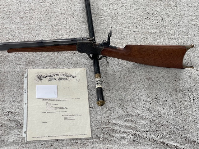

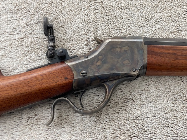

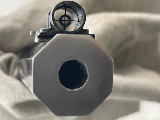

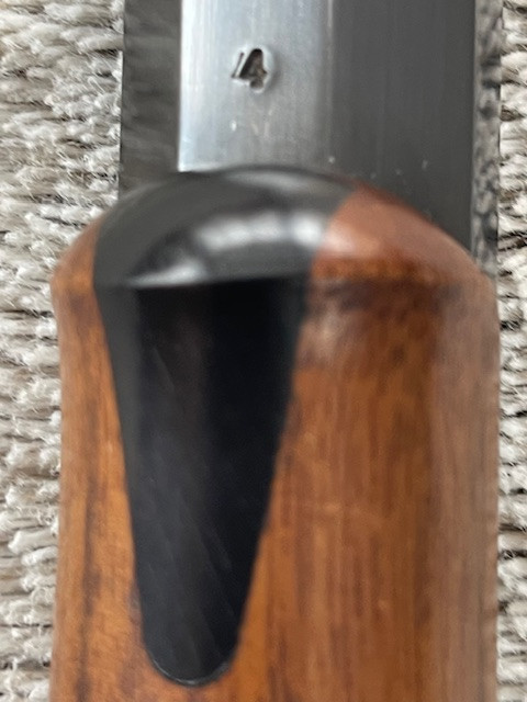

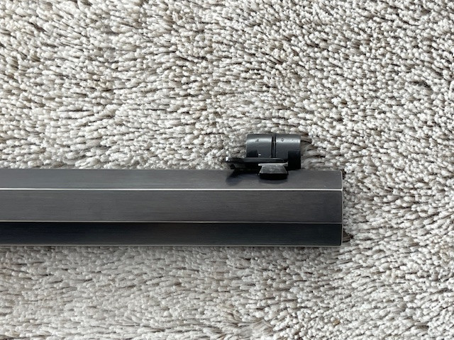

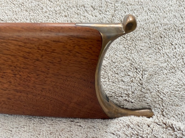

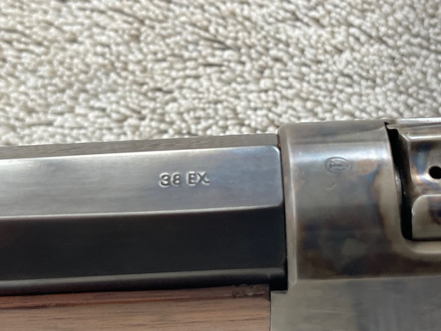

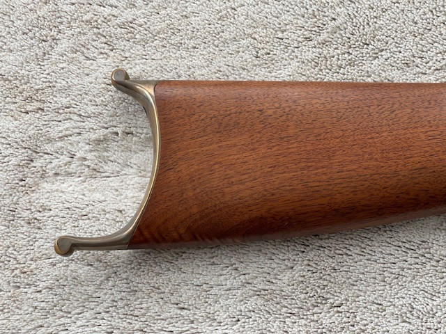

A great thread as many of us have been interestingly following here. I have paid attention to what you’re doing with interest as I also like the Express S.S. Examples, and have acquired a few, over the years, but this one is in the .38 Ex. that is currently on topic. Bert has this in his Survey.
IMG_2186-1.jpegIMG_2187.jpegIMG_2189.jpegIMG_2191.jpegIMG_2192.jpegIMG_2193.jpegIMG_2194.jpegIMG_2195.jpegIMG_2196.jpegIMG_2197.jpegIMG_2199.jpeg
The Bore looks to be as crisp as the rest of the rifle as I would surely like to take her out this spring and shoot it! The double strike on the #4, showing the barrel size doesn’t bother me in the slightest. The C.C., and the condition on this beauty is pretty nice as the pictures say a thousand words!

Anthony-
“Pretty nice” doesn’t quite describe that rifle. Wow! Unfortunately I’m have trouble doing better.

Anthony, that is a very fine rifle.  Neither of my EX rifles are in that condition.  If you see a 40 EX I’m interested.  I’d settle with an unmolested rifle with above average condition.

I just finished loading the 6 rounds.  Each was loaded with 23 grs. of 4198.  I weighed each bullet and I marked each case so I know what bullet is in each specific case.  I also cut some wads/filler in different lengths and kept track of what length went into each case.  The wads were 1/4, 1/2 and 3/4 of the piece of cotton.
Case #1 is the only one with a thin neck and it doesn’t require the bullet to be sized so I used a .380″ bullet and the rest got .379″.  Since I’m eyeballing the cutting of the bullets they varied in weight from 202.82 grs. to 212.42 grs.  There is not a lot of neck tension on any of the bullets.  After I cut them I put the bullets into the drill press and ran them up against a file to chamfer the edges.
