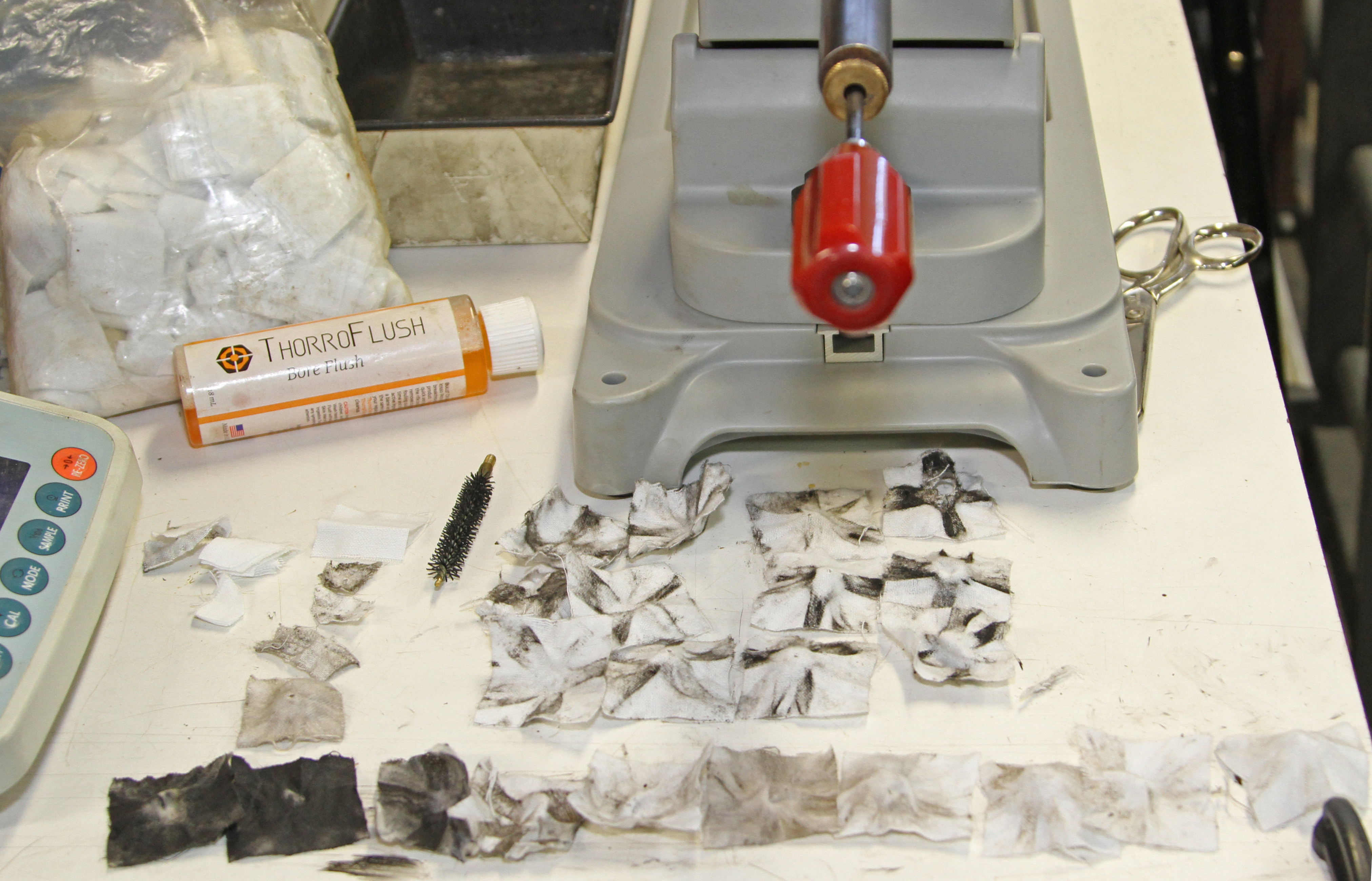

Cleaned the rifle.  Took about a half hour.  The picture on the bottom is after my first pass with a brush.  Ran the brush back and forth a few more times but most of the loose stuff came out on the first pass.  The top picture is all of the patches I used to get the remaining black powder out.  There are 12 patches below the cleaning rod handle.  These were ran through the barrel dry and each side of the patch was used. On the left there are some bits of patches that I use as a backer to make the patch fit tighter.  As the cleaning goes so does the size of the backer.  The bottom row is where I used a barrel flush.  I ran the one on the left with the flush then ran the rest going from left to right.  Once the patches started coming out dry I started using both sides of the patch.
Forum Posts: 14976
December 12, 2025 - 12:54 am
And that is exactly why I never load or shoot black powder cartridges in ANY of my old Winchesters!! If I had to load and shoot the shells a dozen times or more with 4198 to get them fire formed, I would do it versus just 2 or 3 cycles with black powder.  I very strongly detest cleaning up the black powder residue, and not just the rifle… you also have to clean the empty shell cases.
