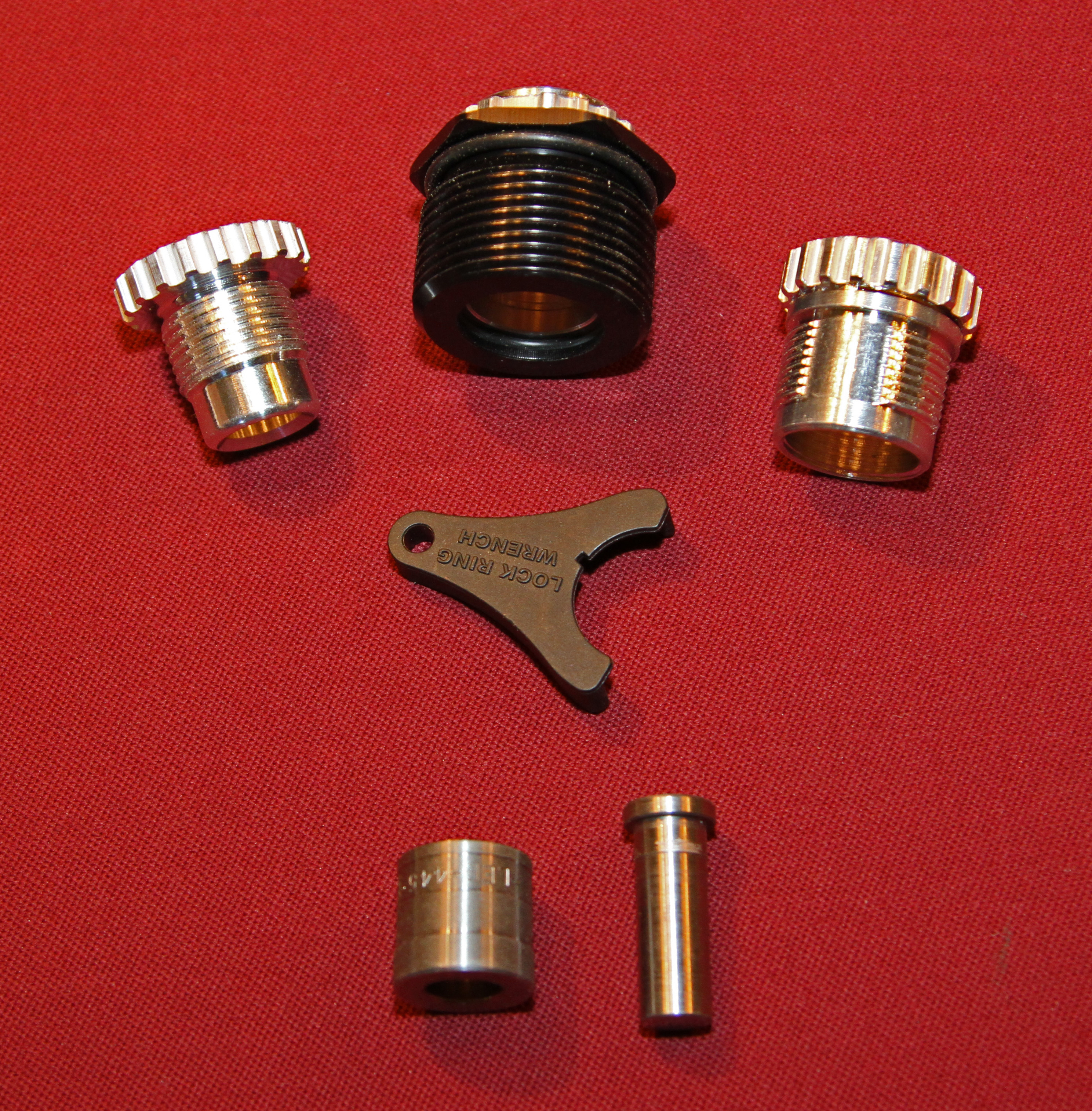

A simple bullet swage tool/die will allow you to reduce your bullets from .381 to .379 (or the diameter you need).  I have a small supply of .379 bullets on hand, but I use them for my 38-55 high-wall.
You should not need to crimp the bullets for a Single Shot rifle.  Resizing the case should be limited to just the short area where the bullet seats in the case.

Here is a picture of the Lee Breech Lock Bullet Sizer that I have.  I would have to order the bottom 2 parts.  A correct diameter sizer and the punch.  I messed up and the sizer is upside down but if you look closely it reads .445.  When using this tool you have to remove the bushing on the RCBS press so you can use the large diameter threads.

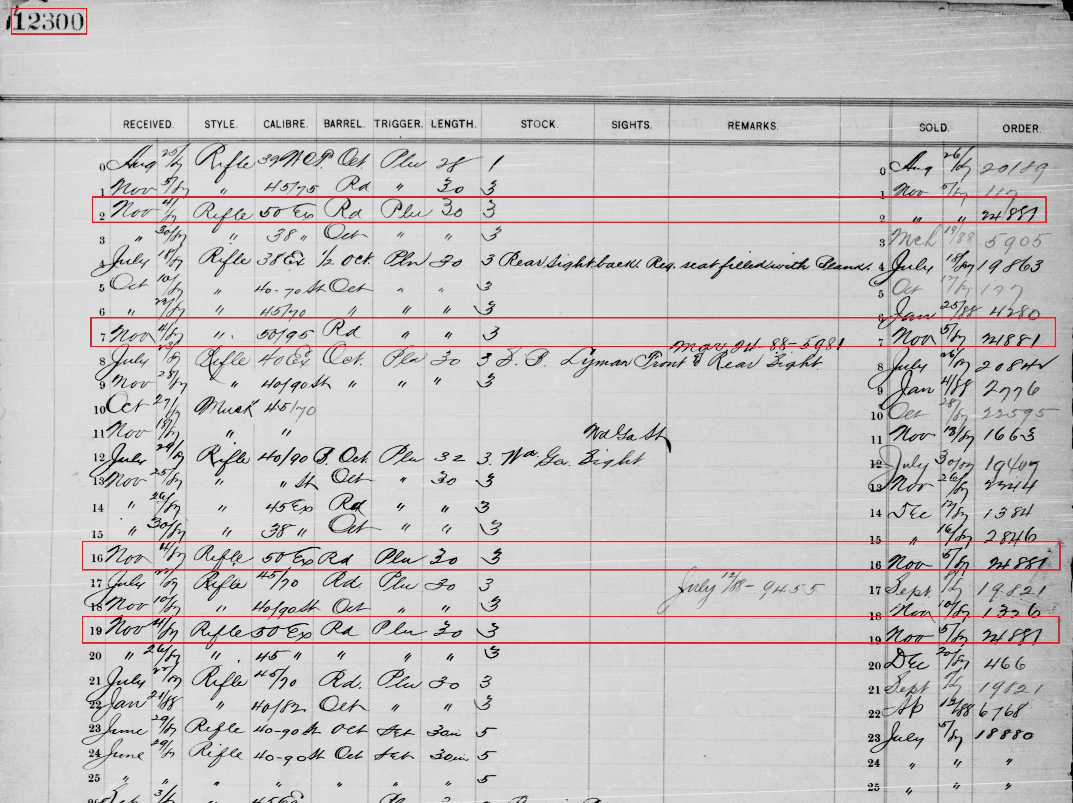

To illustrate the inconsistencies that are found within the factory ledger pages, see the attached copy of the ledger page for Single Shot serial numbers 12300 – 12325.  Take Note that there are (4) serial numbers that I have hi-lighted.  All four rifles were received in the warehouse on the same date and then shipped on the same date to Order number – 24881.  Three of the rifles are annotated “50 Ex” and one is annotated “50-95”, but all four are in fact chambered and marked for the 50-95 W.C.F. cartridge.
I have personally had my hands on 3 of the 4 rifles, and all of them are in fact 50-95 WCF (I serial number 12302 in my collection).  All four rifles were exported to Australia (James Rosier) and bear his “J.R.” marking on the barrel.  The other two rifles were purchased by well-known Winchester collectors/dealers here in the U.S.
