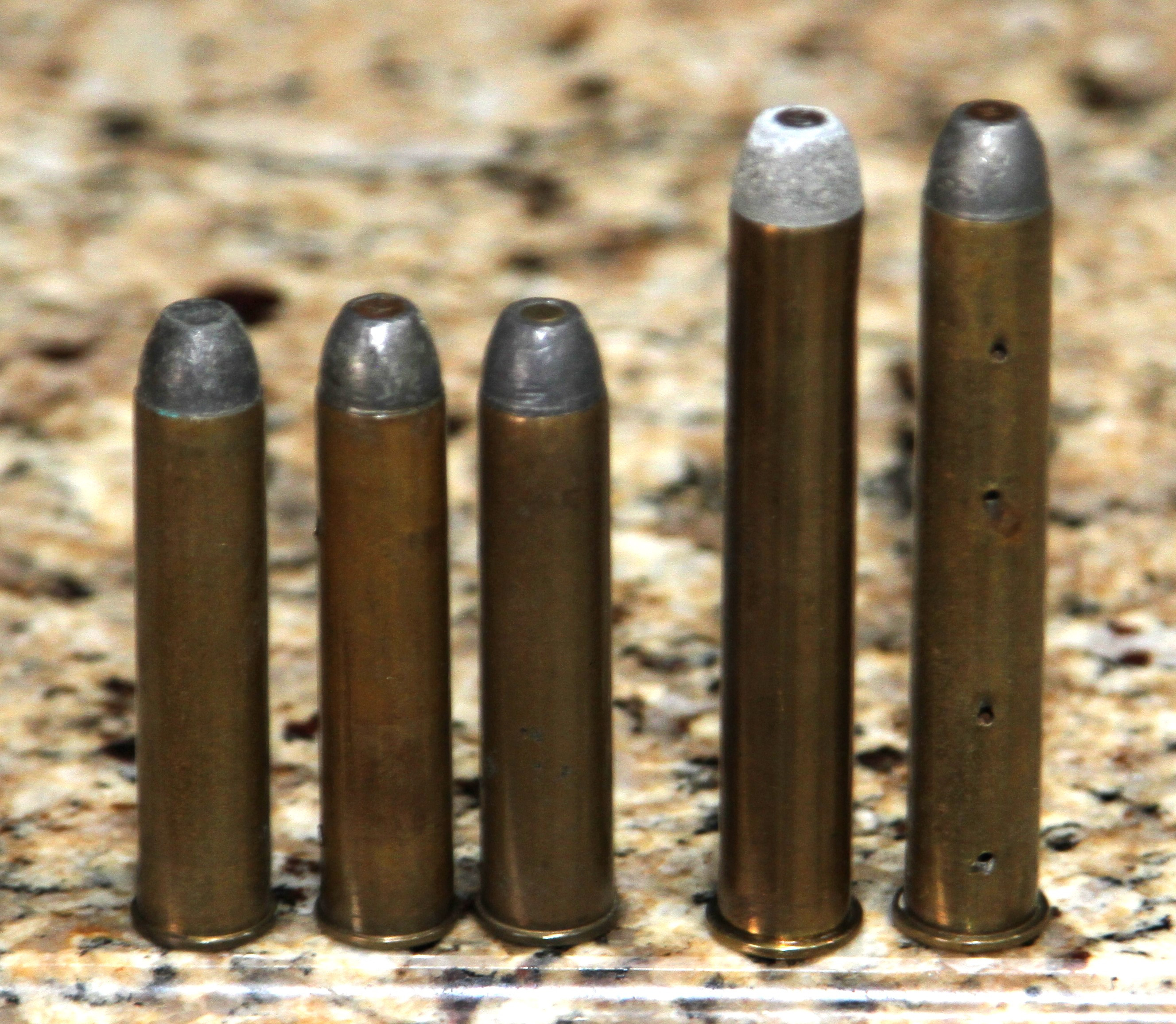

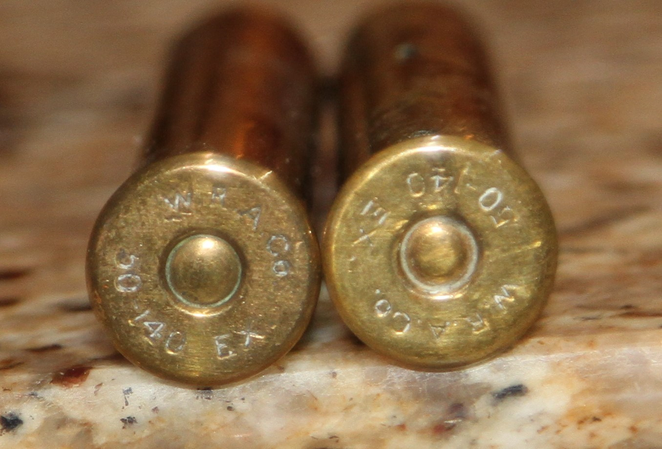

Here is a pic of the 3 ea 50 cal cartridges for the 86 next to a WRACO 50-140 EX board dummy and a loaded round.  Next pic is the head stamps for the 2 50-140 EX.
