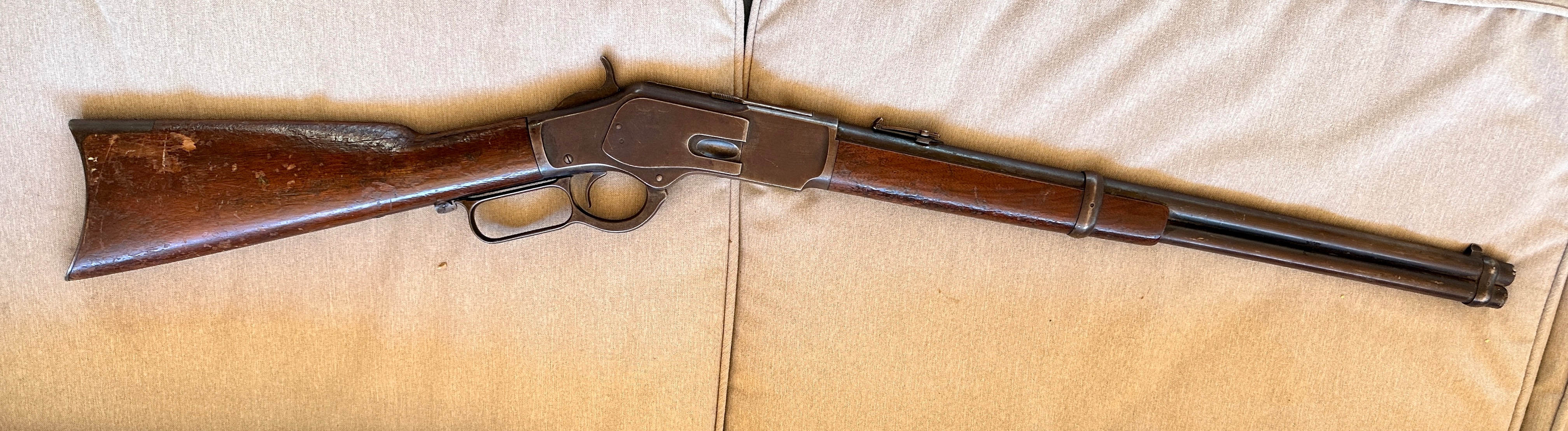

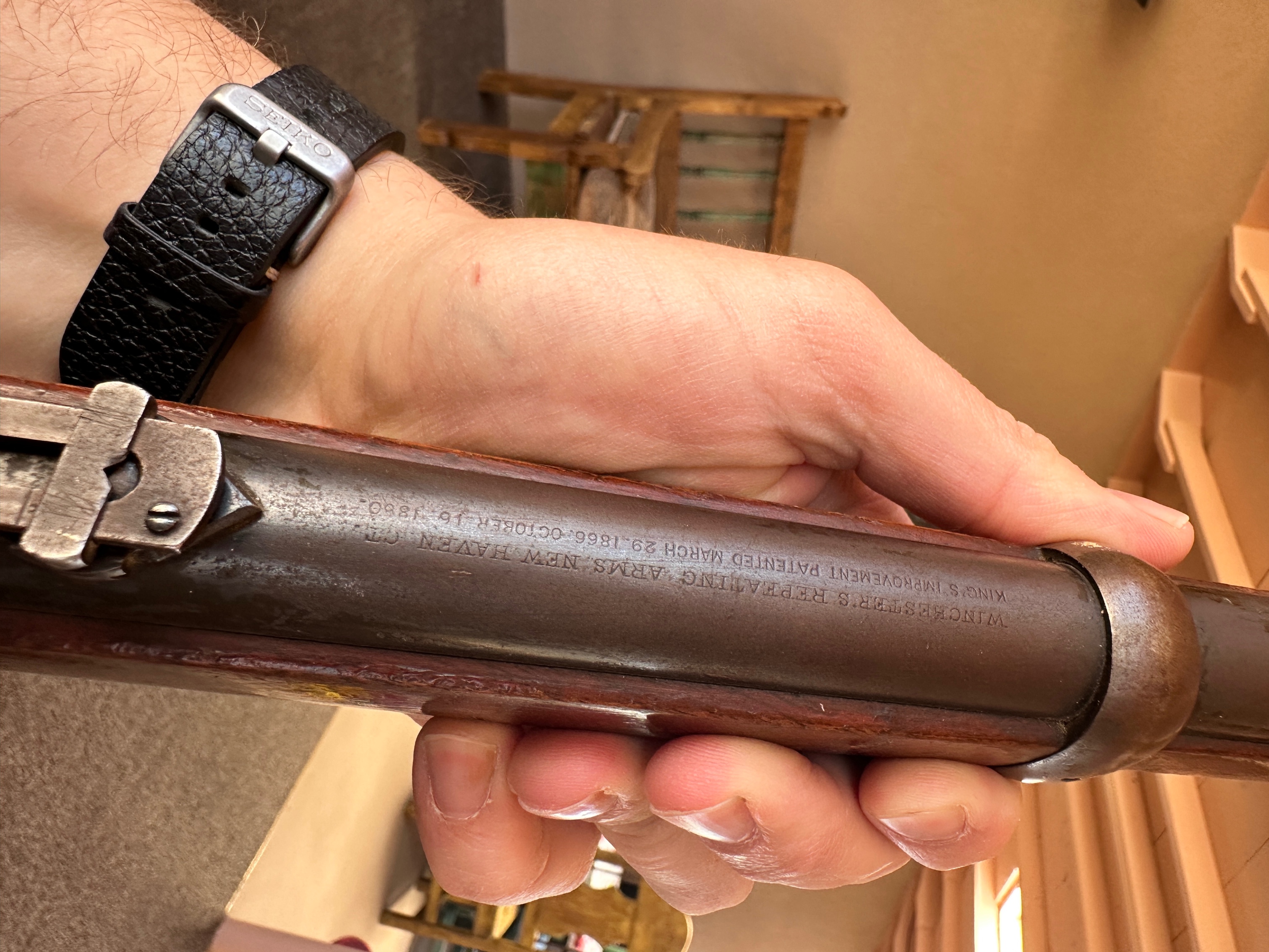

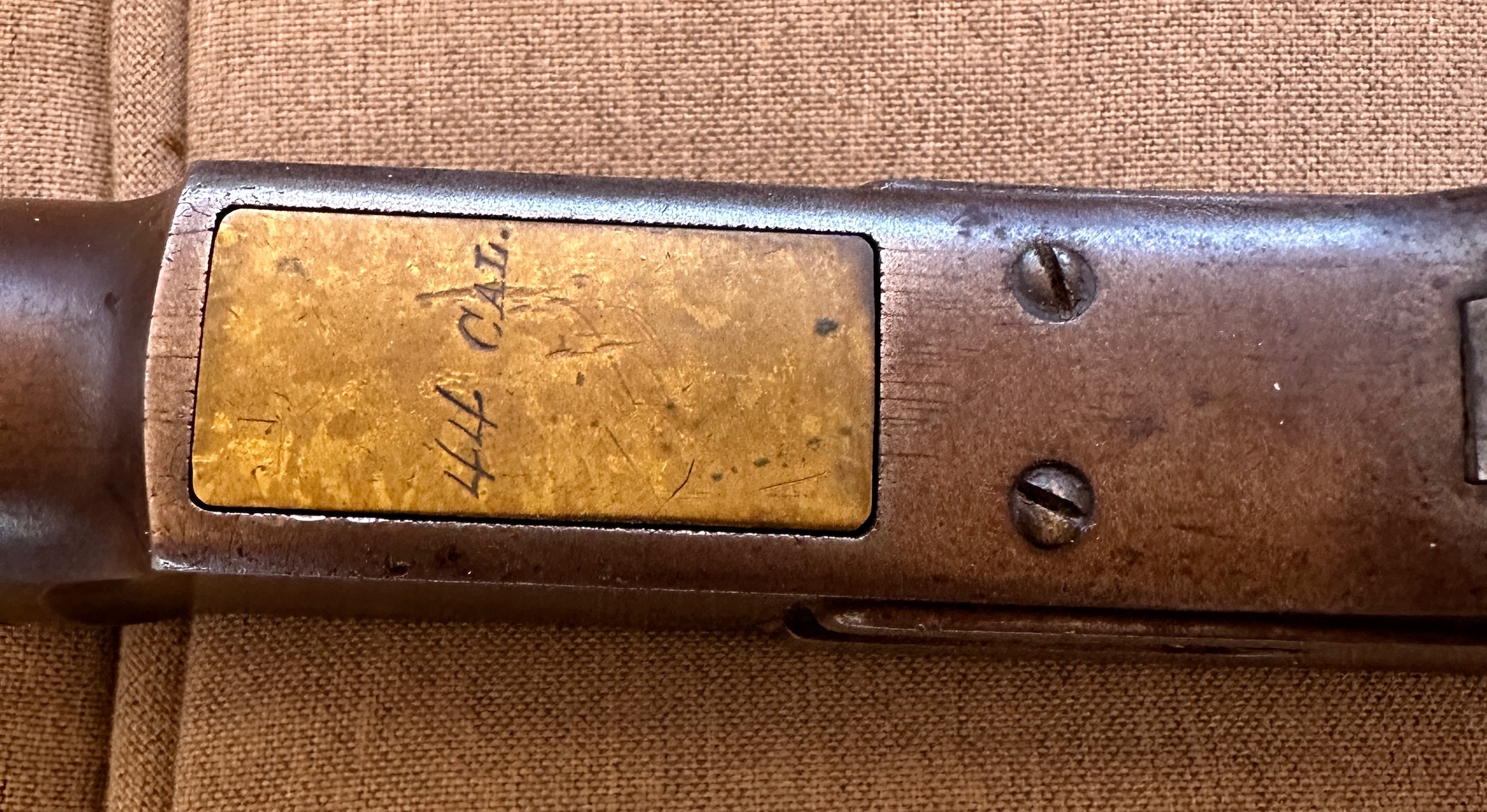

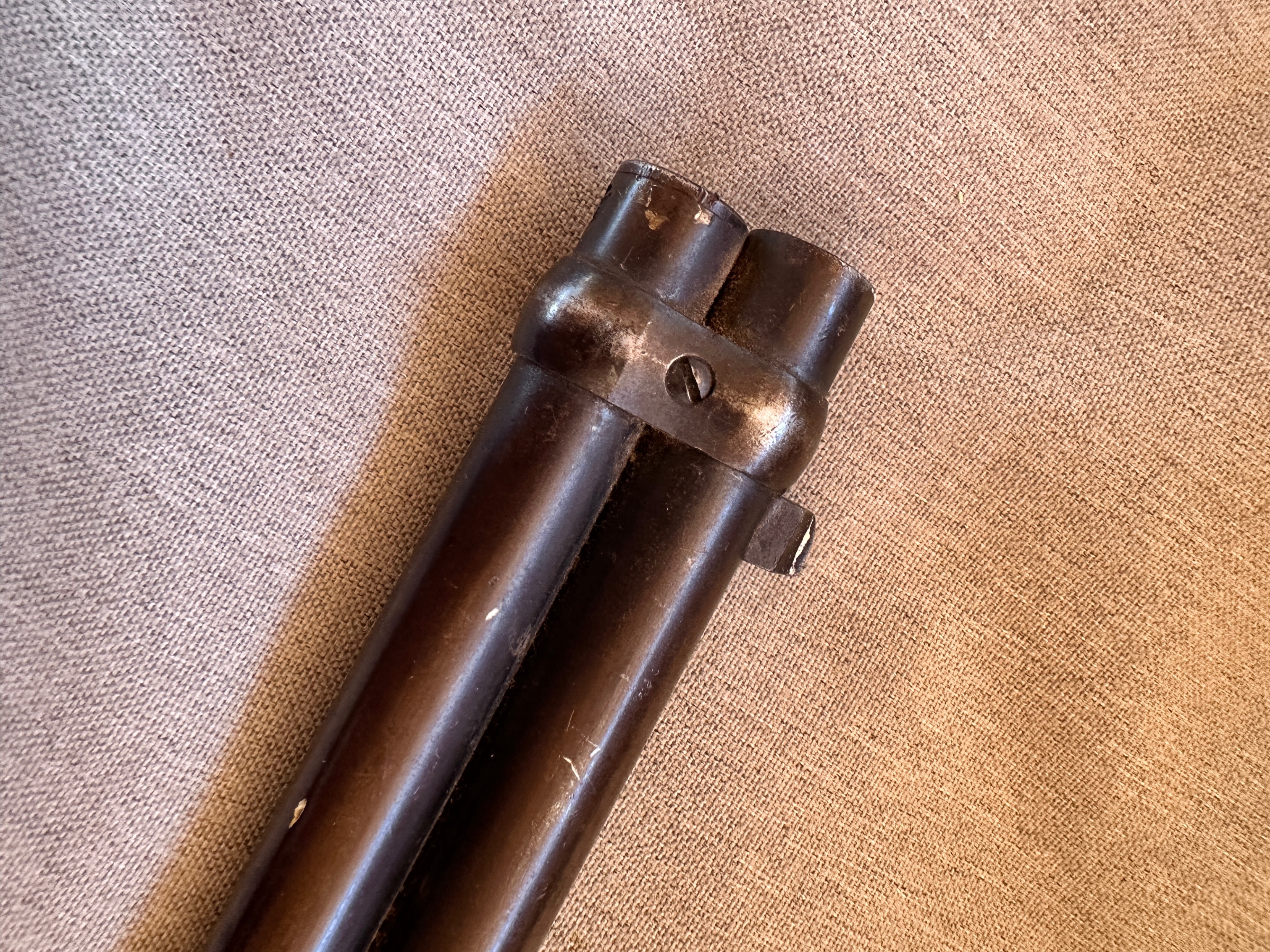

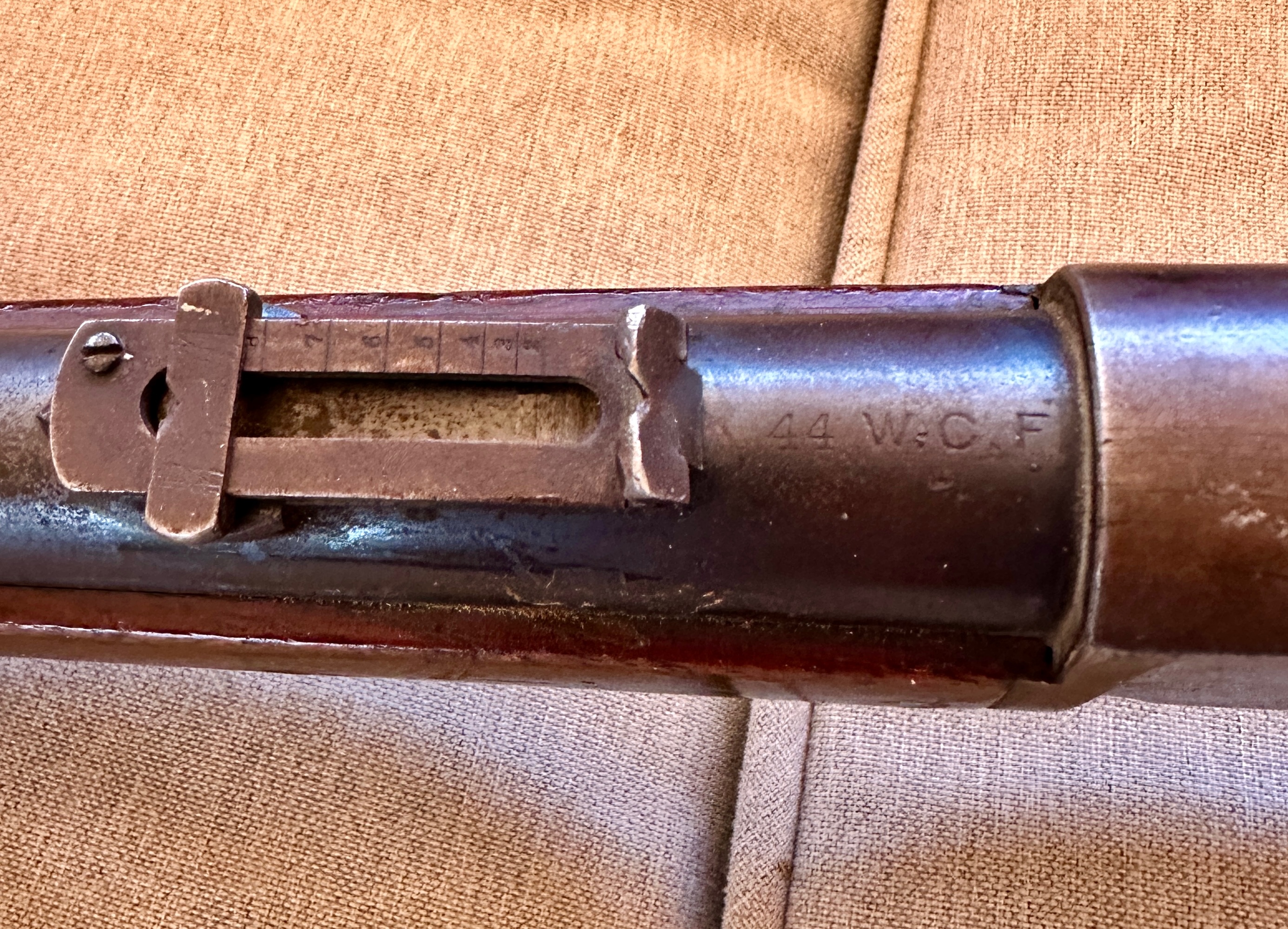

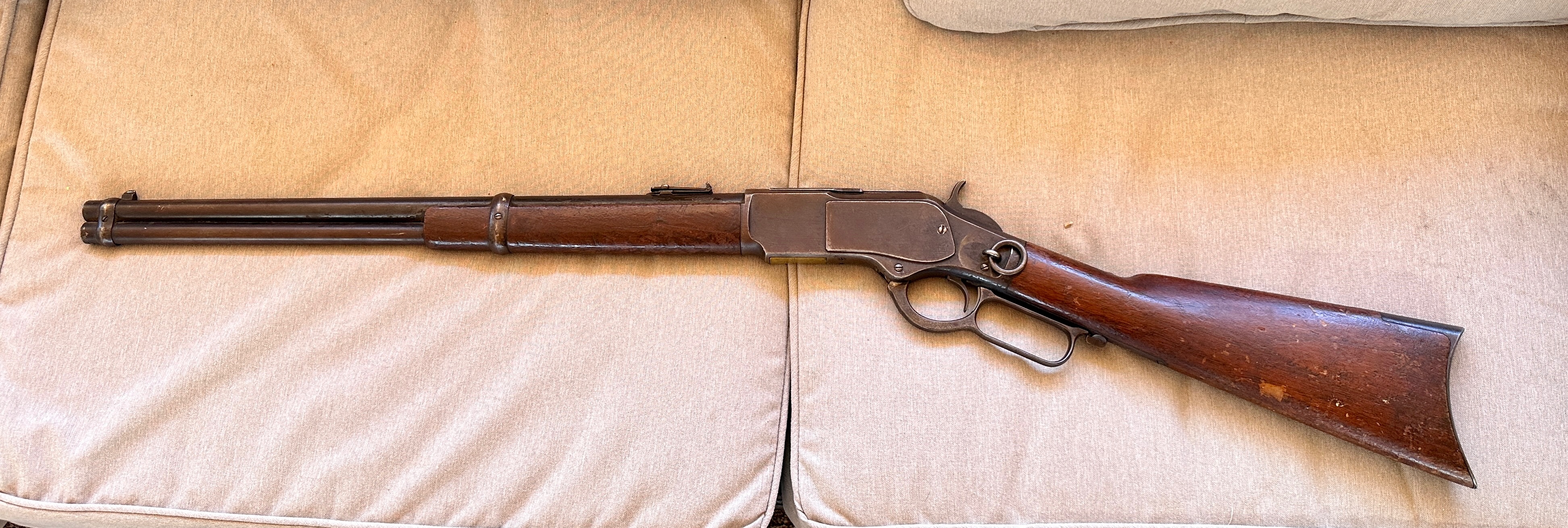

This 1873 was my wife’s grandfather’s. It was originally ordered and sold in June of 1900 according to the letter from the Cody museum. Their family moved to the southwest around the same time so I have it in my head that this gun has probably been in the family of the entire time.

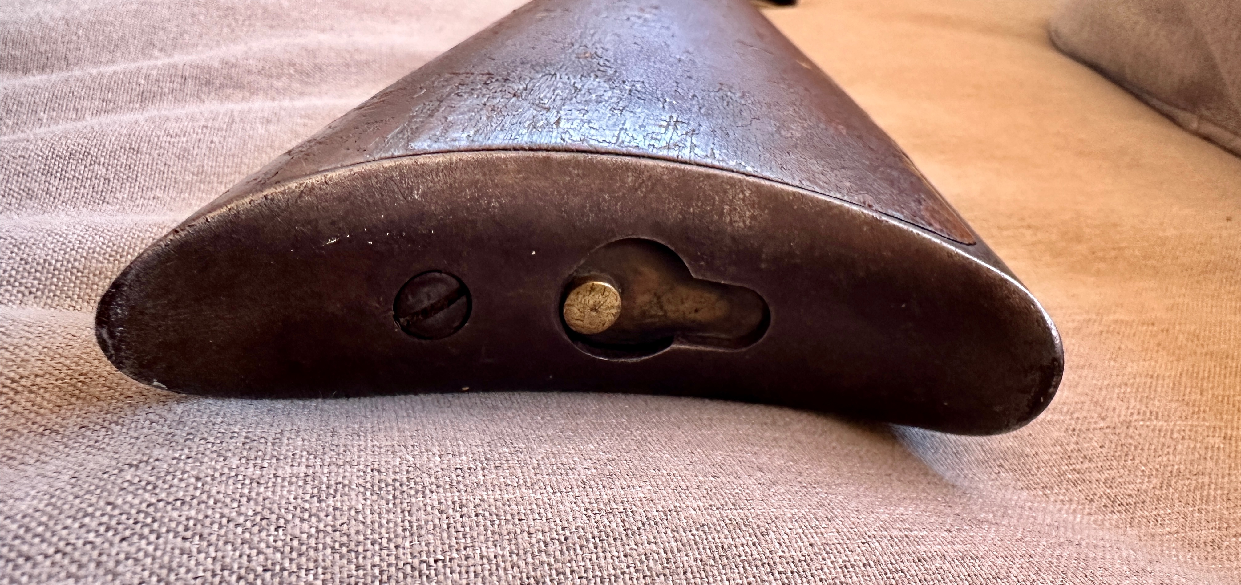

In case it’s not clear from the photos, the finish on the wood has deteriorated significantly, likely due to a century of SW summer heat. It also appears to have been varnished or shellacked somewhat sloppily at some point in its life as evidenced by the dried coating on the barrel and other metal parts. Fortunately the metal is all there and I do not see any severe rust or pitting, dings, or dents, but all of it is a dull brown in person. The action cycles and the trigger pull is pretty good. It is anyone’s guess when the last time the poor thing was cleaned or oiled… definitely not in this century and possibly in the last half century!
My plan for this old coyote is simple:
– clean the varnish off of the wood and metal. Will try denatured alcohol as I’ve seen as a suggestion on this forum, followed by acetone or mineral spirits if needed. Worst case I’ll end up scraping it off, lightly sand, and oil the wood with multiple coats 100% tung oil cut with mineral spirits.
– completely disassemble the gun to see what is lurking under the wood and metal bands. All screws will be treated with care; there are several already that have buggered up heads that I’ll be addressing.
– replace any coil springs and anything that is found broken.
What to do with the barrel and frame? I’m leaning towards completely degreasing everything, boiling it all to convert the brown rust on the surface, carding, and oiling. I’m nervous because it just seems too simple. I don’t want it to look new, but I do want to make sure it’s clean, serviceable, and shootable and able to survive another 125 years.
– reassemble, lube, and shoot occasionally. Likely all BP hand loads.

Welcome to WACA Skierd,
You’ve got a nice SRC that looks to be in pretty nice original condition, here’s what I’d do and wouldn’t do to preserve 124 years of character
– I’d use denatured alcohol to clean the varnish off the wood and metal. I would not sand the stocks.
– As the gun cycles correctly I’d resist the urge to disassemble it.
– I’d just wipe the gun down with a lightly oiled rag and skip the boiling, etc.
– I’d keep it clean, lightly oiled and also shoot it occasionally.
Good Luck with your project and let us know how it works out

  I like your gun. It’s only original once, so don’t do anything until your get good advice. Tedk made some good points.
  Do not sand anything.
  On the metal use Kroil or G96, spray or wipe the metal that you can get to. These types of products will stop any rust. Tilt the gun when using these products to reduce the contact with your wood. Oil will not hurt the metal.
  If your wood has linseed oil applied or something that wrinkled with age then you can experiment on a very small area with denatured alcohol or turpentine on a damp rag. The object is to take off the top layer that doesn’t belong without damaging any finish or stain below.
  You can take off the side plates with one screw and easily clean and lubricate working parts.
  Run an oil patch down the bore.
  Don’t take anything apart unless it’s broke. Less is better, your gun has a good look. It took years to get the natural patina and blue mix, leave it there.

After removing the varnish use Boiled linseed oil on the wood.  Lightly wipe the metal surfaces with an oily rag to clean off the dirt. Oil the interior and moving parts but do not take it apart.  One of your descendants will appreciate that you didn’t ruin it.

You already have a lot of really good advice and suggestions from a few who have been there. I’ll add, to remember it’s not a modern brand new rifle, and don’t try to pretty her up too much!!!
The exterior screws, that you choose to replace that are buggered, after the suggested Kroil, is applied to the screw, a light tap with the proper sized, small flat set, on the head of the screw, on top of the slot, and a small machinist, (ball paean), hammer, it really helps to break free the crud that has, helped to secure those frozen screws in place! Like was said earlier, refrain from completely tearing it apart!
Naturally we don’t know you’re capabilities and what you’re level of competence is, but go slow, and as much patina, that you can leave on it, will do more good than harm!!! IMHO!

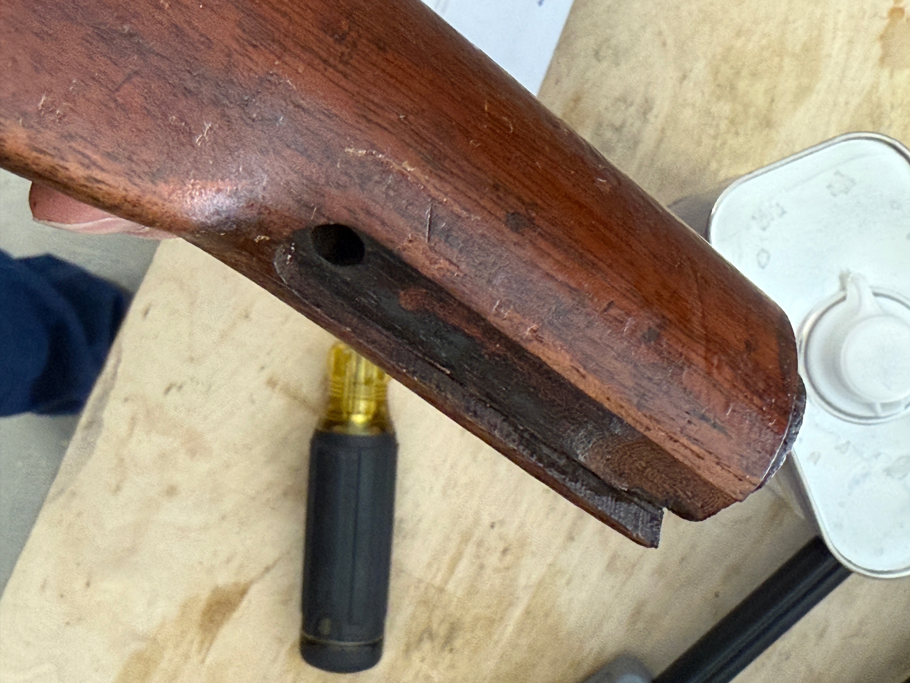

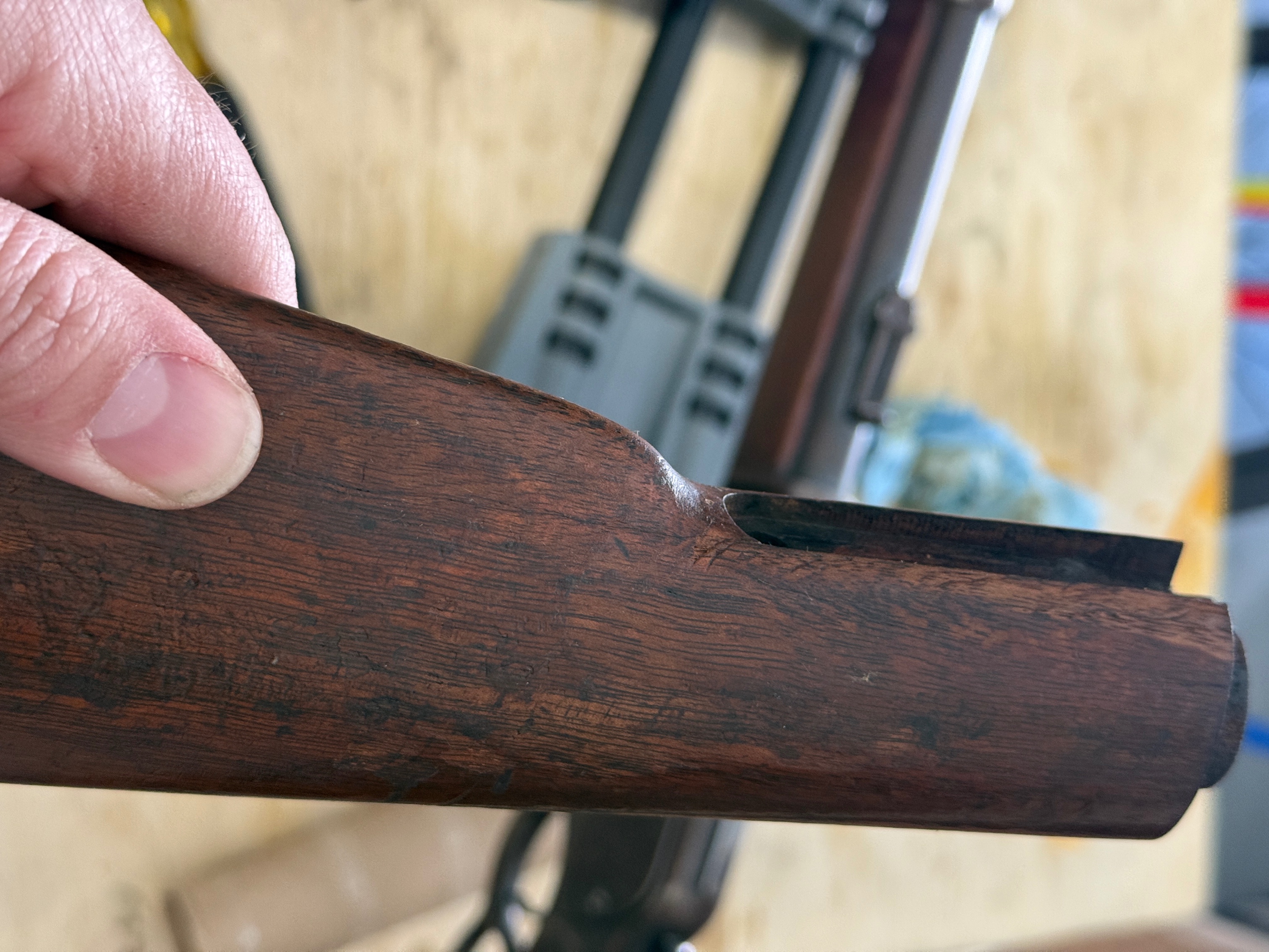

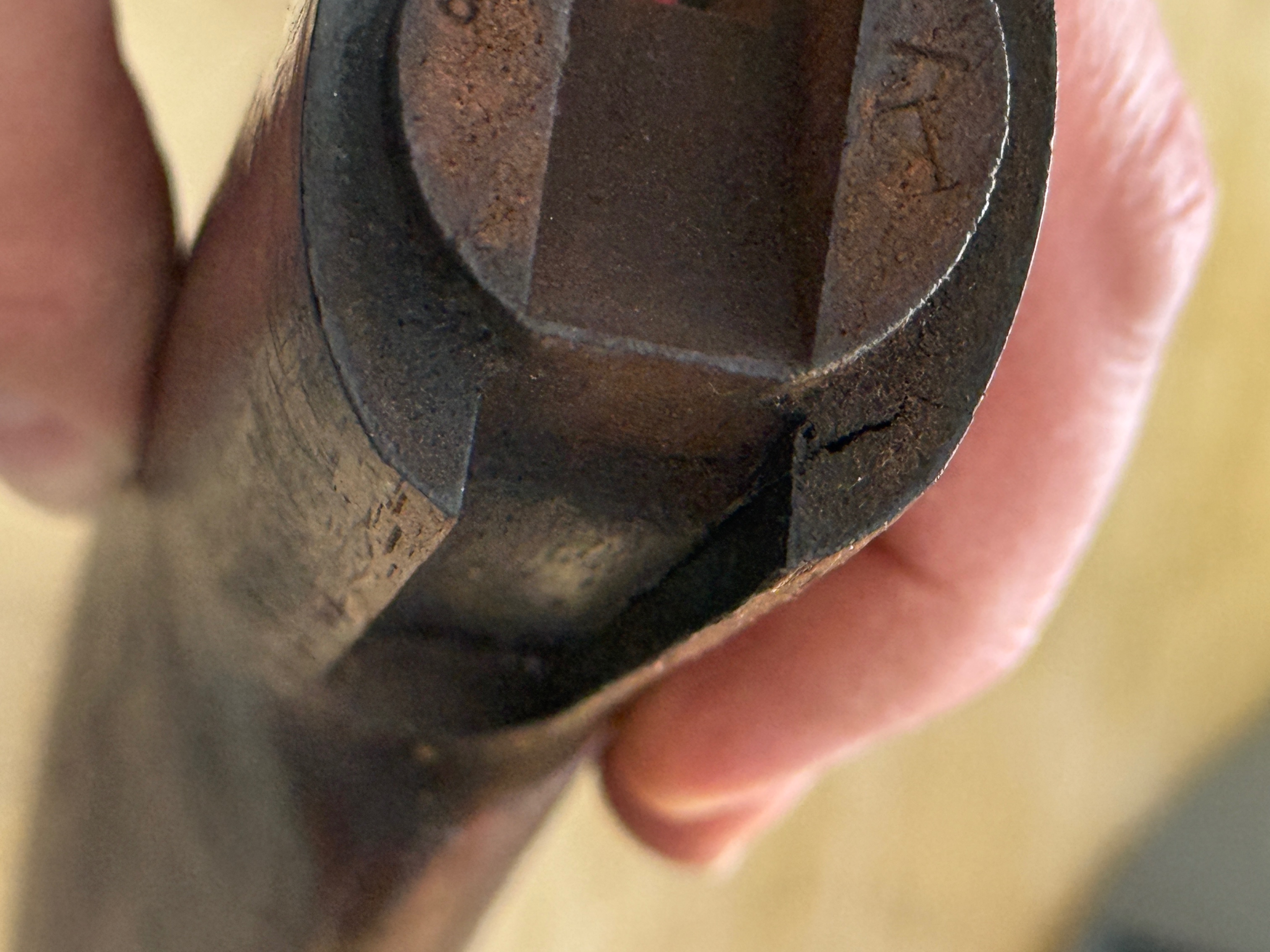

Bob, What is your opinion of that buttstock?

The stock has a little fit issue and has a old heavy alligated finish which might be helped with some TLC. There is something going on with the top of the stock along side the top tang. The surface looks irregular, just not a good view of it.  I would worry when removing the heavy finish is if you remove too much and loose the color in the wood or when your done it will stick out as a refinished stock.

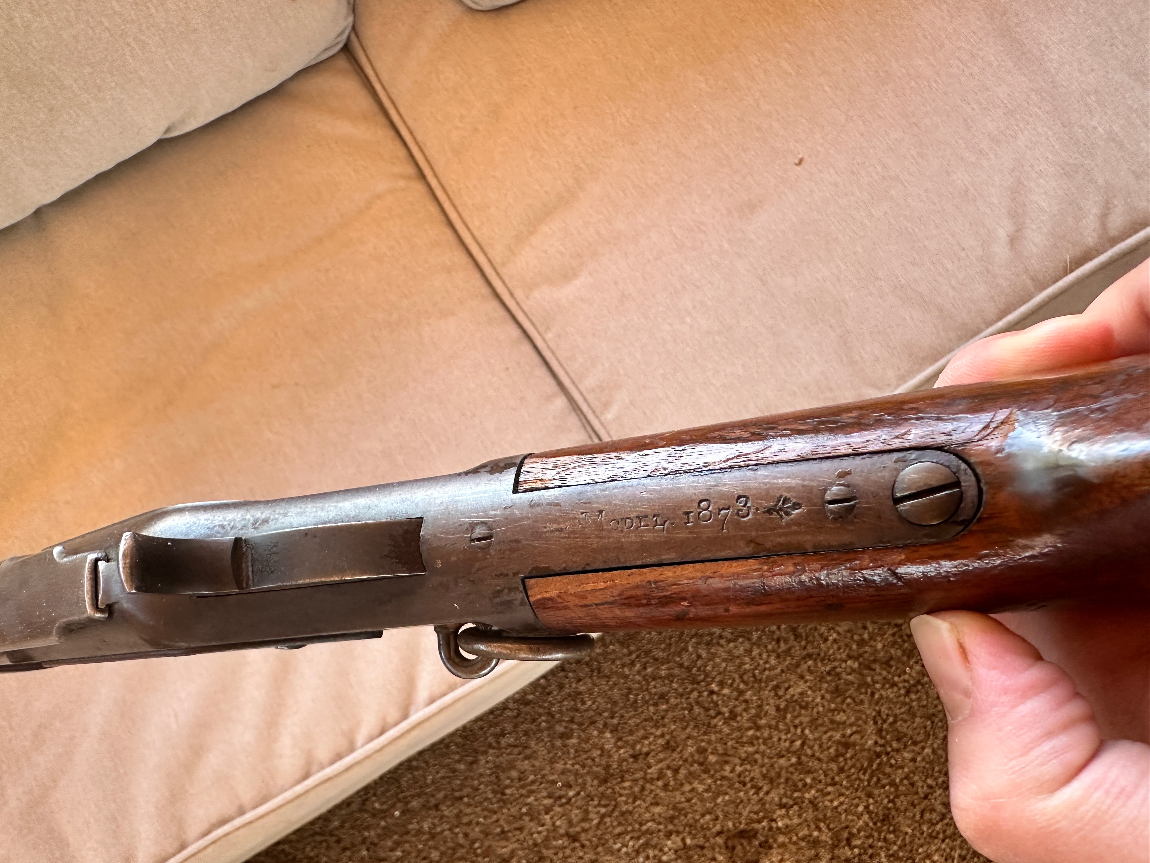

I’ve attached another picture, this time of the top of the rear tang if that helps with anything.

It looks like the wood along the upper tang splintered off.

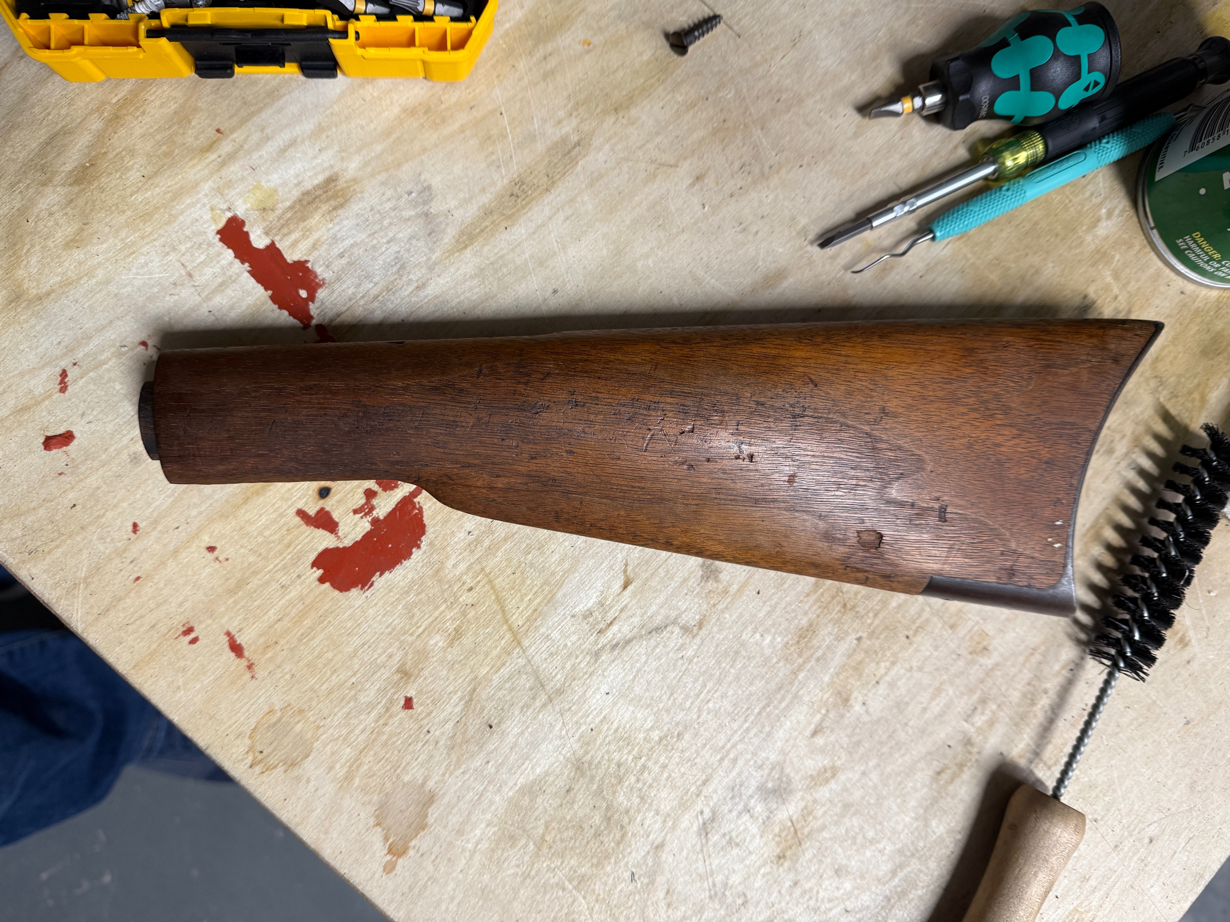

I gotta say I’m impressed that you guys were able to see that in photos when I hadn’t noticed it in person until I got the stock off tonight.  There is indeed a small split forming near where the stock meets the upper tang on the loading gate side.

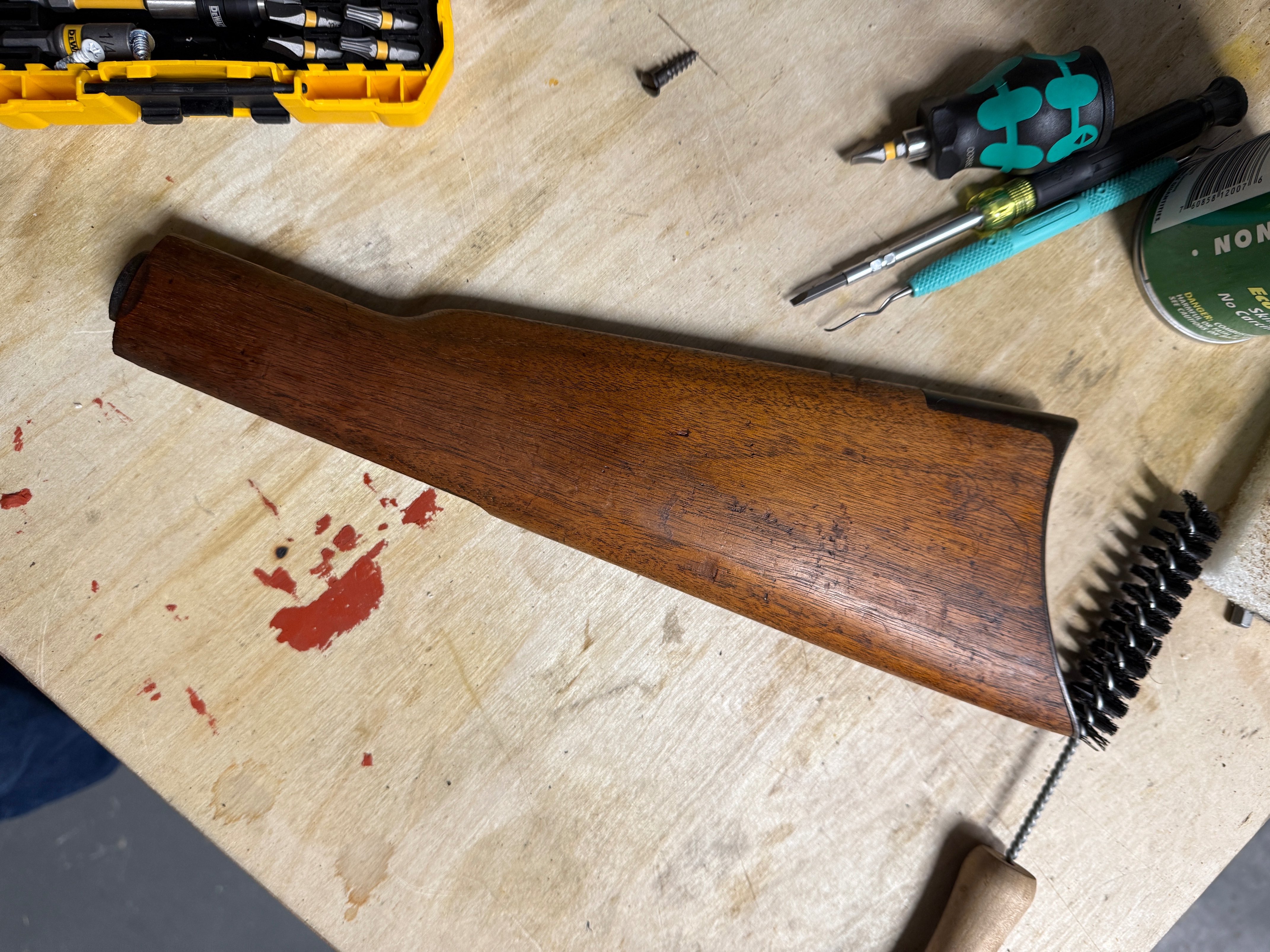

I was able to test using denatured alcohol to remove the shellac on the metal tonight and I’m happy to report it is coming off nicely with only a little persuasion from an old t-shirt. I can’t wait to see what’s under the alligator and orange peel.

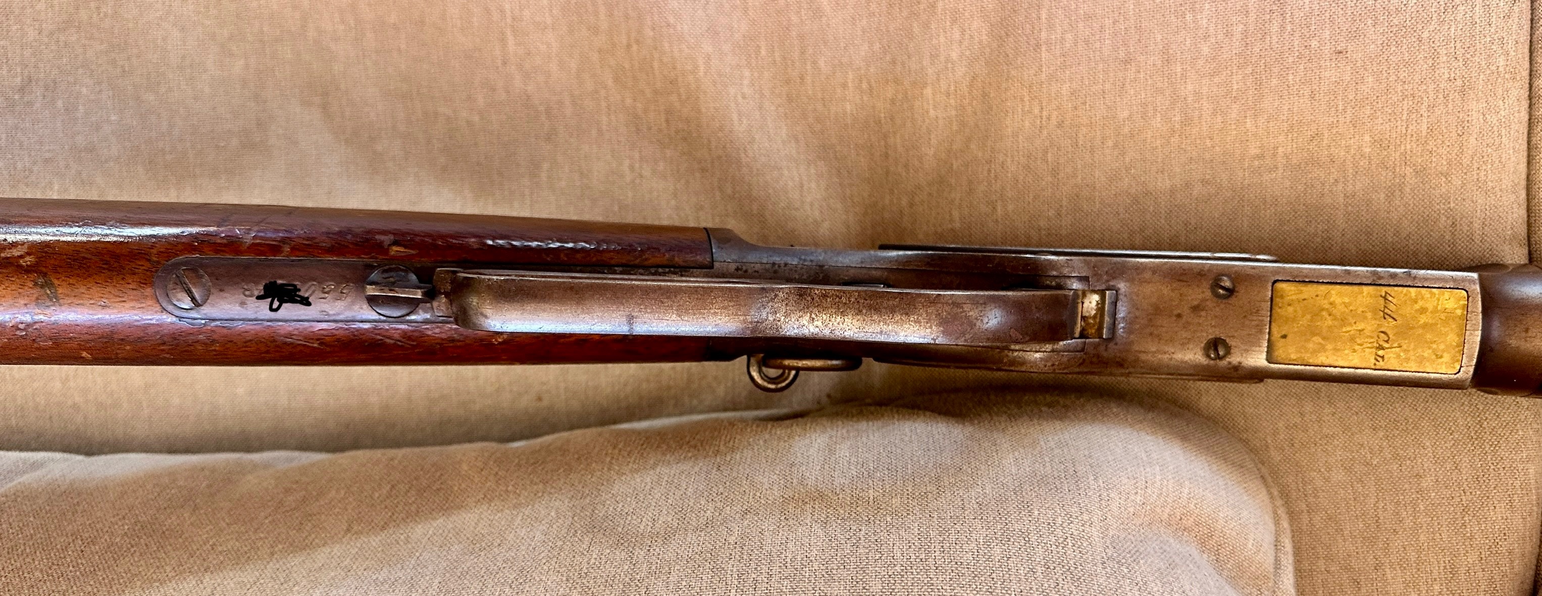

May 17, 2025 - 5:57 am

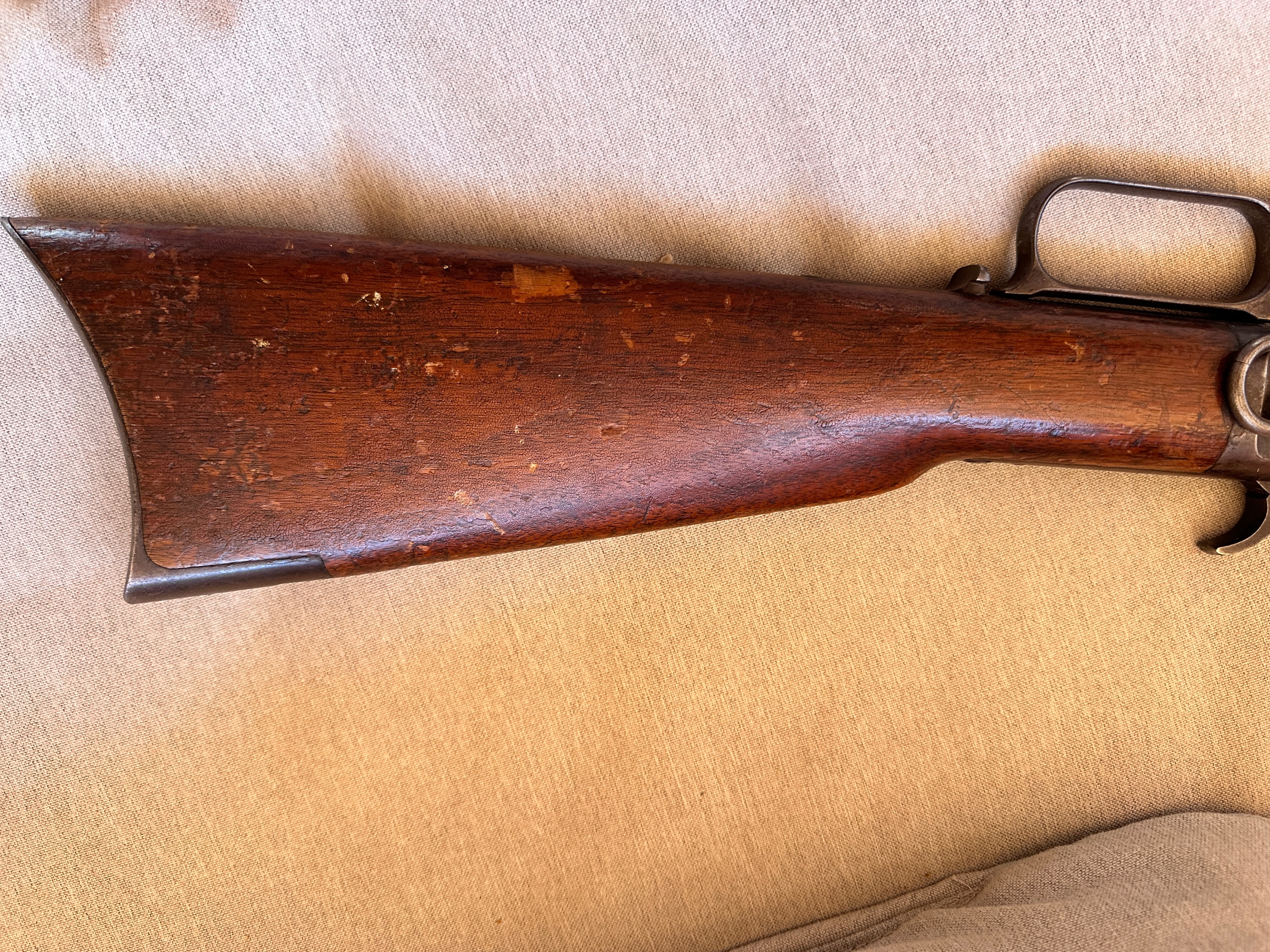

here’s what was hiding under all of that shellac.

That does look a lot better,
Forum Posts: 2493
May 17, 2025 - 2:39 pm
That looks mighty good, to me.  It looks like you left all the character and color and got rid of the crud.
I’ll be curious to know what our guys think. Leave well enough alone or wipe on a little boiled linseed oil?
It’s good you caught that split because you can stop it and make it stronger from inside the mortise.
That sure is a fine-looking Winchester for its age!
