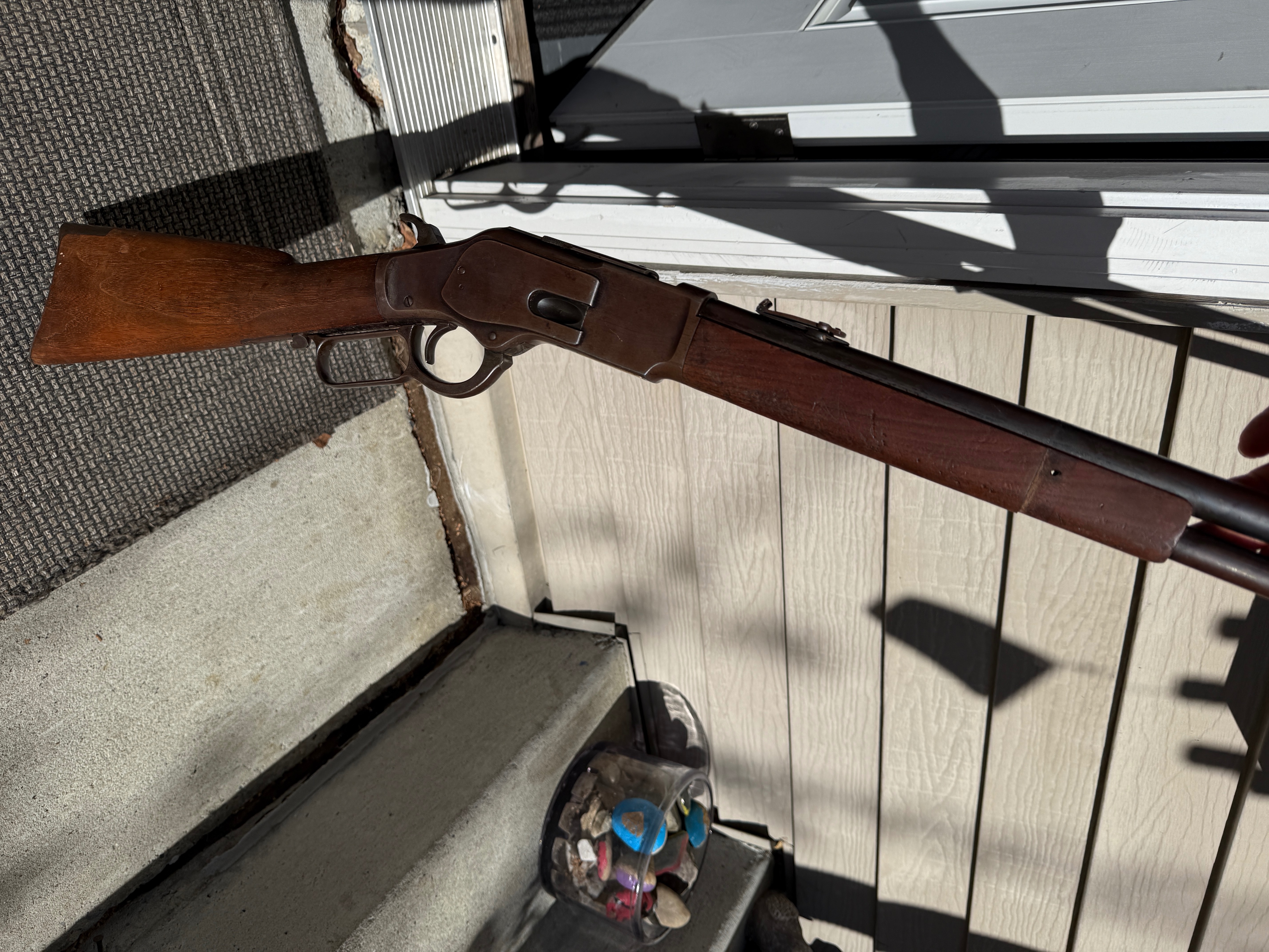

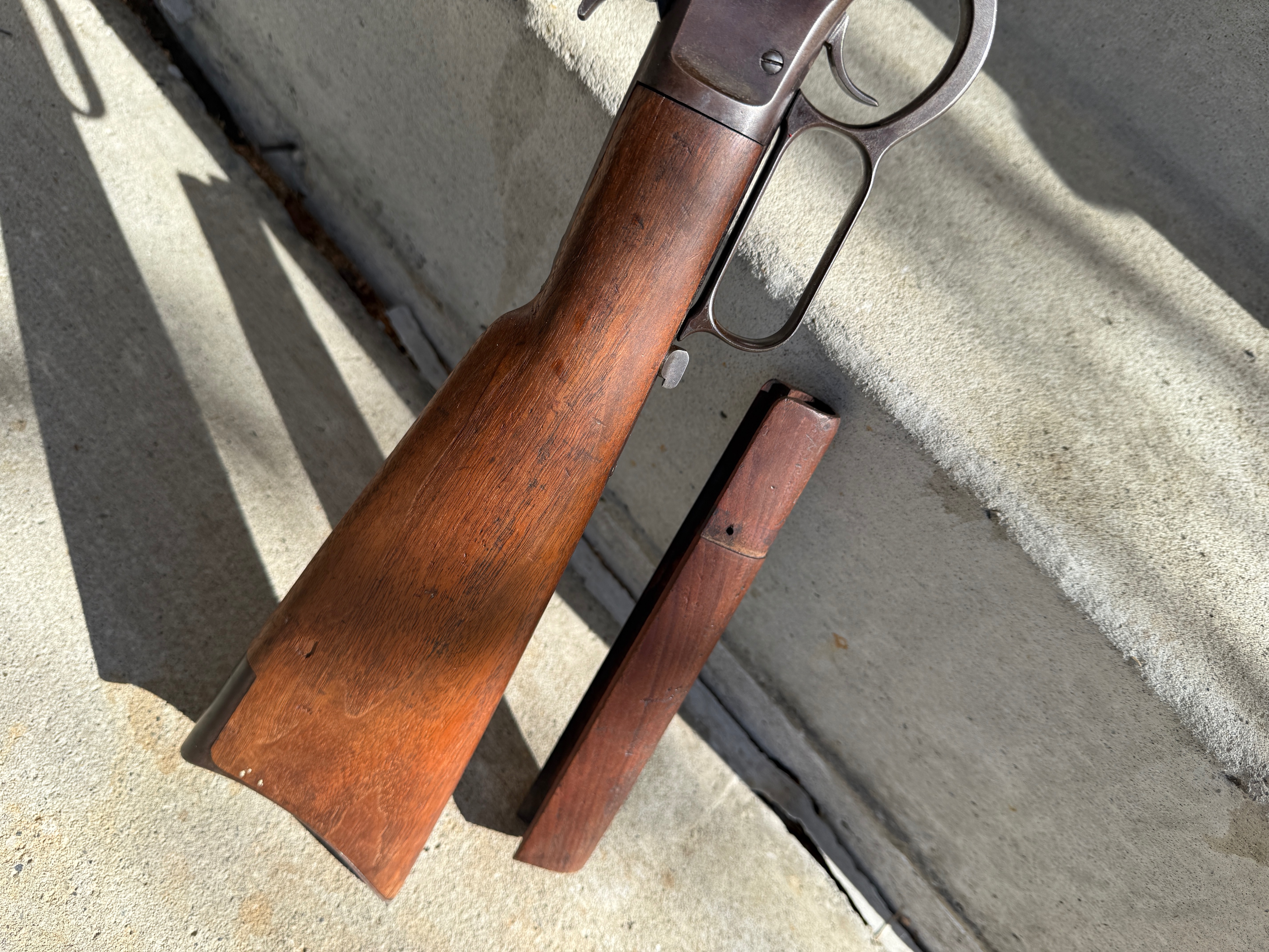

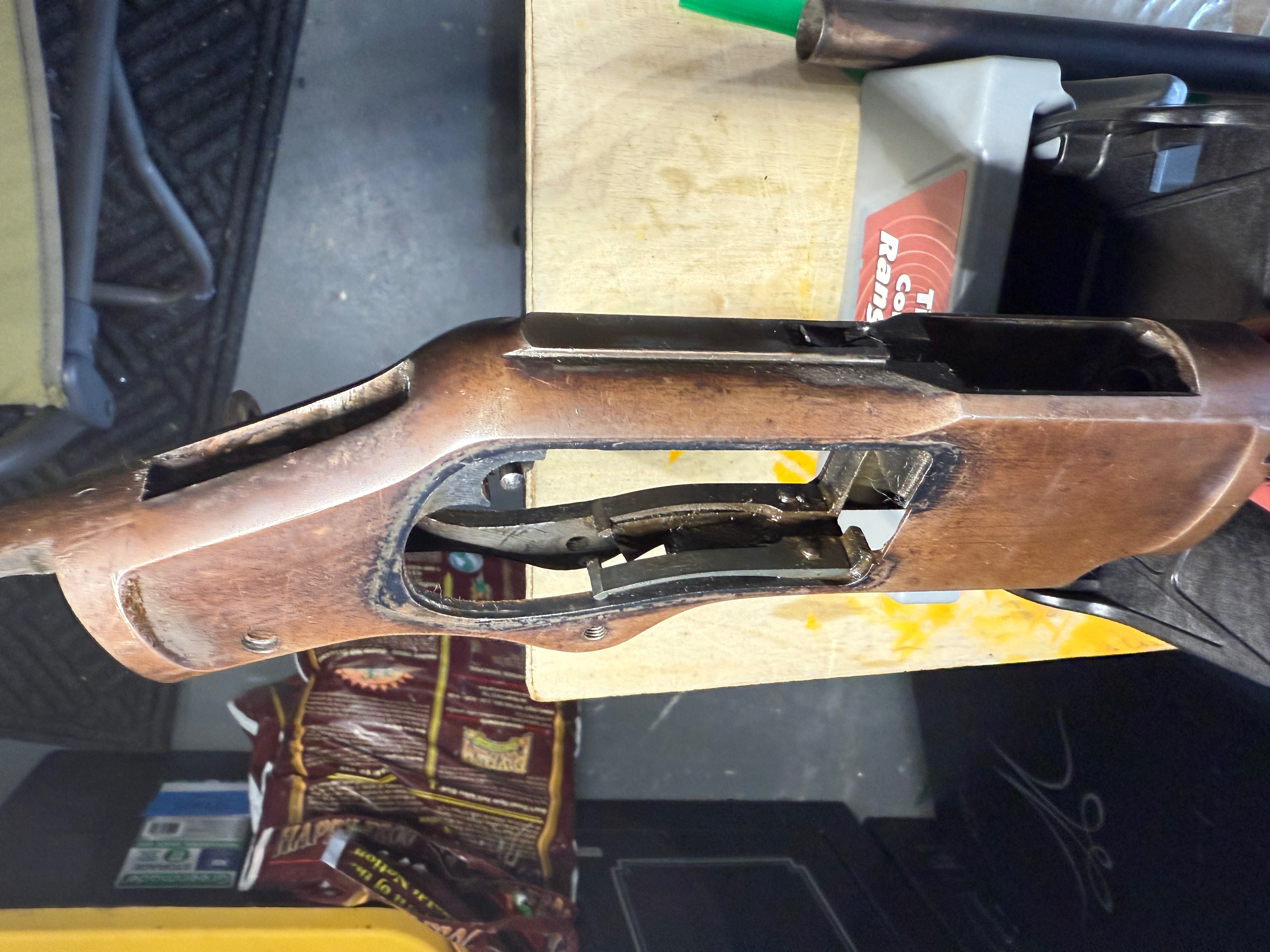

That looks mighty good, to me.  It looks like you left all the character and color and got rid of the crud.
I’ll be curious to know what our guys think. Leave well enough alone or wipe on a little boiled linseed oil?

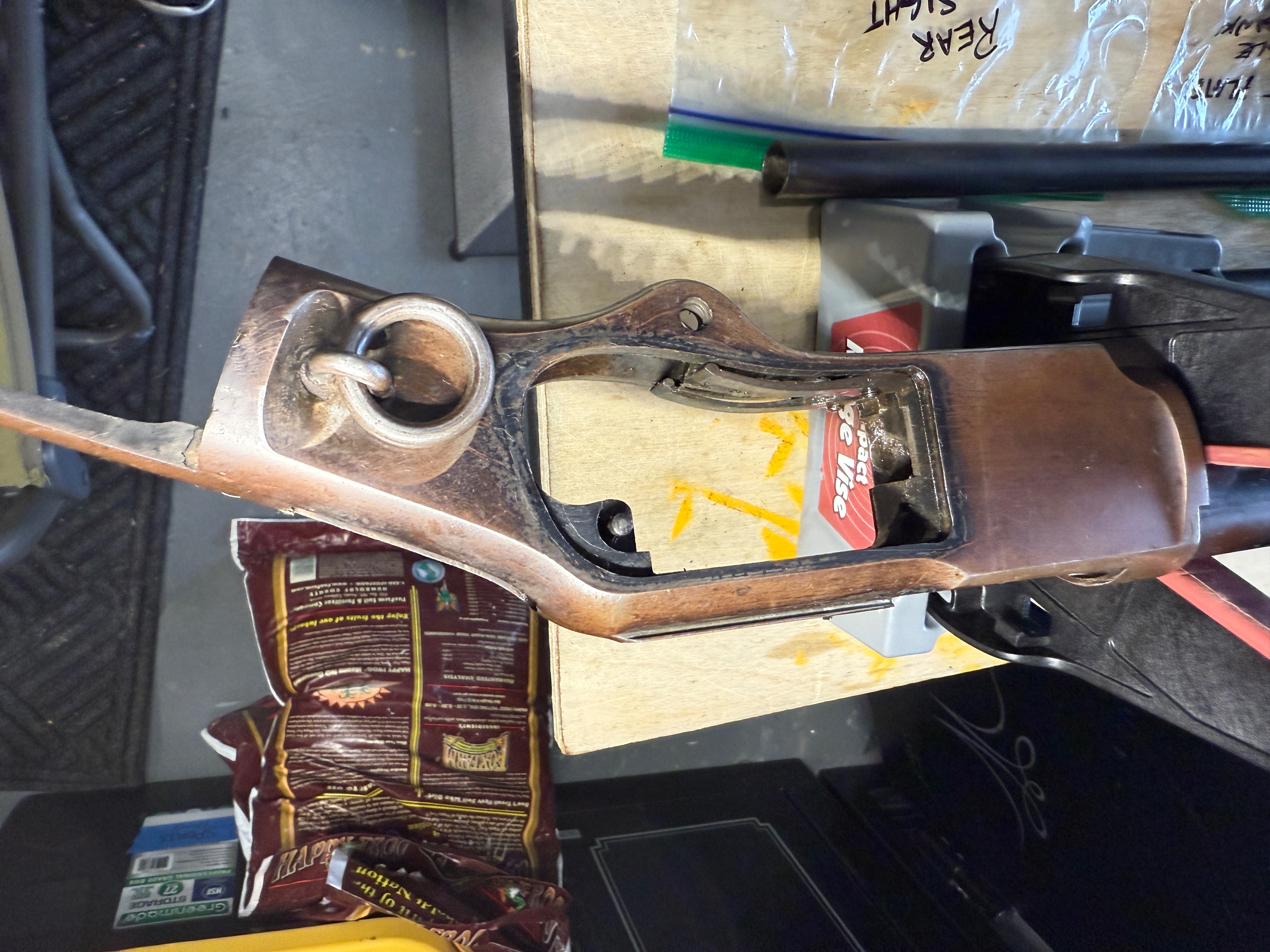

It’s good you caught that split because you can stop it and make it stronger from inside the mortise.
That sure is a fine-looking Winchester for its age!
Getting rid of crud and corrosion is the goal, using the gentlest means possible so I don’t remove original character and flaws from a century of use. I’m not the first person to turn screws on this gun, and it has been used over the years. I want to preserve as much of that character as I can while also removing finishes and oils that have failed so I can prevent bigger problems from showing up in the future. Like the imminent stock failure. Like the rusty tang I found under the nice looking wood on my 1947 Remington Model 11, disintegrating recoil spring plug on my 1905 Model 8, and the gelled goo that was once oil or grease that gummed up the action of my Smith & Wesson 38/44 so badly it was difficult to cock the hammer.
It might not be historically correct, I’ll be applying tung oil (real milk paint co 100% pure tung oil mixed 50-50 with mineral spirits) to protect the wood after I address the split. I prefer tung oil to BLO, and have plenty on hand from finishing the stock on my Kibler Woodsrunner flintlock.

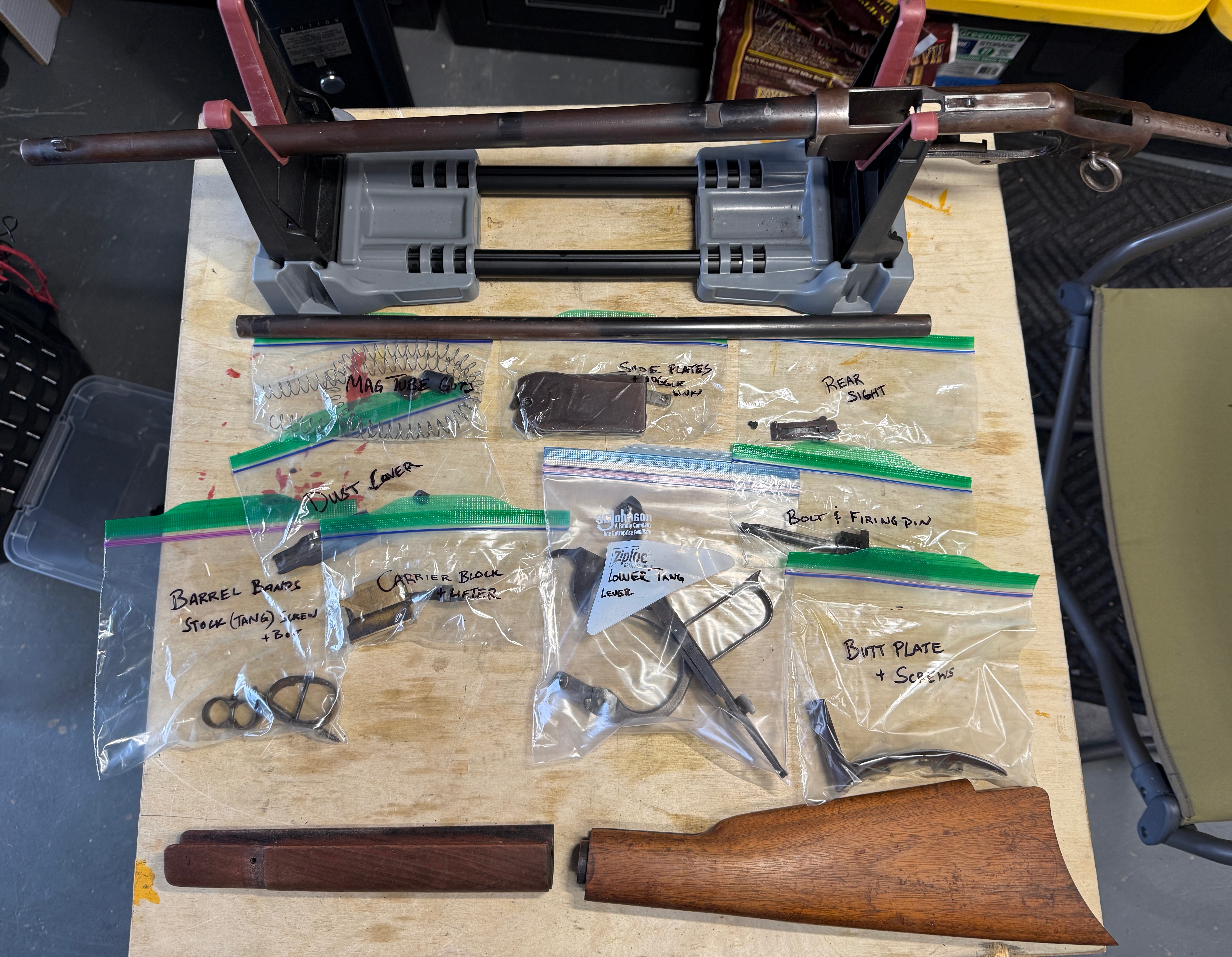

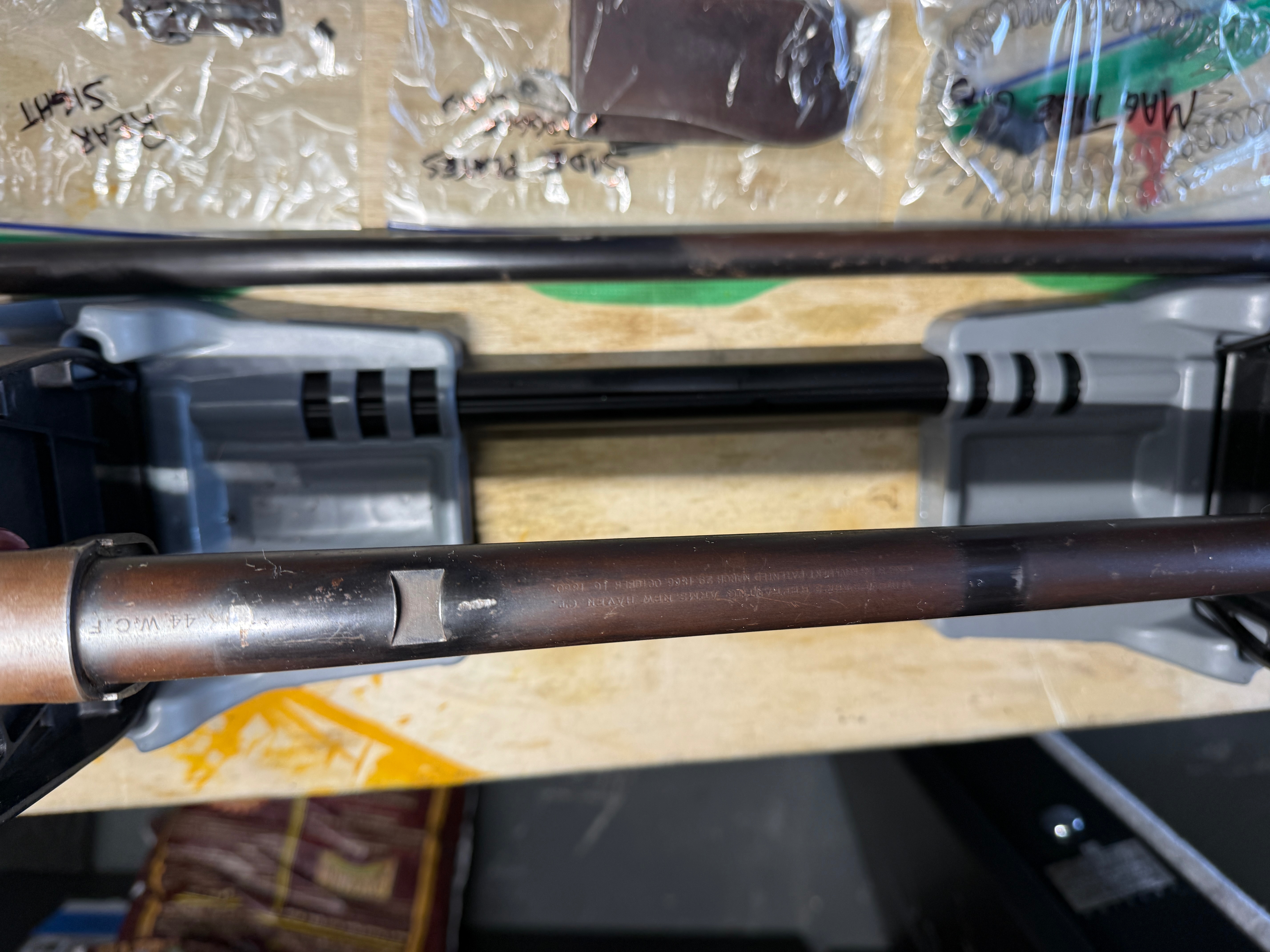

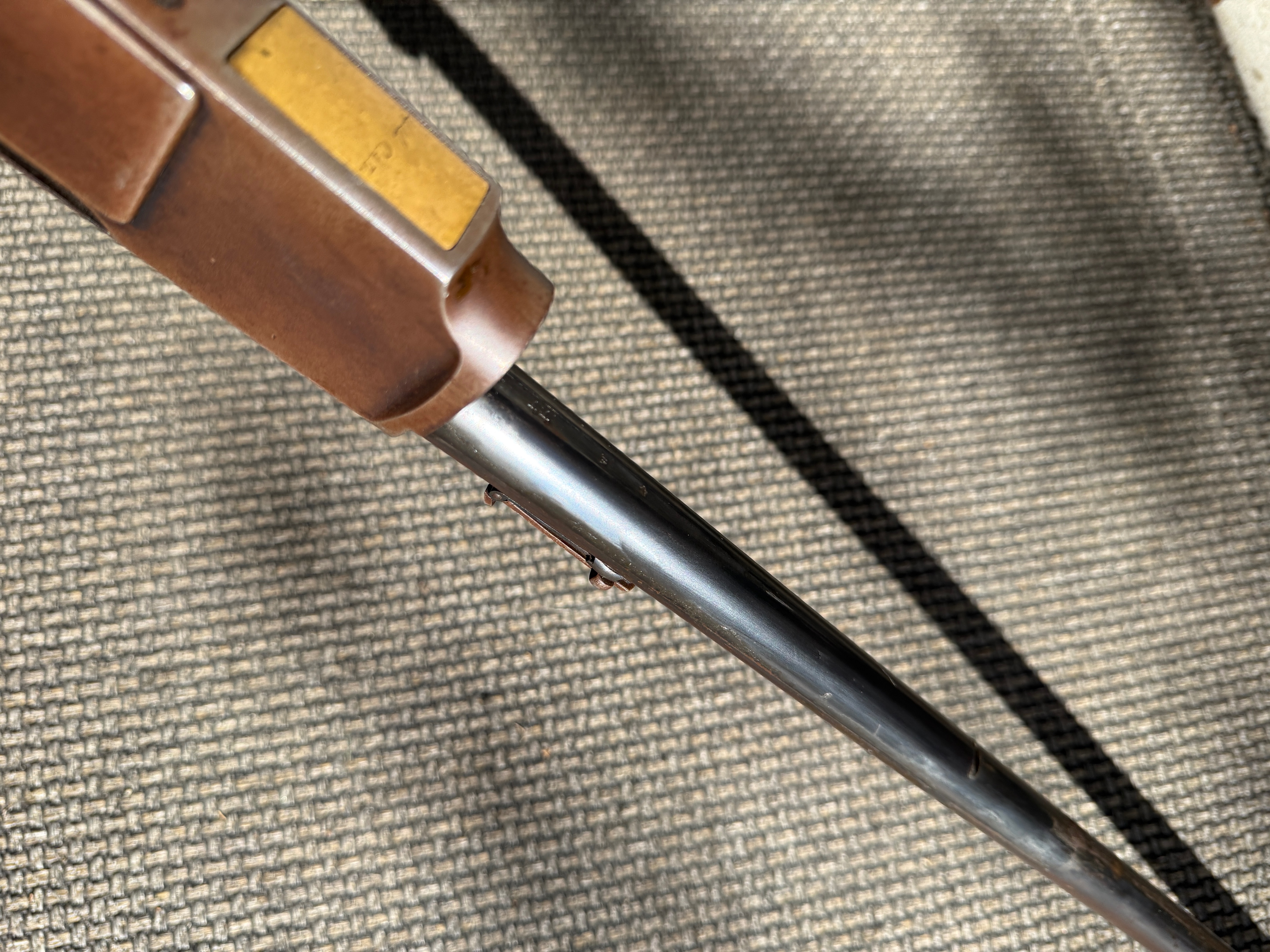

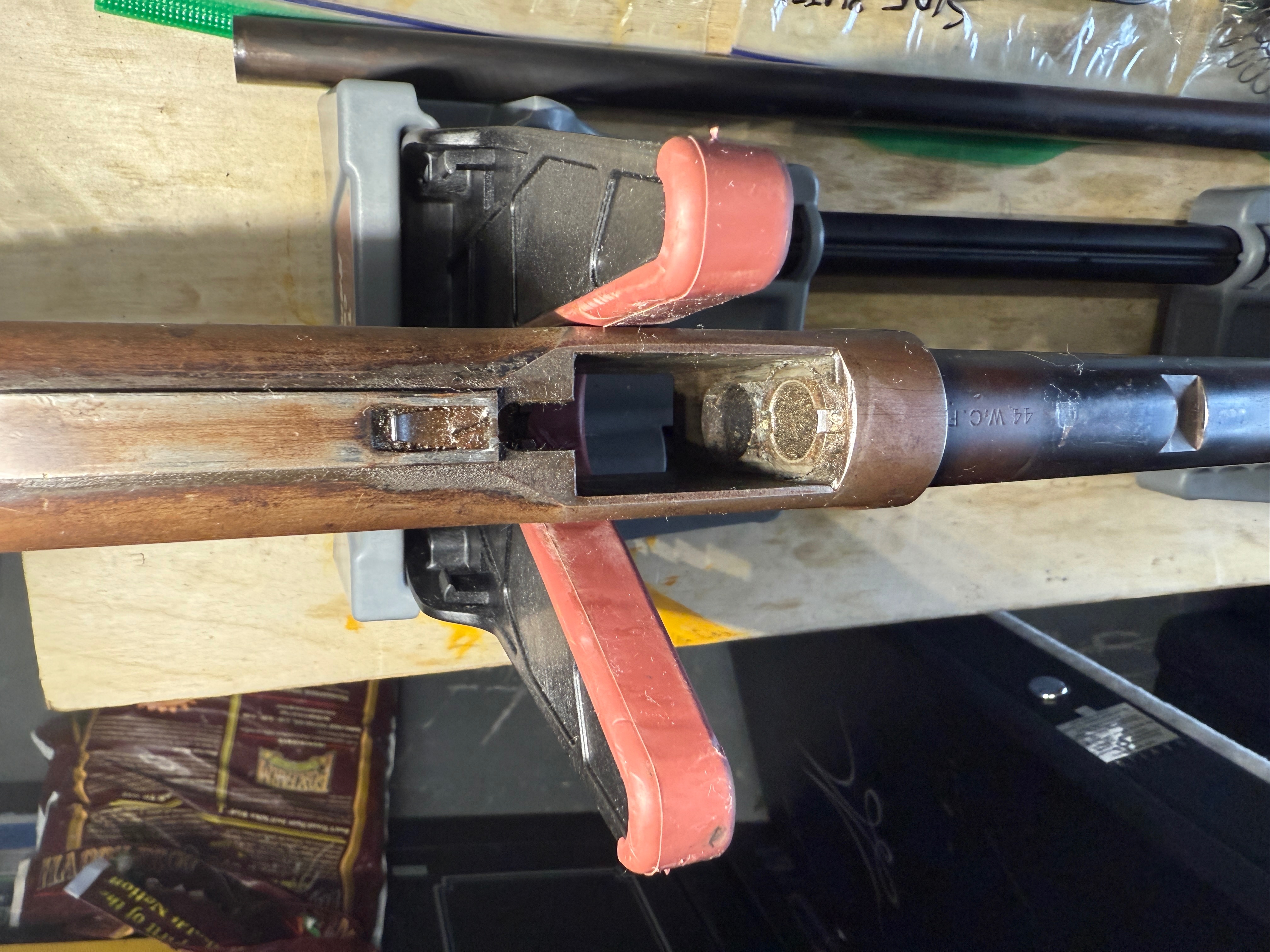

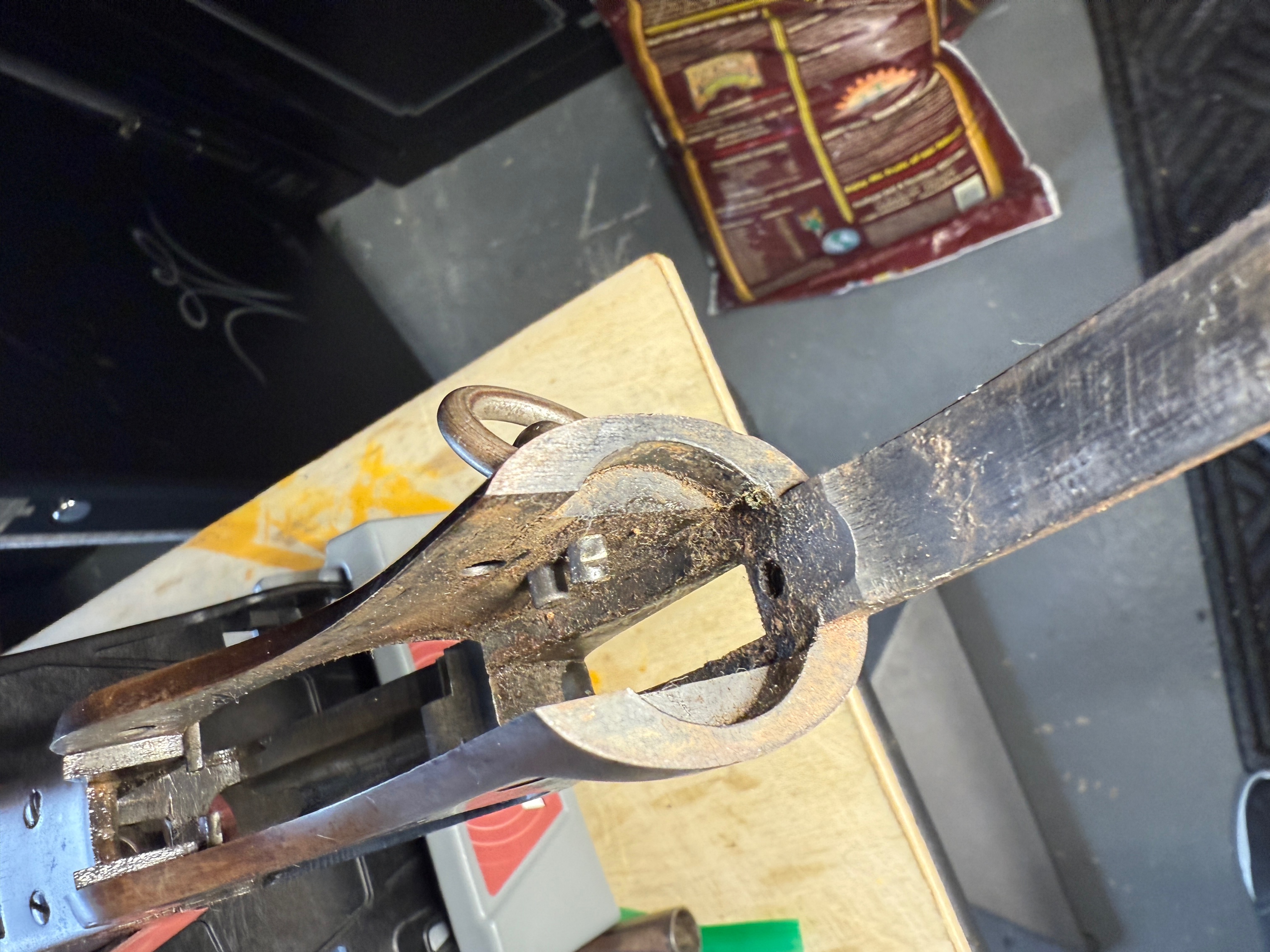

I was able to remove the forearm and magazine tube this morning, and cleaned the shellac off of the forearm. Lots of grit, a little bit of grime, a little bit of rust, but no major lurking catastrophes.
I also got a glimpse of the original blueing still hiding on the underside of the barrel. This would have been a pretty nice looking rifle back in the day.

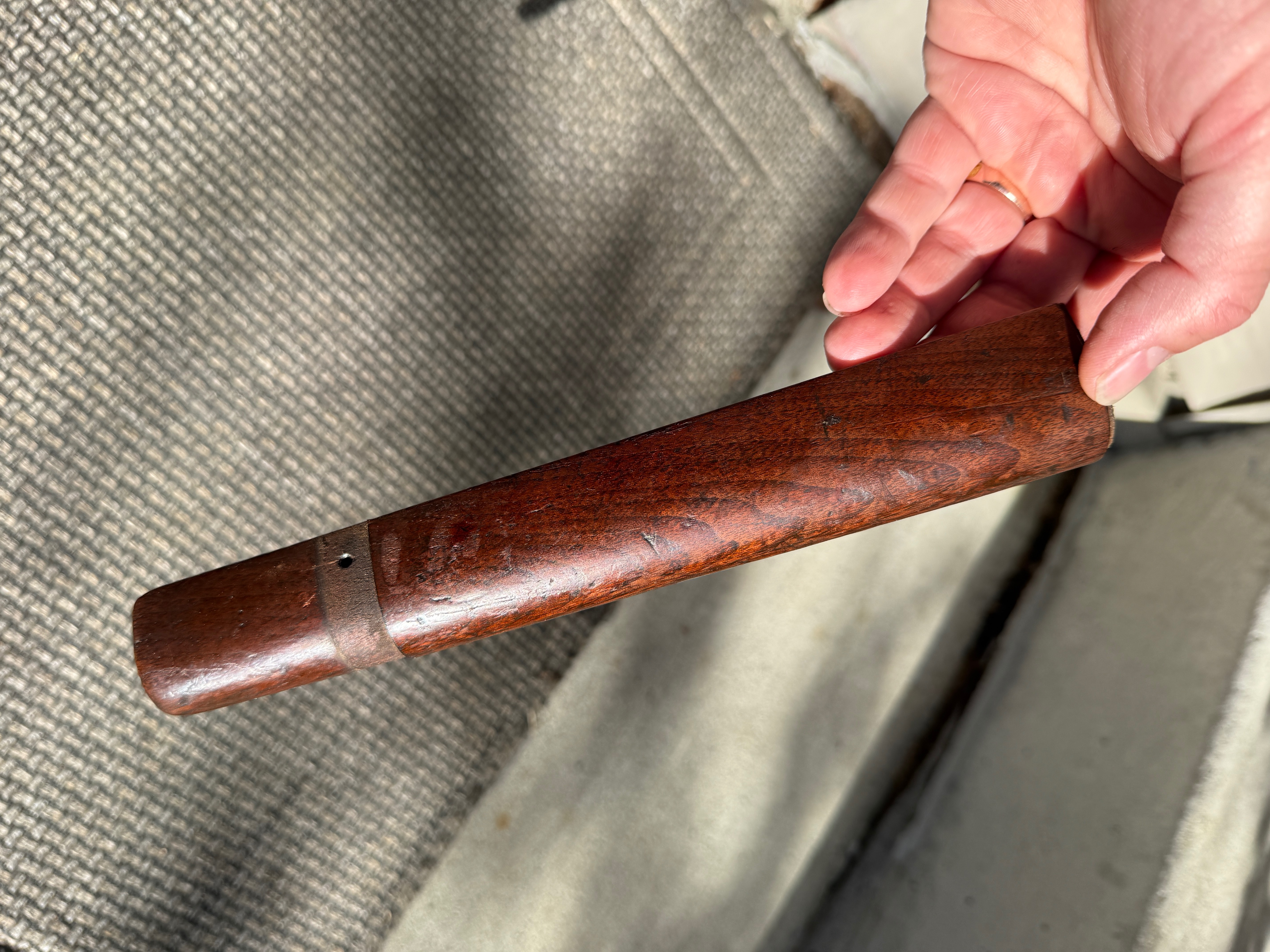

As far as I know the stocks are original. The stock took a bit more work to get clean, I used a 0000 equivalent pad and alcohol to clean both but the stock needed a bit more elbow grease and more work to get clean. I’ll hit the forearm a bit more and see if I can get the color closer, or start searching here for stains that are close to the original Winchester red.
Forum Posts: 2493
May 17, 2025 - 10:54 pm
I think the stock looks great as it is unless you want to wipe on some boiled linseed oil and rub it off, etc. for protection and to slow moisture absorption. The color, now that it shows through, is dead right for an antique Winchester of that vintage.
The forearm color maybe looks darker because of what’s still on top of it but once you get that off, hopefully without biting too far into the stain layer, perhaps a little colored oil rather than trying to hit the exact shade of stain…I’d be very slow to add stain, myself.
Judging from the grain, it may be some of the color difference between stock and forearm is the difference between the natural darker color of heartwood and lighter color of sapwoood, now showing through the deteriorated stain Winchester used to homogenize wood color..
Just my opinion.  The gun is really looking good, at this point.

May 18, 2025 - 11:59 pm
I think you should change you’re moniker to, “Not Scared”! LOL!
Looking great as you’re pictures and intentions are sure proving the plan that you talked about.
Now is the most important time when you start to make progress, and you don’t take it too far trying to make it look new! IMO!

So it really it seems like Poppy really just brushed this thing with a ton of shellac in order to protect it? The more of it I wiped off the deeper it went, around the metal and the joints and under the stock line and into the internals. As the Shellac came off it became more and more clear that the nice even brown coating was less patina and more oxidized old shellac over very fine grained light brown rust and the original blueing, so I made the decision to break the gun down most of the rest of the way to get the rest of the shellac off and clean out the rest of the dirt and grit and rust.
I’ve been very lucky so far that really none of the screws or pins on this gun have fought me much. The lifter spring screws are in very firmly so I haven’t really tried to back them out yet (and may not, with everything else out I can get around them to flush out what’s underneath). I also haven’t attempted to remove the hammer pin or mainspring screw, and again may or may not depending on the resistance I get.
I will not be re-blueing, but I will be boiling, carding, and oiling. I will not be re-staining the wood, just fixing the stock crack and tung oiling it.
I fully understand that many of you will have the opinion that all I have managed to do is ruin this gun’s value. From a pure collector’s I guess I can see that, but for me and my family it’s more important that the gun gets cared for and put back in to shape.

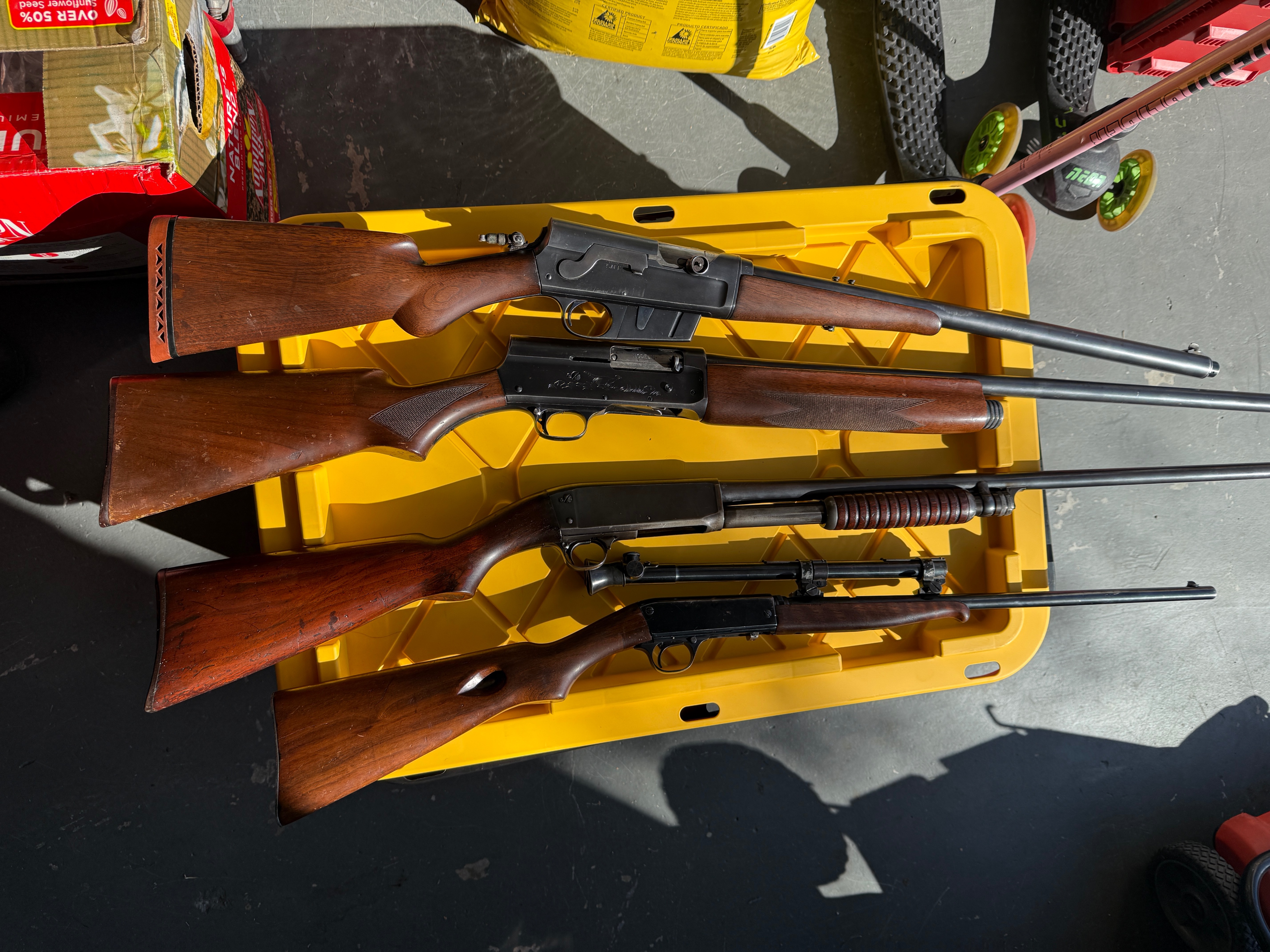

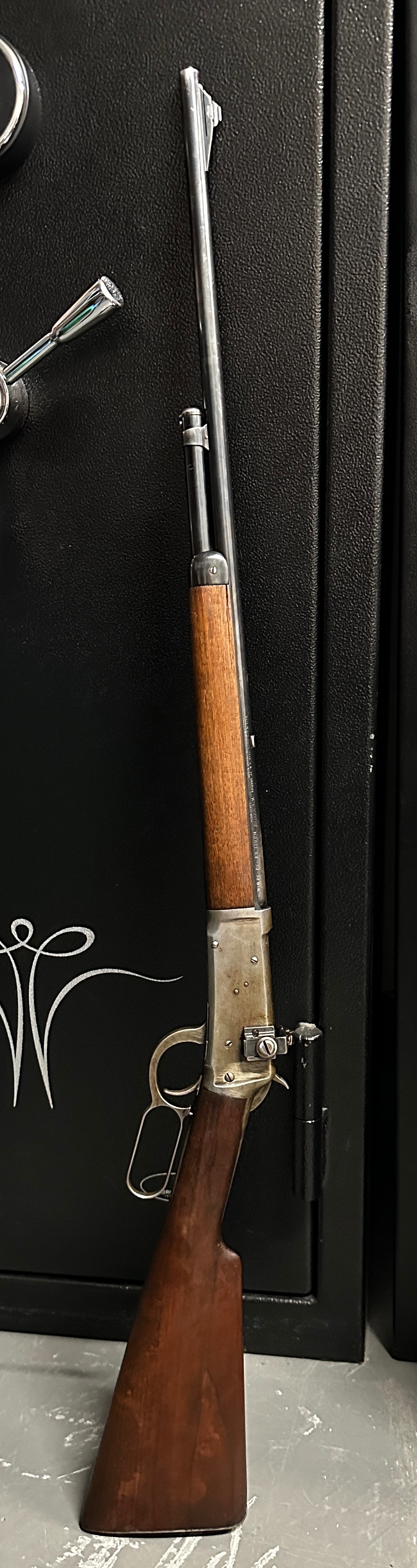

I also have a couple other early 1900’s firearms to compare to, mostly Remingtons (bonus points if you know what they are and why they go together!) and a 1894 with a 64 front end hobgoblin from 1900 or so.
