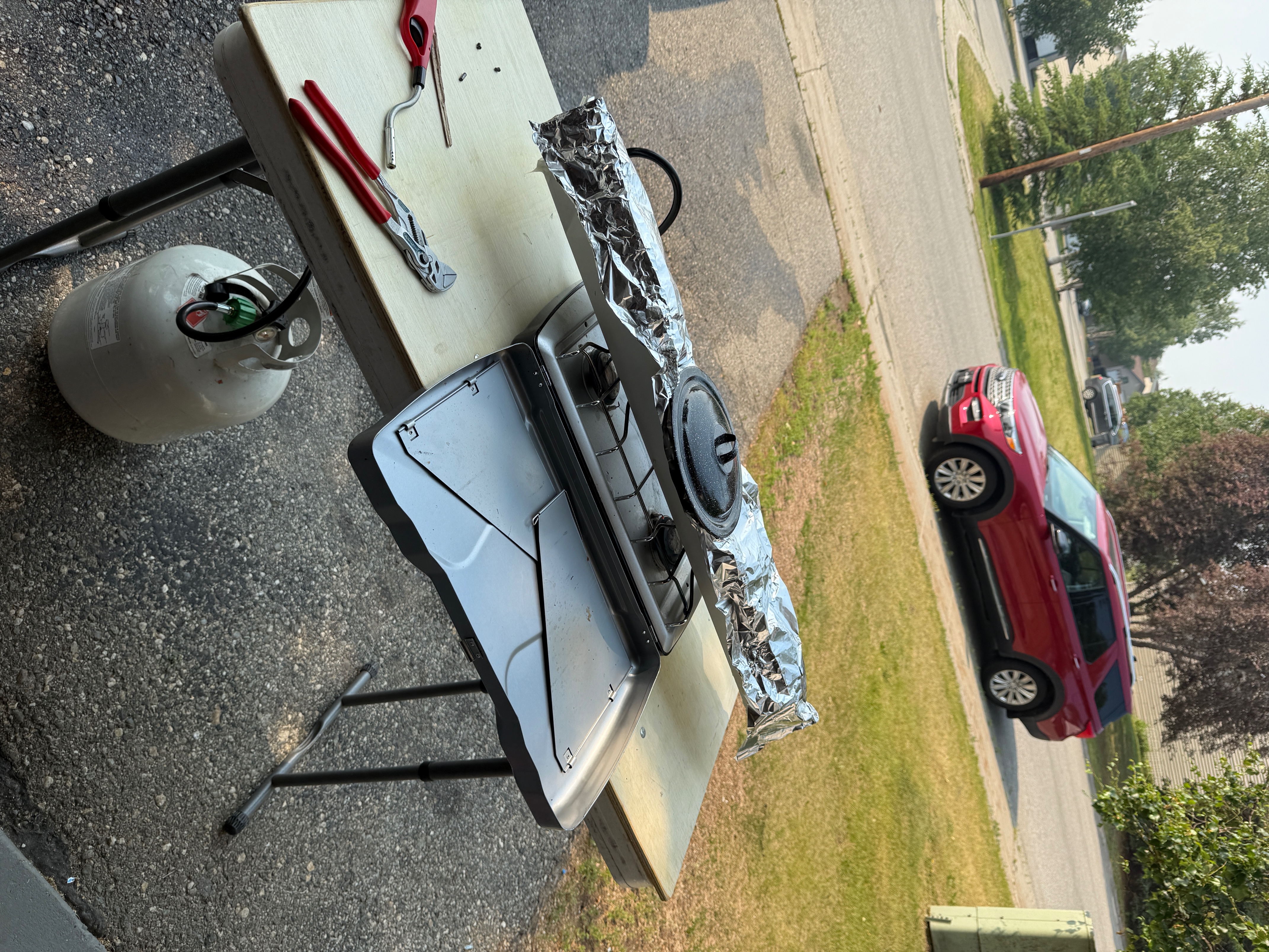

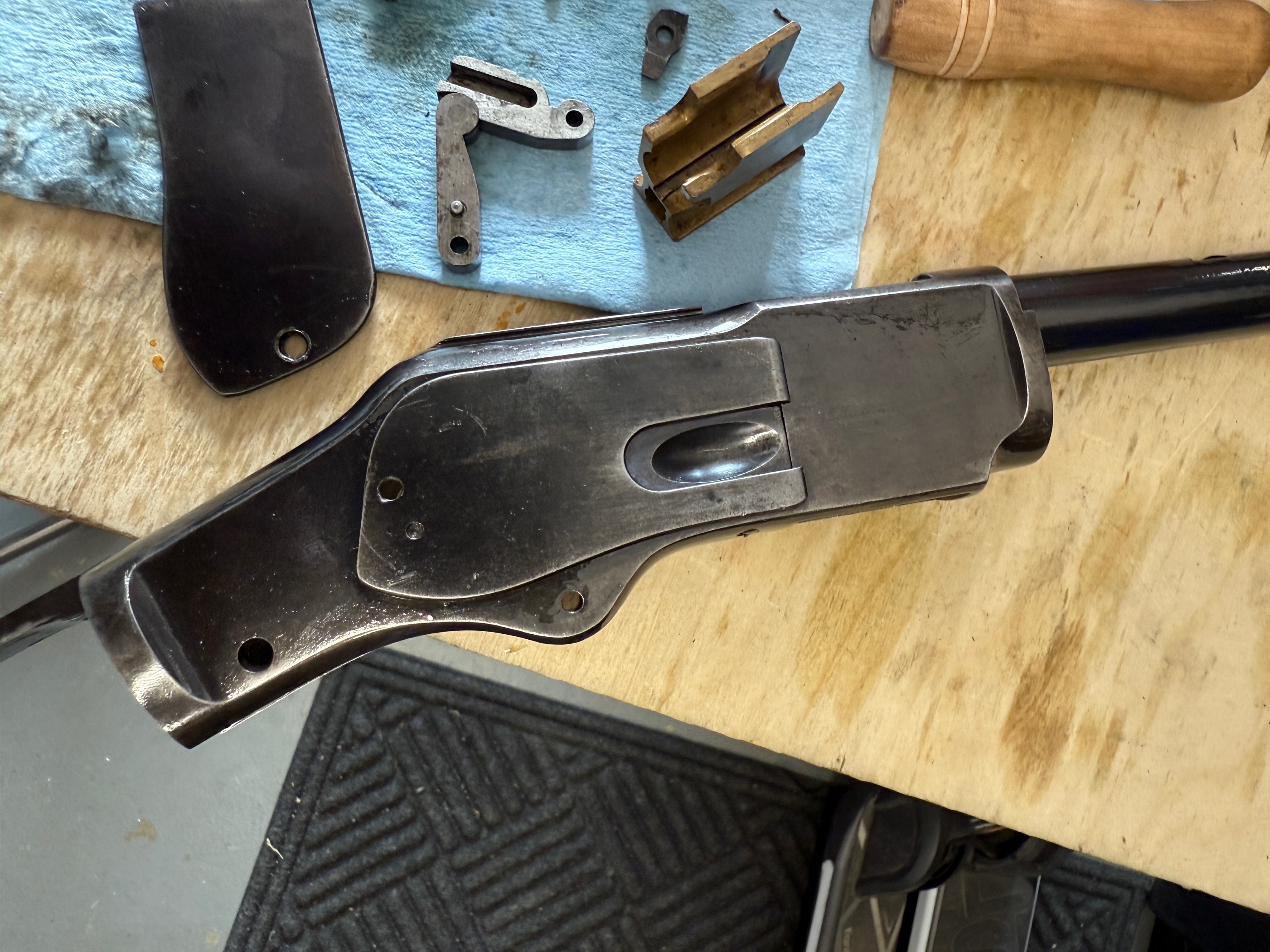

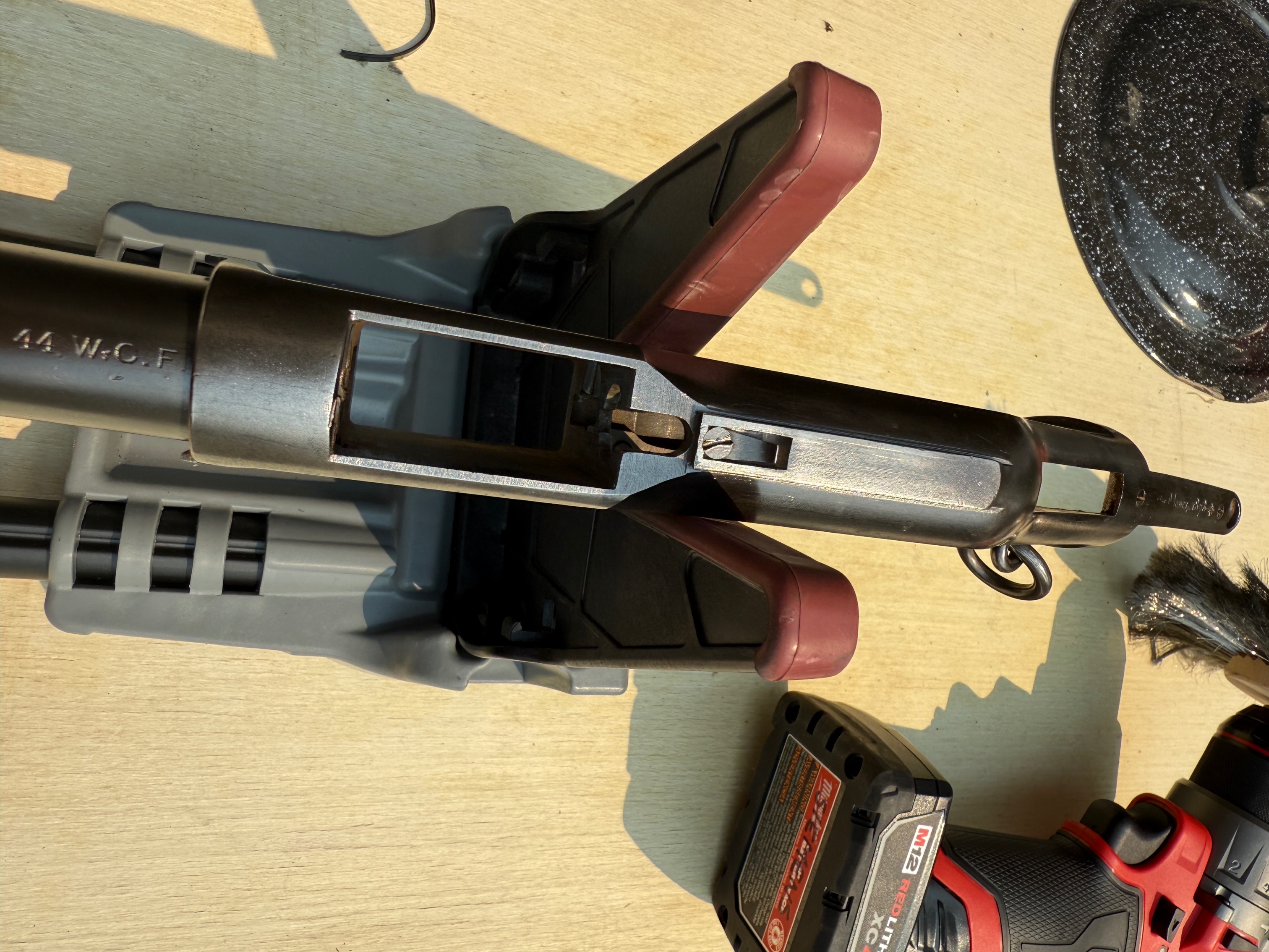

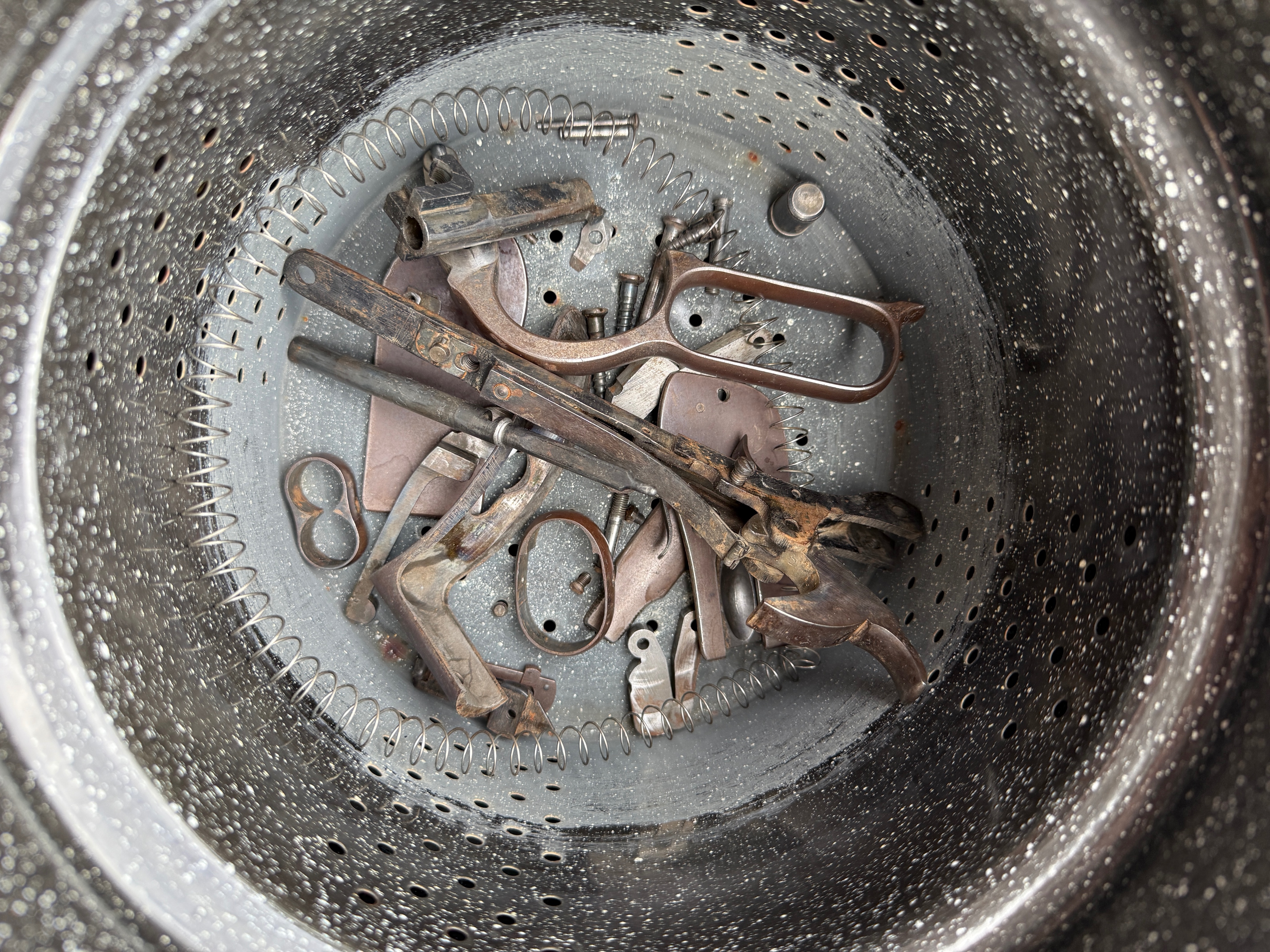

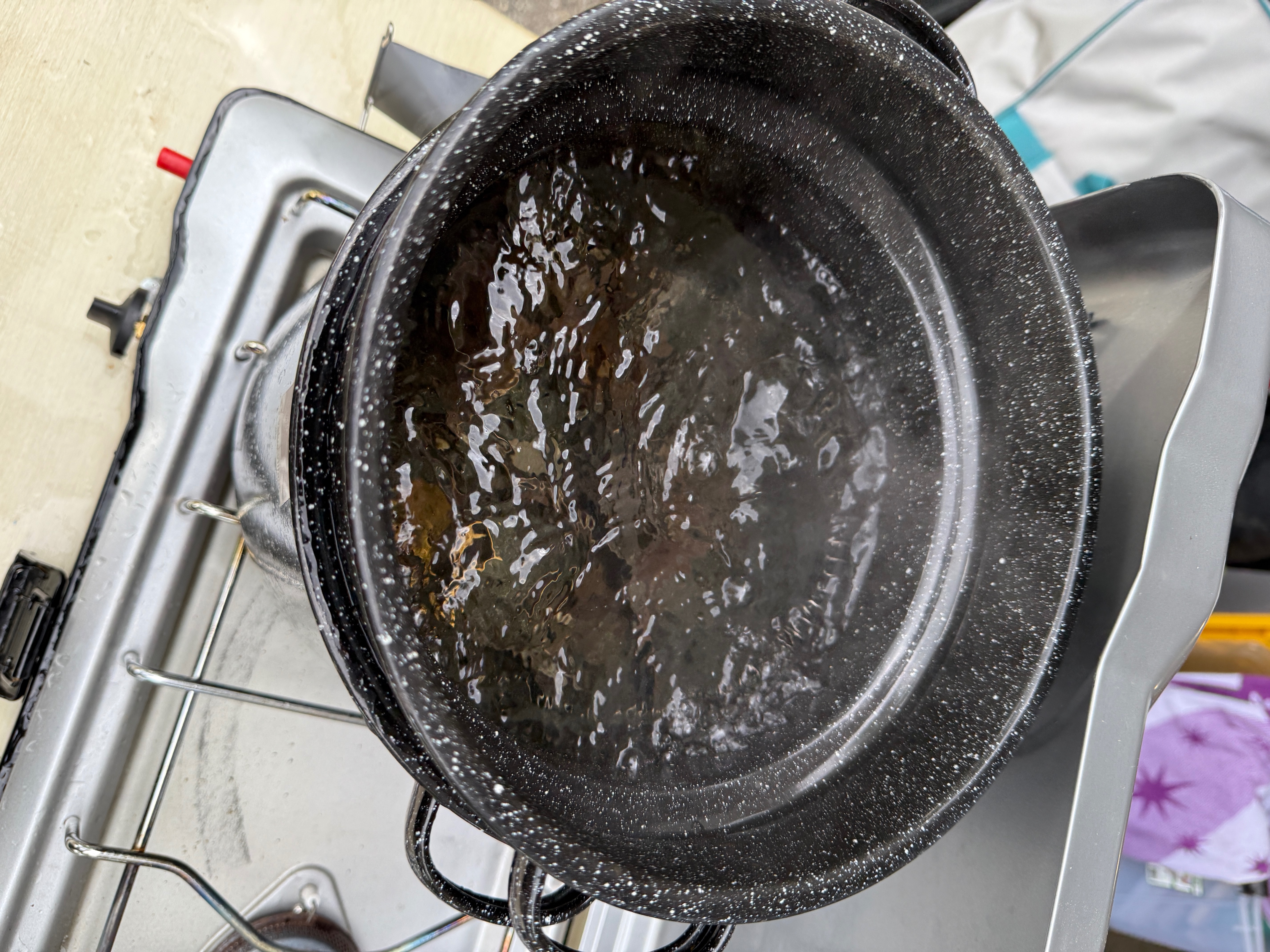

What better way to spend the Fourth of July then refinishing a piece of Americana. Found a double boiler pot at value Village and cut up a Piece of gutter to boil my parts using distilled water.
The small stuff got one round, the barrel bands, tang, lever, hammer, trigger, magazine, and receiver+barrel are on their second round. It’s amazing what you could find under all that grime…

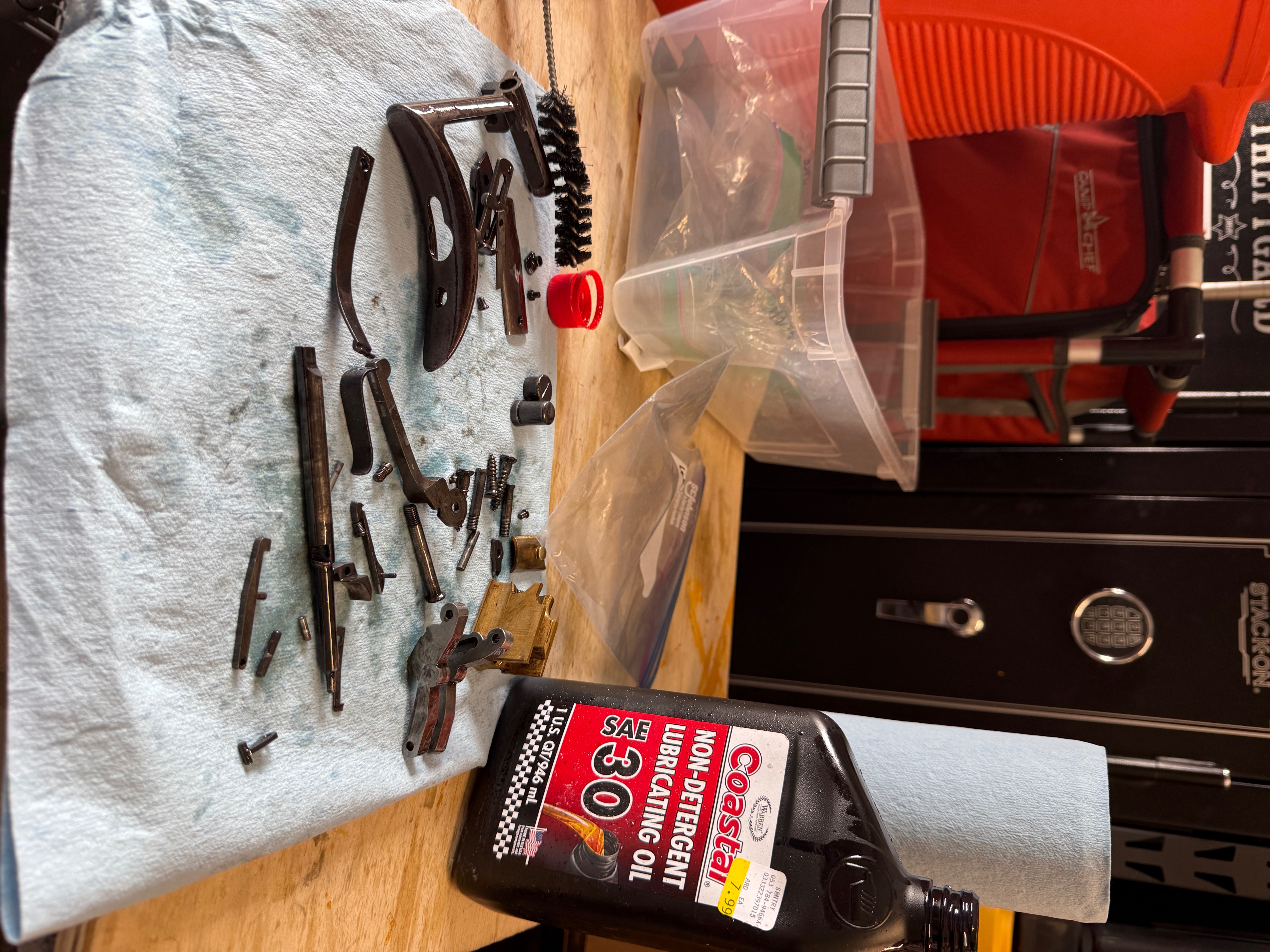

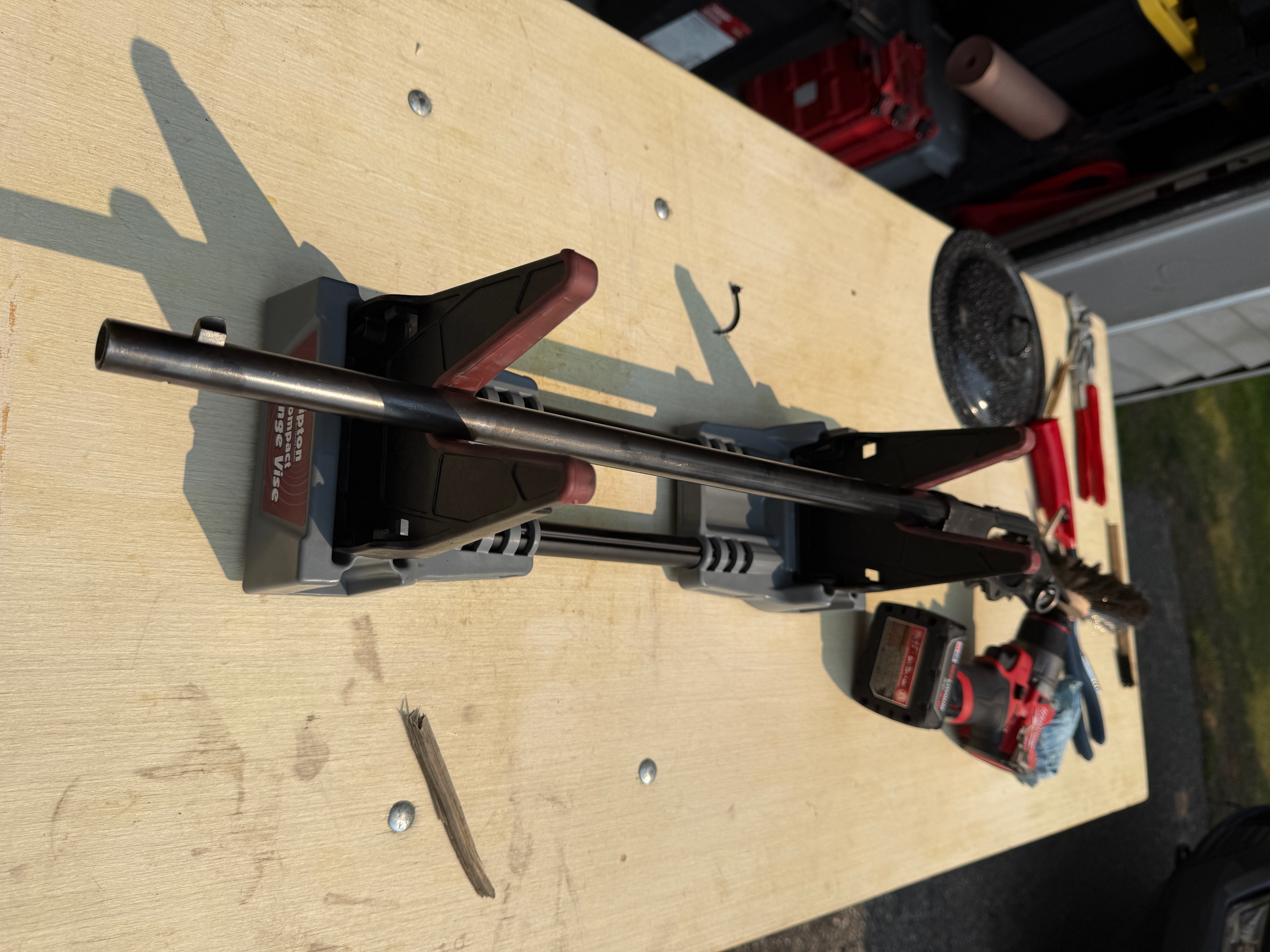

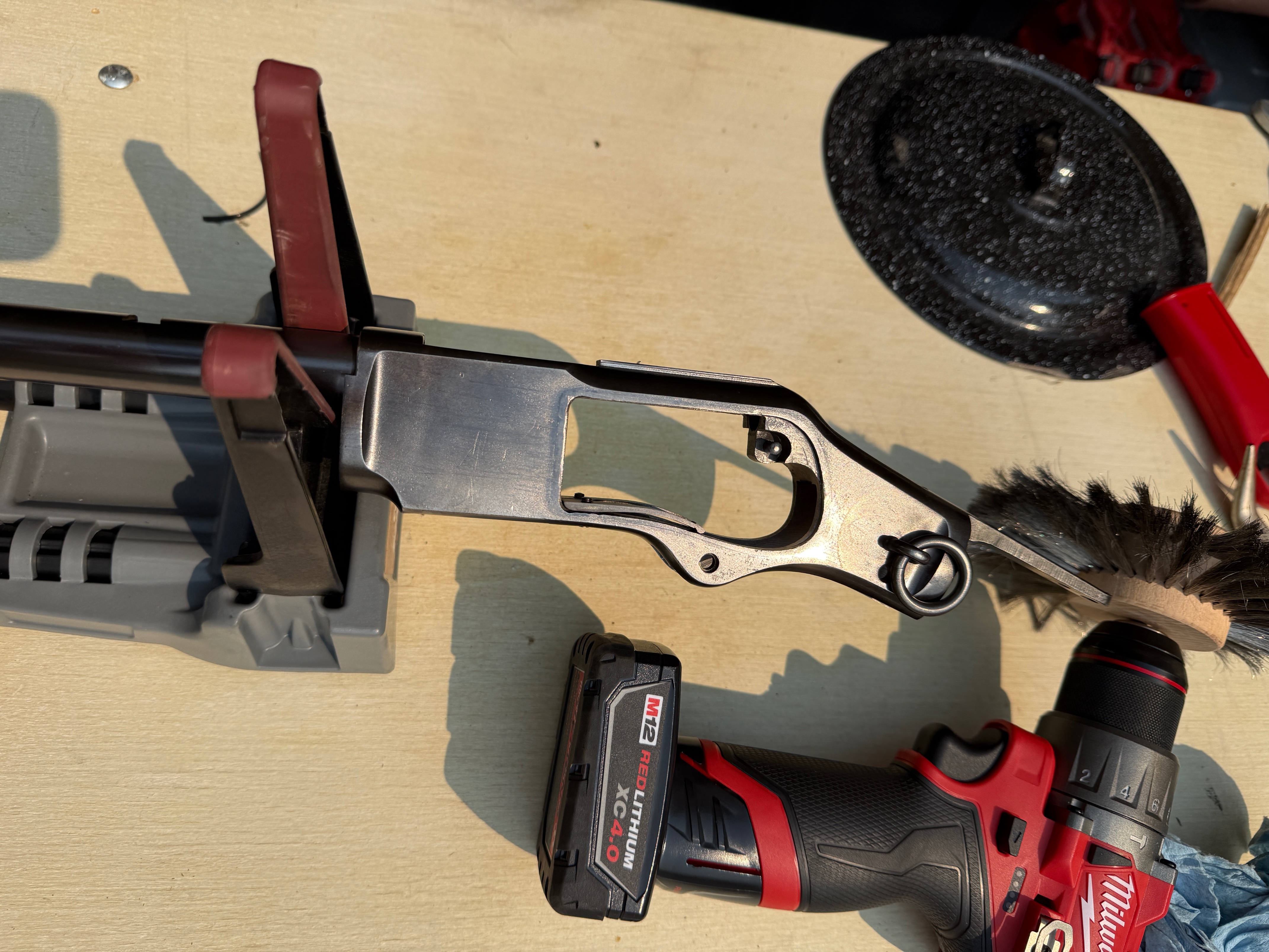

Progress. All of the metal has been boiled, carded, and oiled.

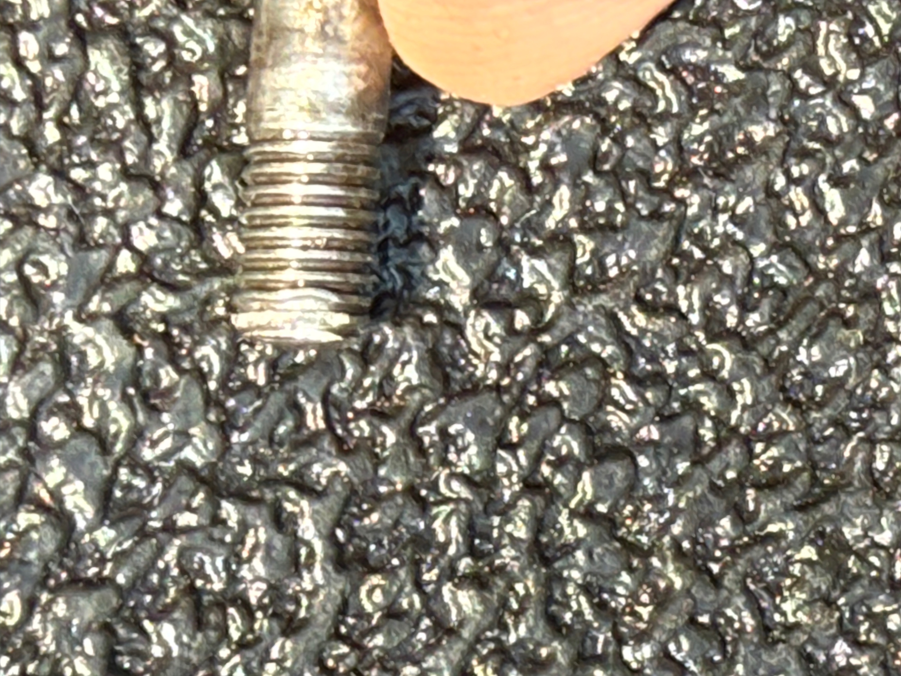

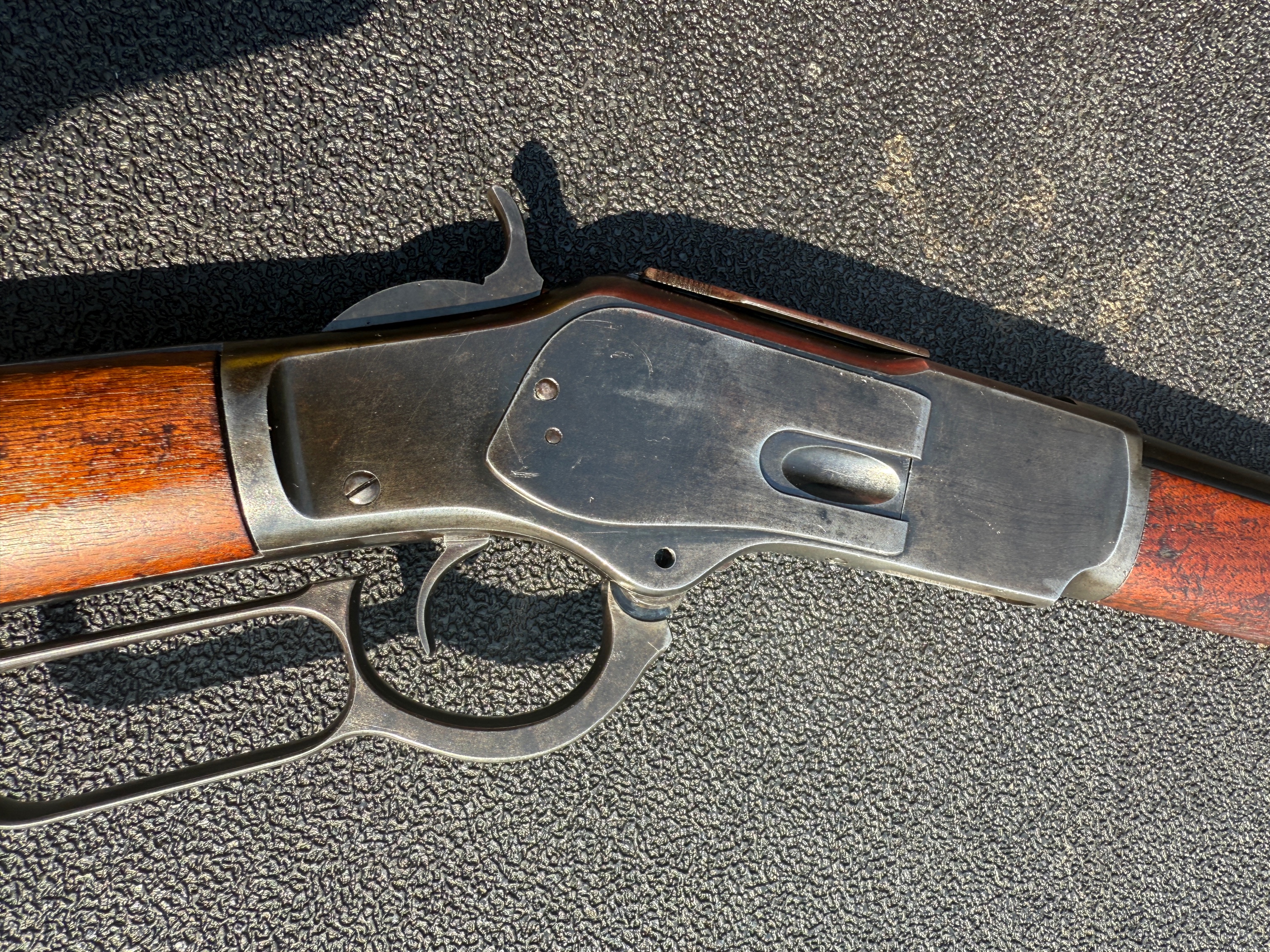

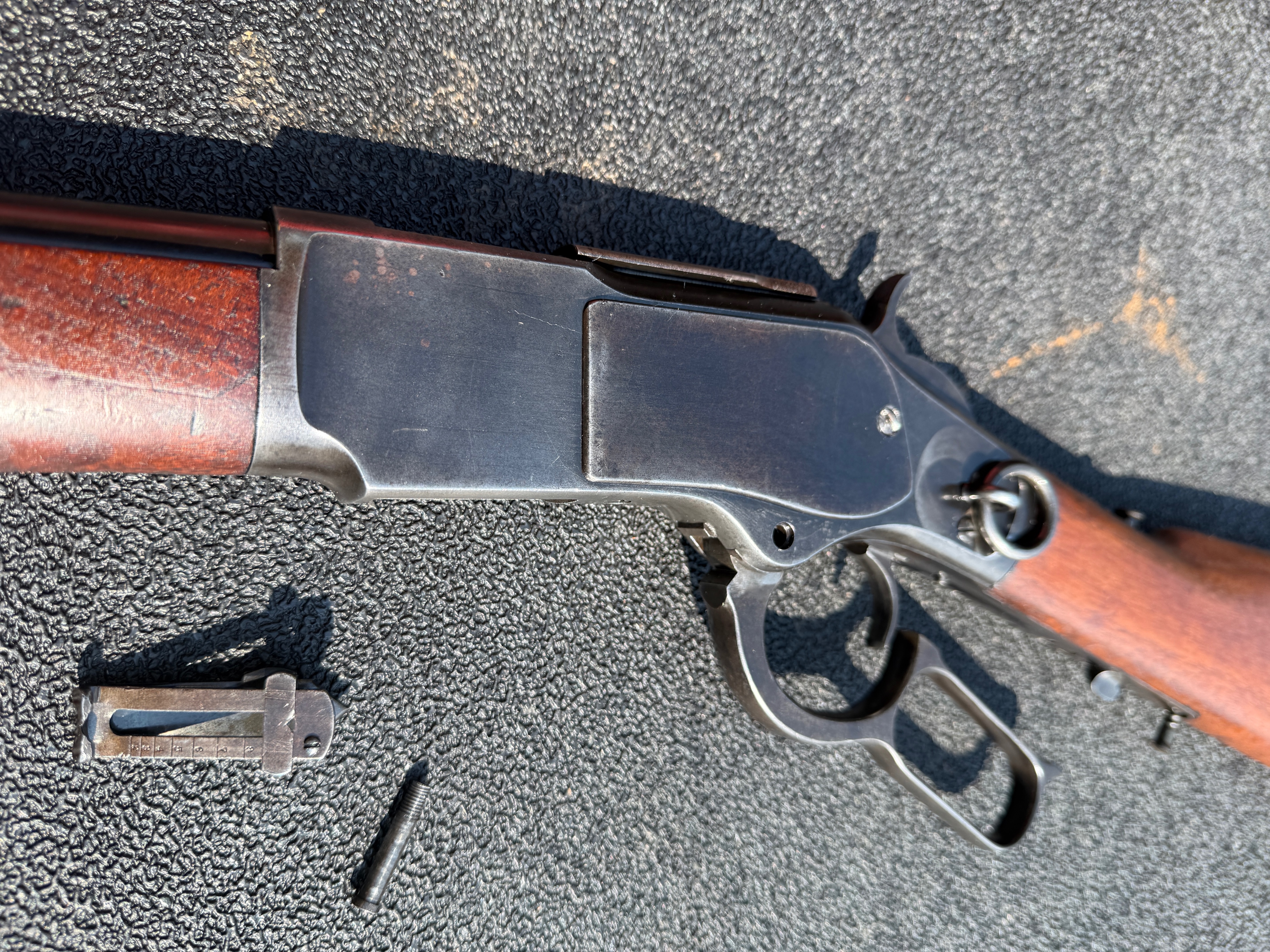

Made it all the way to the end, and finally buggered something up. The lower tang screw got its threads mushed trying to find its way through the lever and carrier lifter. I’ll try to figure out a way to repair the threads but worst caseIMG_0824.jpeg
I’ll try to figure out a way to repair the threads but worst case I’ll source a replacement.
The rear sight is bent, like it was dropped with the ladder deployed and bent itself at a 45 degree angle to the lower part of the sight. Might try to replace the ladder, might just get a dovetail blank and a tang sight.
I hate to be guy to “piss on your fire”, but I have noticed that you installed both of the barrel bands backwards (the screw is supposed to enter the band from the left-hand side when looking downrange).
skierd
Forum Posts: 17
May 13, 2025
52
July 5, 2025 - 2:08 am
Bert, thanks for catching that! No apologies necessary, I appreciate it actually and will switch those bands around when I can.

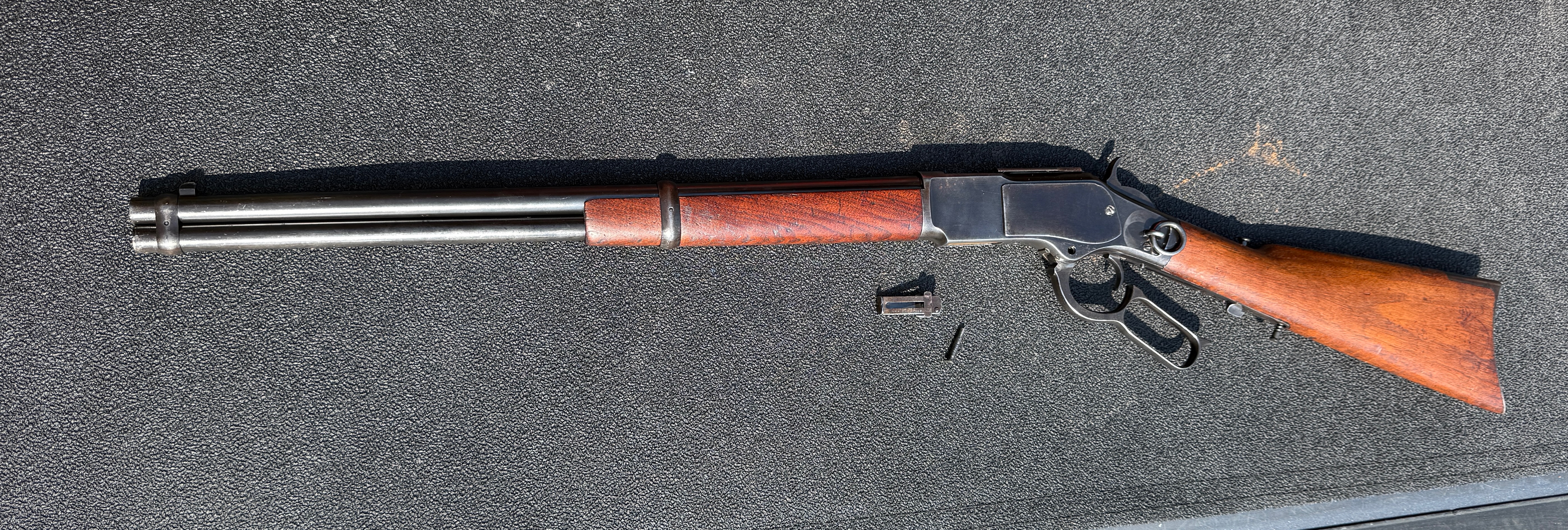

I replaced the rear sight with a skinner peep sight. I picked up a screw set from Homestead Gun parts and was able to get the lever spring screws and tang screws replaced. I cleaned up a couple other screw heads too.
I built some dummy 44WCF rounds to test feeding, and everything seemed to be good to go. So I decided to go for it and load it up 10 live rounds.  Starline brass, WLP, Missouri bullet company 210gr black powder bullets, and 2.2cc (36-ish grains) of 3F Swiss.
Average velocity for the 10 rounds was 1200fps and I was able to ring an 8” steel plate consistently at 25 yards. Considering this rifle probably hasn’t been shot in 50+ years, and I have never sighted it in, and I replaced the rear site, I’m extremely happy. Exactly

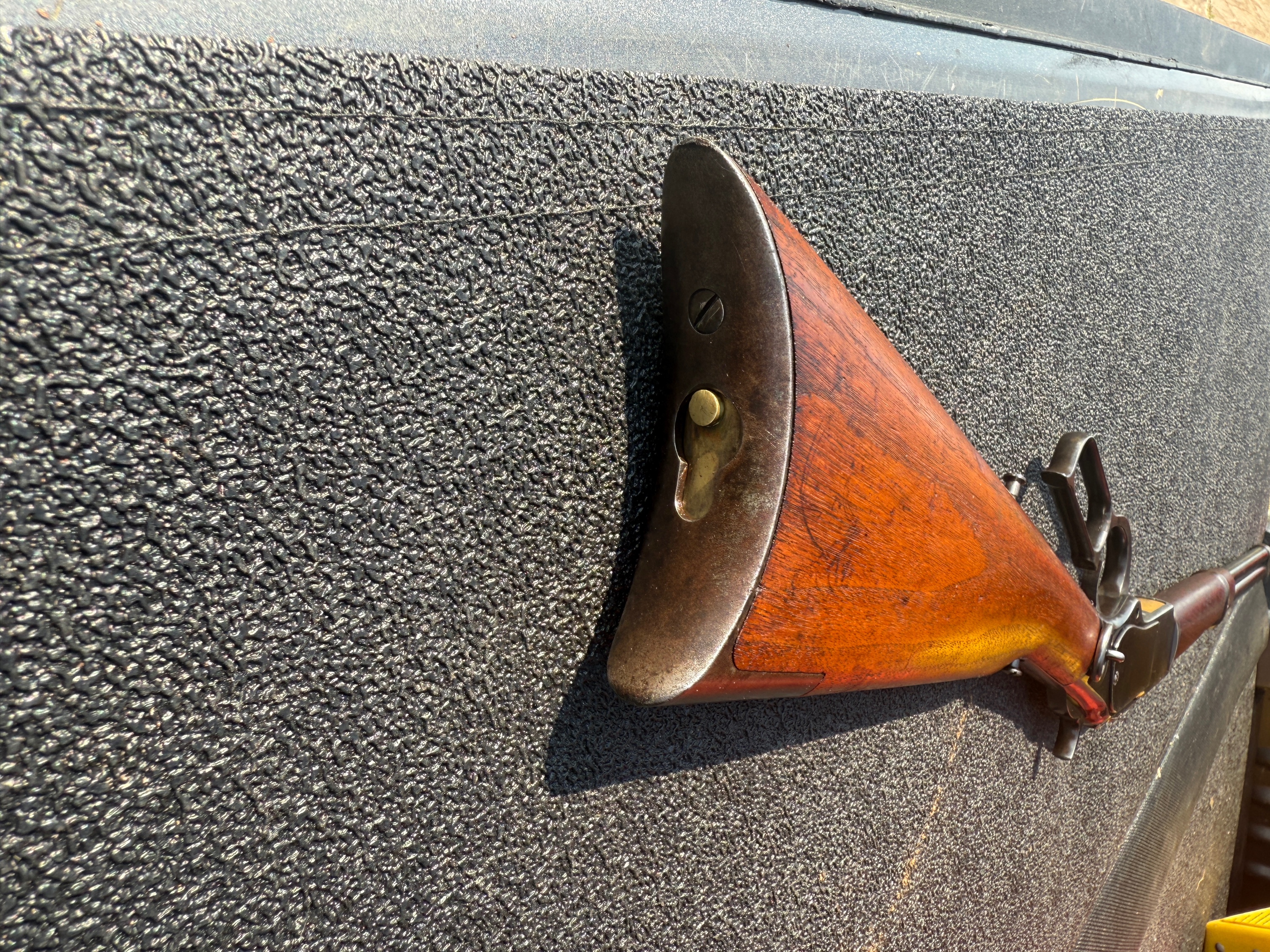

One more suggestion I would make is get a letter from the Cody Museum.  I think it would be interesting to have given how long the carbine has been in the family.  But my main interest would be to verify the buttstock.  This is a SRC and should have a carbine butt.  The rifle butt on a SRC would be special order.  Which did happen – I have a ’73 SRC with a rifle butt myself (that letters).

Actually, yes, I did order a letter from the Cody museum! This rifles produced in 1900 and was sold as it is configured.

I’m thinking that you’re latest picture of the gap in the wood vs. the earlier picture was because of the butt stock not being tightly secured in place revealing that gap at the receiver. Possibly a rushed picture do to daily responsibilities and time limitations. That’s how screws get buggered up. Assembly oil, (gun grease), while putting it back together, is a must for me, while doing this. IMHO!
I’m wondering what the letter looks like and a picture of it would be great to see, even if you want to block the letter head with you’re address out as most here do. Showing that crescent rifle butt, with the trapdoor, is something we don’t see a lot of, as Steve mentioned. I’m wondering how many actually left the factory like yours did, and in the third model vs. the first and second models. Maybe Bob can weigh in and let us know his thoughts or what the updated survey indicates.
