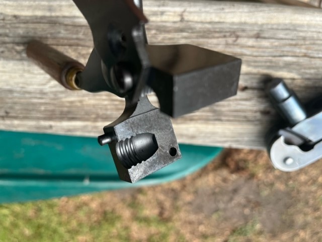

  On your mold the marking looks correct, it is a fifth model mold. Does it have a hollow point hole on the other side?
  Your reloading tool is a Model 1880-1st issue. Does it have any markings on it?

No hollow point , solid head . Markings on reloading tool reads patent dated and Winchester Express .  Markings on mold look like two different 5’s ? And Express on the tong tool is uneven  crude compared to Winchester marking .

  I would need better pictures including the mold cavity and  markings on both tools to tell. T/R

Now that I see the photos, that is the mold you bought from me several years ago.  I’ve always regreted selling it, so if you want your money back just say the word.  I would be glad to buy it back.

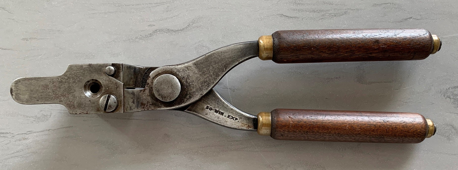

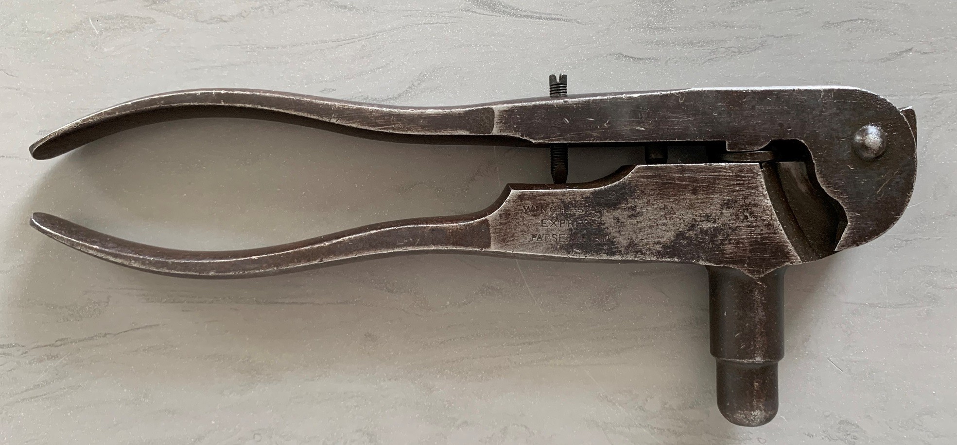

Dusty,
These are the Express tools I have.  The mold is the 1889 variation with the wood handles.  Markings for caliber say: 50 WIN. EXP.  It is a hollow point mold.  I didn’t include the plug in the photo.
The reloading tool is the second variation of the 1880 pliers tool.  It is marked: WINCHESTER EXPRESS and the patent date is on the bottom line.
Both these have the standard Winchester patent and company markings as well.

 The Winchester Express changed it’s name over time because of new models using the name express. The fifth model mold was the last style sold and was eventually marked 50-95. The dimensions of the cartridge and bullet was changed over time. According to Daniel Shuey’s book “W.R.A. Co. Headstamped Cartridges And Their Variations” page 336 C.I.M. #851 changes bullet diameter from .5125-.513 to .5055-.506 dated 6/20/1911. This same CIM authorizes use of 50-95 Ex bullets in 50-110 Ex. CIM 202 in 6/17/08 changes head diameter from .603 to .628. CIM 850 changes length of shell. CIM 851 changes bullet profile.
  Long and short of what I’m saying is the dimensions changed, so did markings and do we even know who made the tools at that time.T/R

Sorry for the delayed response, been busy with the kids doing Halloween and deer hunting. I’ll start with prefacing that in general I have yet to find anyone Faking Winchester Reloading Tools. That is a highly prefaced “YET”. Only seen one or two molds stamped Winchester that were obvious fakes / fabrications that no one with any knowledge would believer they weren’t fake. That said, I’m sure some day someone will start faking these, just like they do everything else.
The 1880 Tool 1st Model Spoon Handle tool looks great near perfect nothing out of the ordinary with it. The markings are great. I’ve determined that through careful observation that the patent date, the word Winchester and the word Express were all stamped separately on these tools. As I’ve seen a couple stamped in error with the word Express above the word Winchester. So them being slightly misaligned or being swallow or deeper to be expected.
The mold is an interesting one and a little bit of a head scratcher. That said I believe it is all original and factory made as such. I’ve looked and will keep looking through my files but it may be the first one I’ve come across marked “50 95”. That doesn’t necessarily mean anything particular though, as all of these 50 caliber tools and mold are in high demand, hard to come by and considered somewhat rare.
It being merely marked 50 95 makes sense to me due to it only being able to cast the solid head bullet. Had it also had the word(s) Express and/or Winchester Express, that to me would be odd as it wouldn’t make an Express bullet with the hollow head. All of the Winchester Express molds I’ve come across will have a hollowed base for the hollow point pin. Of which they sold / provided both a hollow point and a solid point attachments for these molds.
The reason this mold marked 50 95 is that is simply cast the sold head. Winchester also sold boxed solid head bullets, but they also sold the copper express cups that went on the ends of the bullets. Which I have yet to ever come across, but they’re are other such items that I have the same problem with finding.
3.jpg Your 5th Model Mold is a nice piece, a dandy to have in any collection in my opinion.
The only other thought I have towards the set, is that likely someone paired them up. As the spoon hand tool was made 1879-1883 and the 5th Model Mold 1889-End of Production.
P.S. If you guys ever come across anything you suspect is Faked, let me know as I would find it most interesting.

Thanks Bill Hockett for the pictures . The straight line evenness of the stampings  on your mold is what I would expect to see from a factory stamping  .
