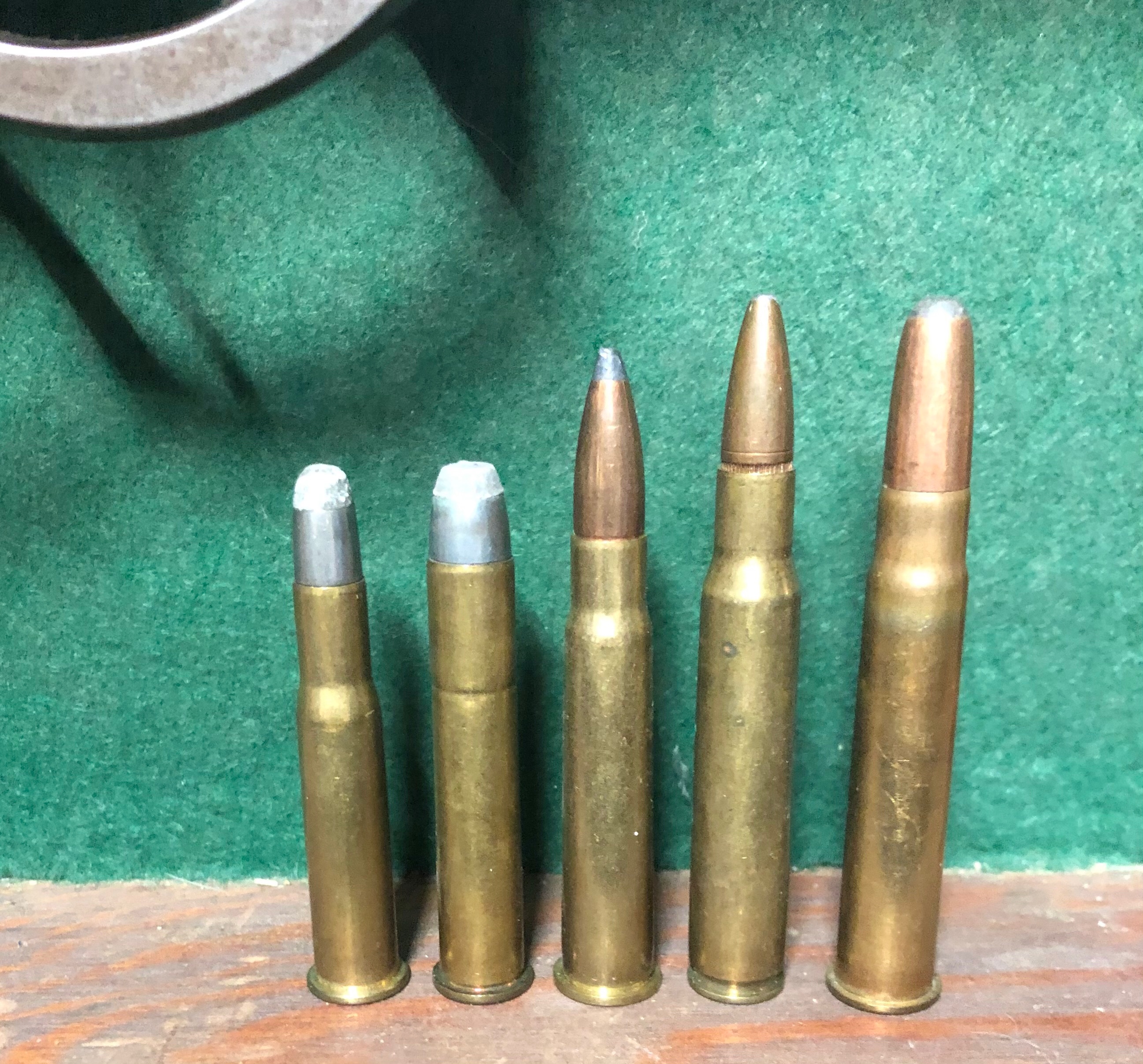

The 35 WCF is one of only 3 cartridges I have shot that actually hurts if you are doing load testing at the range and shooting a lot of ammo.  When hunting, hopefully 1 or 2 shots is all you need.  My 35 has a shotgun butt.  If anyone thinks these help they haven’t shot many rounds of this caliber.
I took a quick photo a few mins ago after scrounging thru the single round drawer for those who’ve never seen a 35 WCF cartridge. From left to right, 30-30, 38-55, 303 British, 30-06, and 35 WCF.

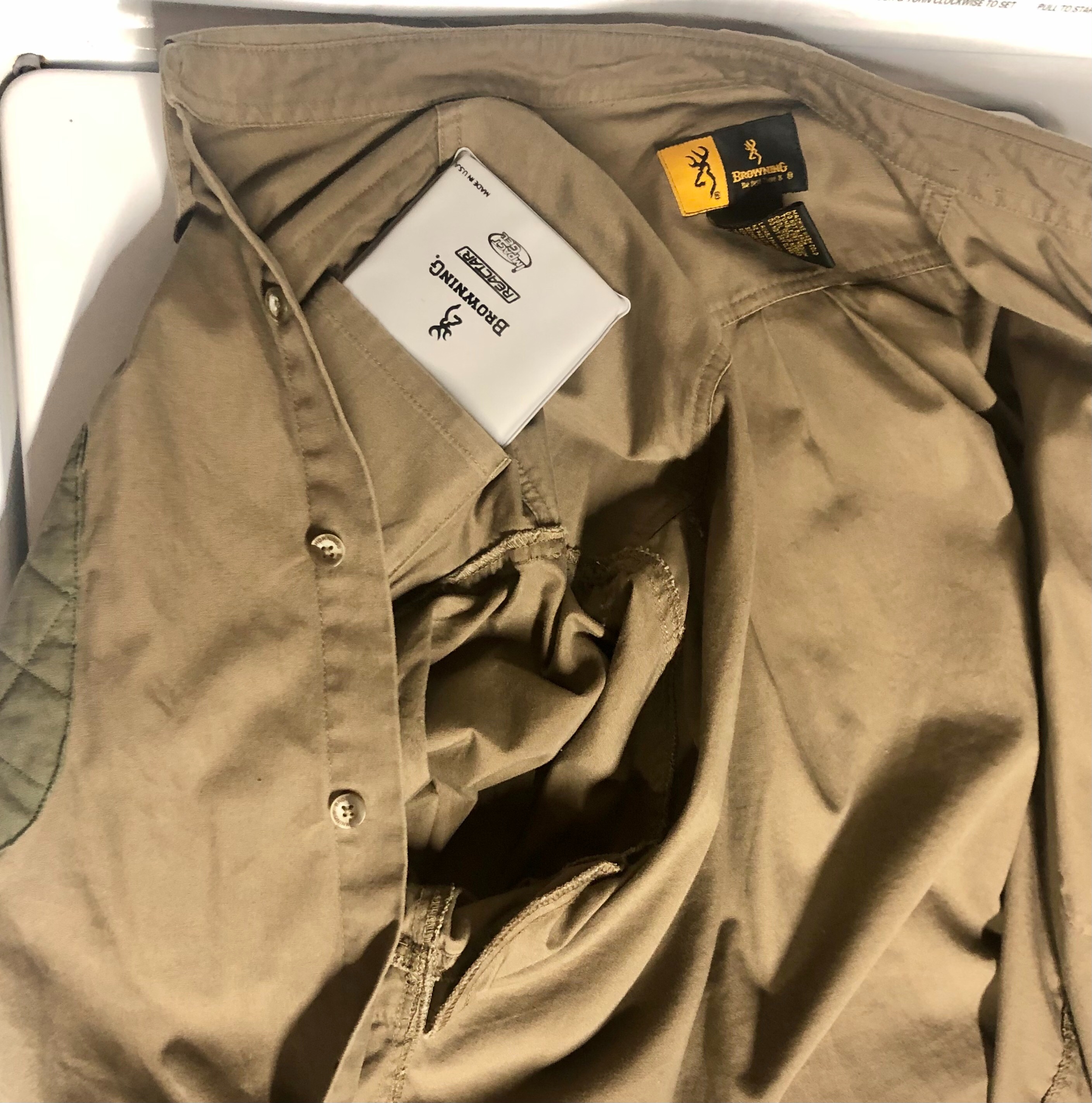

Here’s the shooting shirt with gel pad I use at the range for the big medicine rounds. It definitely helps. Technology applied. They didn’t use anything back in the day or if they did it was a rolled up newspaper.

I have a Pact pad I put on when I shoot the 35 or the 45-70’s at the range.  Try shooting 20 to 40 rounds of either.  I have limited brass and need to fire them to test a different load.  I guess I could knock out the bullets?

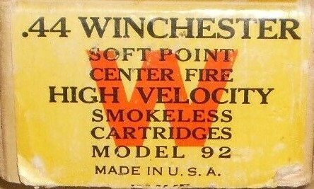

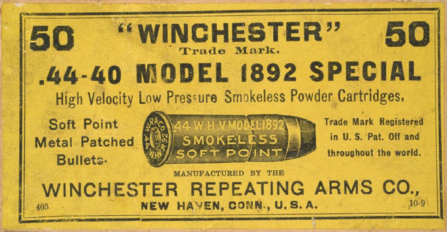

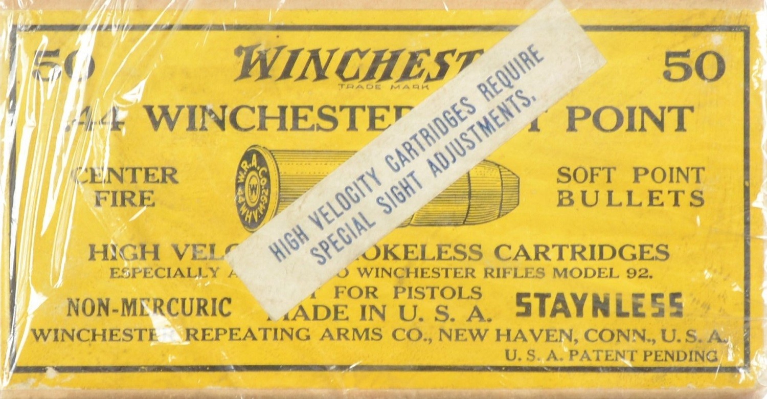

Maybe he used these instead of today’s mousefarts
1,550fps at the muzzle is 1,000ft lbs of energy with a 200gr JSP.
How much “energy” does it take to kill anything?

It has been reported that it only takes 750fps for a 200gr 44-40 bullet to “fully penitrate the broadside of a horse”. If you are hunting for food, that it is plenty of velocity and mass. If you are hunting for sport, you probably should not be hunting. Then there is always the bow and arrow!
Does this answer the black bear question…
44 Magnum revolver
240jsp @ 1,450fps = 1,120ft lbs of energy
44-40 M92 carbine
200jsp @ 1,550fps = 1,066ft lbs of energy (1903 to 1945 W.H.V. strong action rifles only)
200jsp @ 1,350fps = 809 lbs of energy (Original Ballistics)
200jsp @ 1,190fps = 628 ft lbs of energy (current 44-40 factory ammo, velocity reduction after 1979 when Winchester switched from a rifle powder to a pistol powder) (My tests recorded only 1,050fps @ 489 ft lbs of energy)

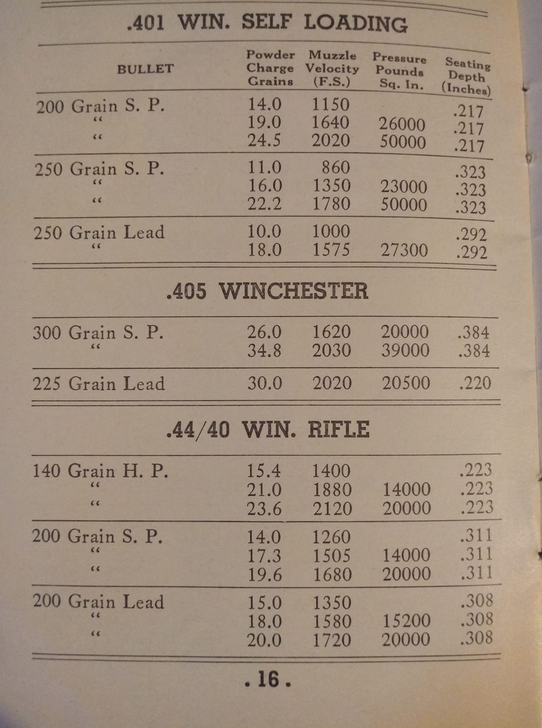

If the grandfather handloaded with data from back in the day (1937)…..then it gets even better.
20gr of Sharpshooter with a 200 lead, 1,720fps @ 1,313ft lbs of energy which created 20,000cup

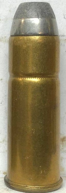

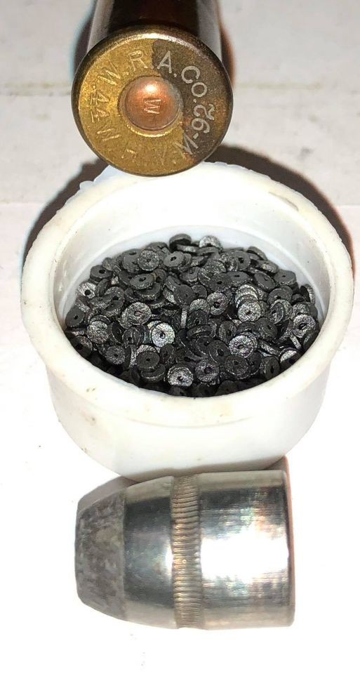

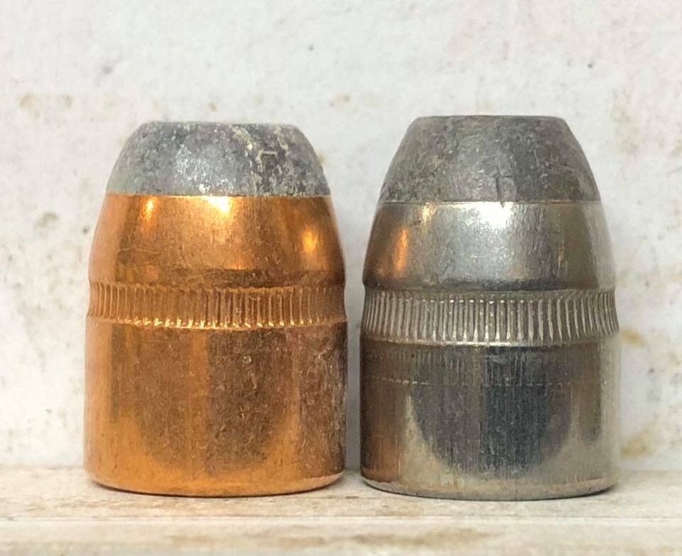

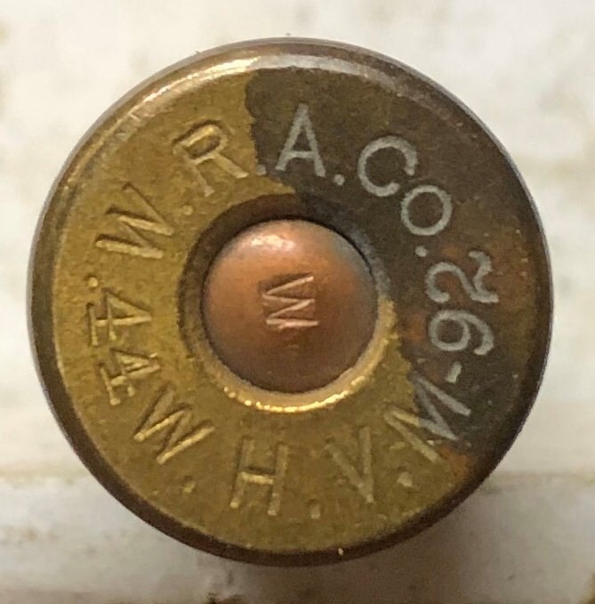

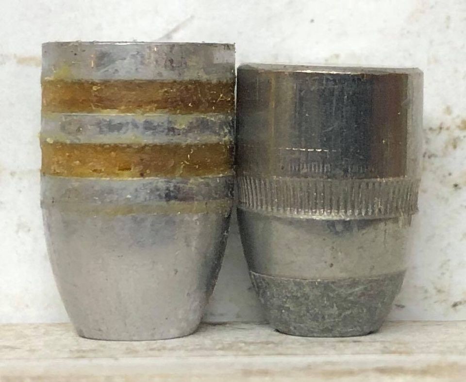

Here is a Winchester M92 44-40 High Velocity cartridge from the late 1920’s that I dissected. It contained 20.3gr of Sharpshooter powder.
19.6gr of Sharpshooter along with a 200gr jsp reported to achieve 1,680fps @ 1,253ft lbs of energy
