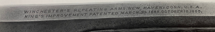

I just noticed something else that is setting off the red flag… the barrel marking is “WINCHESTER‘S“, and I have never seen that on any authentic Winchester barrel.  In all cases that I am aware, it should simply be just “WINCHESTER”.
You may need stronger glasses Bert, picture of the address on my 73 short rifle sn 51818573-short.1.JPG
Edit;
As pointed out to me by Bob, the “WINCHESTER’S” marking is standard for the Model 1873 (and I would have known that if I had taken the time to look at the barrel on my own Model 1873 rifleFrown).  Interestingly, all of the other Models (those that I actively survey) do not have the ” ‘S “, just “WINCHESTER”.
Edit;
Never noticed it until your earlier post. Saw Bob’s pics and thought I had missed something. We see “Colt’s” quite often in early writing’s, I suppose “Winchester’s” makes sense.

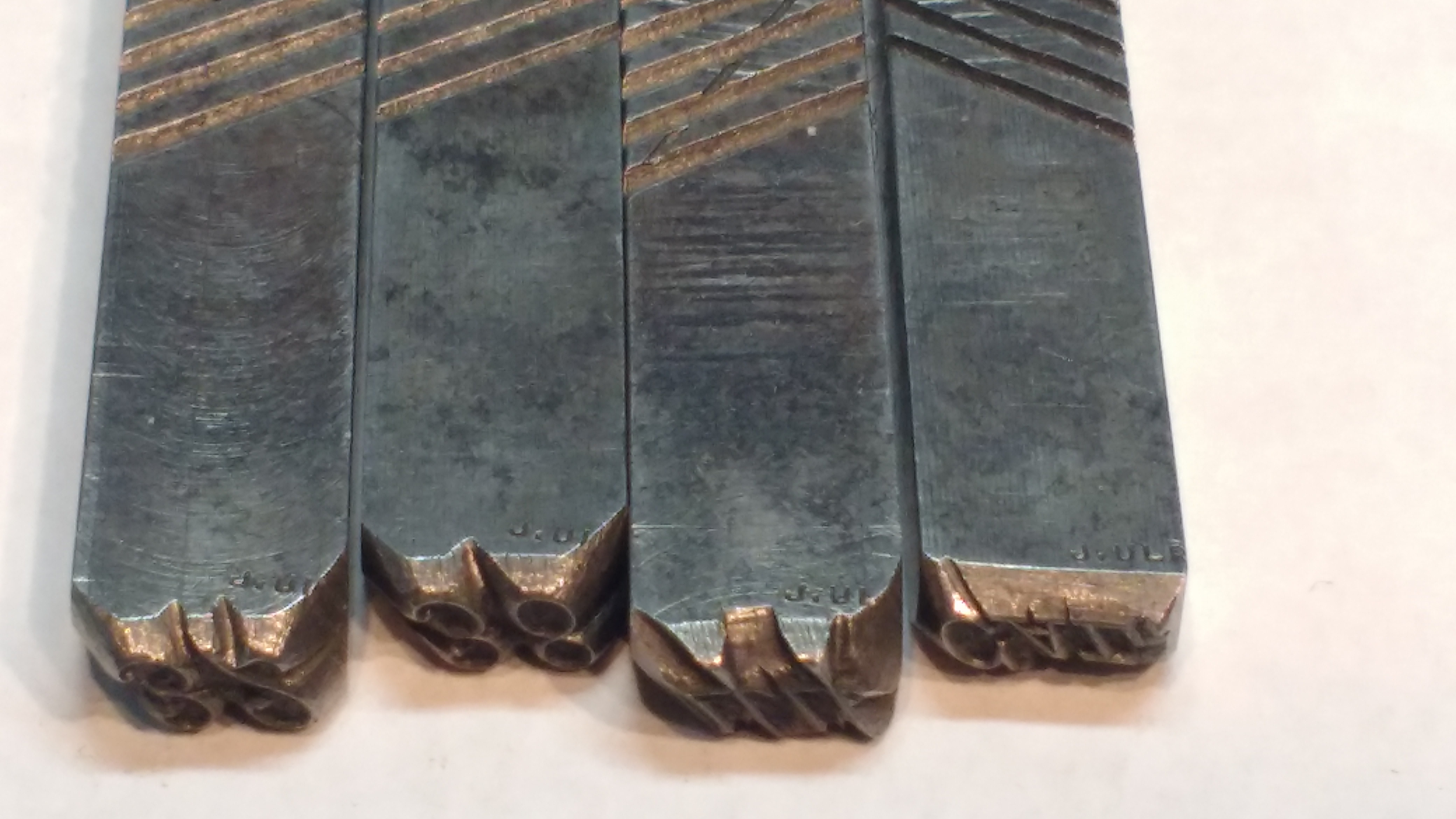

I also noticed the barrel caliber stamp is not correct. It should have a dash between 32 and Cal
Did the caliber marking ever change to “32 CAL.“?  The reason I ask, is because the early Single Shot rifles manufactured in 1885 & 1886 were marked without a dash just like the barrels on that pair of 1873 Short rifles.
I haven’t seen 32 Cal. As far as I have seen it went from 32-Cal to 32 WCF at about 200,000 but I keep a eye out for it.

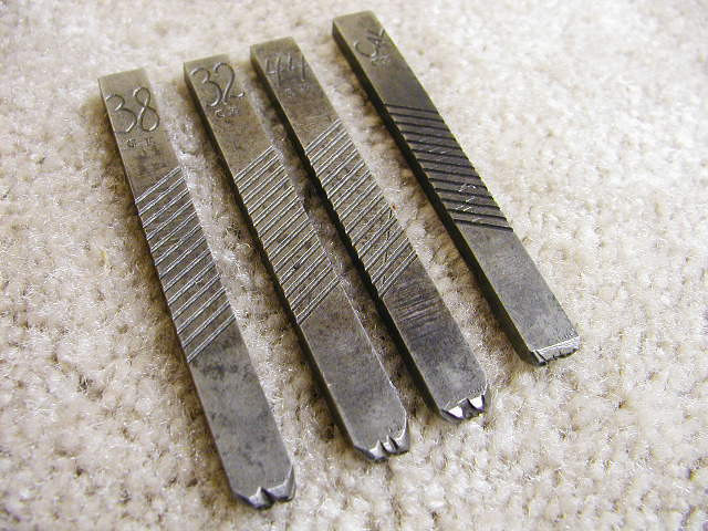

I did some digging into the barrel caliber on the 32’s and did find they started out with the dash between the 32 and Cal and somewhere between 148,429 and 173,870 they eliminated  the dash which would line up with the caliber marks on the 1885 that Bert stated. From what I see the 32 and Cal where two separate stamps since I’m seeing the distance between them vary.  They could of been stamped by the same stamps they used on the elevators which were separate dies. At 222245 I found the first WCF but I assume there will be intermixing of the stamps to some degree like I saw in the 38’s. I found 38-Cal and a 38 Cal after the 38 WCF showed up. I would think that is from old barrels left in the wood barrel crates on the bottom of the stack.
On these short rifles they have “32 Cal” but they are not correct. The Winchester “32 Cal” is in italics were as these rifles the 32 is not italicized.
Here are some of the original caliber stamps which were made by J. Ulrich
