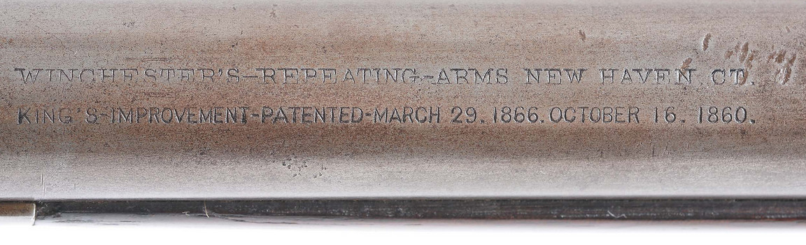

They have later barrel address’s than what they should have based on the serial numbers. A call to Cody is in order before even considering them.

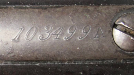

From looking at the serial numbers, it looks like they were refinished. On higher condition guns you usually see the serial number with raised edges.

I checked with Cody and they do letter the way they put in the description but the barrel address bugged me. In the back of my mind I thought they didn’t use the later barrel address on round barrels so I started looking at pictures of round barrel 73’s and confirmed that they didn’t use the later U.S.A. address on a round barrel. Here is a pictures of round barrel address serial 256959 & 458817 with the C.T. address.

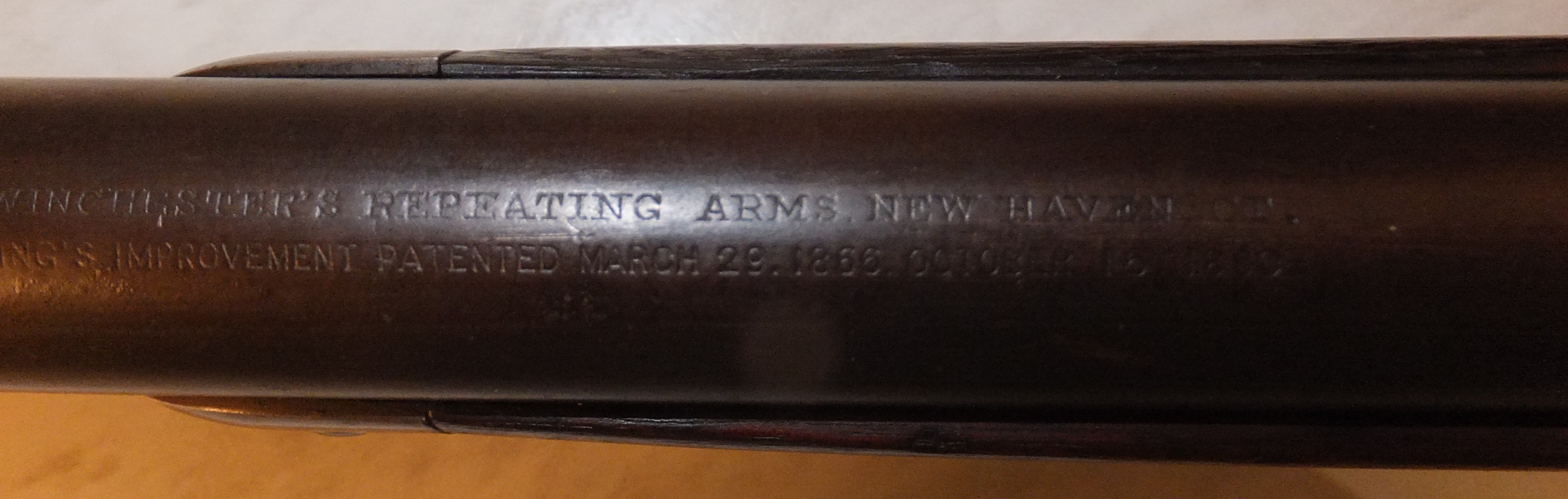

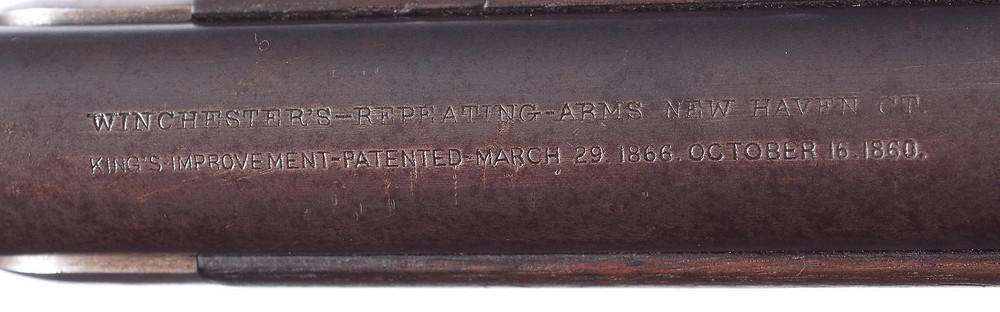

I just noticed something else that is setting off the red flag… the barrel marking is “WINCHESTER‘S“, and I have never seen that on any authentic Winchester barrel.  In all cases that I am aware, it should simply be just “WINCHESTER”.

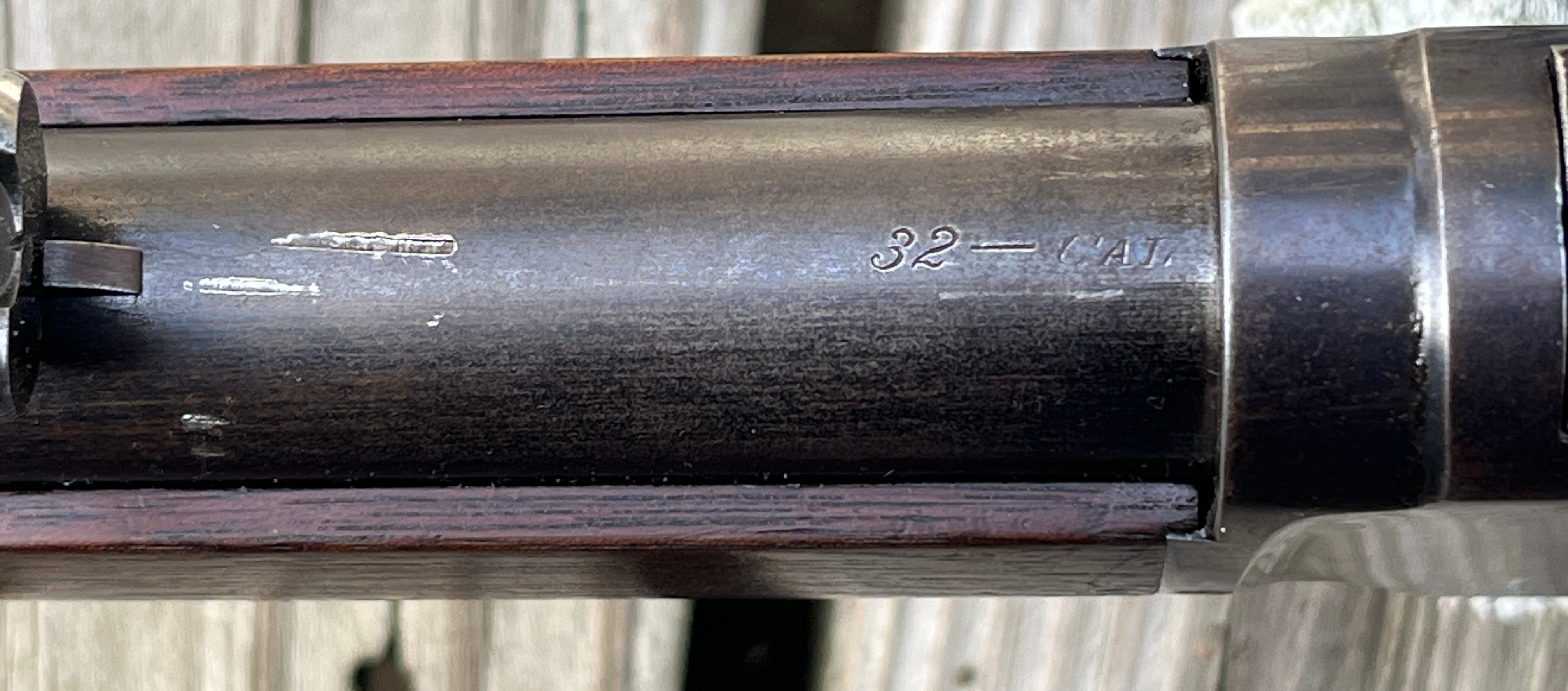

I also noticed the barrel caliber stamp is not correct. It should have a dash between 32 and Cal
Did the caliber marking ever change to “32 CAL.“?  The reason I ask, is because the early Single Shot rifles manufactured in 1885 & 1886 were marked without a dash just like the barrels on that pair of 1873 Short rifles.
You may need stronger glasses Bert, picture of the address on my 73 short rifle sn 51818573-short.1.JPG
