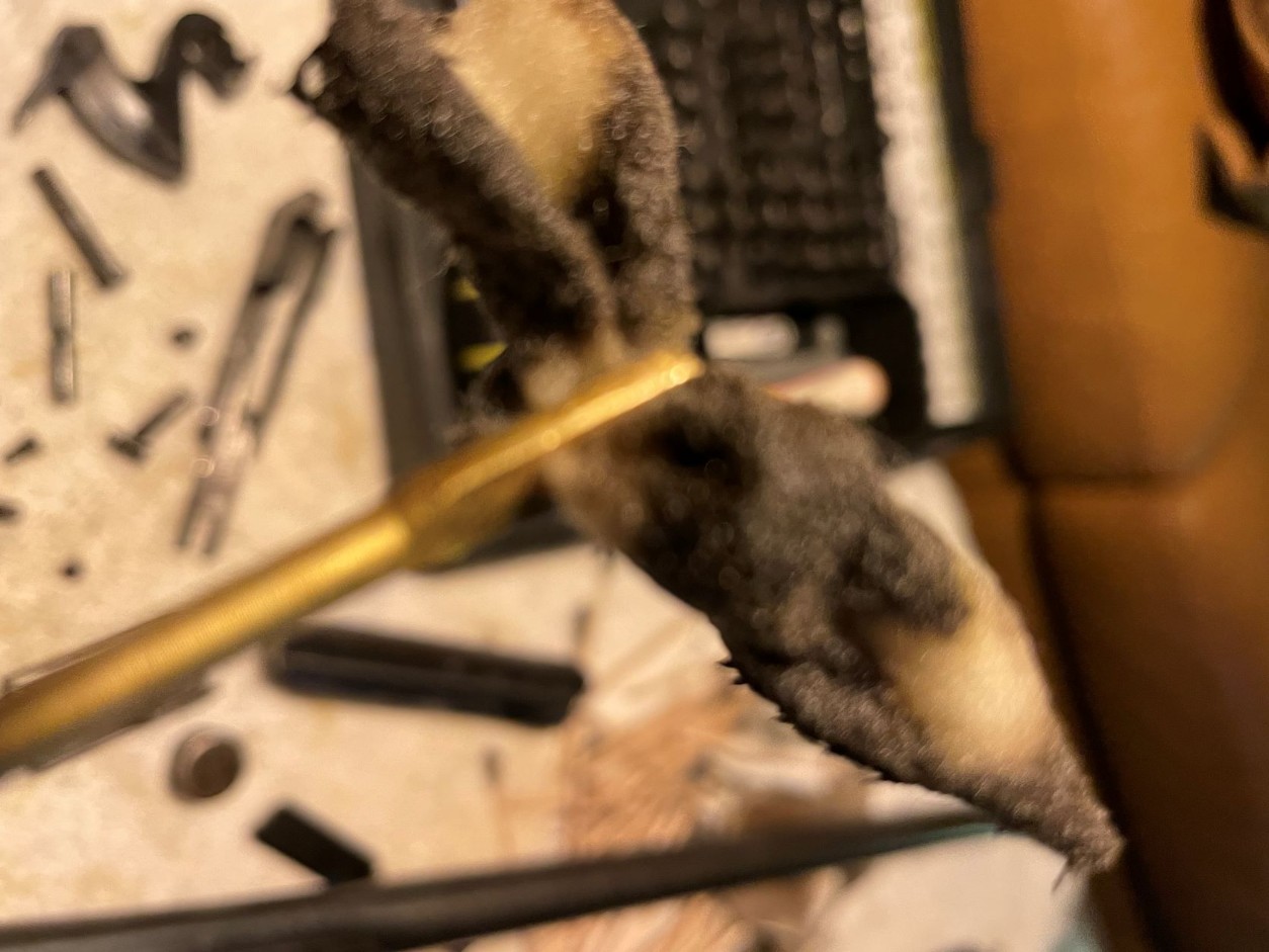

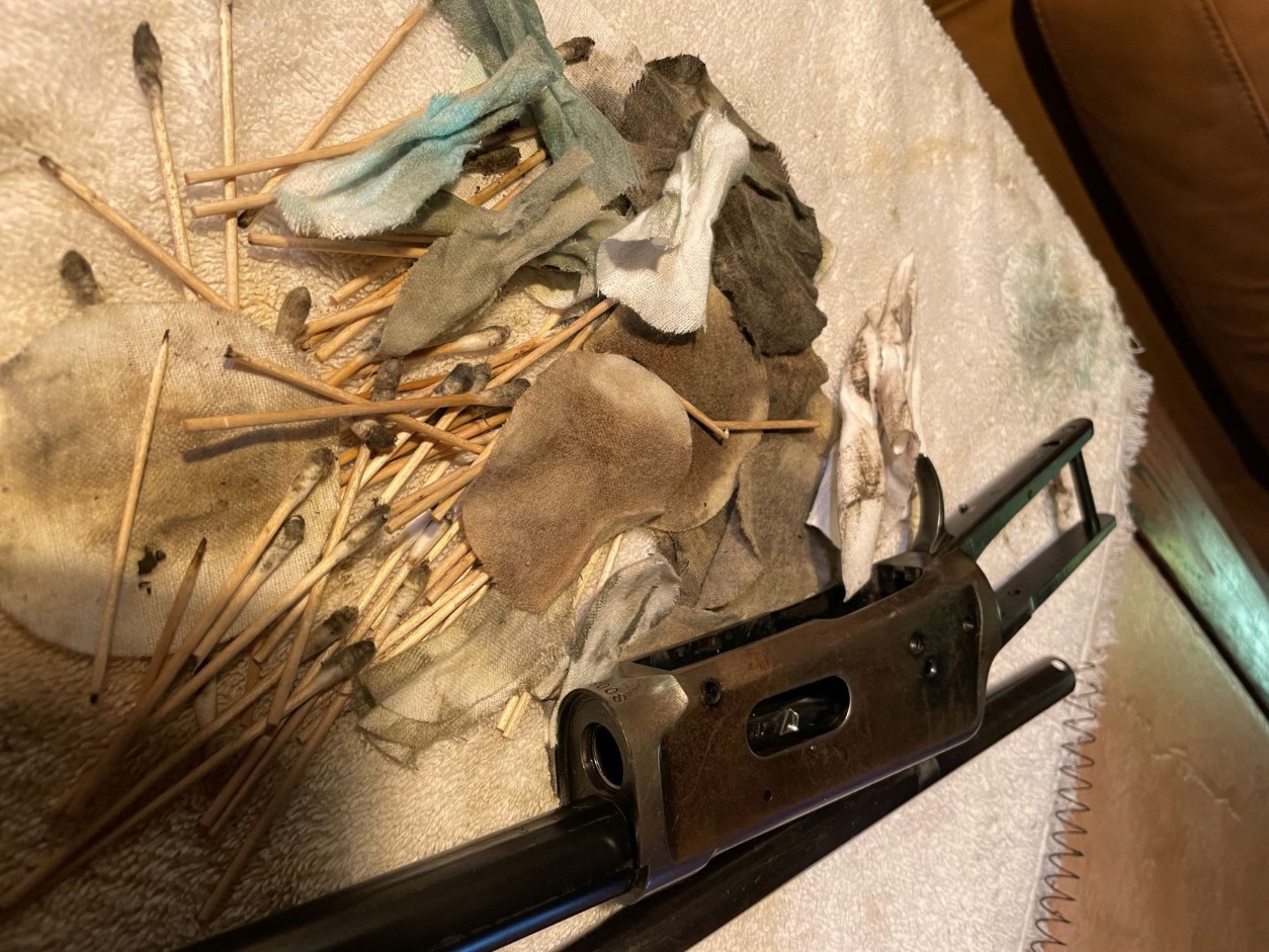

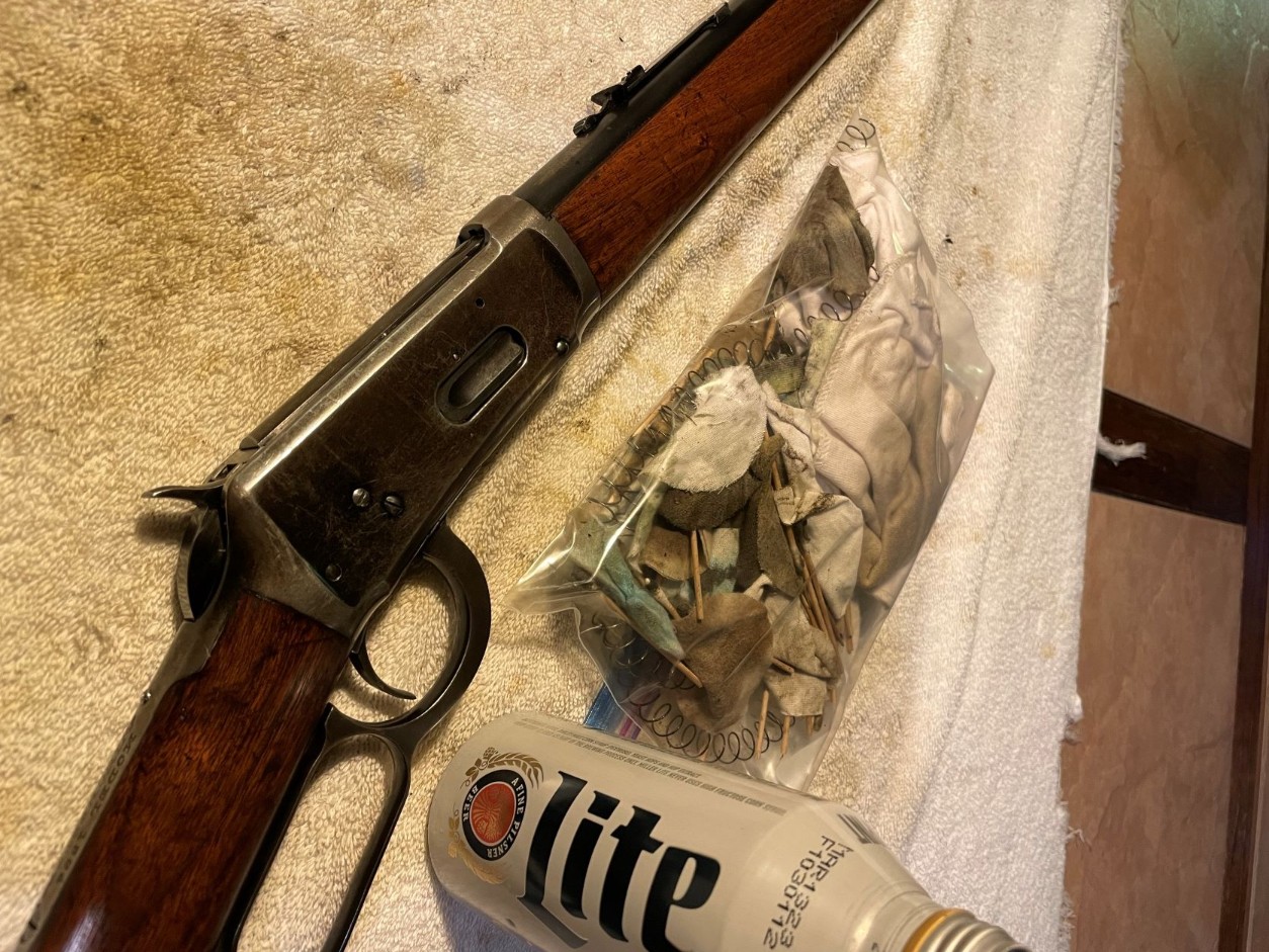

Shown in the pics is a made in October 1915 ser#800838 26″ 30 WCF  Model 94 Rifle that I picked up yesterday from my FFL.
Time to tear down, clean and assemble ….. 6 hours ( I’ve done this before)
First inspection looked to be un-touched as far as fasteners (every screw slot filled to the top with 107 years of grime)
The real soiled patch was ONE swipe through the magazine tube, spring came out in two pieces. The patch in my hand was grime under the forend wood.
The green patches obviously were from the bore. Bore cleaned up like “New” shiny with strong rifling and No pitting or frost.
After 20 toothpicks,40 Q-tips, countless patches and rags and 6 hours labor it cleaned up very well.
No hardware had to be replaced. Bolt was completely disassembled and cleaned. Firing pin was seized in the bolt until I cleaned.
Bluing on barrel and magazine tube 95%, receiver bluing 25% with no nicks or gouges. The towel was white when I started the service.

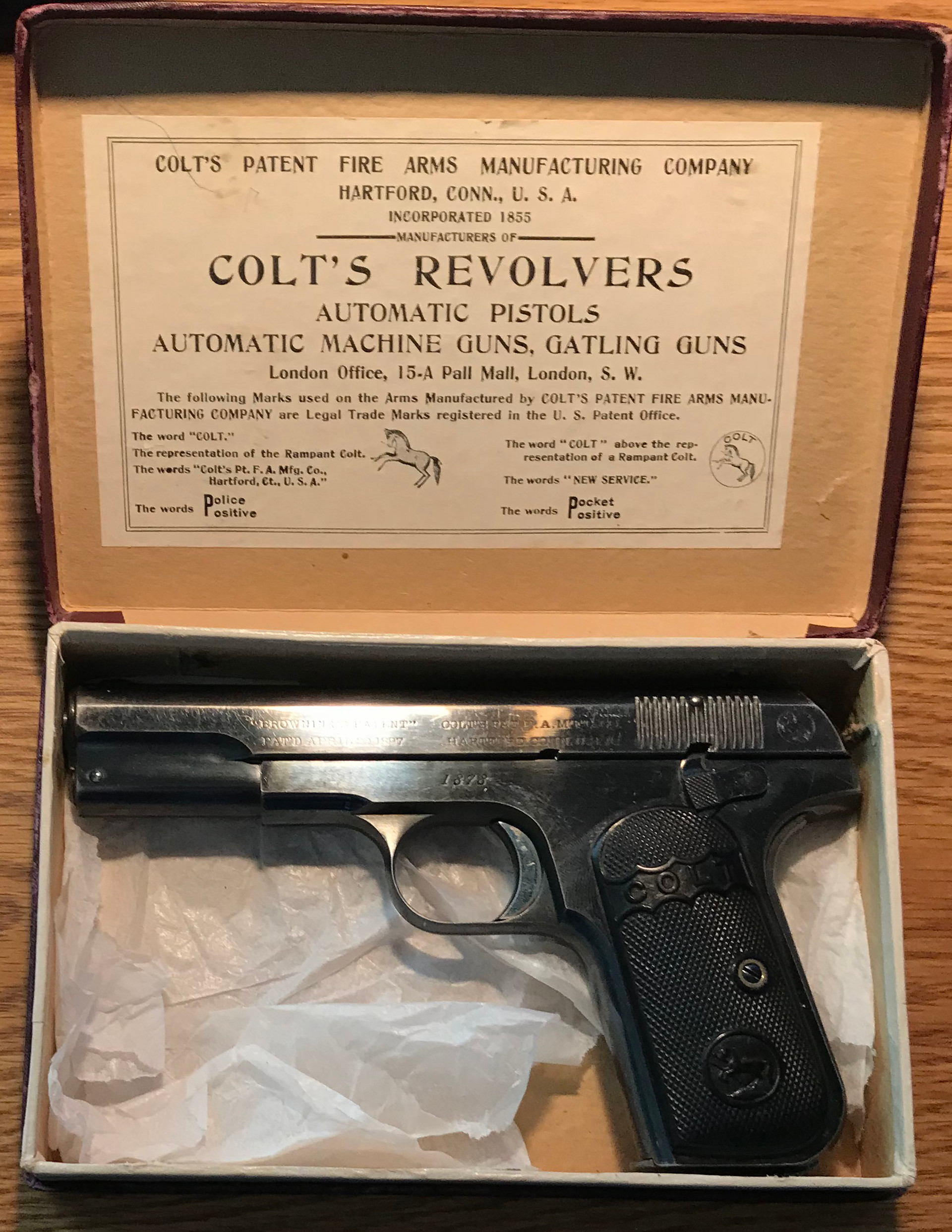

March 9, 2023 - 7:42 pm
Nice story.  If you would like a box these do come up for sale.  Might be a few hundred dollars for a real nice one.  The one in the picture is an early gun and box.  The early barrels are about 1/4″ longer and so is the box.  These will bring a premium.

March 9, 2023 - 7:57 pm
Hi Chuck,
Thanks for the pictures that looks like the box that I remember that pistol was in. It had the same label on the inside and a label on the end but the box was a plain cardboard box. The store stamp was in red ink on the top in the middle of it. I only wish I could find the original box I only had it in my hands a couple times when I was young. Knowing my grandfather he may have kept a bill of sale with it if he did it is long gone like the boz. In hindsight I think I value it more than my dad did I only wish I know more.
I would be interested in finding a box to go with it.
Rob
March 9, 2023 - 7:58 pm
S&W 1930s red boxes sell for over $500 on ebay, but since the serial is written with a china marker on the box, they can’t very easily be passed off as original to any other gun.  Same with Colt boxes, so nice as it is to have one, I question whether it’s worth that much for a non-original box.
