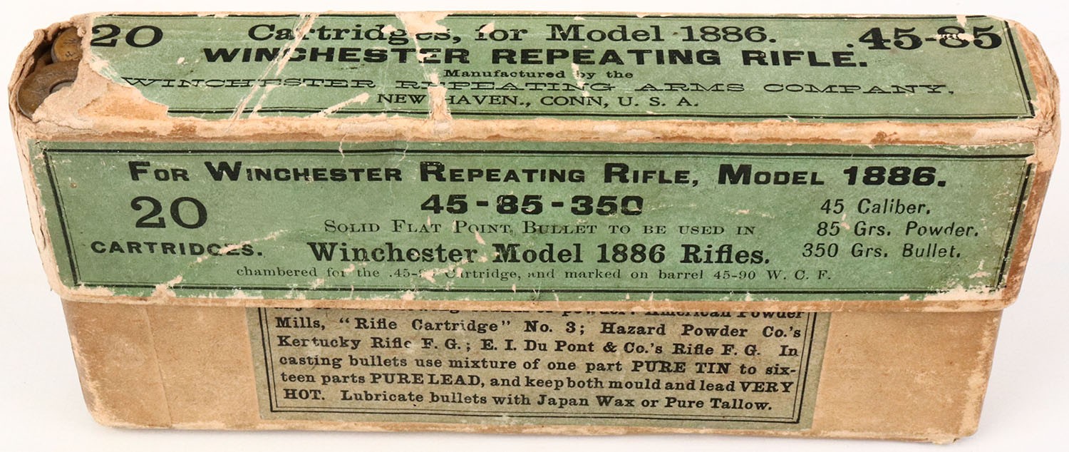

The box label is very forthcoming, “To be used in Winchester Model 1886 Rifles chambered for the .45-90 Cartridge, and marked on barrel 45-90 W.C.F.” The bullet is 350 grains of Solid Lead with a Flat Point.
I do believe there have been a rare few rifles that had their respective barrels marked wit the .45-85 W.C.F. caliber stamping. The rate of twist no doubt would be the same as the 45-90 W.C.F. barrels.
This is very interesting Mav, I haven’t seen or noticed this before! Nice work my friend!Smile

Anthony said
I agree with Tony – very interesting.  I really enjoy seeing this box.  And, the 350 grain bullet is helpful.  I mentioned earlier, there were 15 M1886’s that left the factory marked .45-85 WCF.  I sure would like one of those in my collection.
